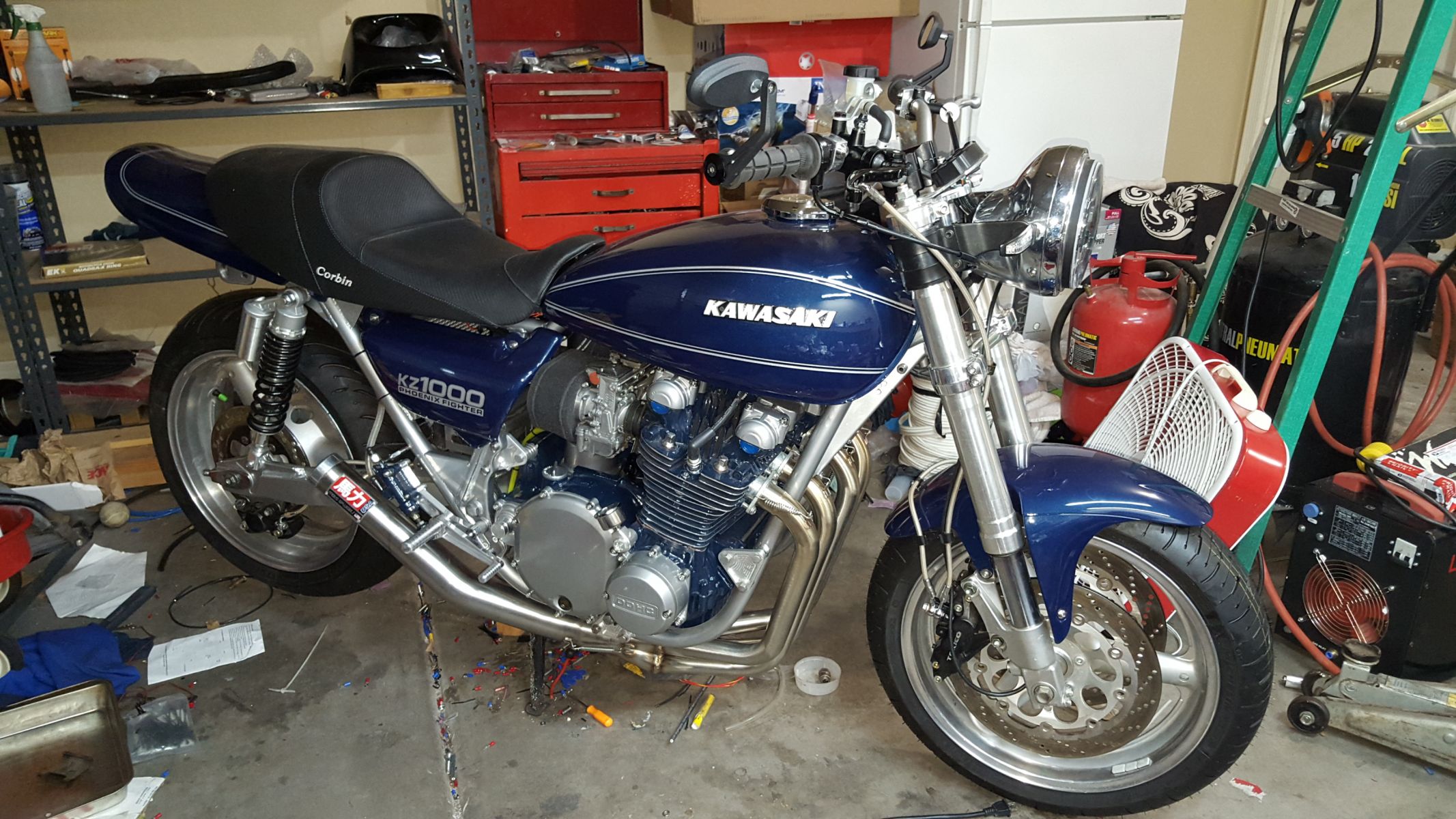

I think the issue is to big of master. I thought the nice GP set that I bought would work but they don't. My brakes wouldn't work either. I have a stock M.C. that I will try tomorrow night. I didn't rebuild the GSXR front calipers so I may just rebuild them all just to make sure. It's not flex in the line as I have made all brand new stainless steel brake lines.

Got the front brakes working today. I had to go back to the cable clutch mechanism. I think something is wrong though. I adjusted the clutch per the FSM but when I pull the clutch lever in the rear wheel won't spin free when I have it in gear. I am concerned as I removed the push rod when I was mocking up the hydraulic clutch. Is there anything I could have screwed up there. By the diagram it does not look like it.

Re: Phoenix Fighter
22 Nov 2015 16:38
Clutch plates are sticking together. They should free up once you ride it.

Re: Phoenix Fighter
22 Nov 2015 18:30
Thanks Steve that makes sense, I put the new clutch plates in about a year ago. I will do some quick tuning on the carbs and see where it goes from there.

Re: Phoenix Fighter
25 Nov 2015 17:01
Test run ready. Bench tuned the carbs Monday. They run a bit rich and will have to jet it down a step as the only way I can get them even close to running right according to my color tune. I only have the mixer screw turned out a 1/4 turn. Wish I would have marked down what jets and needles I had in it when I was bench syncing them. :pinch: Fortunately on these carbs the are easy to access.

Re: Phoenix Fighter
25 Nov 2015 17:09
It will lean out as it breaks in. A little rich is better than too lean. I'd put 500 miles on before I started to dial it in. That thing looks like it wants to GO. :woohoo:

Re: Phoenix Fighter
25 Nov 2015 17:22
That's the plan Steve. I am off work tomorrow so I get to take it for a test ride finally. Should also be able to get a quality video and pictures done tomorrow.
