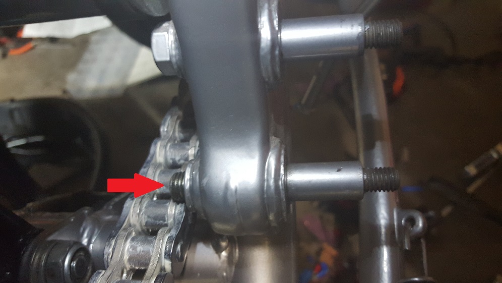

Minor set back. I put my chain on tonight and uncovered a clearance issue. I pulled a nut off the rearsets stud. Does this stud come out? If not I cut it off and move on. I can't tell because of the powder coat.

The studs screw out of the frame. I use a pair of vise-locks on them to break them free but I'm sure there are gentler methods.

It will come out but the chain will slap against the bushing when loose.
