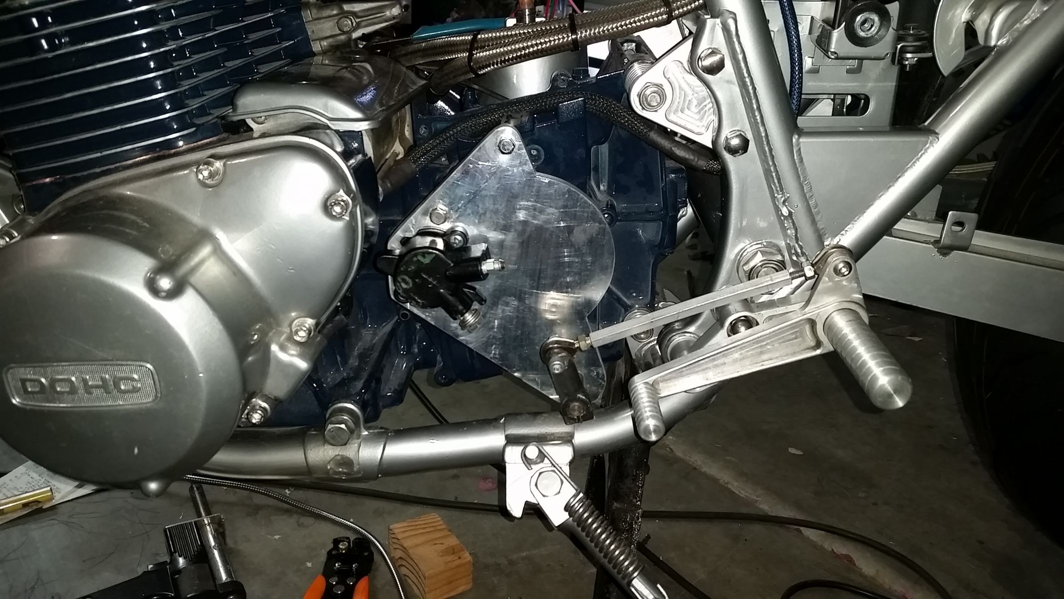

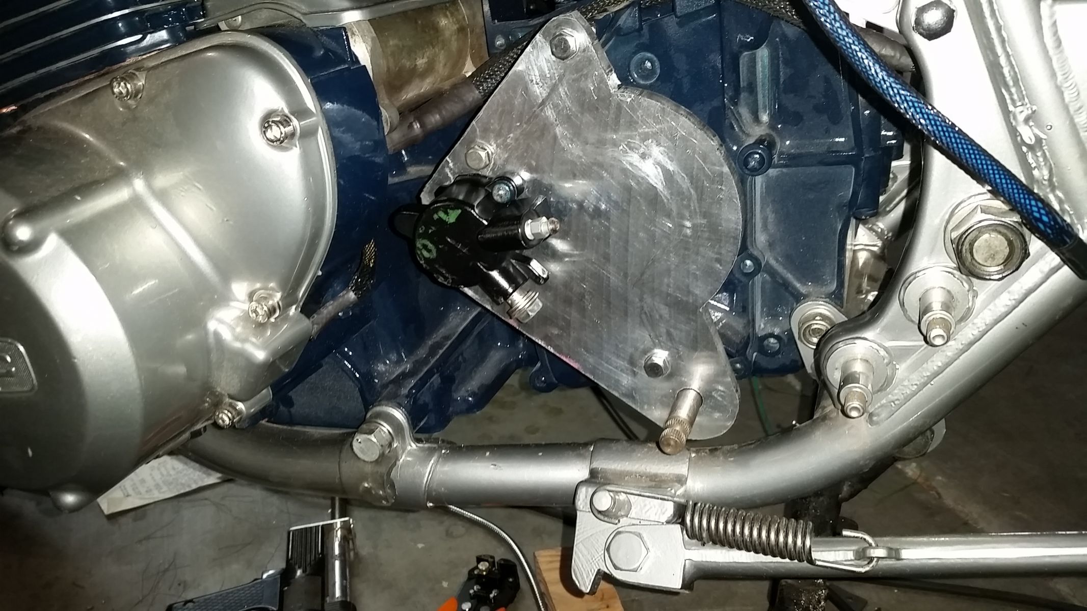

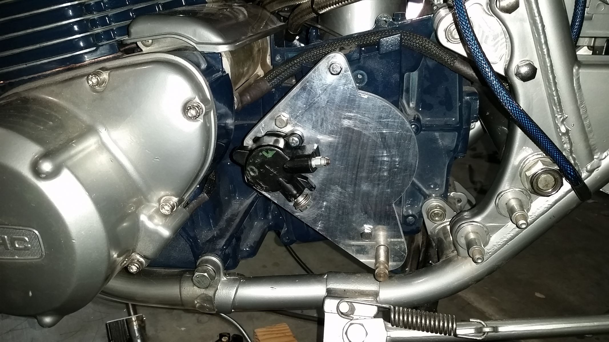

31 Aug 2015 13:07swest wrote: Will it fit under the cover? I'm far from doing it but interested.

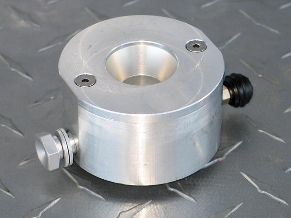

No Steve, not the way I made it. I think a guy could make that work but you would have to shorten push rod. There is already a guy that makes a slave cylinder that takes place of the worm gear. Davido posted a link to that. Its made by American classic x
Here is a link from GPz750KS Hydraulic clutch conv
Jon

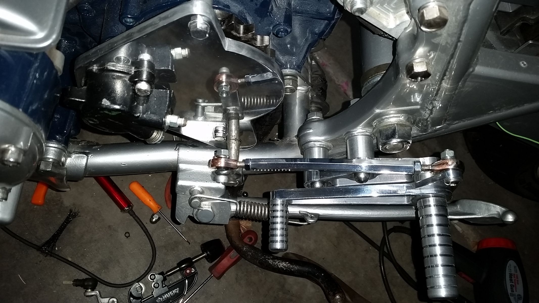

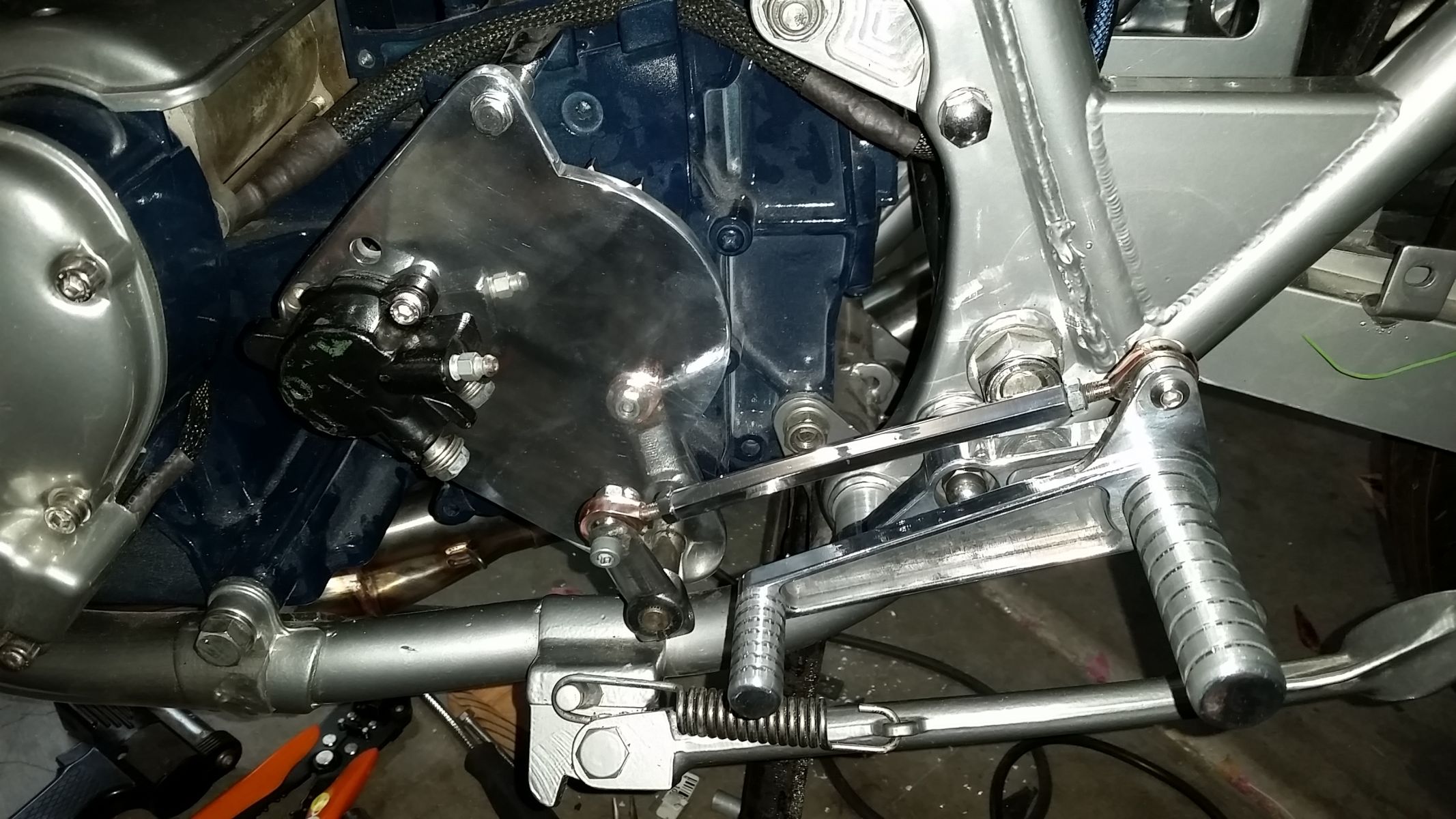

Well, I need to get some material for spacers, clean it up and some new bolts and its done. Still waiting on some new banjo ends for the hydraulic line. I wanted to get the bracket mounted before I ordered the banjo for the slave cylinder end.
I will end up pulling the starter and painting it the same color as the motor so it blends in.

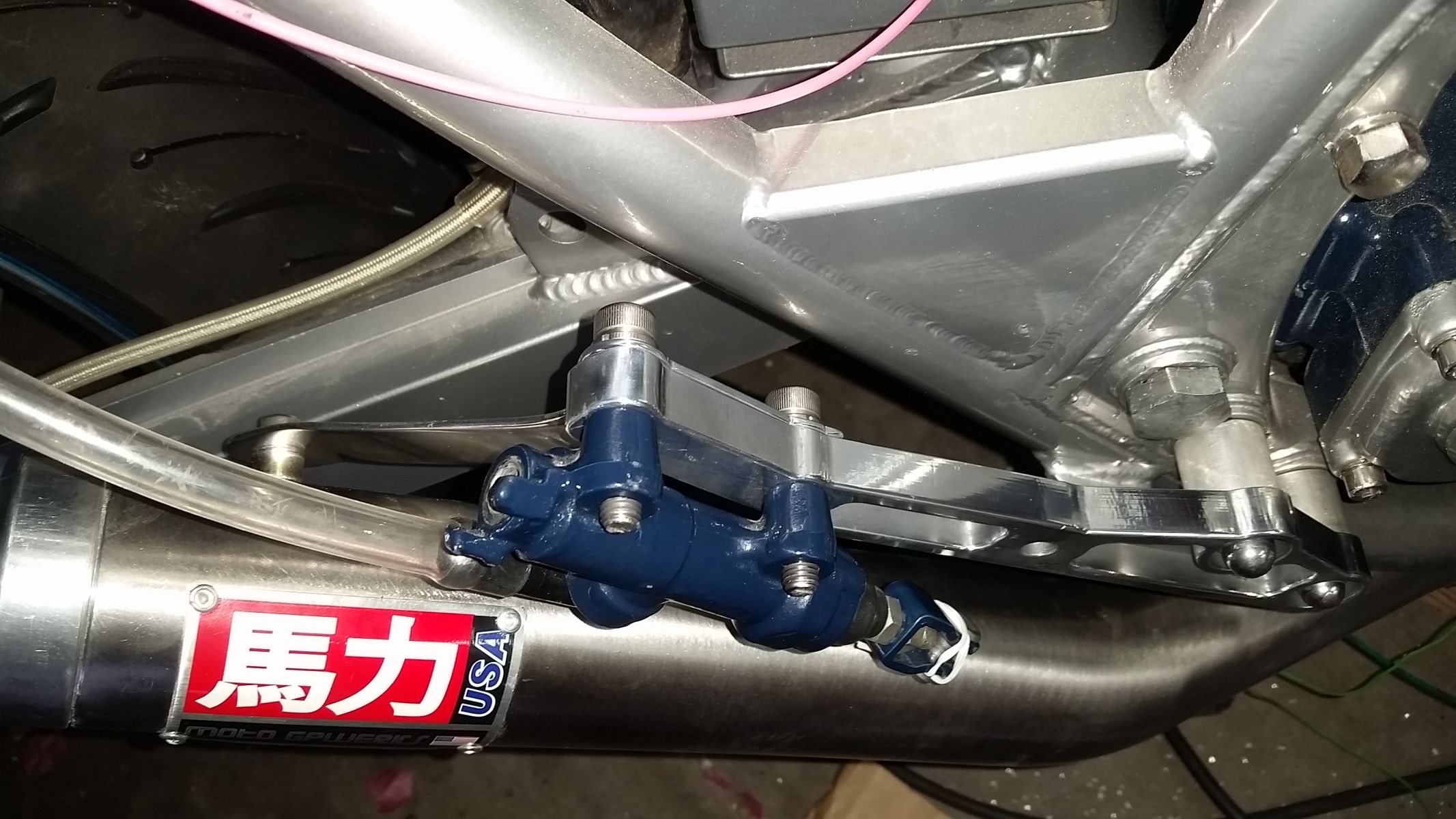

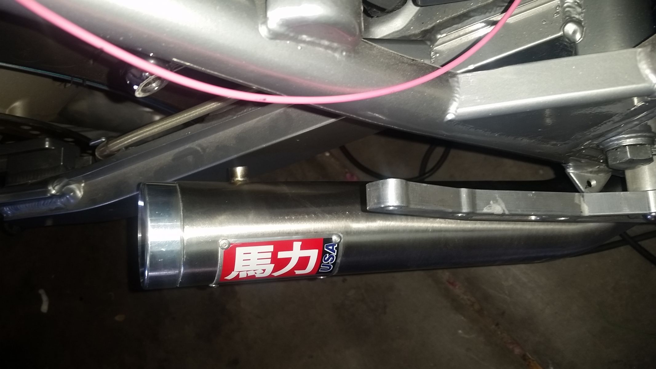

Re: Phoenix Fighter
06 Sep 2015 15:56

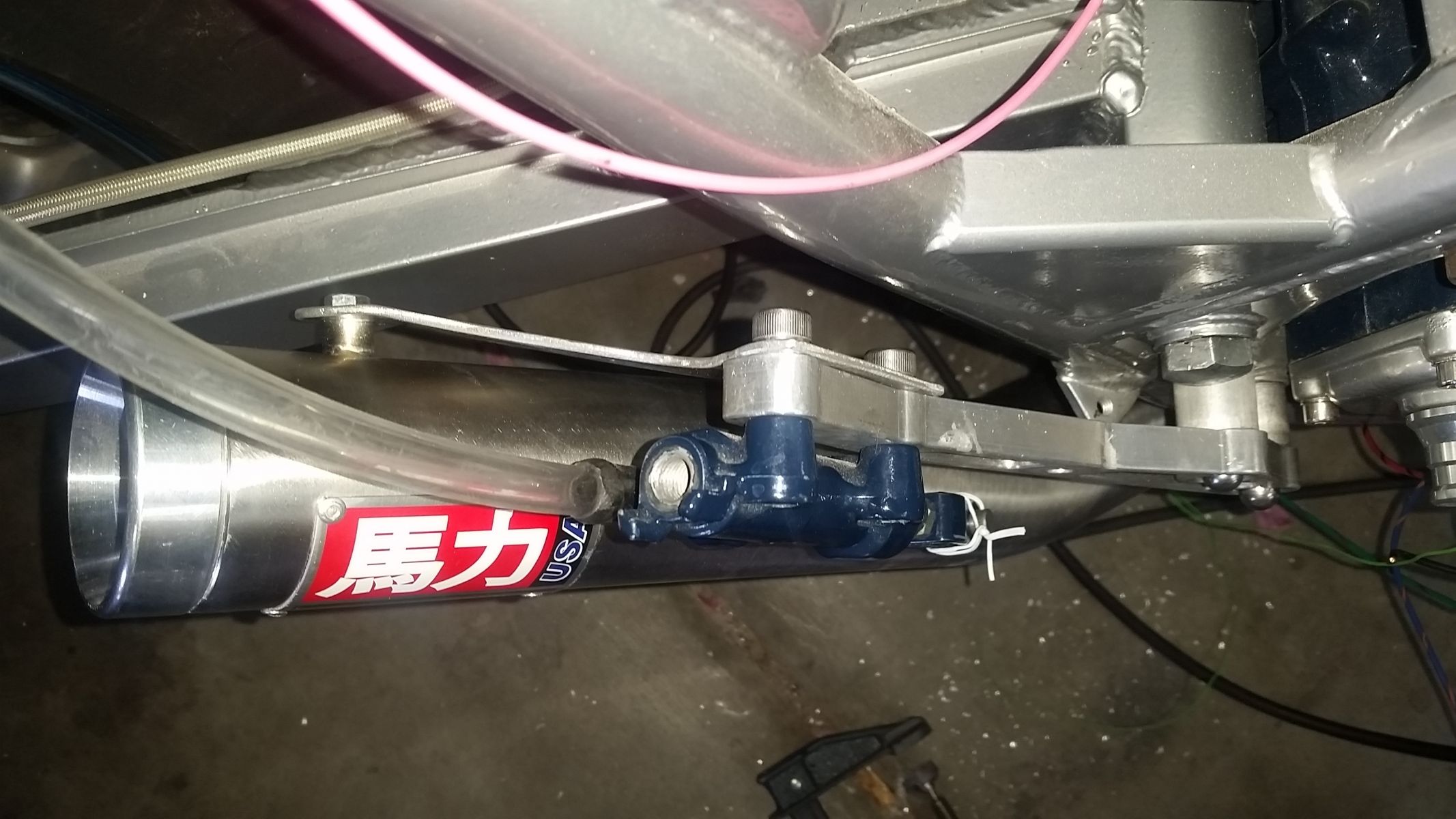

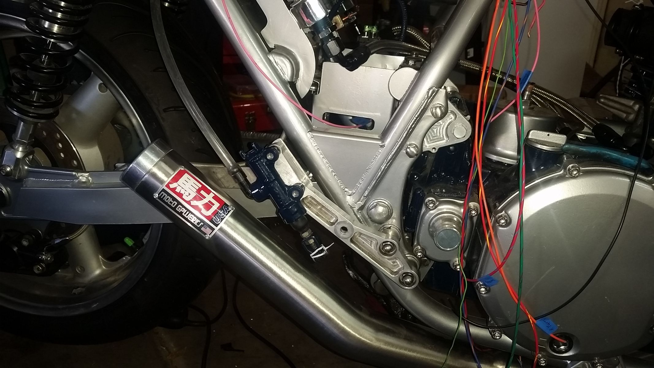

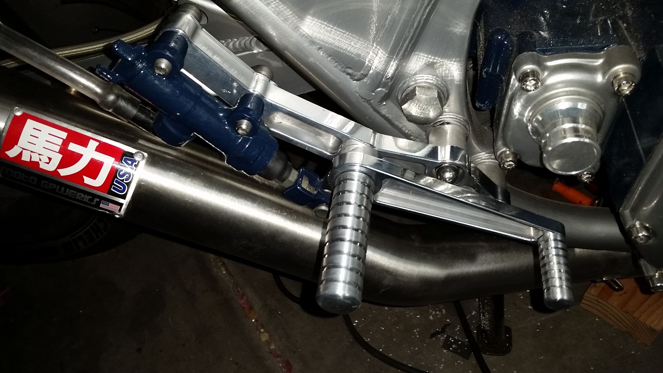

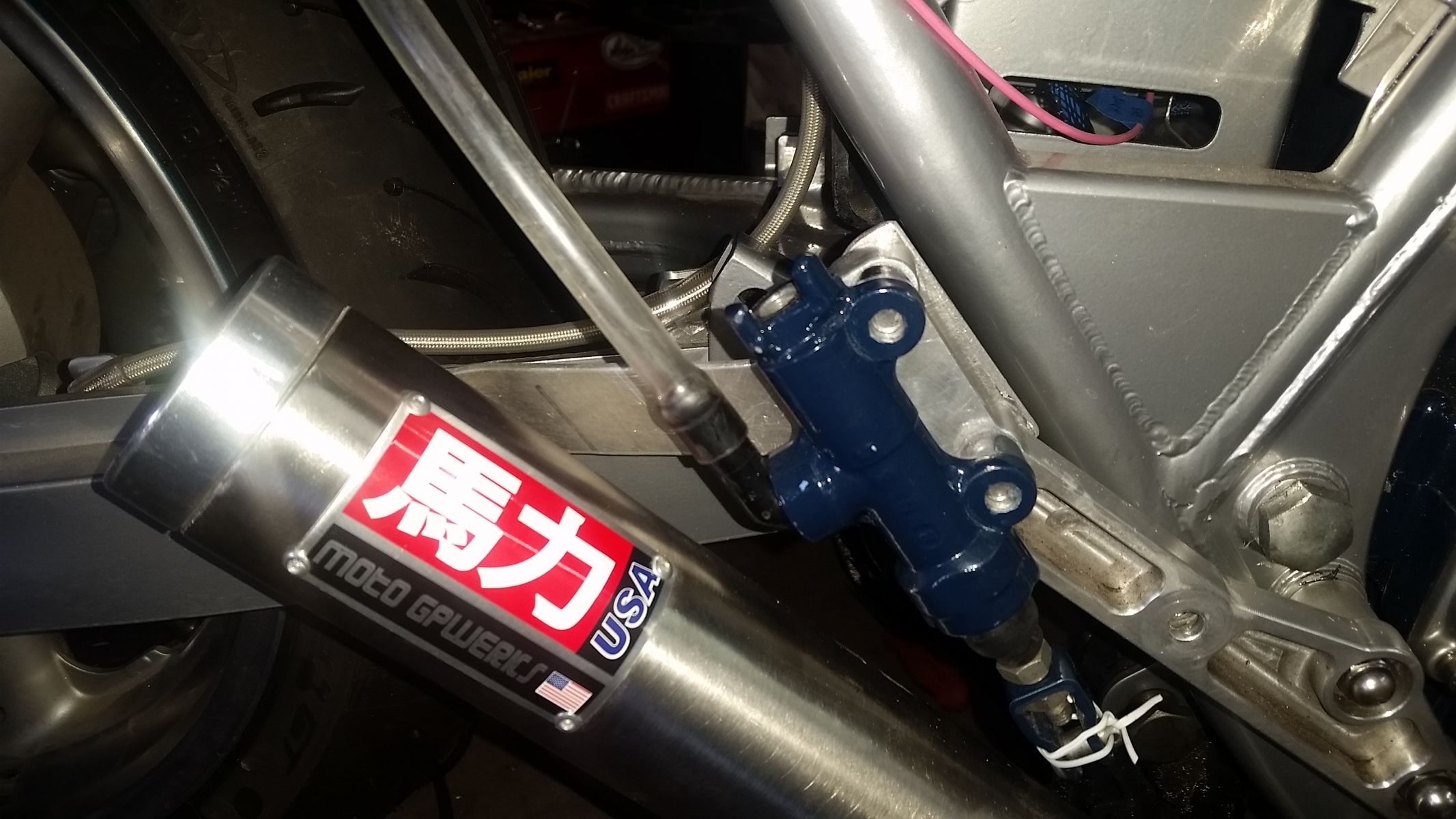

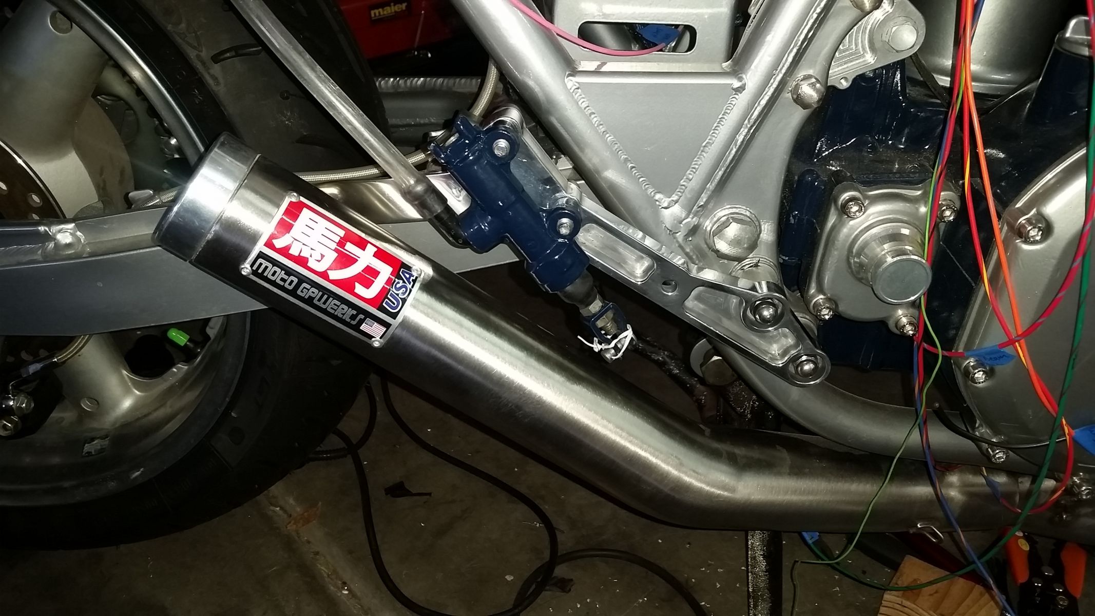

Couple of finish photos of the exhaust bracket, Decided to put a little polish on the rear set bracket also. Now I have to do it to all the rearset parts :pinch:

Re: Phoenix Fighter
08 Sep 2015 08:22
Nice. Your clutch doesn't as naked as I thought it would.
- kaw-a-holic
- Posts: 1808
- Thanks: 249
Re: Phoenix Fighter
08 Sep 2015 09:12
I like it. The starter is not hidden like it used to be so I may take it out and pretty it up a bit.

- bluezbike
- Posts: 592
- Thanks: 104
Re: Phoenix Fighter
08 Sep 2015 09:40
That just looks really sweet......I am really enjoying your fabrication work :woohoo:

- DoctoRot
- Posts: 2622
- Thanks: 785
Re: Phoenix Fighter
08 Sep 2015 18:54
Dang those rear sets are CLEAN. are they Les Holt's? If i hadnt already gone with Tarrozis i would have gotten a set from him.
- kaw-a-holic
- Posts: 1808
- Thanks: 249
Re: Phoenix Fighter
09 Sep 2015 02:16DoctoRot wrote: Dang those rear sets are CLEAN. are they Les Holt's? If i hadnt already gone with Tarrozis i would have gotten a set from him.
Yes Doc, those are from Les Holt. I polished them. He also made the motor mounts. I made the mount spacers that match the foot pegs he made. I still need to polish the engine mounts to match through rearsets.
