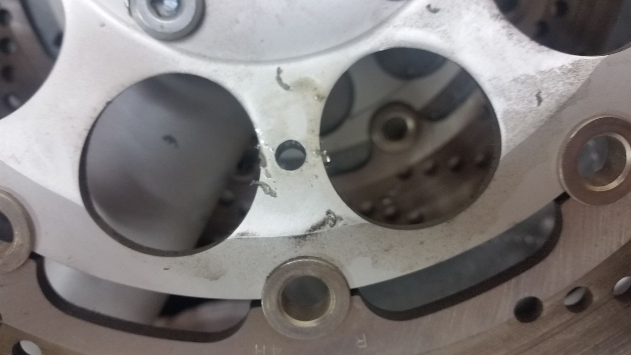

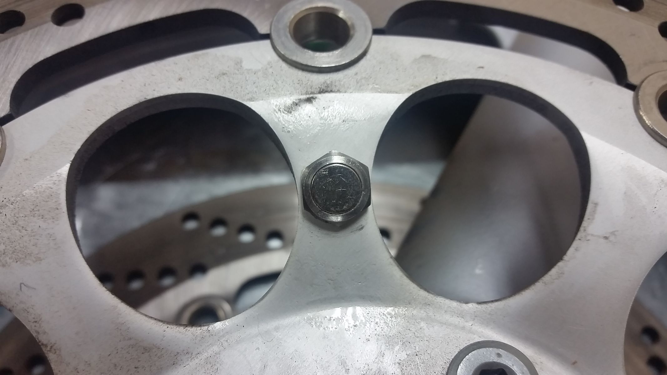

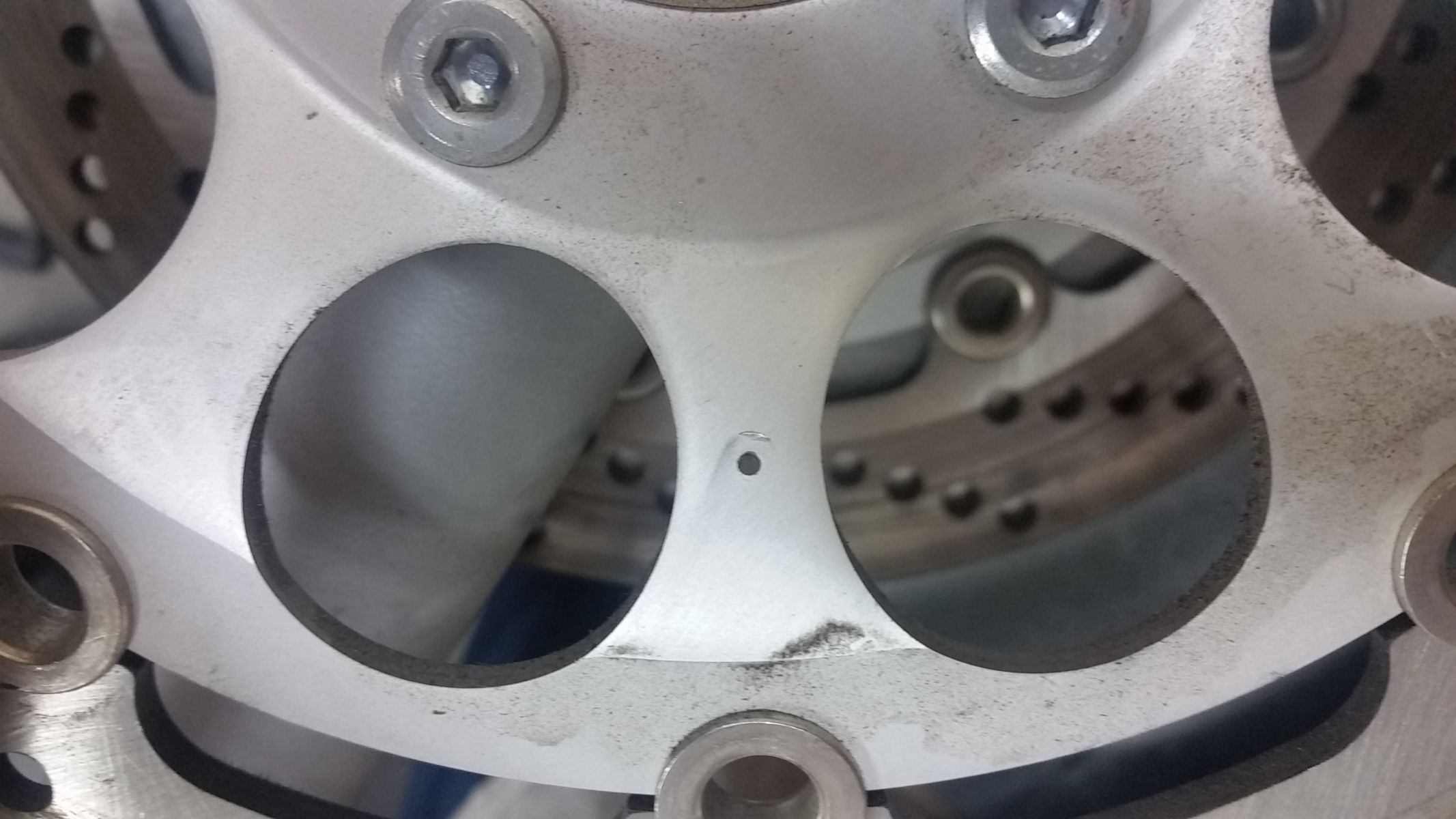

Didn't get a lot done on the bike today, stuck waiting on some fresh Wisco circle clips for the piston pins. So I spent time staring at the bike. This is helpful sometimes as I come up with new ideas or solutions I did not see before. I was going to purchase new gauges from Speed Hut because I couldn't find a way to mount the speed sensor to my Trail Tech unit. Well problem solved. I also had to pull my fork tubes to have them serviced. I hate farming out work but this is something I really didn't want to mess with and have to buy yet another specialty tool I will loan out more than I use. So here are a few pics of the magnet I mounted.
