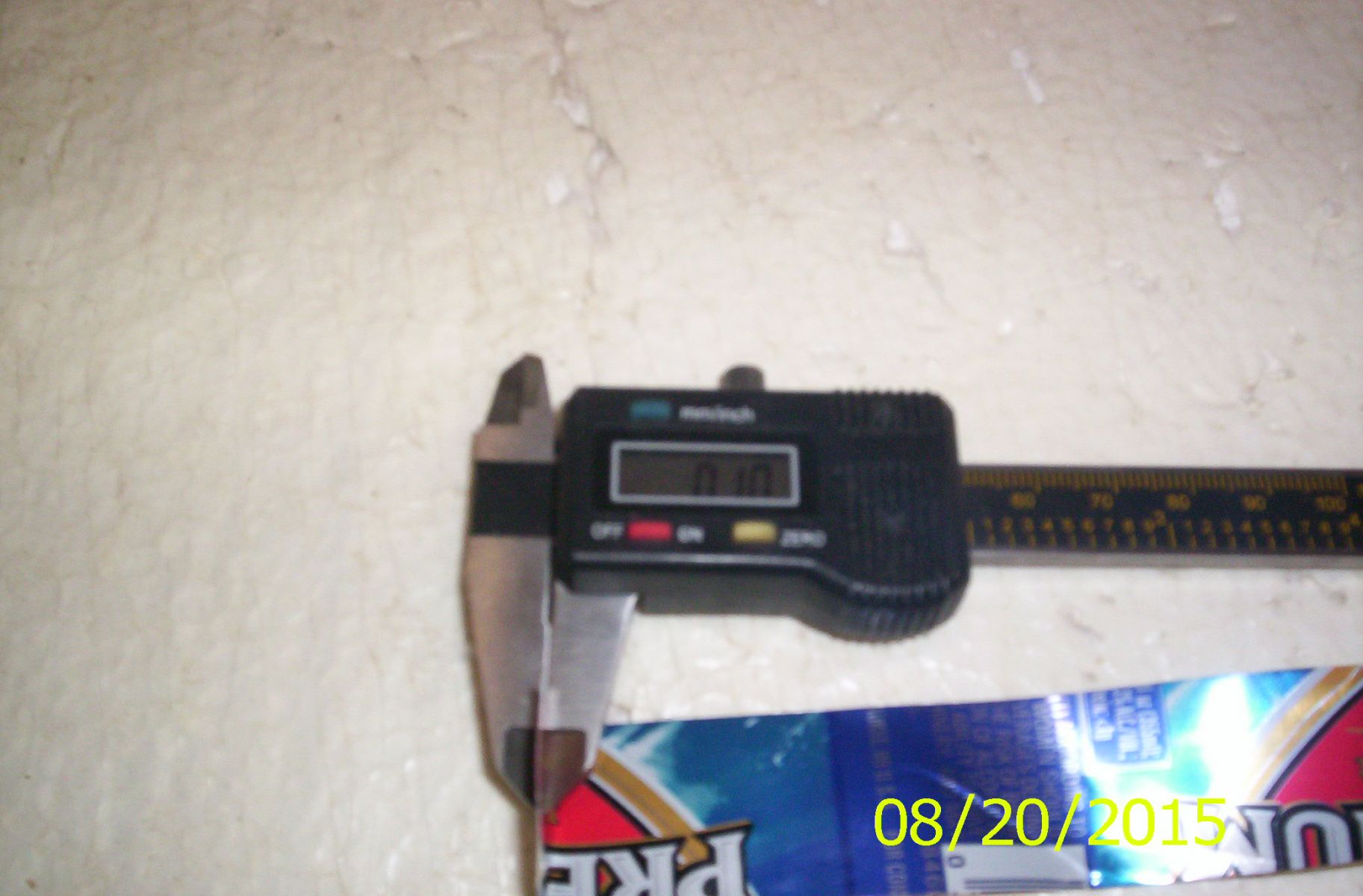

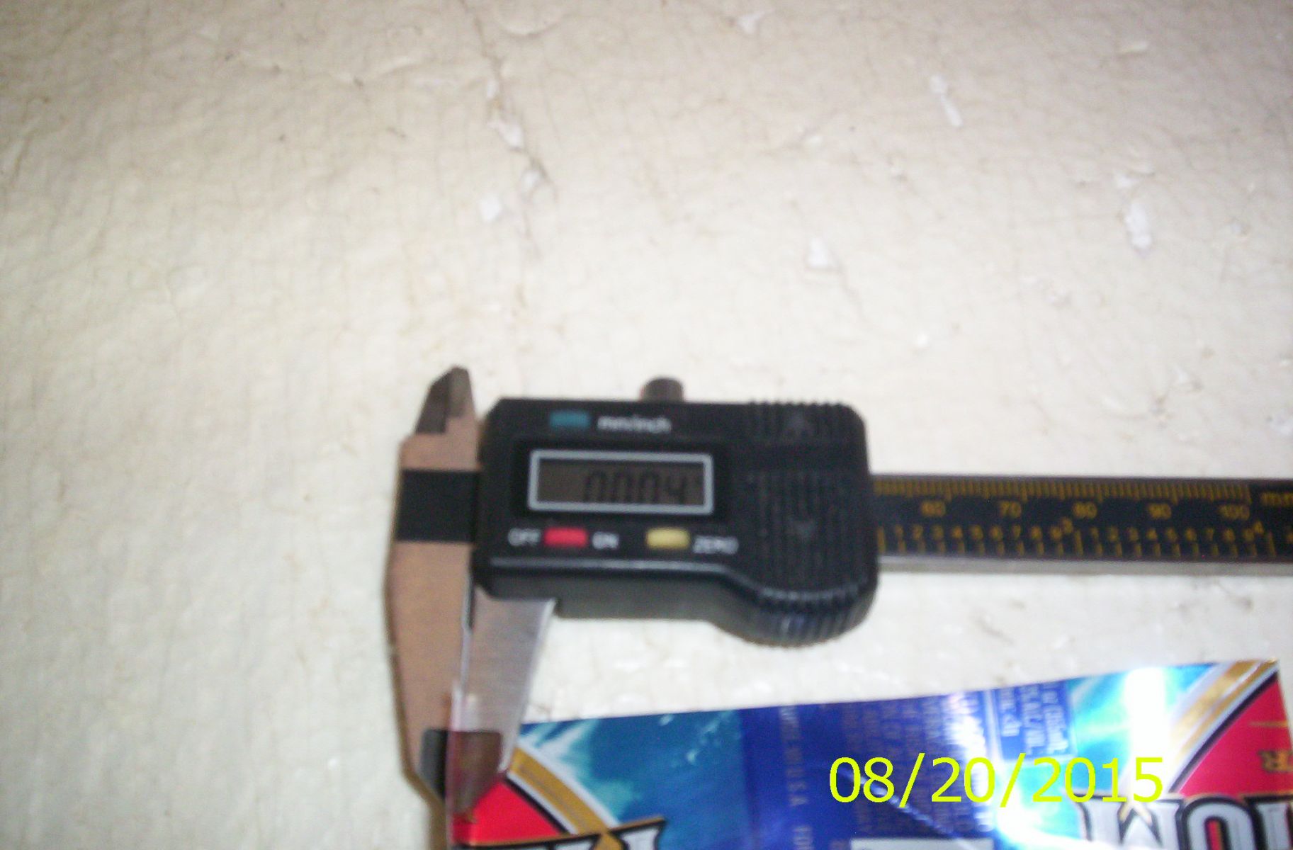

This is going to sound weird but you can use the beer can trick to shim up your cams and take your readings, then remove the shims from under the bearings. Be sure to shim the cam towers too. Measure the thickness of the can stock and subtract. I'll be back later, late to work.

Back in 78 I had bent valves due to a broken cam chain. I strapped the head to one of those little old lady pull carts, took a bus to LA, got my head fixed and came back home. When I put in the cams, I found the clearances were 0 or less. There wasn't a K shop for 60 miles. I had only the bike and it wouldn't run. I slept on it and the next morning I cut some shims out of a beer can, put them under the cam bearings, poked holes where the oil galleys were and shimmed the cam towers up with my beer can stock. I was desperate. It worked. I rode the bike to Riverside, got my shims and rode home. The beer can thickness is about 0.10mm/0.004". You can shim up your cams like this to take a reading on your shims.
