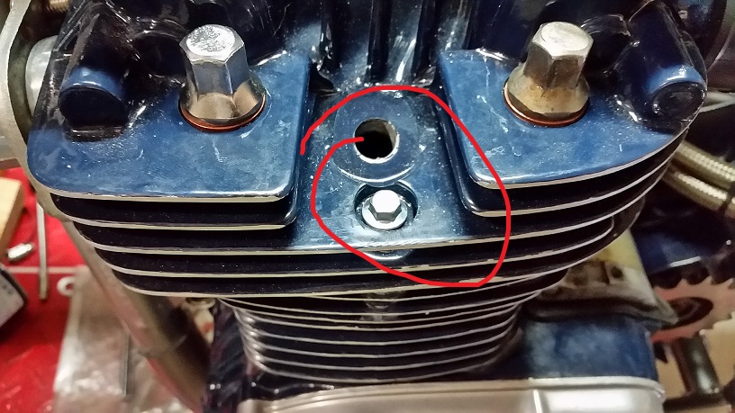

Love this bike but some days it is not easy. Finally got the Cylinders and head back on just to discover that the #13 hole in the cylinders is stripped out. My question is what do I fix it with? Heli-coil or Time-cert? Time-Cert is better but doesn't it need a much bigger hole?

Heli coil. Just pick up the tap and a bag of four. I just send them down with a small screw driver. Back and forth little by little until in. You have that collar to deal with.

Timesert will work. You may be able to find a shop that will fix it fairly cheaply. Ed

thanks for the feedback I'm concerned that the helicoil won't take the 30 pounds of torque that I need for the head.

That's 104 inch pounds.
