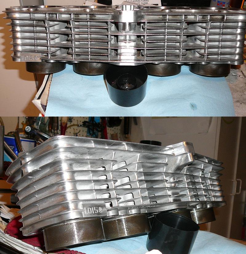

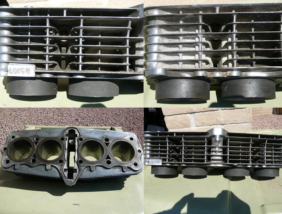

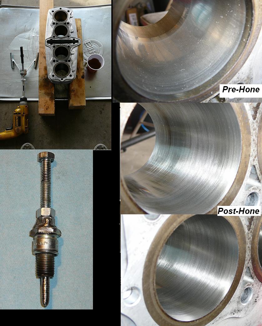

Good weekend... Final Z1 parts (I hope... :whistle:) on the way and Larry should be completed with the head next week... Close, oh sooooooooooooooo close...
Pre-Cylinder: DOH!... :pinch:
Post Cylinder... Still have some cleaning to do in crevices but coming along....
Pre/Post Hone and TDC Tool (adjustable length)...

any plans to repair the chipped fin ?

hey dave you might want to invest in the right sized ball hone those blade hones wont give a proper angle on the cross hatch unless you have your speed just right the cross hatch patern should be between 45 and 60 degrees in order to retain and shed oil properly. i hate to say it but yours kind of look like fine screw threads.

@ Marky- For the time being, using as is broken fins and all... Game plan is go with what I have OEM 1015cc with new rings at minimal costs... Save some money and send the old 903 cylinder to Joe Hopper for new sleeves, bore/hone for their 1075cc kit...

Yeah, Larry pinged me on that as well... :blush: :laugh: 70mm Flex Hone is the next purchase at pay-day...

when its time for the 1075, why not just get another 1015 and have it bored, rather than resleeving a 903 ?
Bingo
Check locally for the hone. Here's a link to a place where I buy my stuff.

14 Mar 2012 10:14Old Man Rock wrote: Good weekend... Final Z1 parts (I hope... :whistle:) on the way and Larry should be completed with the head next week... Close, oh sooooooooooooooo close...
That cylinder picture, pre-honing, shows a lot of ring wear at the top. I've seen this a lot on motors with higher compression, this looks like Detonation. I'd be sure to use a comp ratio for the F-d up gas we have these days.
The picture of the cylinder, after honing is no good. There is no cross hatch pattern, and with the amount of metal removed the piston to cylinder wall clearance would be in excess of the limits.
I wouldn't worry about re-ringing that one, and concentrate on getting a set going with a fresh bore/ pistons, or another that is in good shape and just needs de=glazing and rings.
