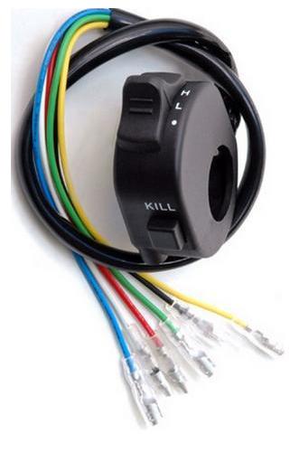

"since u r switching out the throttle, what r u going to run for switches now?"
Left handle bar will hold small control for turn and horn only, only others on the gauge cluster.
Still searching for what I have in mind but this is an example where this unit only measures ~ 1" wide.... Nice and narrow....
Kill = Horn
HD Light center contact "L" is common 12Vdc input.
"H" = Left turn
"." = Right Turn
I know, GAY right?... :laugh: :laugh: :laugh:

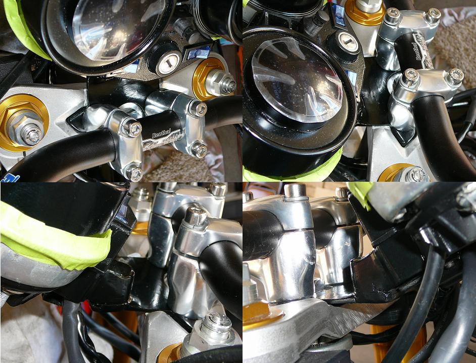

09 Feb 2012 22:26 - 09 Feb 2012 22:28

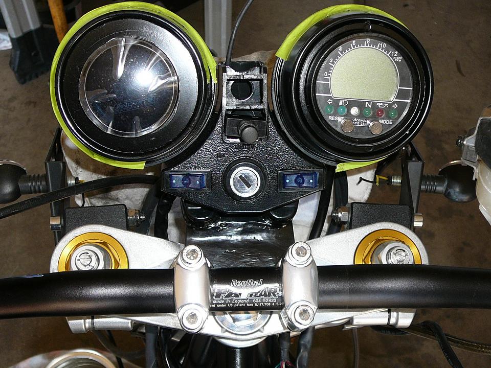

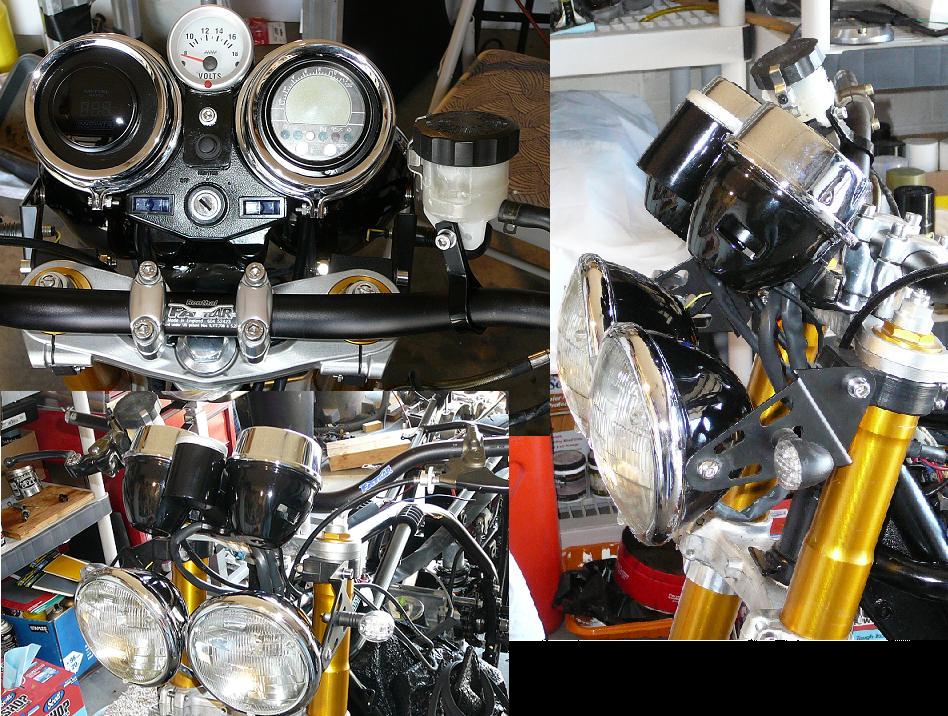

Not that I didn't like them Mark....
but I'm looking for slim as possible no more then an inch.
Maybe next build...
Some lighter images...
Don't mind the middle starter switch.... The Vdc Gauge mount will be cover/securing the switch in place.
Maybe next build...
