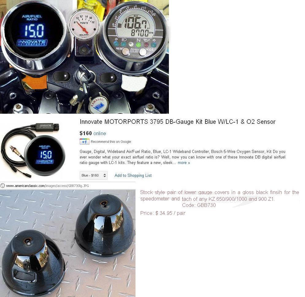

09 Jan 2012 09:15I like the plan, but let me warn you about that AFR gauge. That sumbitch will drive you crazy. You might want to have a sticker made up that says 14.7 so you can focus on riding. I know your personality is a lot like mine and you will find yourself wanting to adjust your pilot screws when sitting at traffic lights and changing jets at rest stops. :laugh:
Where did you get the rollbar paint? I like the sound of some paint that comes out of a rattle can and is still tough.

" you will find yourself wanting to adjust your pilot screws when sitting at traffic lights and changing jets at rest stops. ".... :laugh: :laugh: :laugh:
Several fold answers on this one...
1) AZ requires emissions so this would come in extremely helpful.
2) I can use this one to compare the results of the one I designed awhile back for accuracy.
I still haven't given up on that concept yet, have some ideas/design still to work out yet.
3) As in my recently destroyed engine
, an AF/R unit would have provided me some extremely useful data on that Black Sunday where I would have babied her home not working her hard on the exiting out of those turns... If I had only known... :blush:
Anyhow, I know from my plug condition/readings previously informed me my jetting was about right, slightly on the rich side. All the additional tools I can utilize for saving this next build I'm all for...

I hear you man, mostly just deviling ya. :evil:
I have rode around with my LM-2 strapped to my non-functional speedo and I have learned that you can only get the carbs right for certain criteria. That's what will drive you crazy. You have it tuned right when you leave on a warm afternoon and it's running a little lean when you are on the way home on the cool evening. Plus the transitions between pilot and needle jet, needle jet to main jet, and so on. That kinda stuff will bug you if you are watching it all the time. Next you will find yourself looking to go EFI.

OMR, I'm liking the customized original gauges. That was a good suggestion to run with. Nice position for the volmeter too. Well done! - Jim
