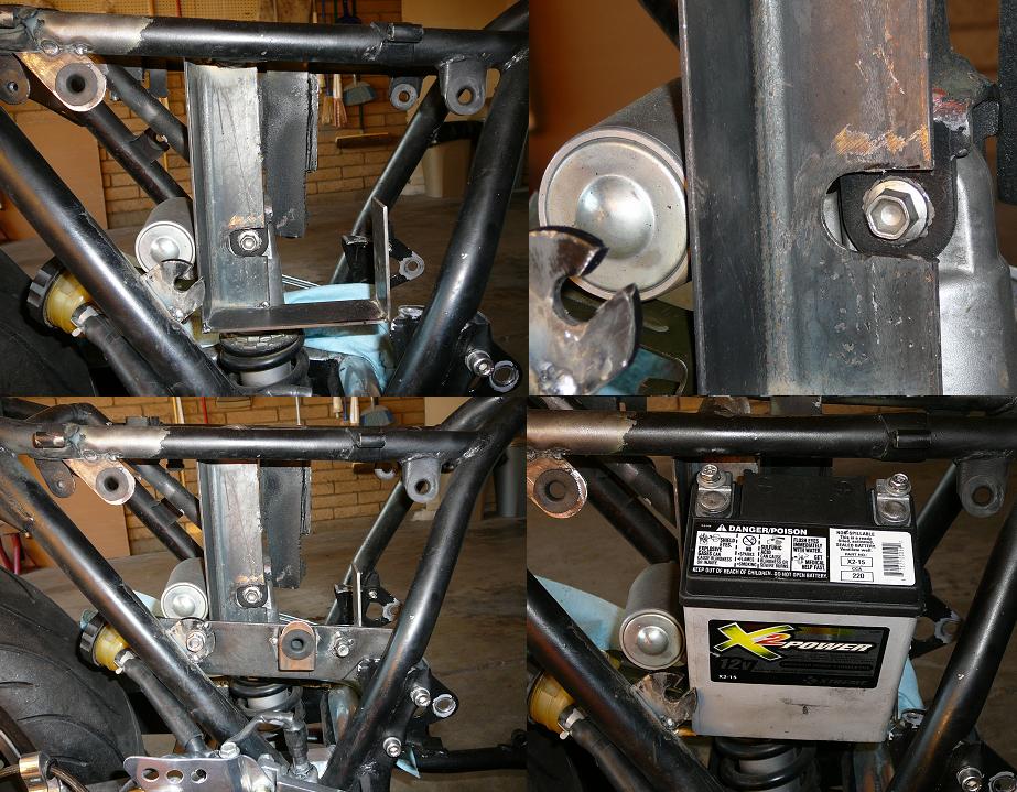

Just a little update...

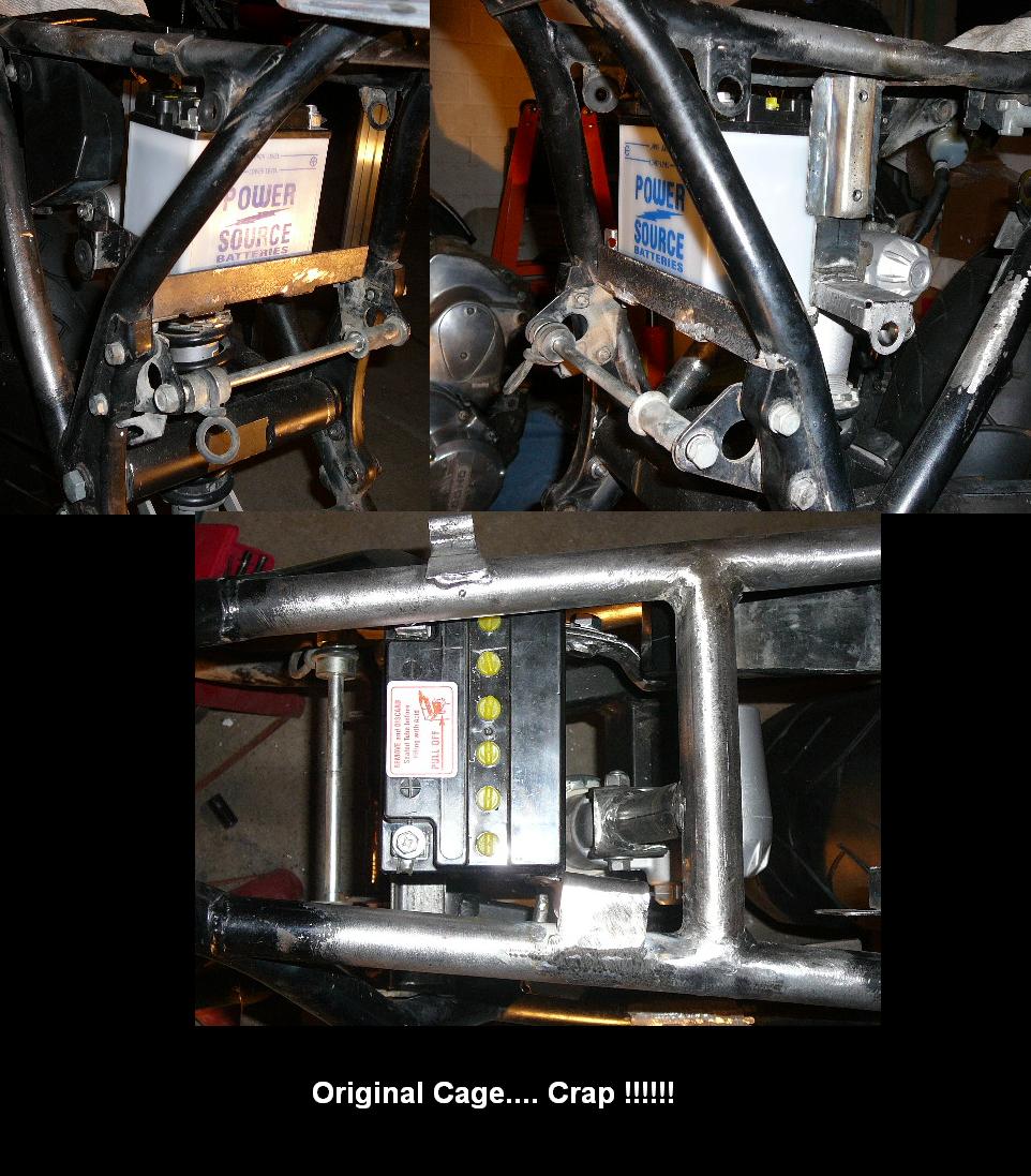

I always hated the way the original battery cage came out and it was always a pain in the ass to get into the compartment, the battery terminals, heat build up etc... Just plain sucked...
With that in mind a time on my hands, change it....
Original Battery Cage.... :pinch: :whistle:

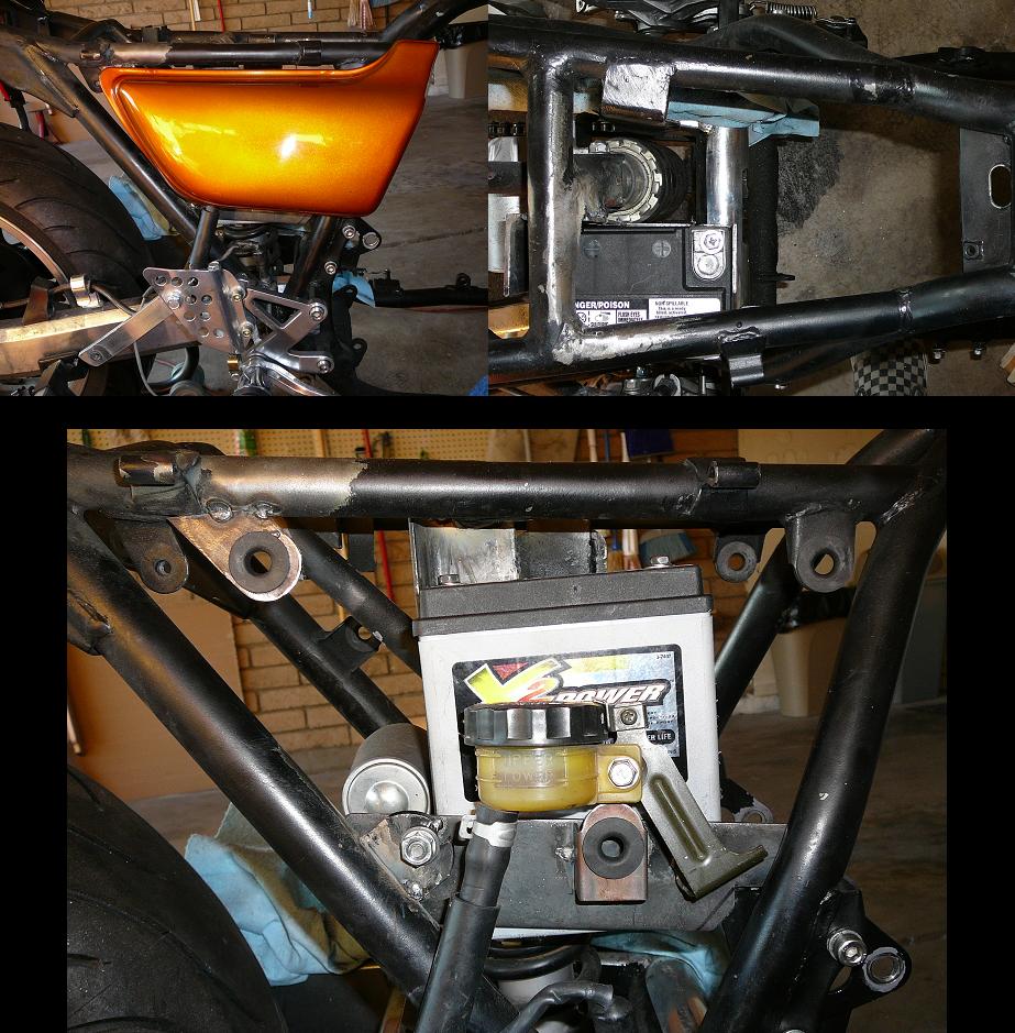

New Battery cage (exits out right side) leaving plenty of new tool storage space soon to come.
OMR

Way to go Watson :woohoo: Now the bike is going to lean to the right :ohmy:
Just kidding....looks good bud :kiss:

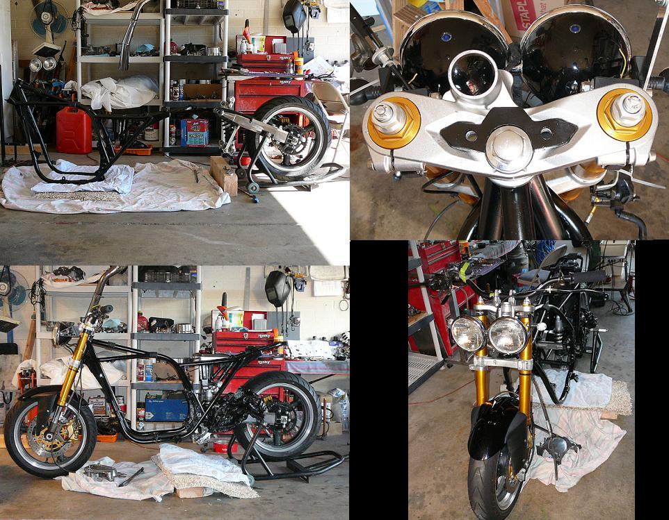

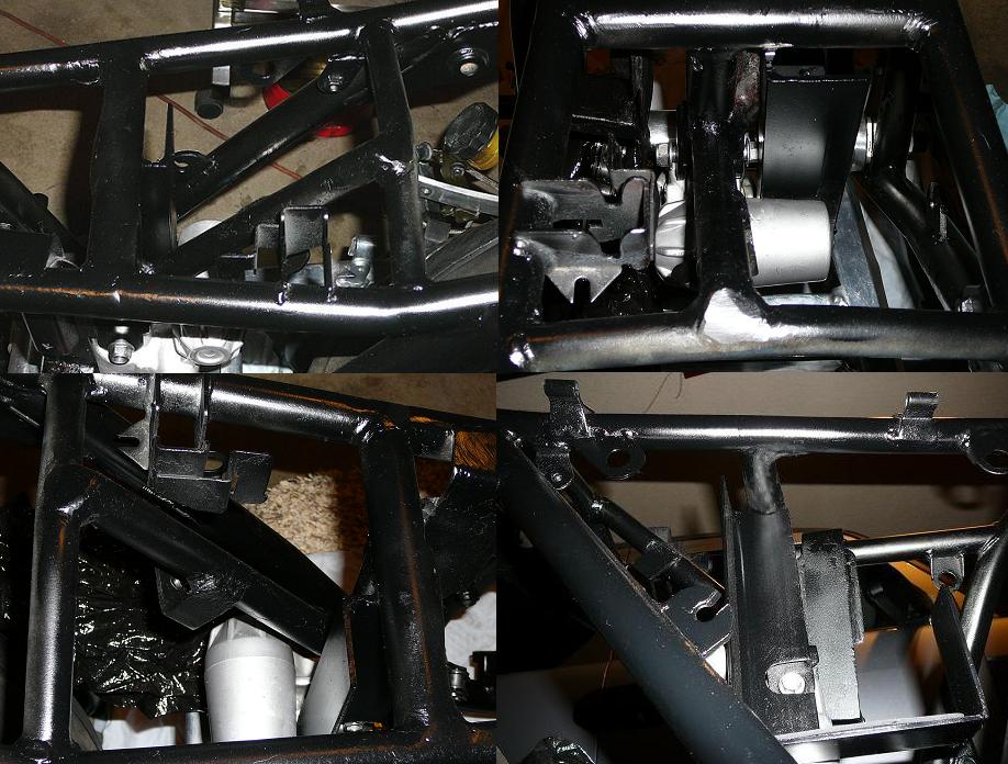

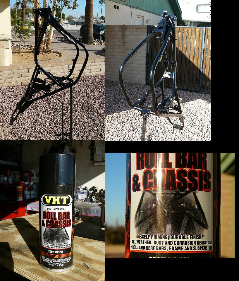

Just a little update....

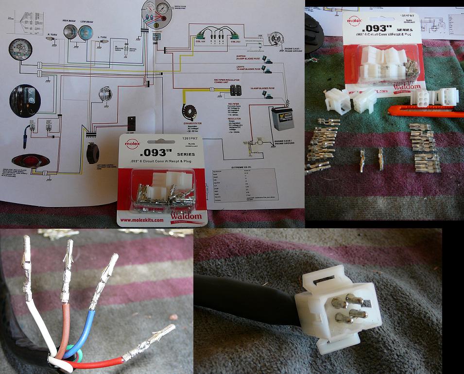

Fab work all complete, frame stripped and painted, putting back together and started working on the electrical panel & harness....
NOTE: Found this VHT Rollbar and chassis paint... Self Priming to boot! :woohoo:
So far all good, paint has held up well with 7 days cure time. Hit it with a screw straight driver no chip...
More to follow in the next couple days...

I picked up some of that VHT Chassis & Rollbar paint last summer to do my frame with. I've been worried about the 250 F degree rating though. Think it'll stand up to the engine and exhaust temps?
1983 kz440 ltd
Quack
Quack
- Old Man Rock
- Posts: 6071
- Thanks: 225
Re: OMR: '76 KZ900 Restoration/Modification
05 Jan 2012 10:12 - 05 Jan 2012 10:15

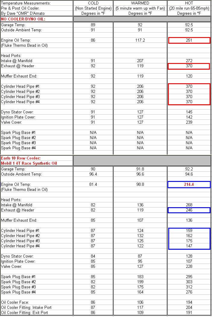

Should be fine as can be reviewed Pre & Post Oil cooler temps measurements.
NOTE: This is Arizona measurements where summer temps reach 115F plus. :pinch:
If it does become an issue, then back to Duplicolor wheel base & touch up over the trouble spots for this stuff held up with no heat related "Bubbling" issues at all...
That's the beauty of paint over powder coating, touch up where & when required... All good!

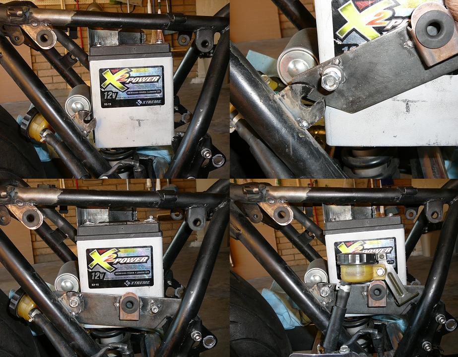

i noticed it looks like you added a support bar from the back to the t bar mount for the shock. i didnt catch that earlier i was thinking i might need it on mine.
did you mount it to the curved bar? or does it just look like it from the pic's?

Thanks man I've been thinking I need to do that but didnt realize you already figured that out. your PDF file saved me hours, thanks again.
