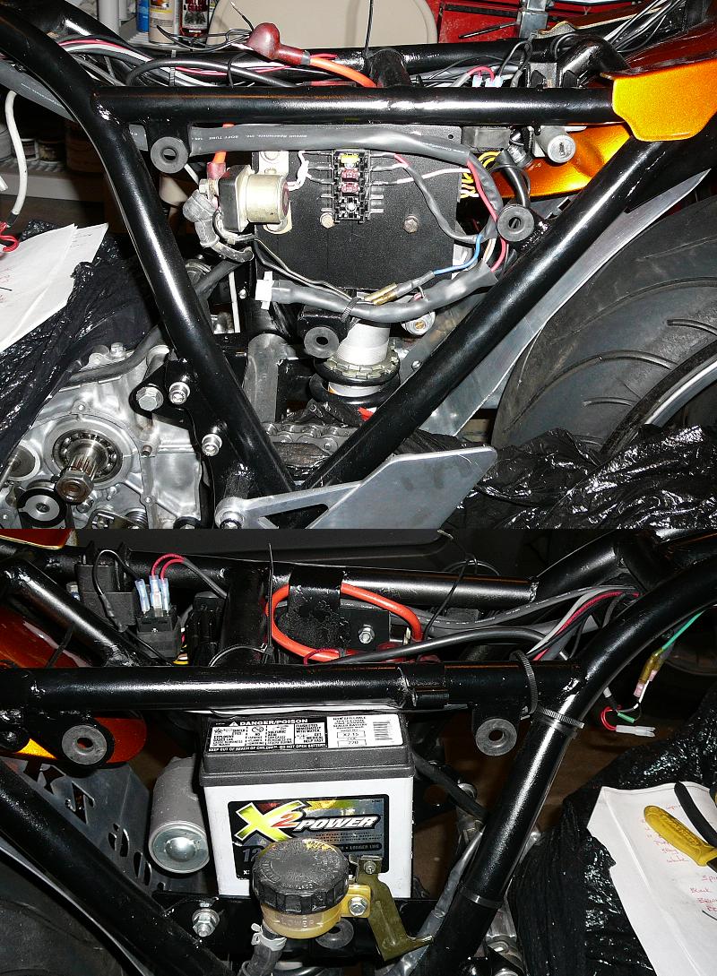

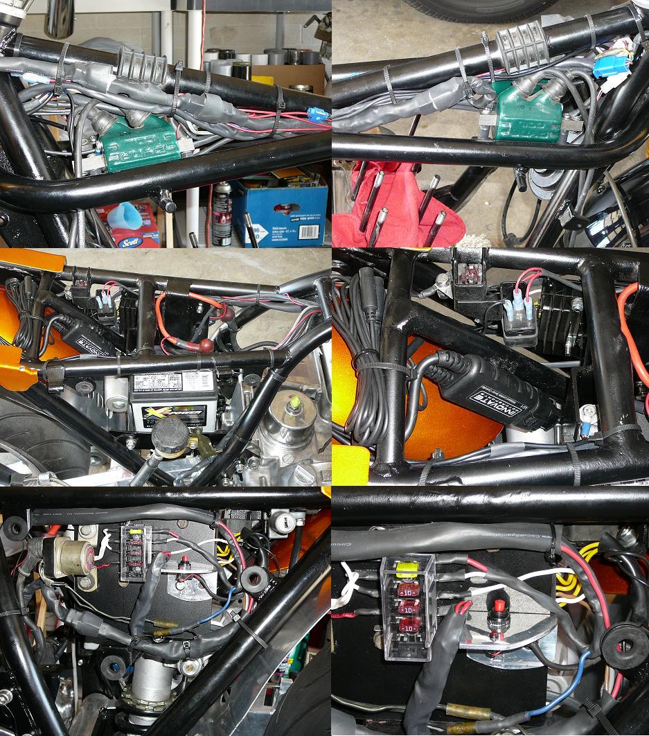

Electrical Harness and Panel complete with AF/R calibration switch/LED...

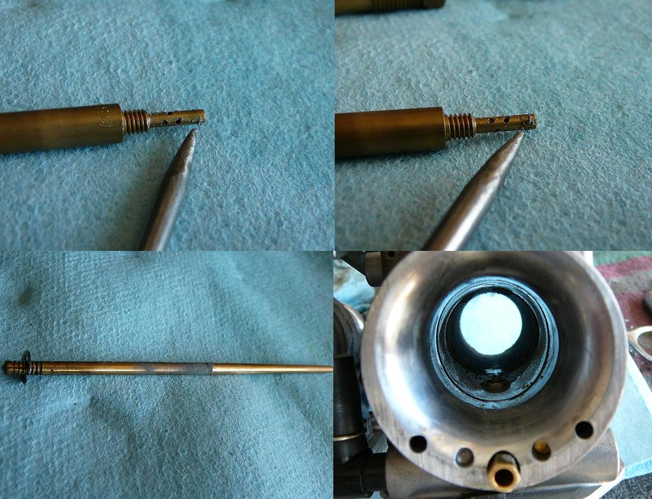

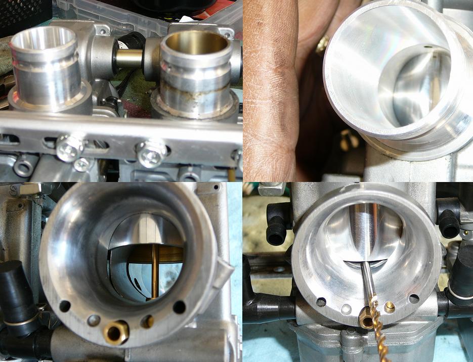

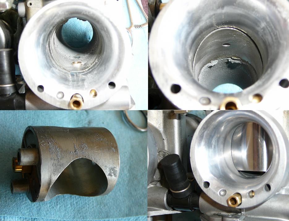

Carb clean... Aluminum in #4... Nasty... :pinch:

Wow, it's hard to fathom that the aluminum bits puked up all the way to the carburetor. Is that air filter hosed as well?

Do what you like. If it were me, I'd replace the needle, pilot and quite possibly the needle jet in #4 carb.

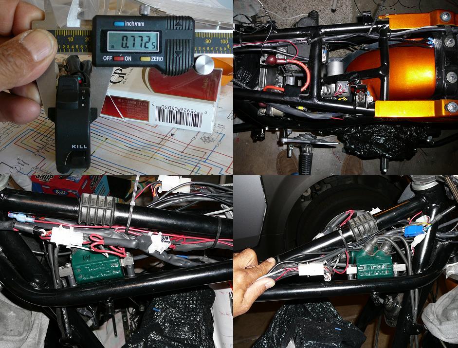

27 Feb 2012 10:52Old Man Rock wrote: Back to subject matter....
Wiring panel & harness... Still have some final heat shrink tubing and tie wraps to complete but not until all electrical/running up to specs.... Later... Basic electrical operations such as Headlights, speedo/tach indicators, horn, turn signals w/LED relay, tail lights, break lights all operational.
Left handle bar switch is interesting concept.... :blink: :woohoo:
Switch to "H"... = Left Turn
Switch to "L"... = Right Turn
Kill... = Horn
Are you sure those handle bars don't require a .77295" width kill switch housing :silly:
Larry C.

i have poured a piston out of an air cleaner before myself :pinch: .

I got a valve head out a pod filter.

27 Feb 2012 17:40les holt wrote: I got a valve head out a pod filter.
les
THAT is a one in a gazillion..... :laugh:

27 Feb 2012 19:00 - 27 Feb 2012 19:01les holt wrote: I got a valve head out a pod filter.
les
holy crap man :woohoo: !
talk about dang ol' if it don't fit force it man :pinch: :evil: .
i knew it was bad when i pulled the drain plug and one third of an oil control ring came out :sick: .

That was a bad day all the way around! LONG way from home, missed a shift. I rode that thing almost 100 mile before it let totally go and I was pushing it hard. I knew I wasnt going to save much if anything so I stayed in it.
I run rev limiters and good springs now, WAY cheaper. :laugh:

Wow Dave. Been away a few months and this is what I come back to. What a mess.

27 Feb 2012 22:54Old Man Rock wrote: Back to subject matter....
Kill... = Horn
Imagine that....same measurement

In the photo, is that metal particles on a pilot jet?
If so, wondering how the particles got to that location.
