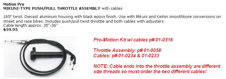

24 Mar 2012 15:57
Hey Davey. Wake up
have a question for u bro.
when u switch to the new throttle, does the new throttle have 1 hole the same size as the kz throttle cable, and 1 larger hole? if so what is the solution for the cables? i have some modern switches that have cable holes like this.i could use 1 if i had a cable solution.
r u still going with this 1?

- Old Man Rock
- Posts: 6073
- Thanks: 225
Re: OMR: '76 KZ900 Restoration/Modification
24 Mar 2012 22:49 - 27 Jul 2012 20:32
Marky... suppose to be the same size but I haven't really confirmed yet... DOH! :pinch:
i'LL LET YOU KNOW SOON...
-6AN on the cooler adapters is what you want... I screwed up when ordering -8an and that is why I have the "Blue" reducers..
Here you go Marky....
