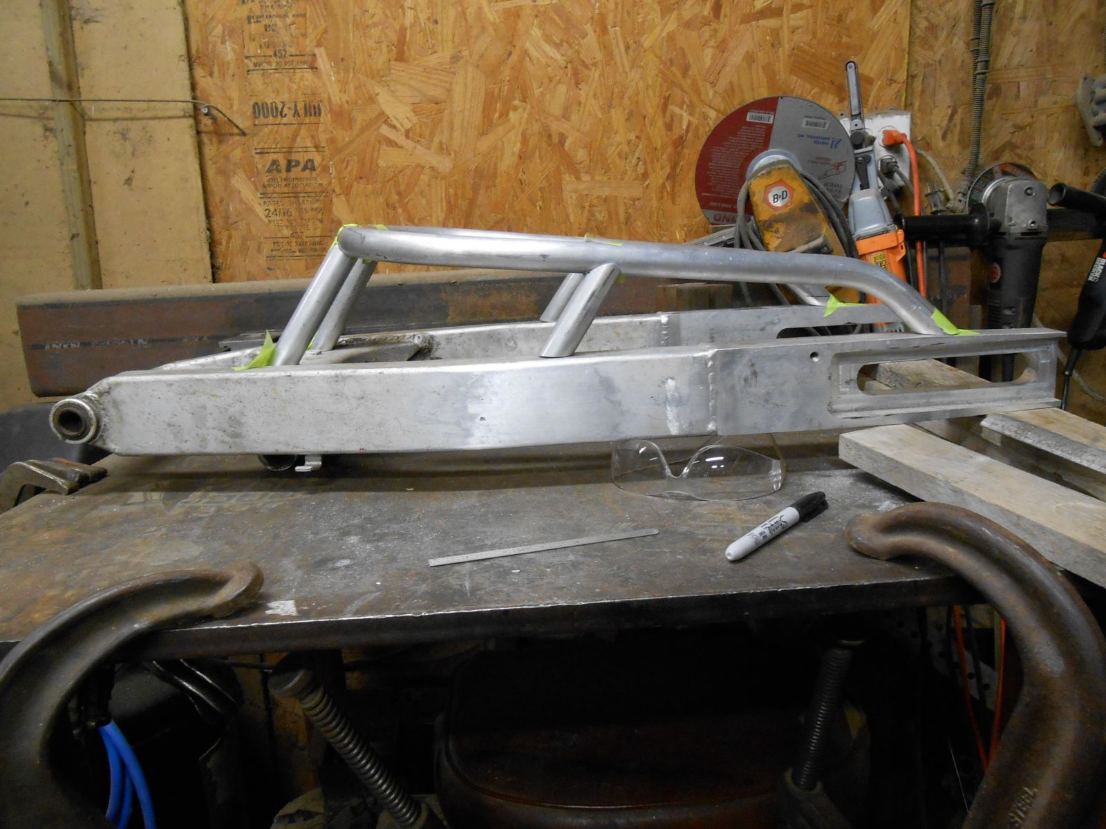

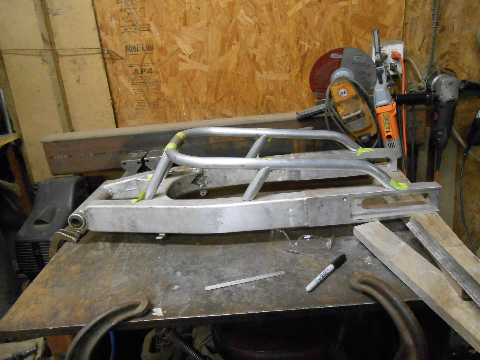

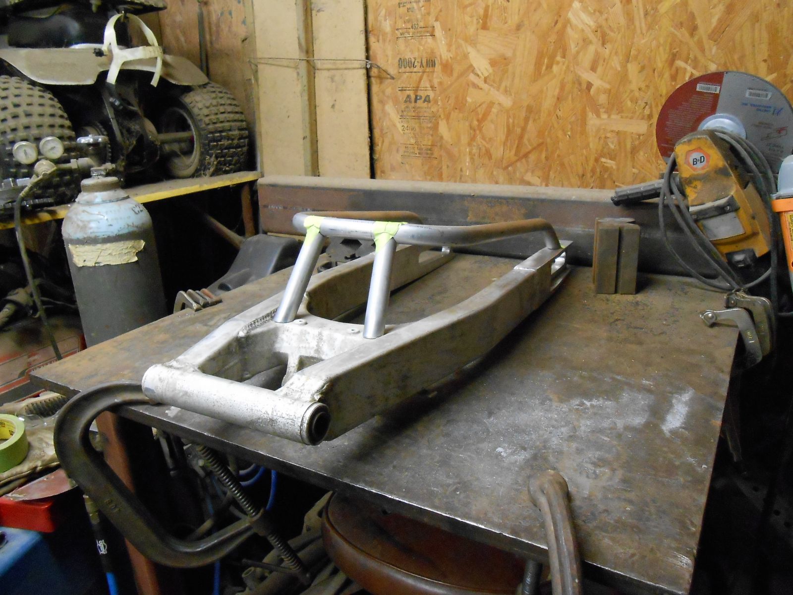

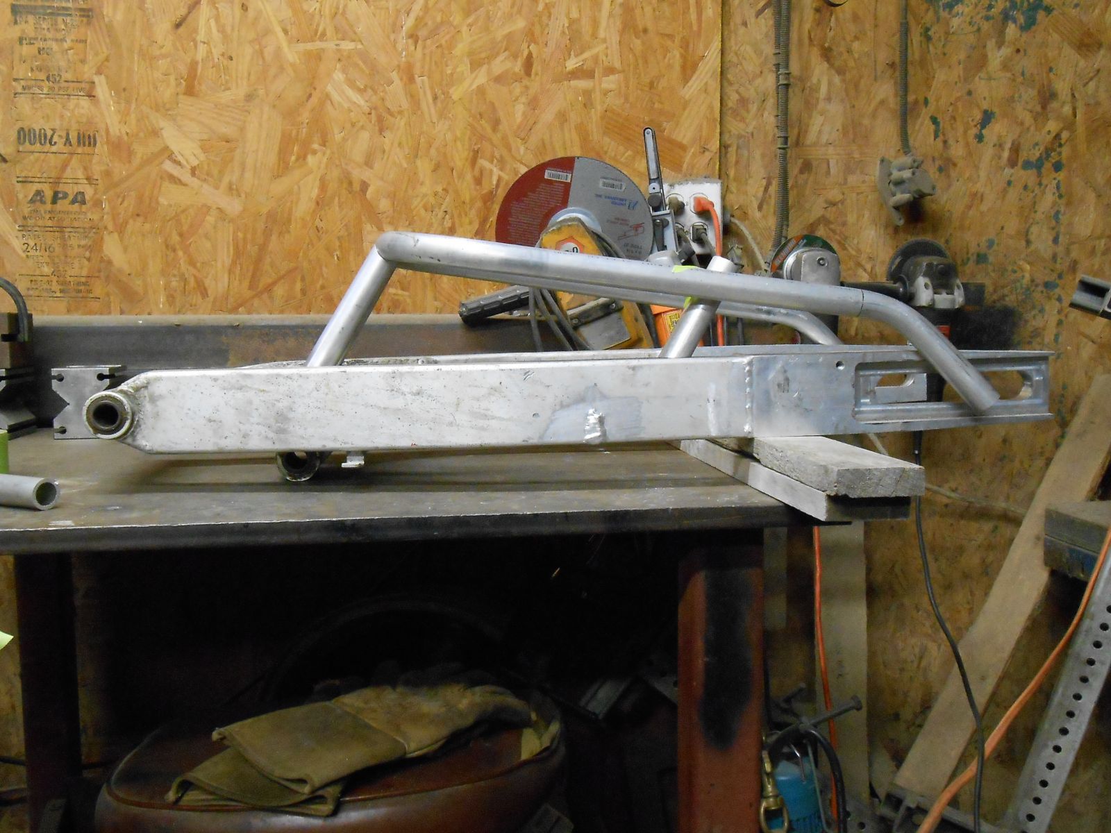

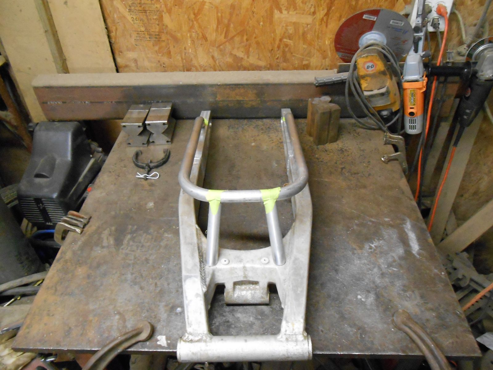

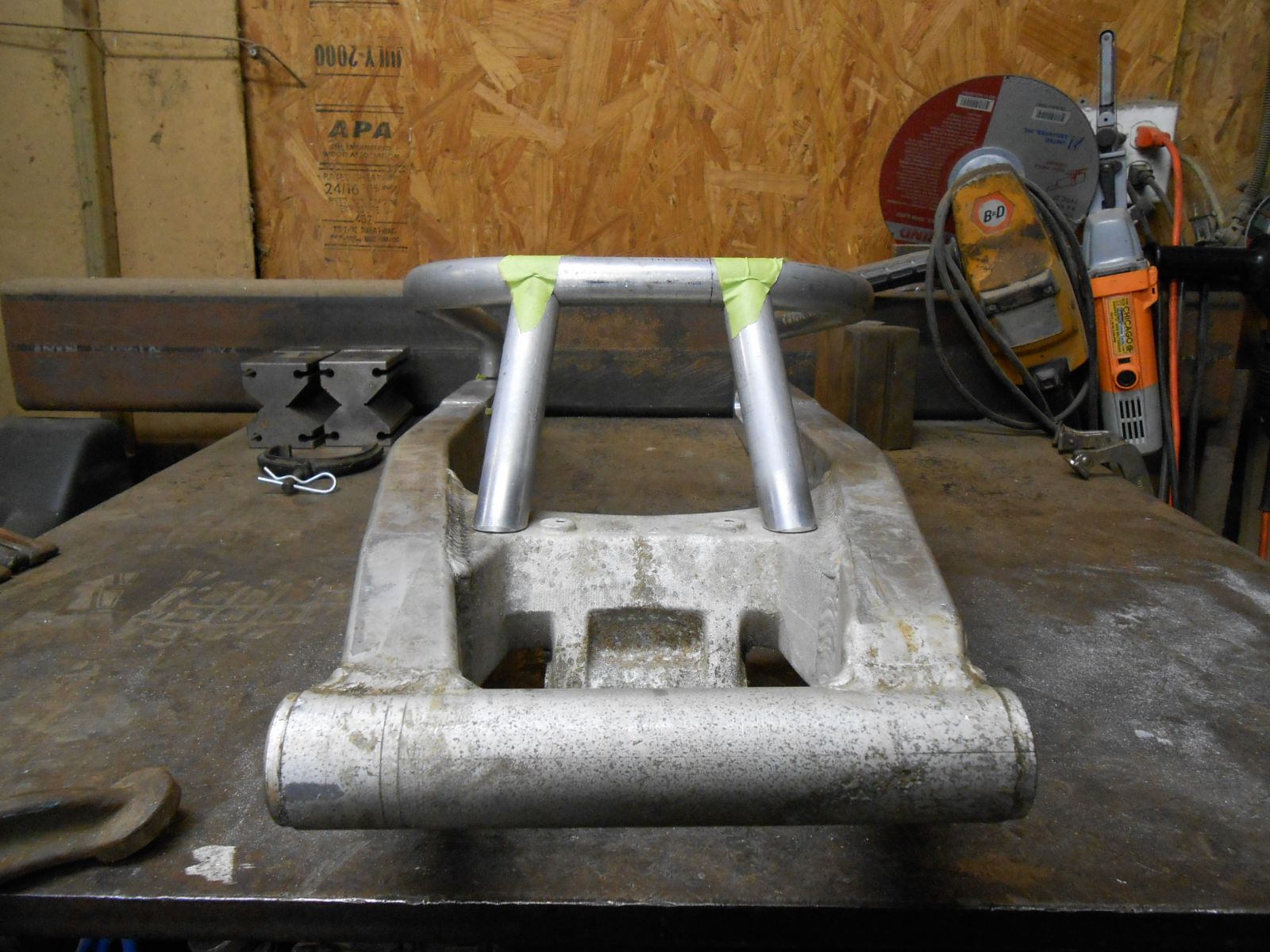

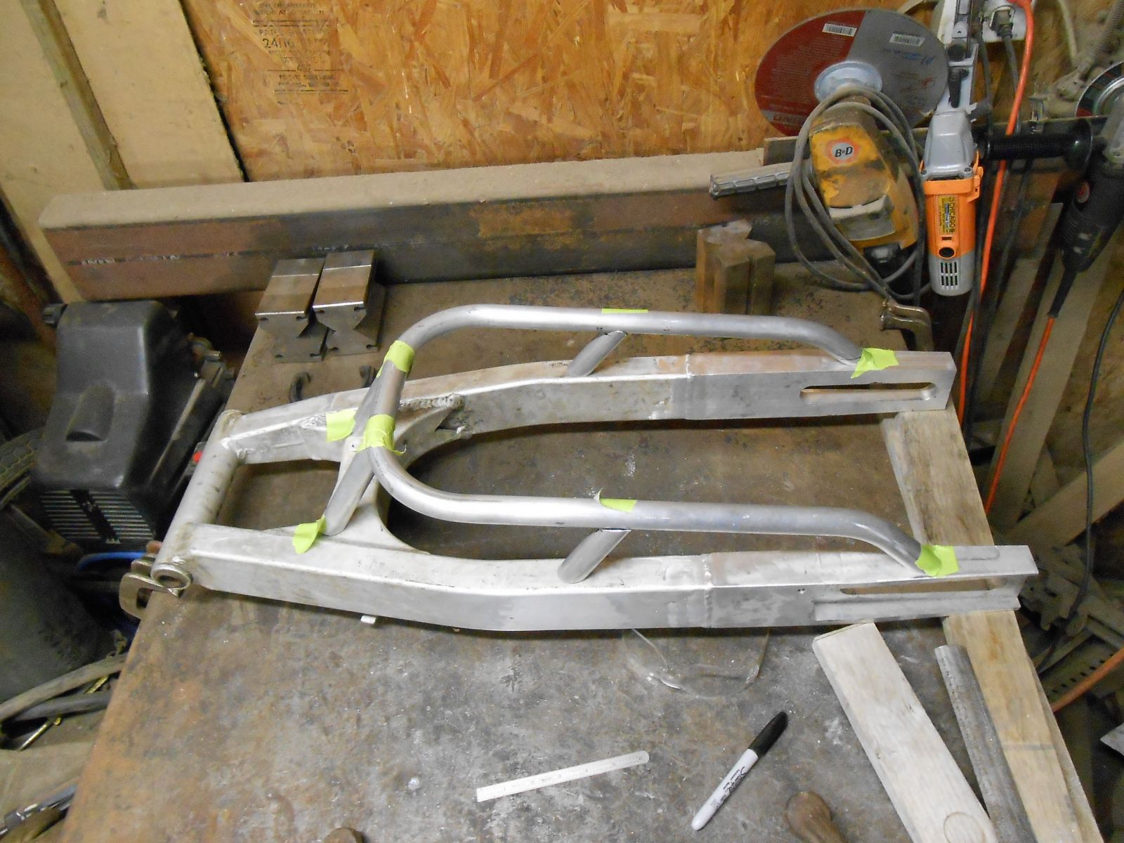

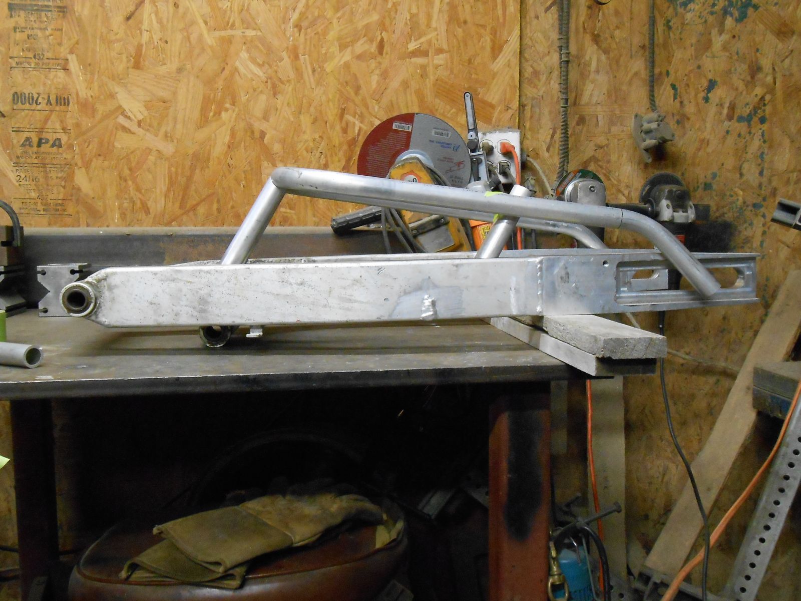

finally got some pure un-interrupted shop time,to get dougs swingarm closer to finished.
it is amazing how many different things can distract/steal your time completely from you :pinch: .
i was able to get the tubing for the braces cut to length and four of them milled off at (depending on where you call 90)60/30 degrees.
which seemed to set the angle nicely.
i also used the mill and a hole saw to cope the tubing to fit where it intersected the brace.
i was wanting to get it all welded up :whistle: ,but everything i got done turned out well.
so i am satisfied,thanks for being patient doug
i'll be back at it tonight and i will post the pics of the progress tomorrow.

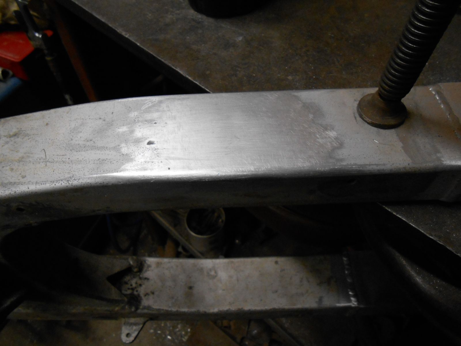

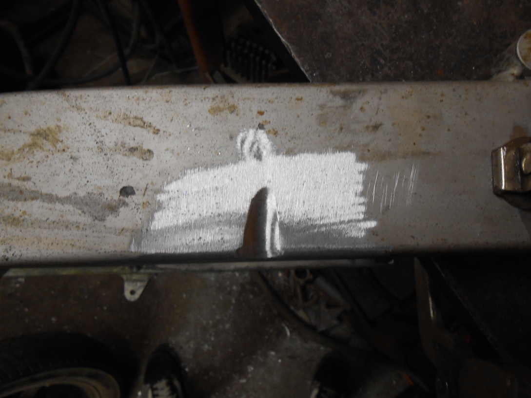

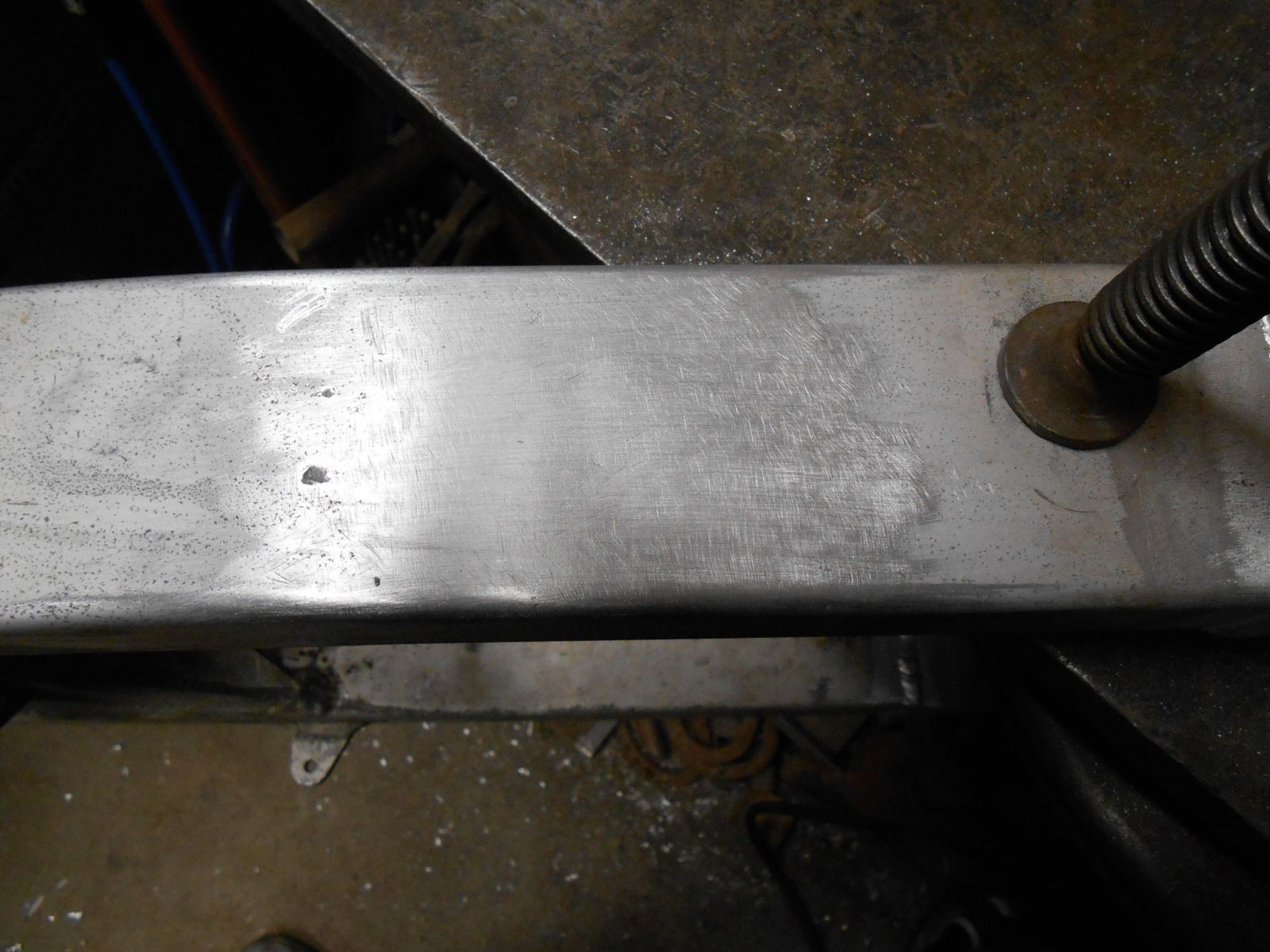

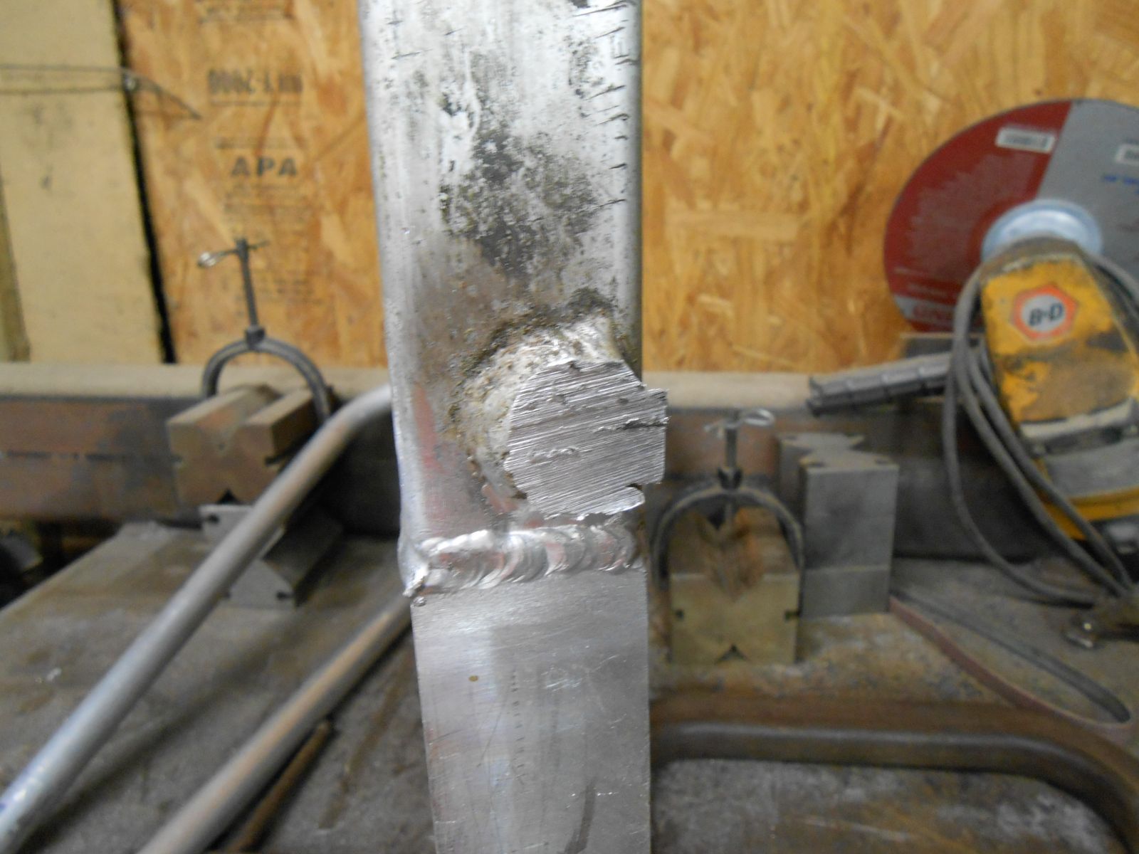

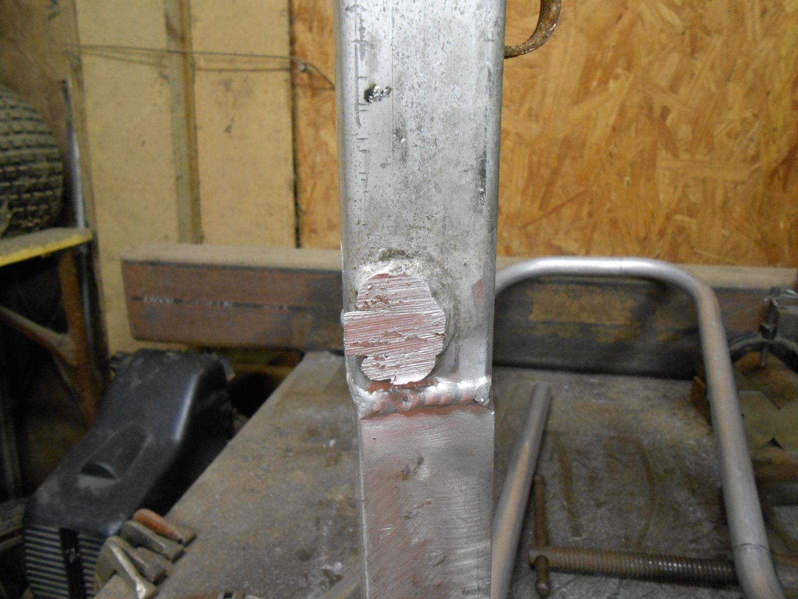

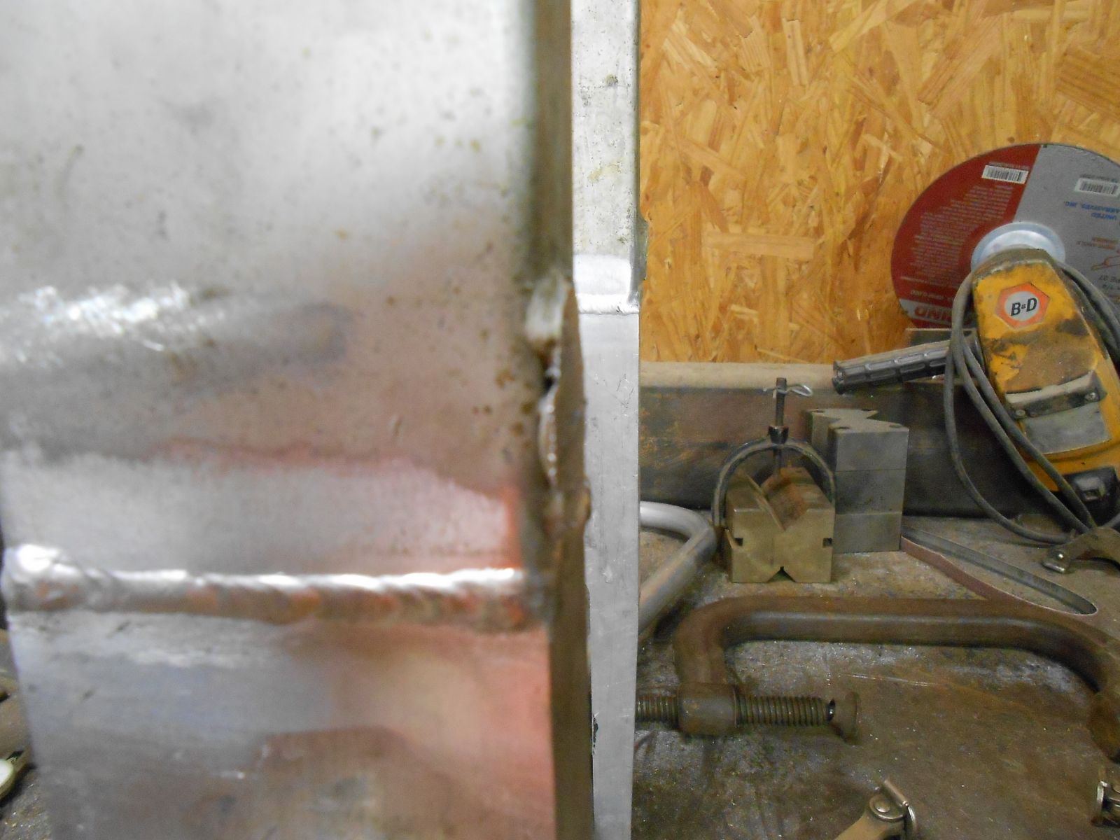

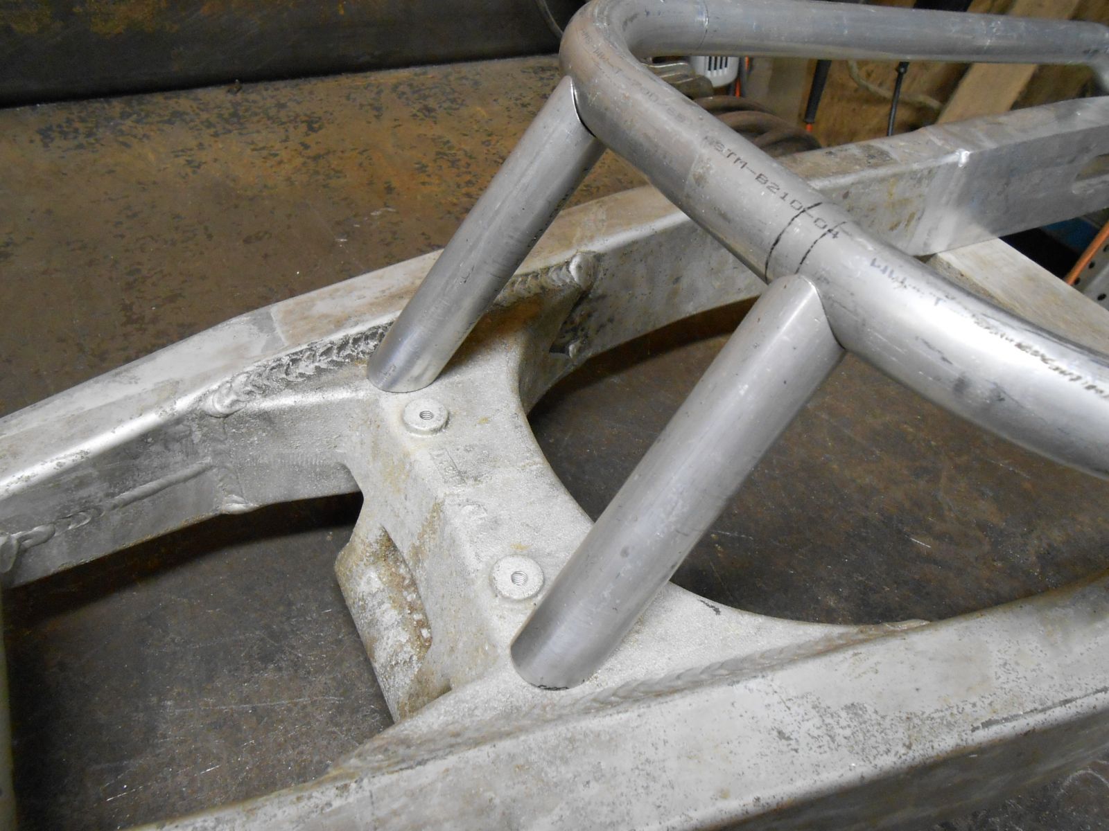

okay back at it last night.
remember this notch ?
and then the subsequent weld to fill it up?
here it is after metal finishing it out.
i'll be back at it tonight,hopefully with more exciting pictures
trying to make that heinous notch dis the f-(k appear was time consuming :pinch: .
grind,file,sand.it was worth it after i was done,and seeing the pics now

Very nice! I've been eyeballing one of those mini belt sanders for a while, might have to go pick one up.

04 Oct 2012 13:26Ederer wrote: Very nice! I've been eyeballing one of those mini belt sanders for a while, might have to go pick one up.
i have the electric one from h-f,it is pretty good.hard to find the replacement belts tho,and it has the plastic/rubber wear guide deals that the belt runs on and they wear quickly,i am planning to find something harder to replace mine with.
i haven't looked at the air powered one that h-f sells but you might eyeball them both and make your best choice.
they are not a dyna-file,but they don't cost three bills either.
if you don't push them hard they are good,but i get impatient and have found where to back off and let the tool work.
