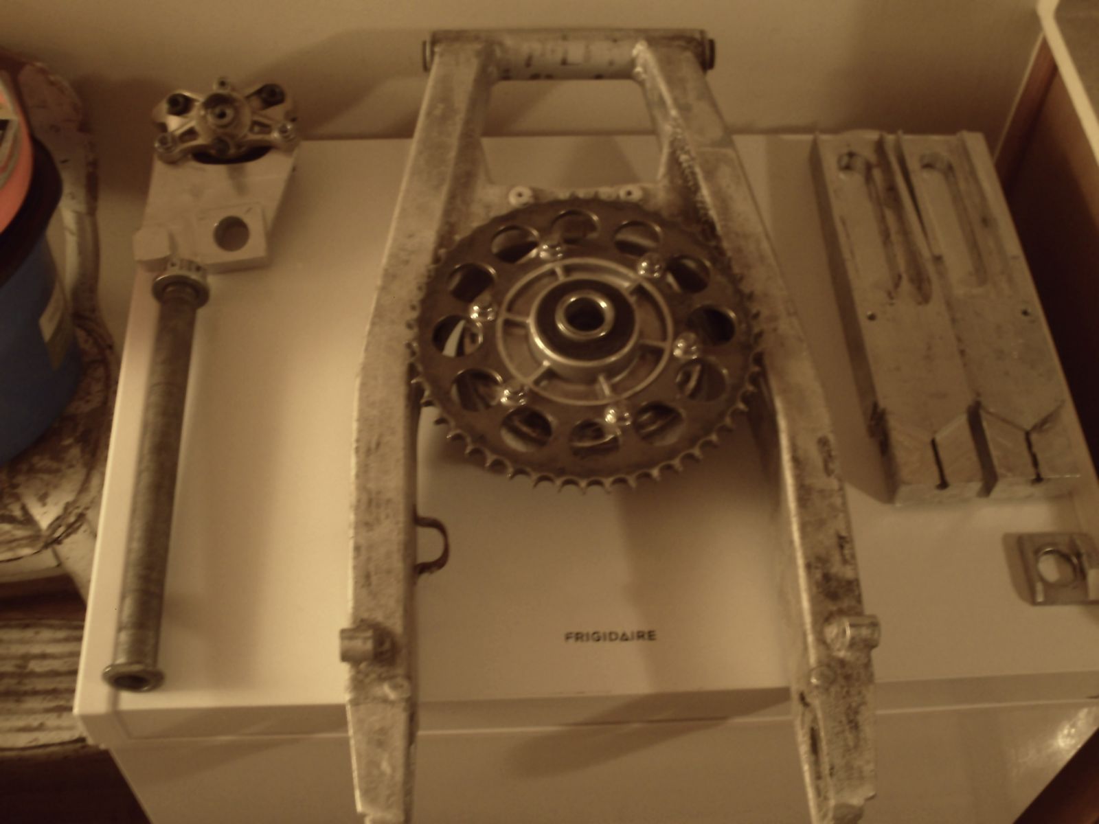

I do have a bit of an update. I managed to score a outboard bearing support for a heck of a deal from MTH76 (Mark). I couldn't help myself so I mocked it up real quick.
It appears that the chain run should clear the frame without too much but I need to do some more measurements to make sure.

it looks great. i'm putting mine on now too. i just sent mine out to have the clutch hole bored larger. this will allow me to run a hydraulic clutch.
i'm trying to come up with a dif rear mount , so i dont have to weld a threaded sleeve to the frame.

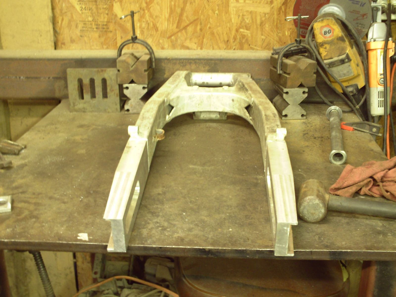

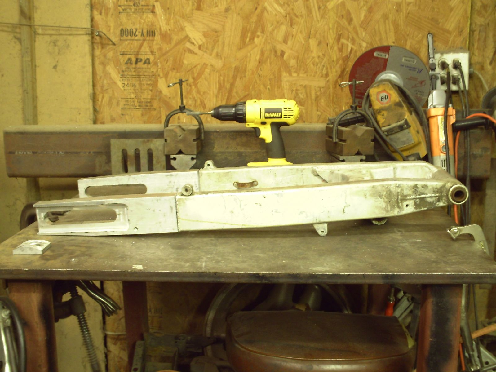

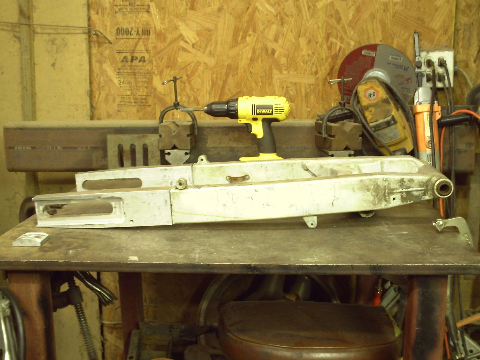

29 Aug 2012 12:56doug,
tapped me to extend and underbrace his gixxer arm that he is using for his project.
i am just in the preliminary stages,i have the original ends cut off the arm,and the extensions machined to fit inside the tubes.
i am also going to create an underbrace using 1" o.d. x .120 wall thickness 6061 seemless tubing.
here are some pics to whet your appetites :evil: .

here is the arm with the extensions mocked up.
more to come,
