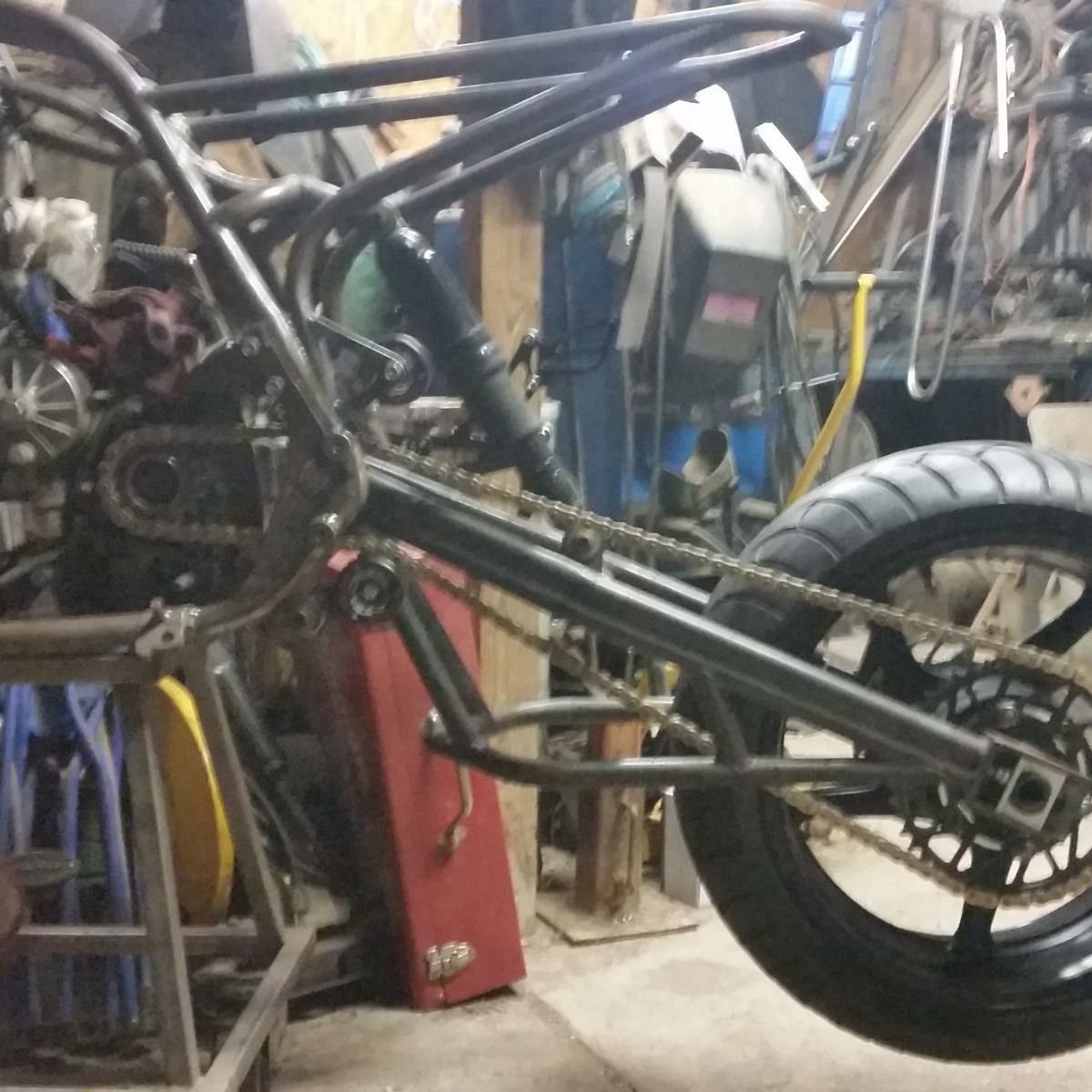

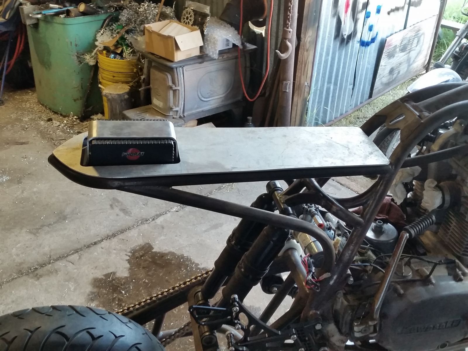

bluezbike,
turns out,

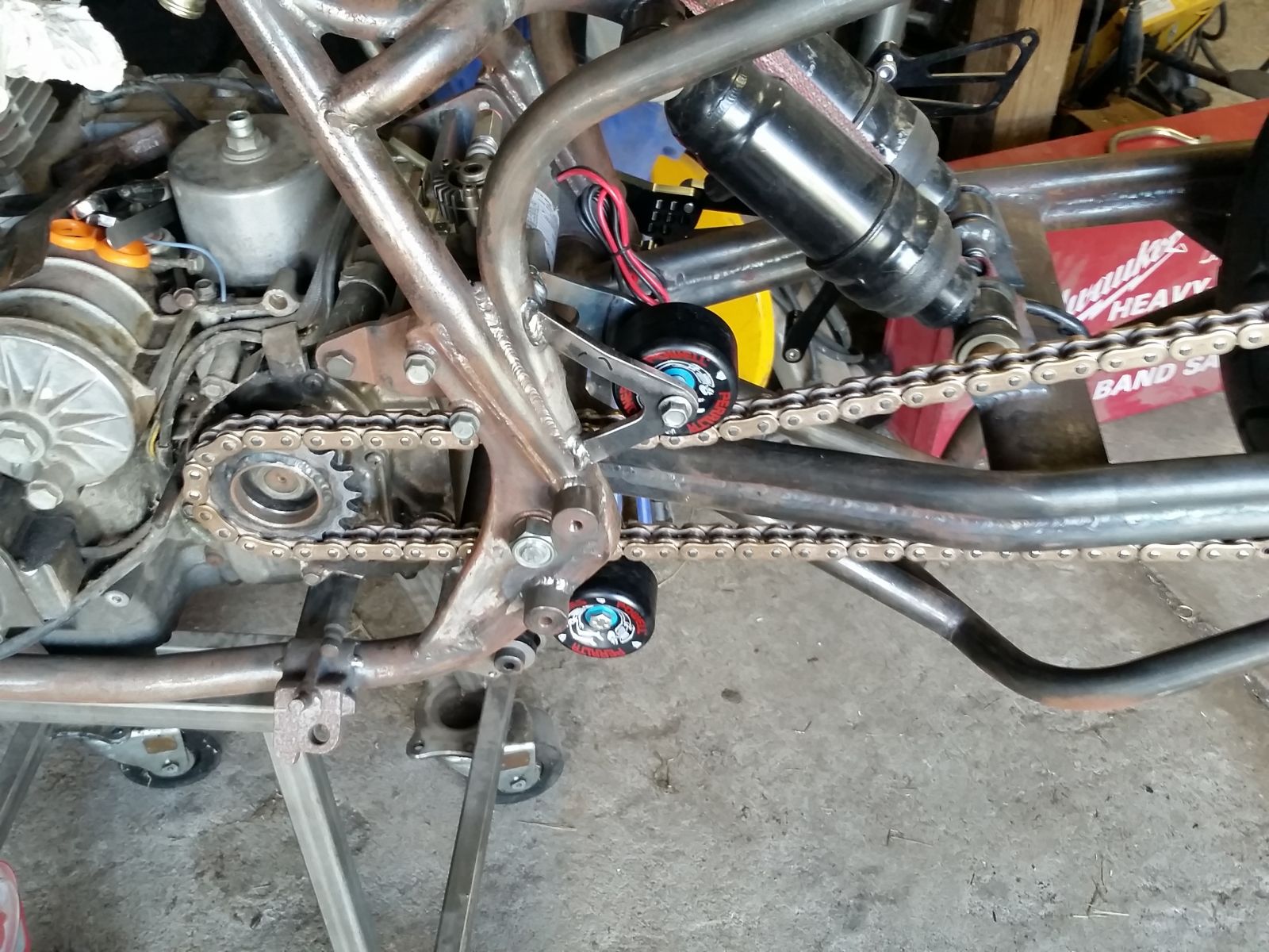

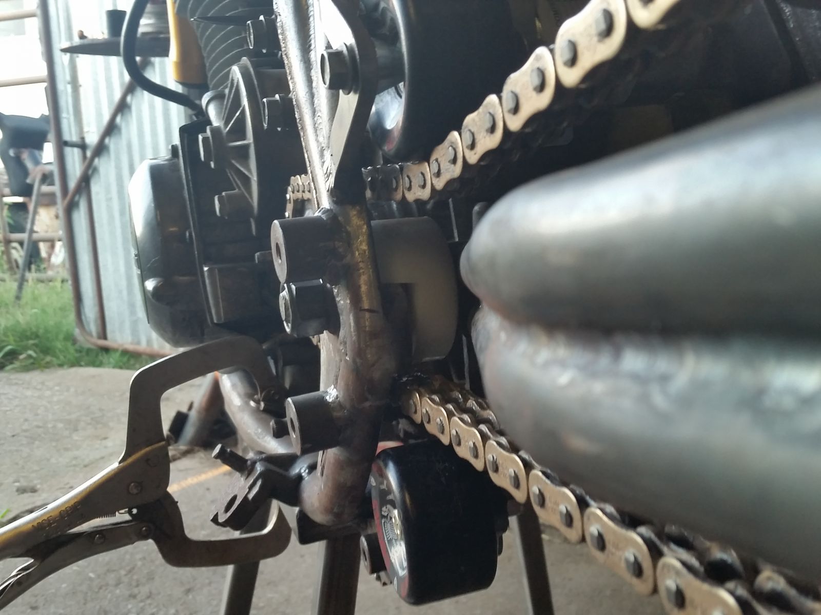

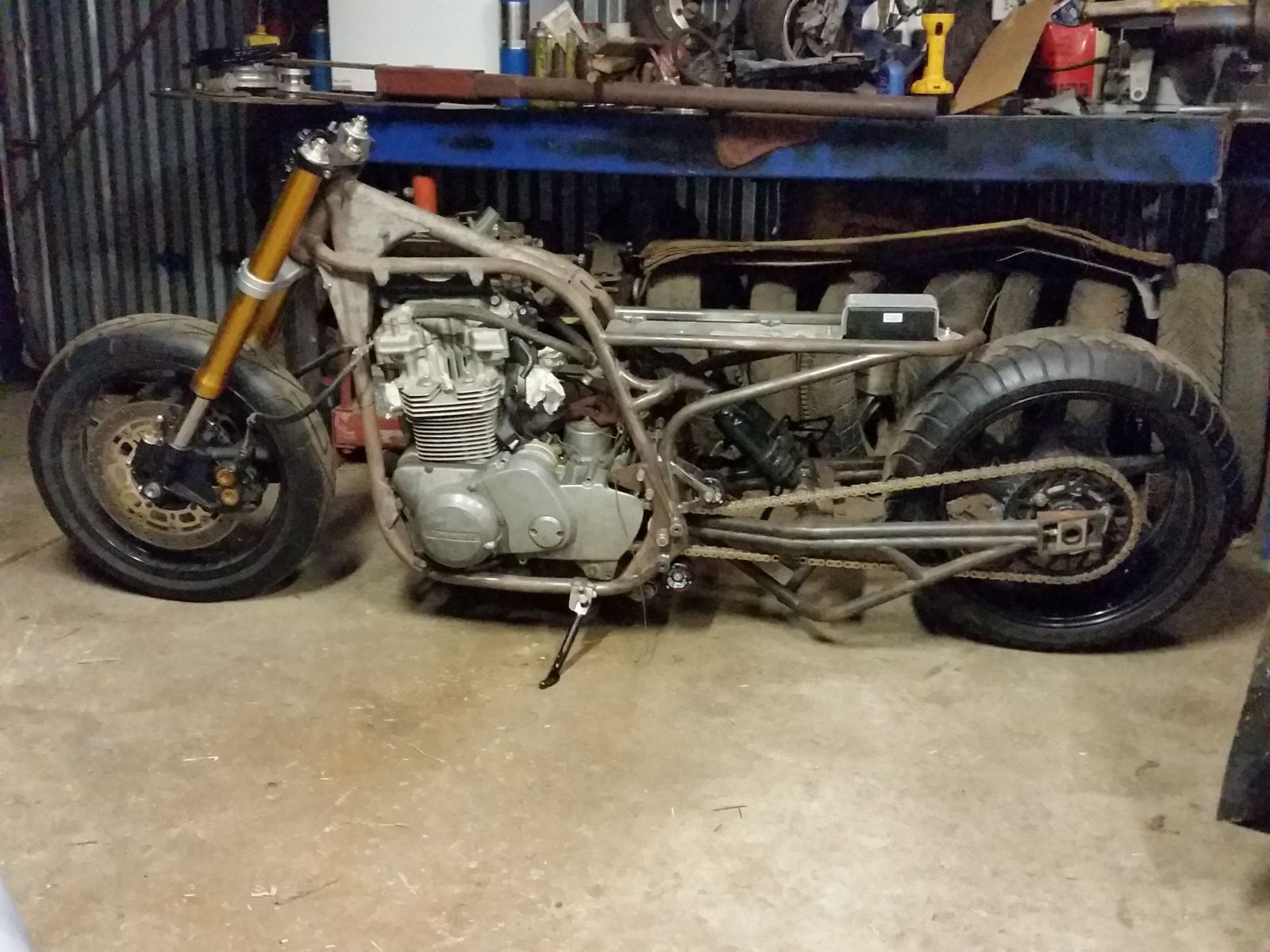

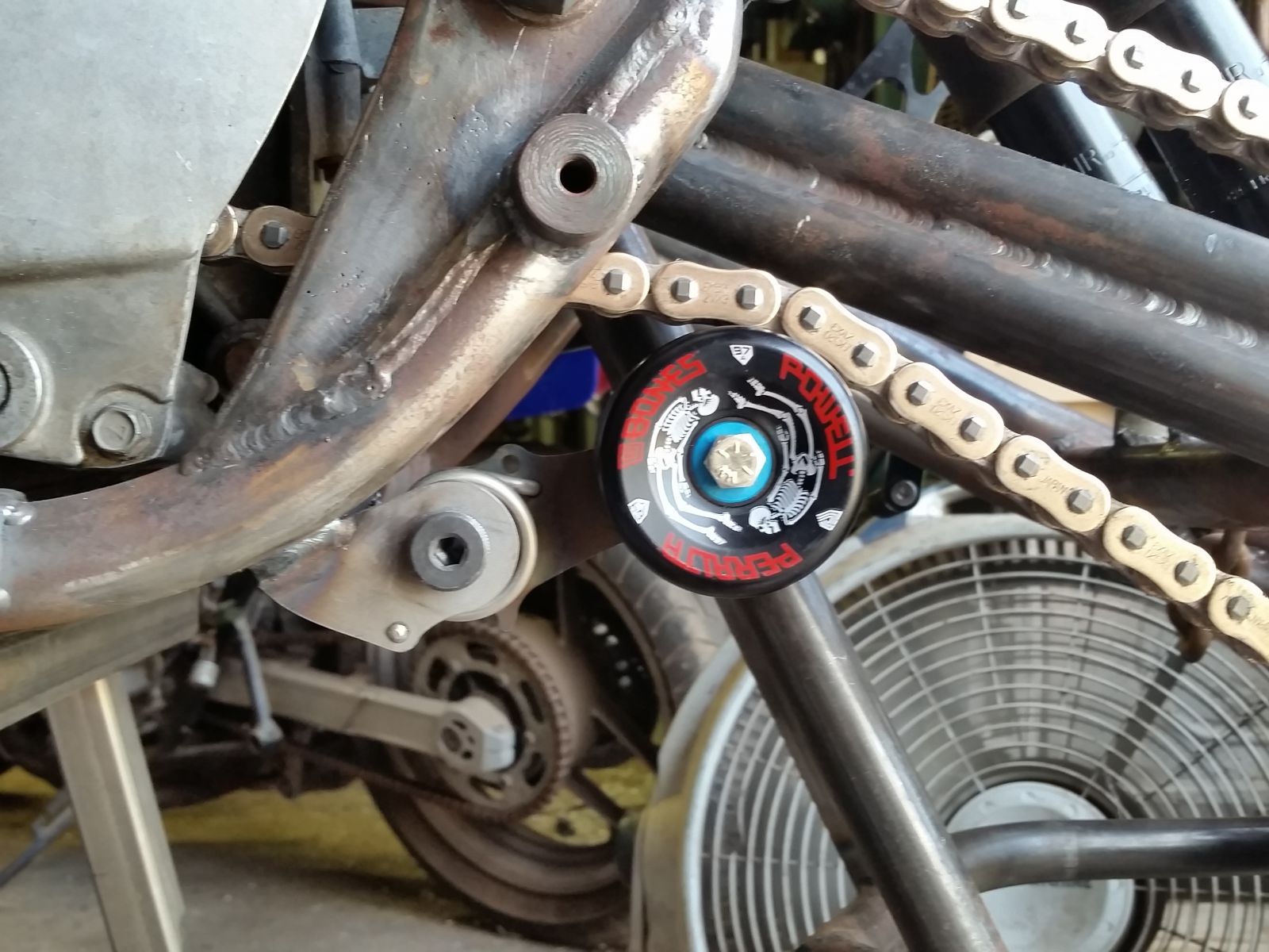

to be able to ride the bike slammed or jacked up we need some chain control.
i had to machine a plastic chain slider that slid over the pivot and extended into the frame notch.
i also purchased a www.monstercraftsman.com/powell-peralta-...-on-chain-tensioner/
which i used with a couple small mods,to control the lower chain run.
i also used a skateboard wheel to act as a solid mounted upper roller so that when the bike was slammed it rolls on it.

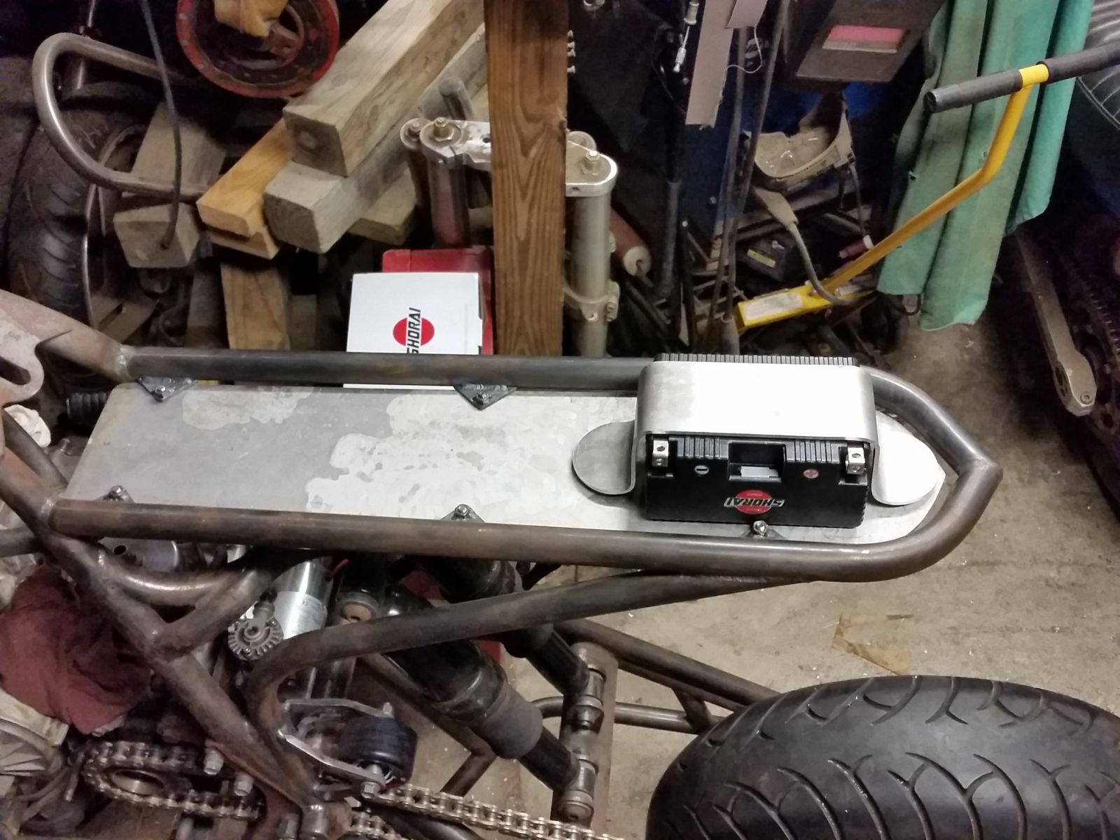

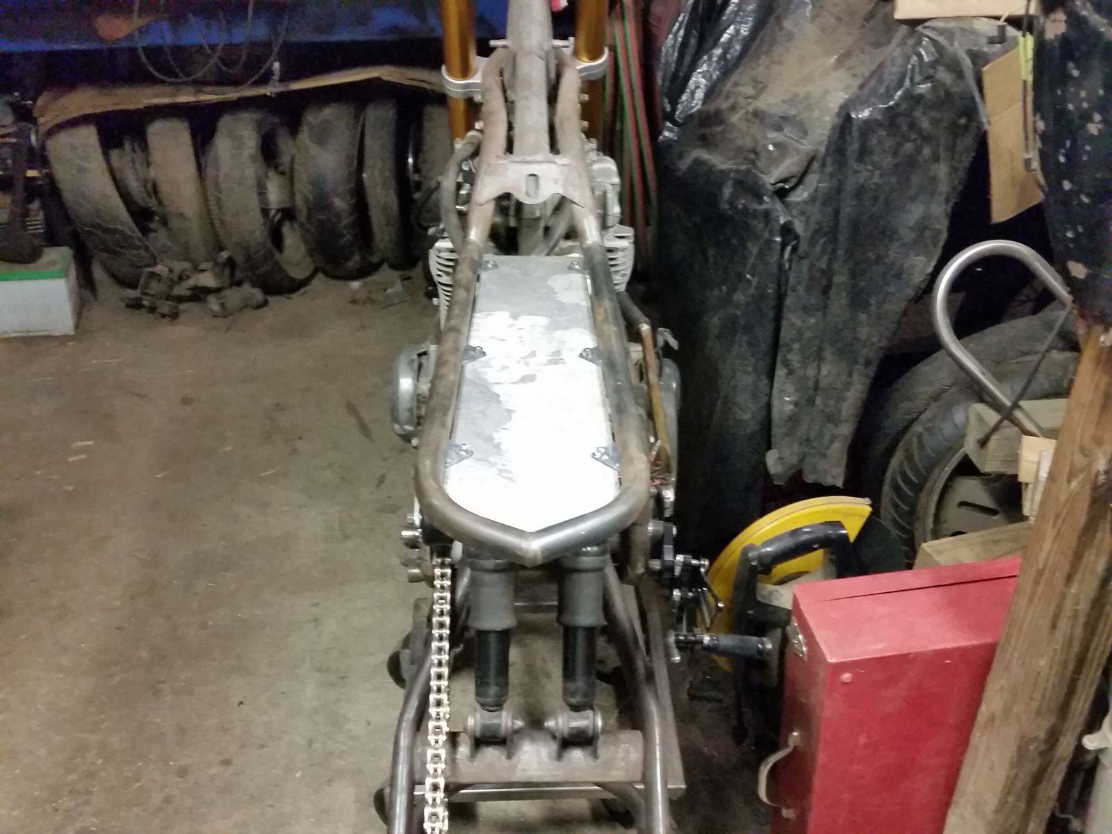

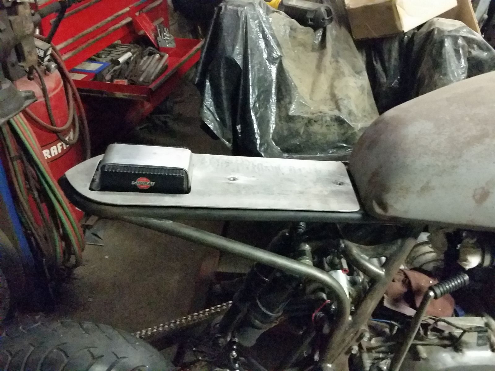

built and installed an electrical under tray to mount the battery and whatever else on.
and shaped the seat pan and got it fitted and mounted,

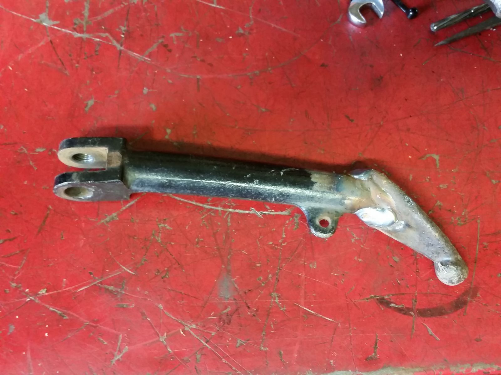

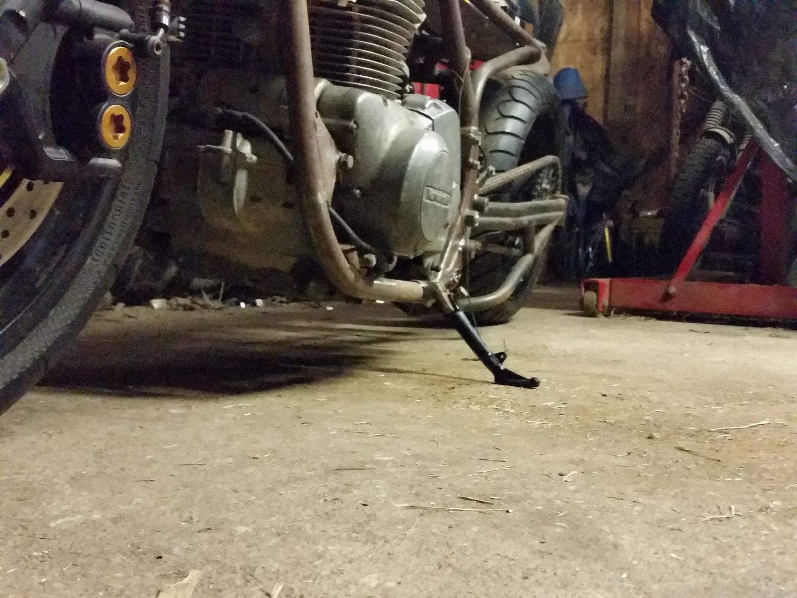

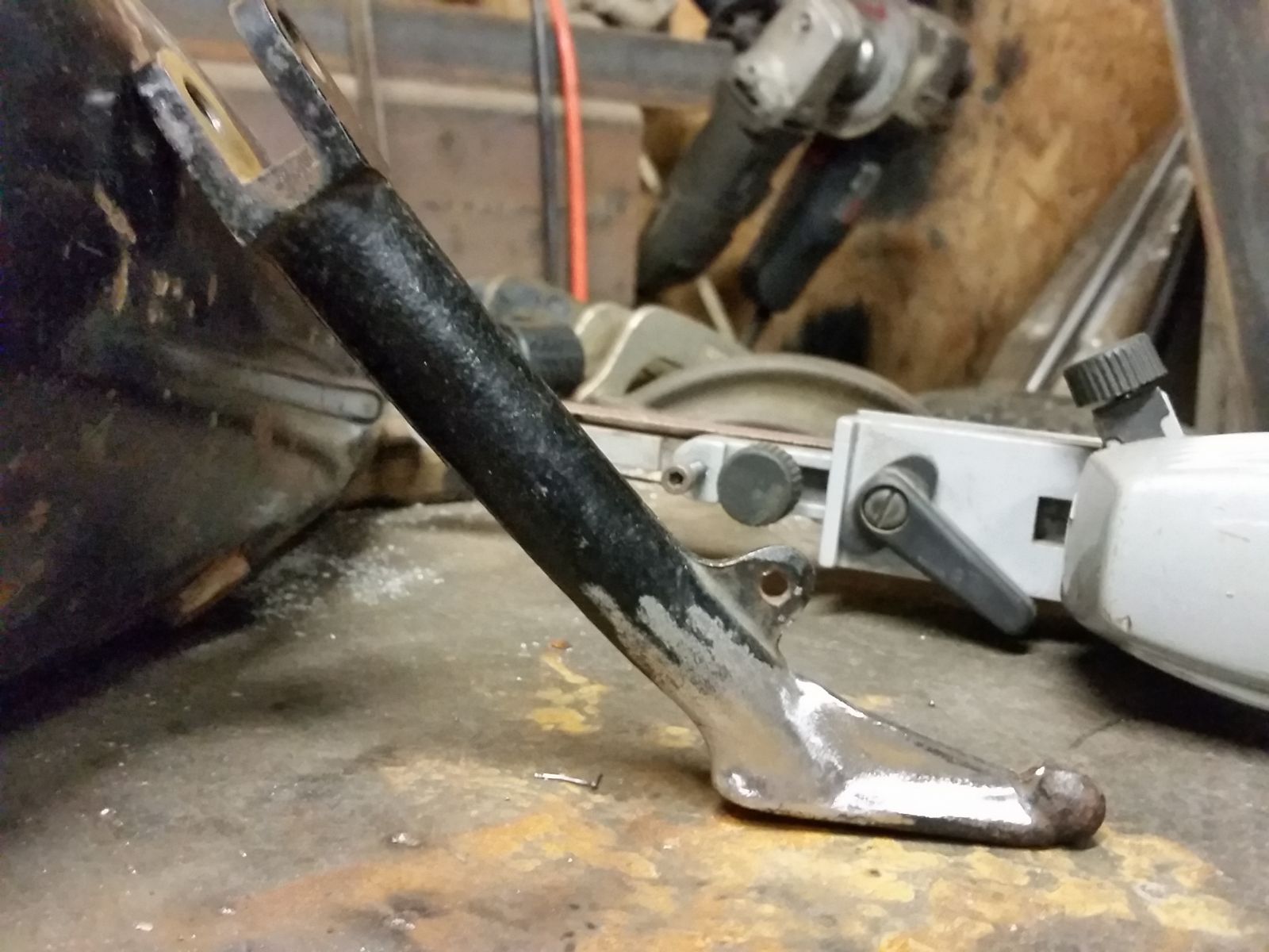

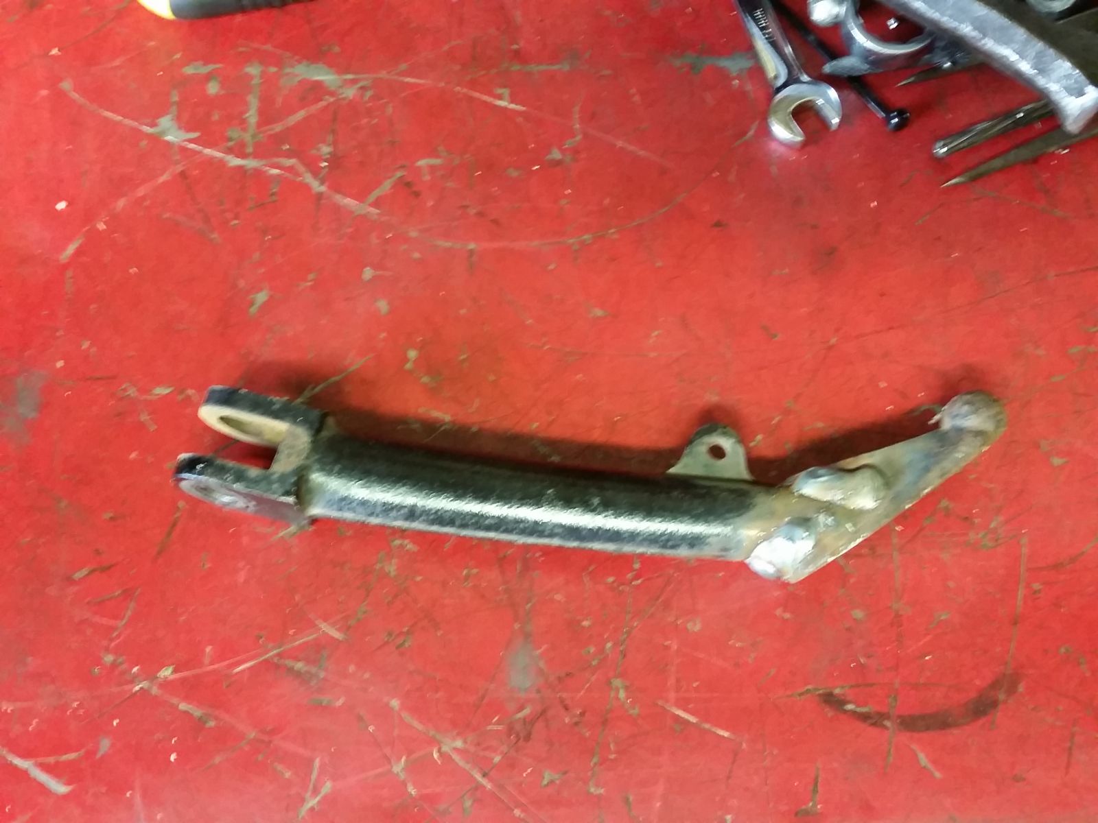

had to shorten the kickstand so when the bike was slammed it sat properly.

Outrageous work as always Leon.......riding that bike would make me dizzy though with all the permutations of ride height, but WOW, nice and clean. I especially like the inner plastic slider solution in the middle of the chain.
