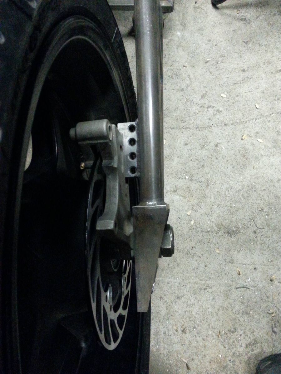

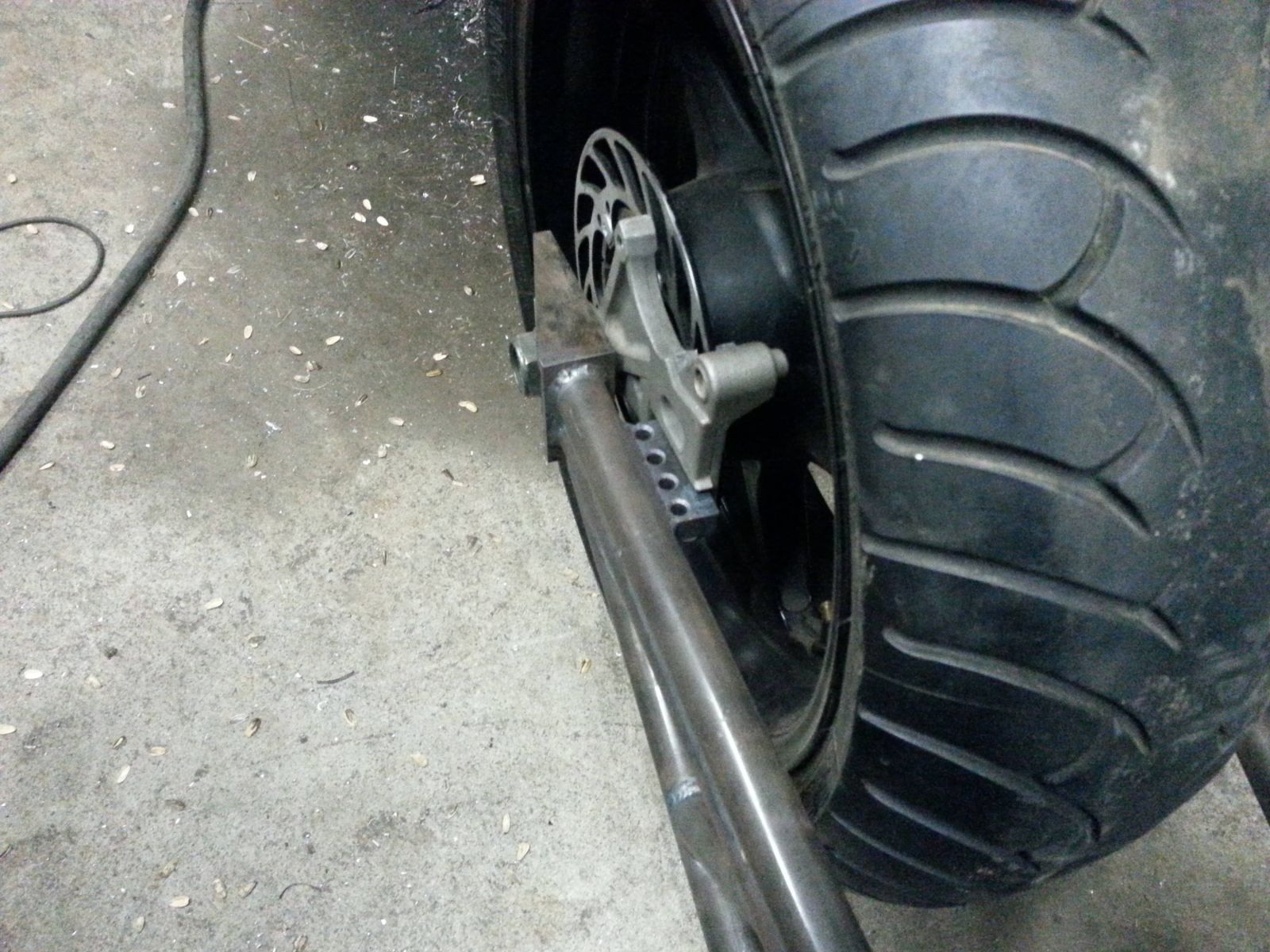

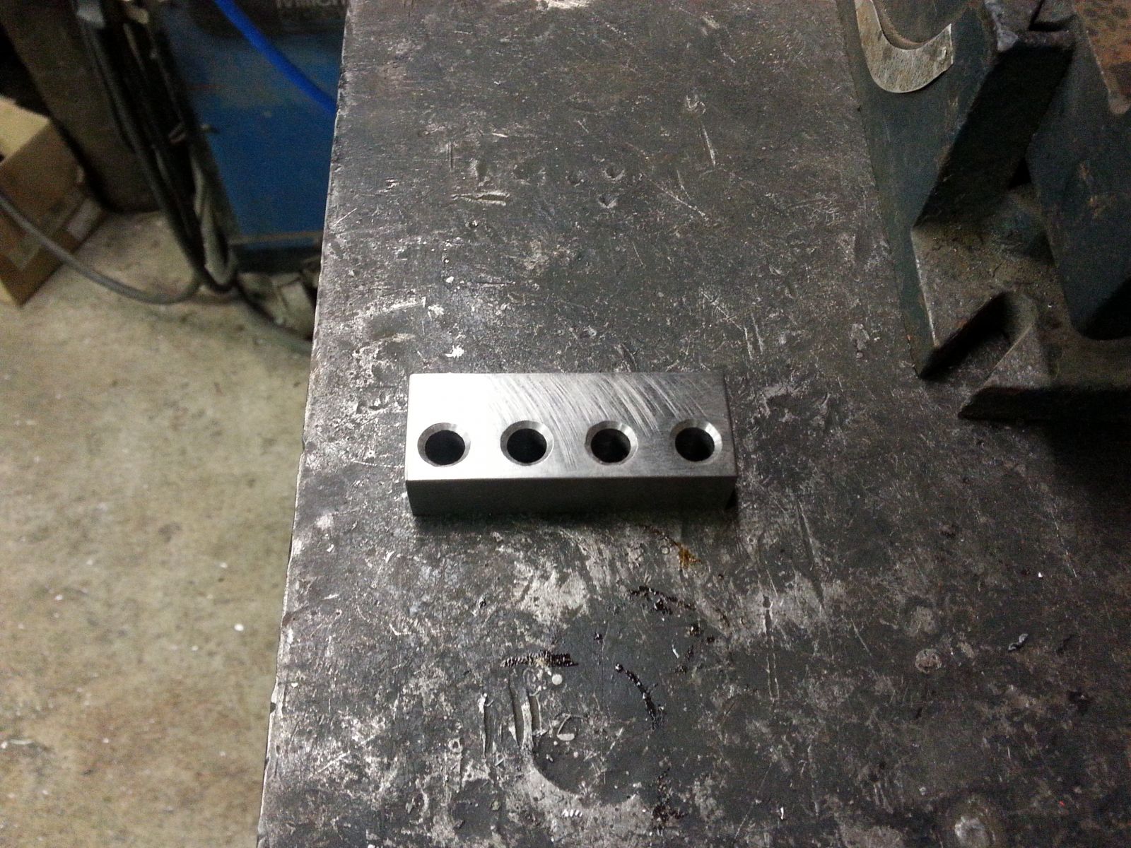

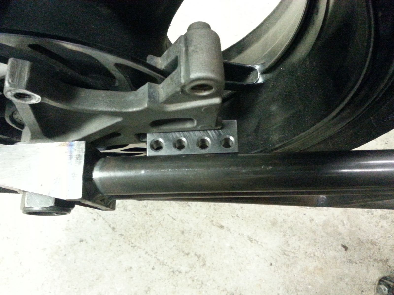

doug,
yessir just a slight amount of progress.
it doesn't look like much.
but when you band saw it out of a big chunk,mill it square,fit and mill to size then sand out (most)the machining mark and layout holes and drill and chamfer the holes it eats up some time :blush: .
but after it was welded in i was pretty satisfied with it.
