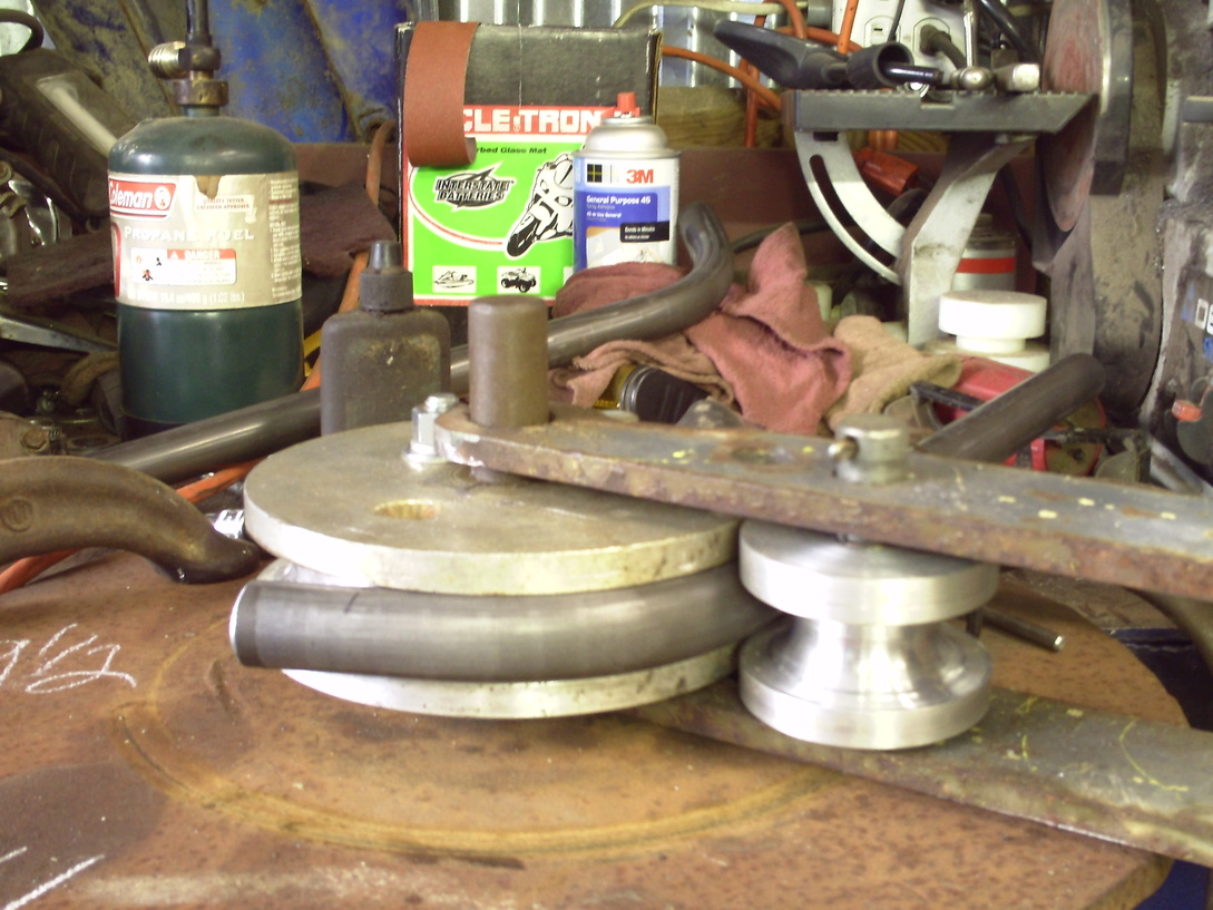

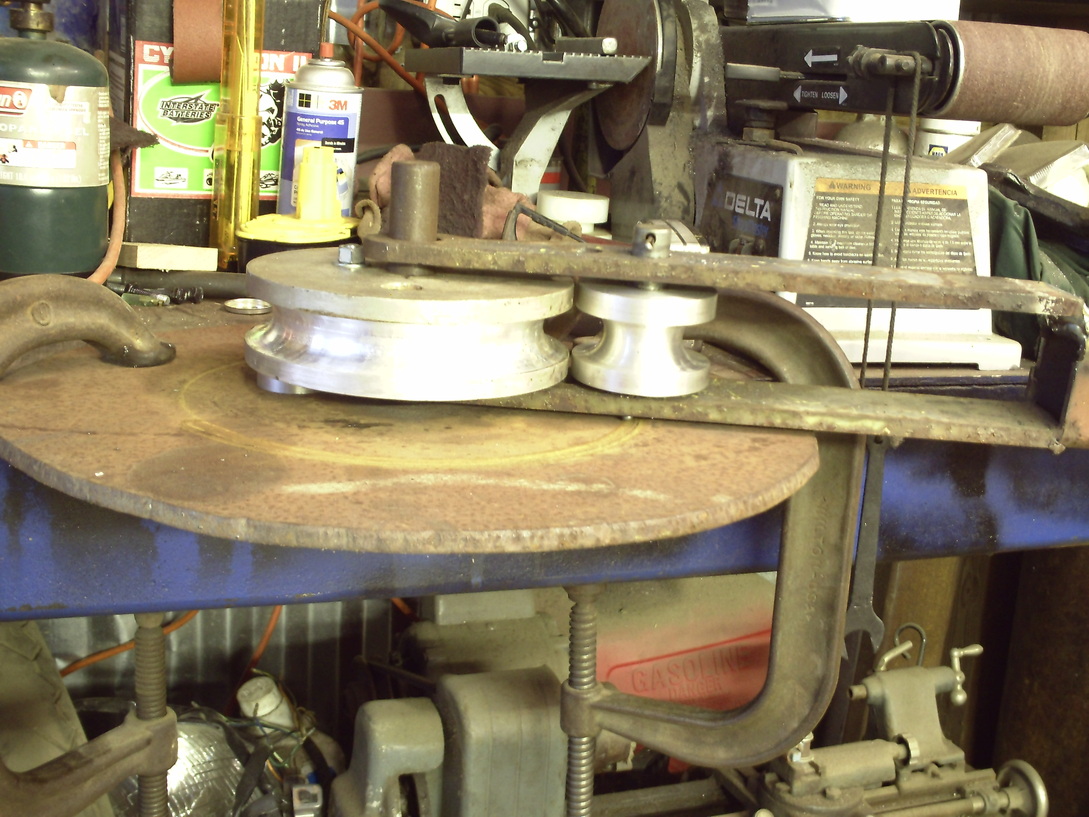

Are you using a mandrel tubing bender? If I bring you out some material you think you could bend me up a new rear hoop for my subframe? A tubing bender is pretty much the only thing I don't have access to.
- Posts: 7444
Re: kz750 custom swingarm fab
29 Oct 2014 06:31 - 29 Oct 2014 06:51
2.5itim,
i have built my own manual tubing bender and can bend 1" 3/4" and 1/2" tubing.
i believe the radius of my 1" die is a little to small to just make a smooth loop so it would have to be a couple bends to get a loop wide enough to fit your frame rails right.
