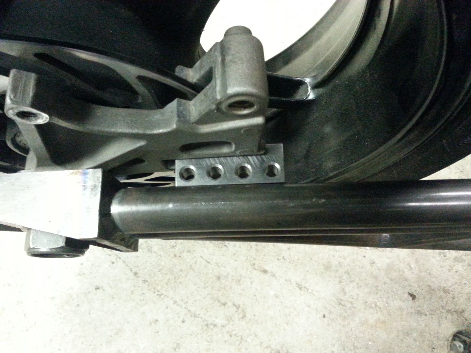

got the brake anchor machined last night.
now just need to get it welded .

it depends on what your application is going to be,as ed mentioned.
the swingarm on my black z1r i pictured is 3" over stock which is what i felt i needed to get the gaps above and in front of the wheel where i thought they looked the best.
because i also added structural rigidity and a larger contact patch the extra length has not negatively affected the handling.if i was to go much over a 3" stretch you are getting into pro street /drag race territory.
