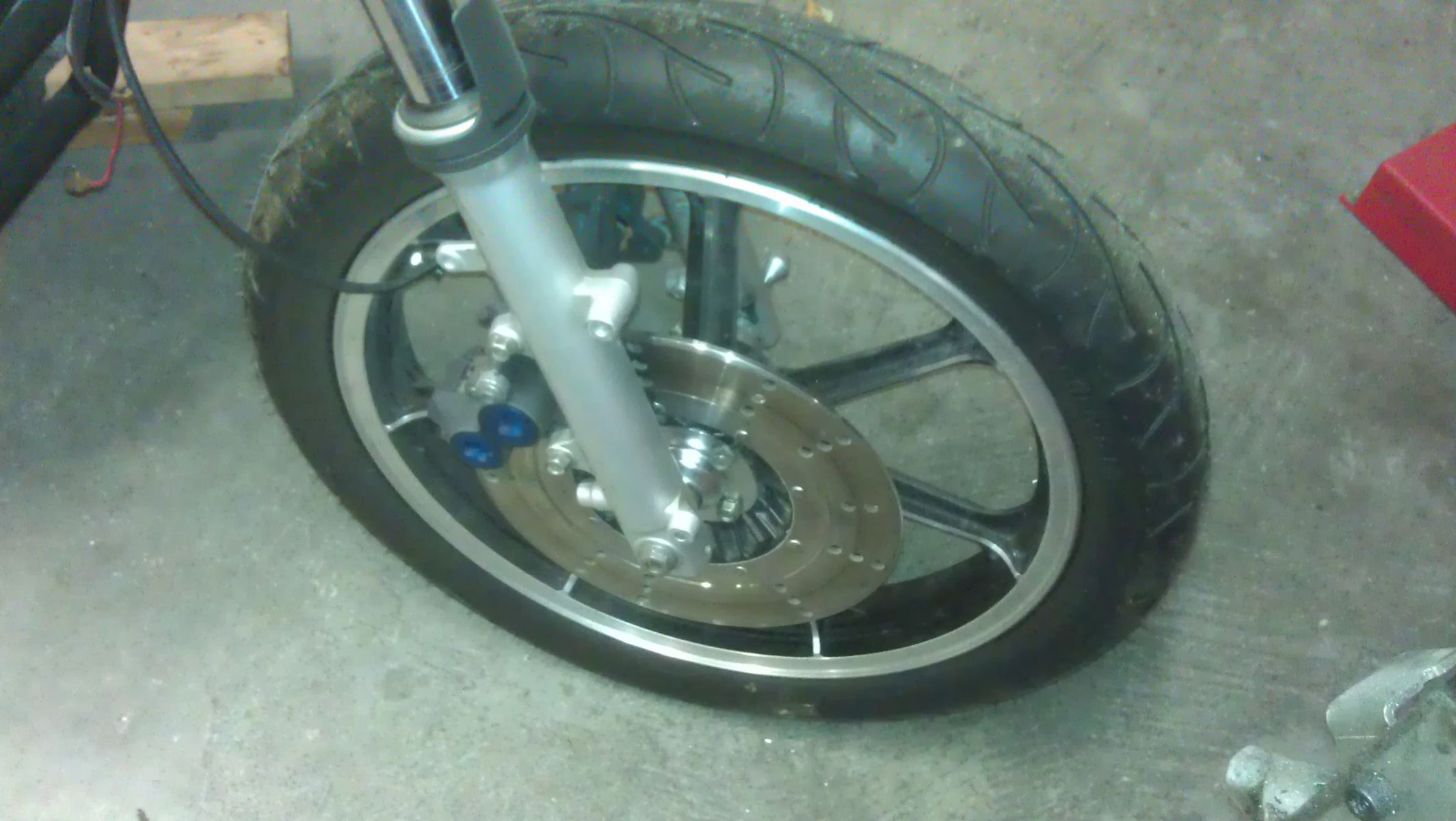

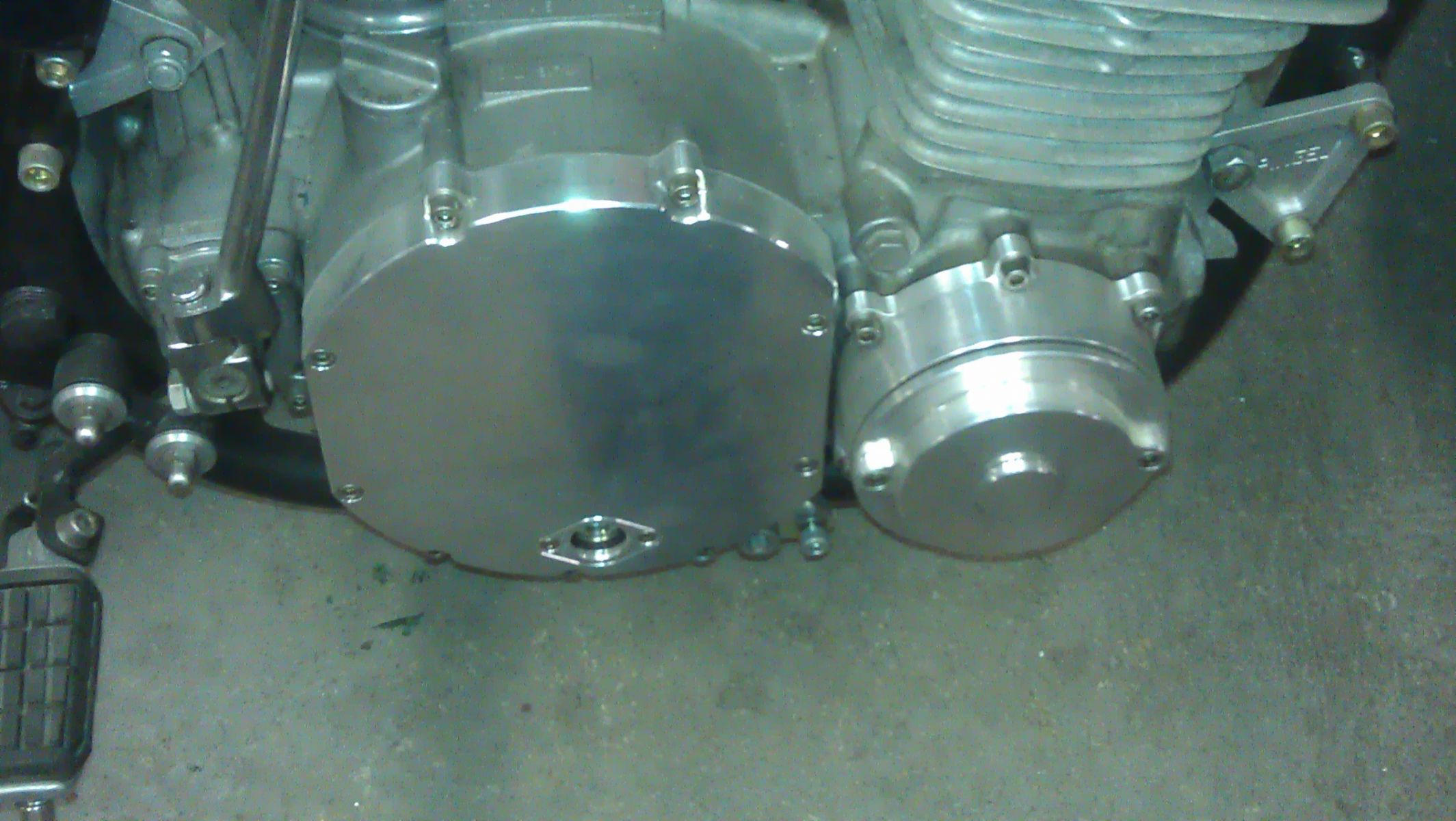

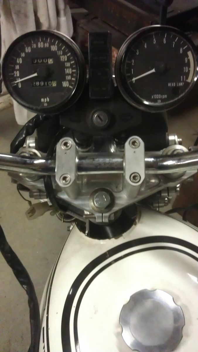

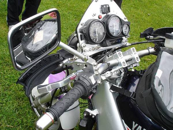

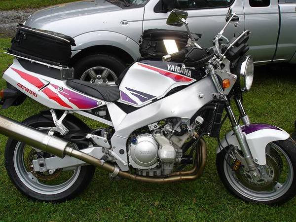

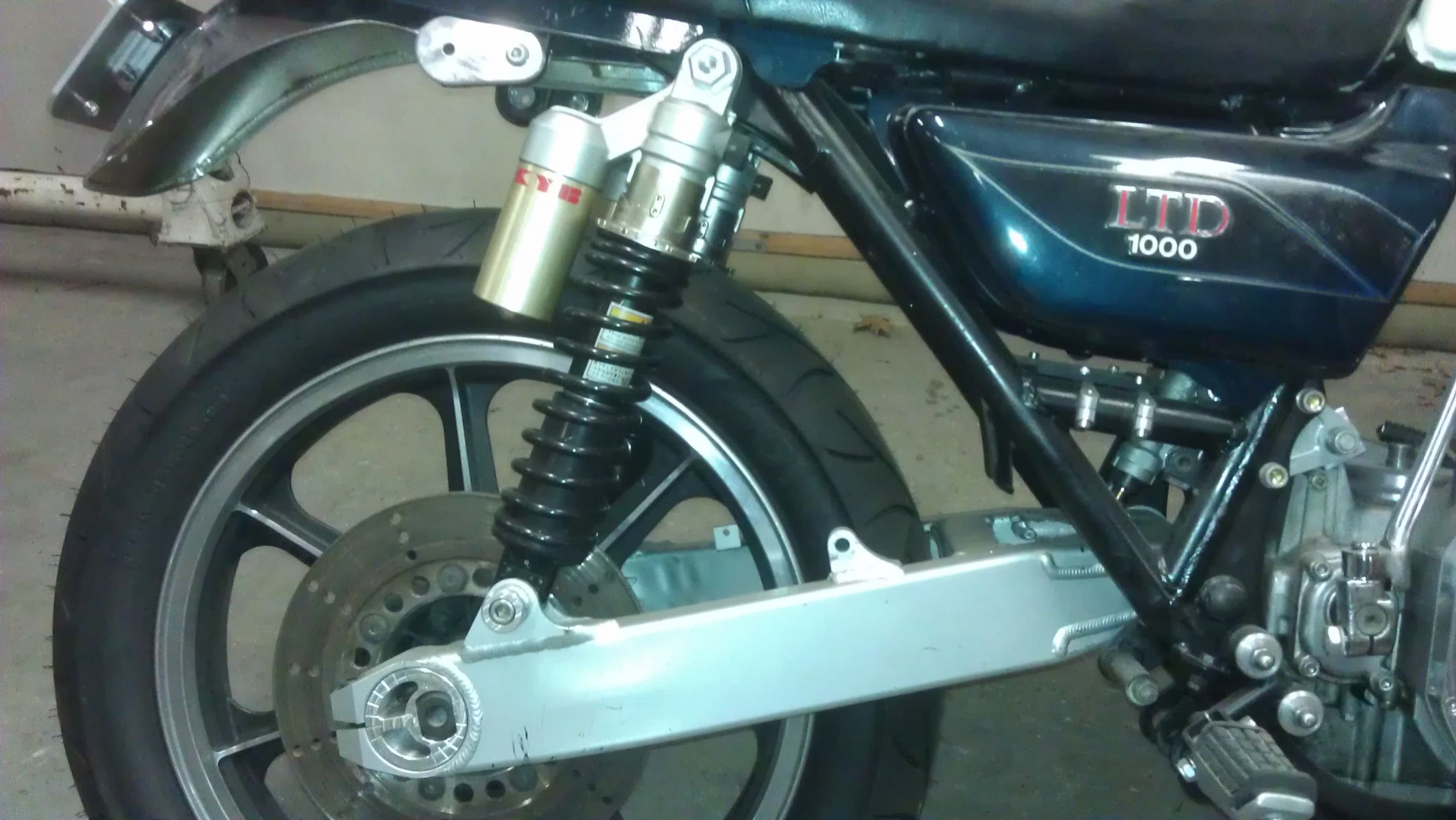

Leon does some nice work! I don't have any photos of the twin yet, but I'll try to post some of the air box I just finshed. Here are some of my KZ1000B4 project and my YZF
Attachment IMAG00191.jpg not found
Attachment IMAG00211.jpg not found
