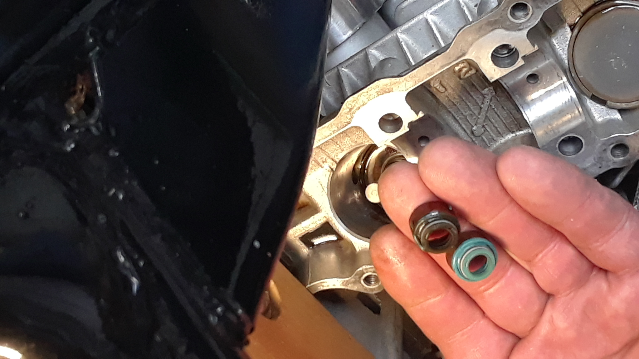

25 Sep 2025 09:04 - 25 Sep 2025 22:45I may have found the culprit, and it's not what I was expecting...
Video link below:
photos.app.goo.gl/yMse8ena71guhGrKA
Cylinder #3 has new valve seals now, and I believe the piston rings are fine.
Was hoping to ride the season out, and I'm not quite ready to hang it up just yet...but that #3 exhaust valve seems a bit wobbly.
Video link below:
I believe the piston rings are fine...but that #3 exhaust valve seems a bit wobbly.
The installation of a new valve stem/guide seal didn't help...
The head must be pulled for service

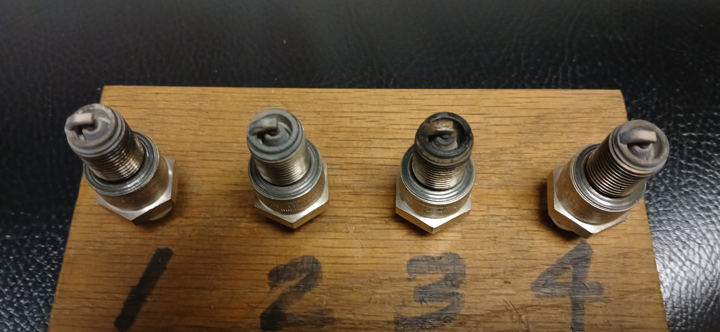

Be careful, those plugs are really lean, I would start richer then go leaner, your plugs are too white, they should be dark grey (gray for US)

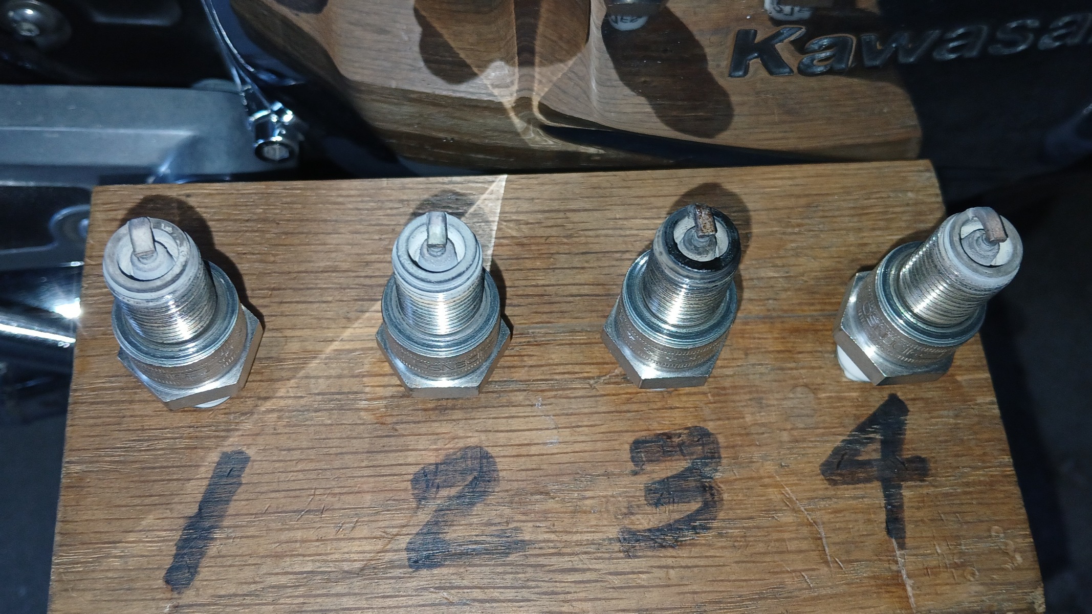

29 Sep 2025 09:47 - 29 Sep 2025 11:12Be careful, those plugs are really lean, I would start richer then go leaner, your plugs are too white, they should be dark grey (gray for US)
Truer image without flash:
Been running Non-Ethanol 90 octane (recreation gas) exclusively for a couple months.
The motor doesn't ping under load or run hot. It starts easily, runs strong, and is completely silent when the ignition is turned off.
Pilot Jets were changed from 17.5 to 20, and Mains from122.5 to 125 about six weeks ago.
Air Jets are .09 with Jet Needle Clips in the 3rd. slot.
Fuel Screws 1/8-1/4 turn out produces smooth idle.
Nippon Denso W27ES-U spark plugs
Please advise, thanks!

Thats better the colour looks better. The flash obviously made it look very lean

Bozo, your comments and observations are muchly appreciated.
90 octane rec gas seems to burn cleaner/better than 93 octane E10 Premium. Given the minimal cost difference and close availability, I prefer leaving the corn 🌽 juice out of my fuel system.
