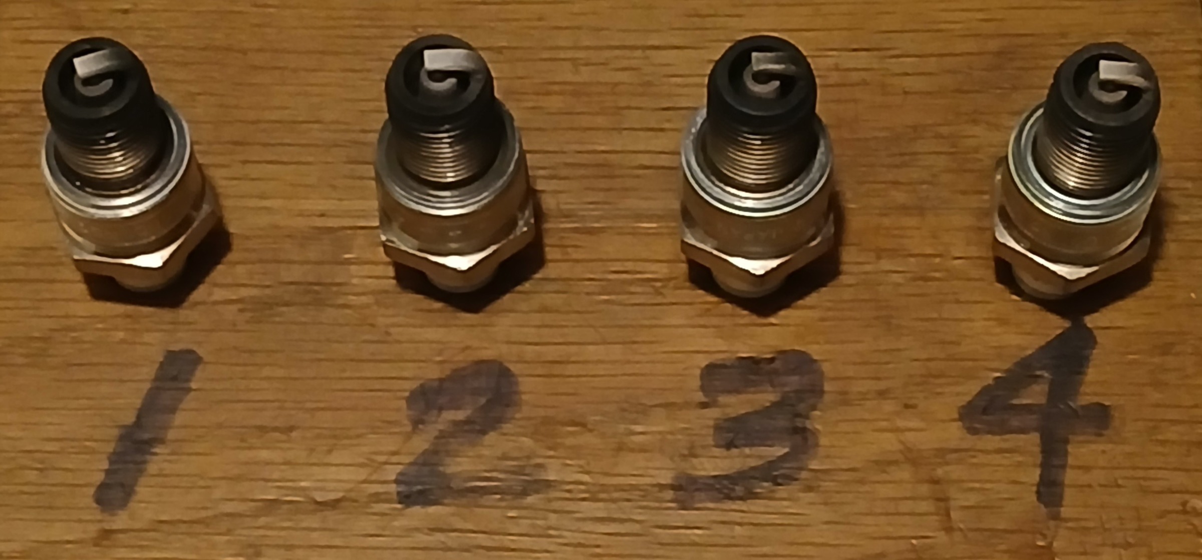

Carbs just ultrasonically cleaned...plugs after 200 miles:
#3 seems slightly off 🤔
Nippon Denso W24ES-U non-res
Taylor Spiro-Pro Wires
Dynatek 2000- Setting #5 38° BTDC
RPM- 10K 3 Ohm Minicoils
Shindingen SH775- Roadstercycle
Carburetor Jetting:
122.5 Main
15 Pilot
.8 Air
Fuel Screws- 1/4 +/- out
Needle Clips- Middle

Would size 12.5 (or size 10) pilot jets, or lowered needles correct that?
Tried leaner .9 air jets but the engine didn't agree much with that...

I would stick with the #15 pilot, if you go too small on the pilot it probably won't start or idle (been there)
Was the pilot circuit set with Color Tune kit?
Have you tried a #120 main jet? A smaller main will lean out all circuits but would require adjustments to the pilot circuit (fuel screw setting)

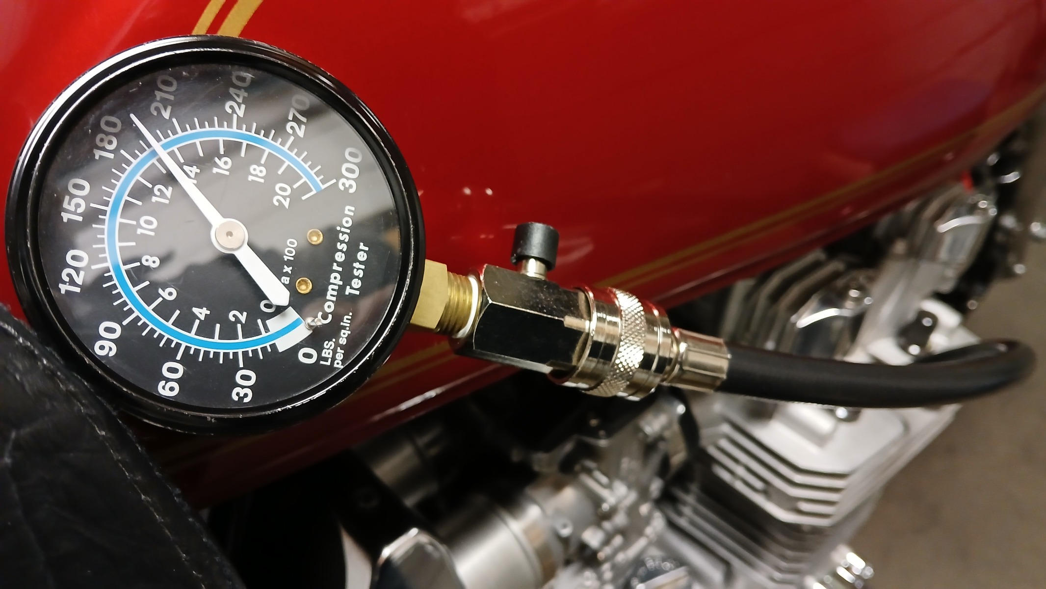

Steve, same carbs...way different engine(s).
The old motor had compression around 150 psi, but this one is holds 180 plus.
My gut-sense suggests this motor pumps air at higher speed/velocity, which naturally sucks more fuel than before.
Could this engine application be pushing the limit for the RS34 carb size considering how close it is to needing the smallest pilot jet size available...or am I just looking at this wrong?

17 May 2025 10:36I would stick with the #15 pilot, if you go too small on the pilot it probably won't start or idle (been there)
Great suggestions!
Apparently, I must stop trying to equate RS34 and BS34 carb jetting. It just seems odd to use the same main jet spec'd by the FSM for a stock 82 KZ1100 motor, when this engine is anything but that. Lol

17 May 2025 16:50Compression would have something to do with it but not much. The 34's are fine for what you're using them for. When I lunched a piston I bought a 1015 barrel set and I couldn't get the old style Wiseco 10.25/1 piston so I used the stock KZ1000 pistons until I could buy a new set. The jetting wasn't that big of a deal just minor changes. I did notice a small drop in power though. Later I dropped in the new pistons and was back to where I was. The biggest change was when I did the mild porting on this junk head. Night and day. I never had the clutch slip in 2nd gear before. With the 1075 it was much STRONGER than ever. I may look into a smaller main but I think I already did that. I'm going to try by the book plug chops and see where it leads me.Steve, same carbs...way different engine(s).

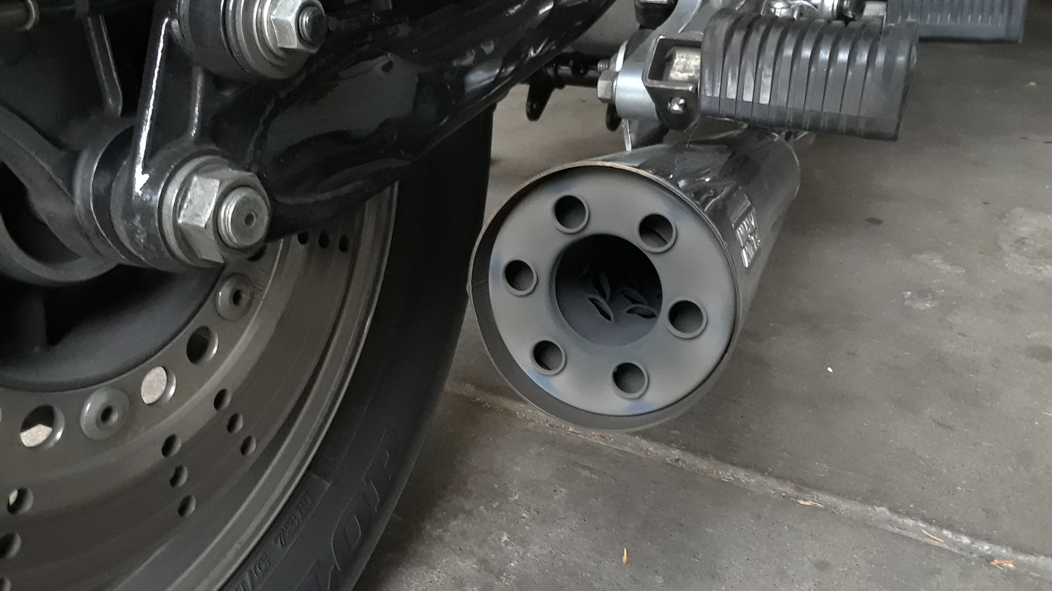

190 190 185 195
After a ride with the competition baffle installed-mid 50° F. air temperature.
No carb changes yet since cool temps will be stuck here for awhile.
The good advice is muchly appreciated!

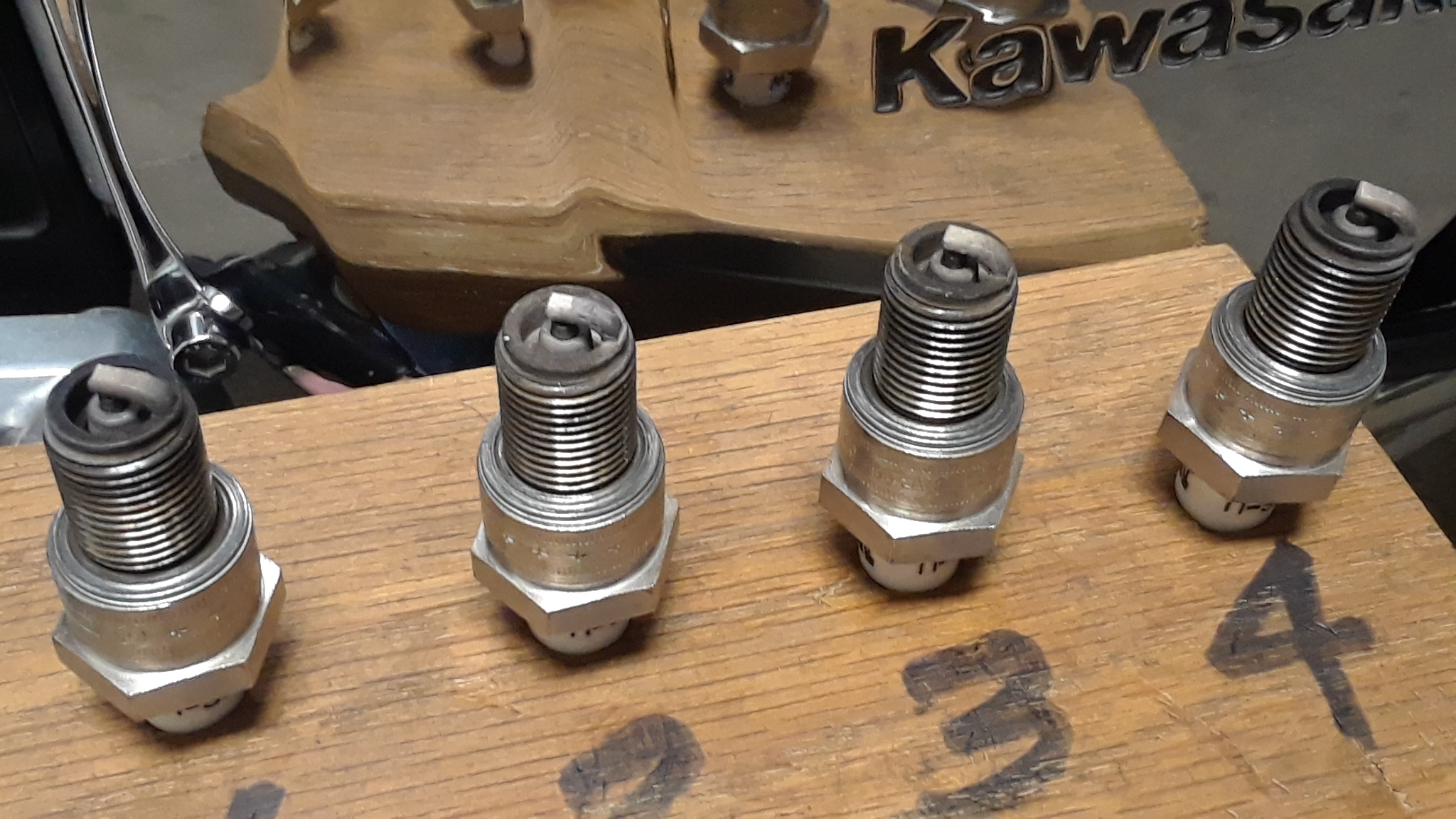

08 Jul 2025 18:36 - 09 Jul 2025 07:58Nippon Denso W27ES-U
Above images taken after 100 mile ride with 90 octane no-ethanol recreation fuel blended with around ten percent 110 octane racing gas purchased from two gas stations.
She's running strong (and cool) with the 15 pilot jets...and 120 mains.
Still noting plug #3 color difference even with the pilot FUEL screw barely open while the others are 1/8-1/4 turns out.
Have also been adding about one qt. (Shell Rotella T4) oil per 400 miles.
Cylinder 3 seems to have an issue that is not going away.
To date the engine has about 4K miles on it.

Abolished the problem with the Morgan Carbtune!
Cylinder 3 was somehow set massively high last time...by me of course.
P.S. Been running Ethanol Free 90 octane for several fill ups now, and think I'll keep using it for a while.
