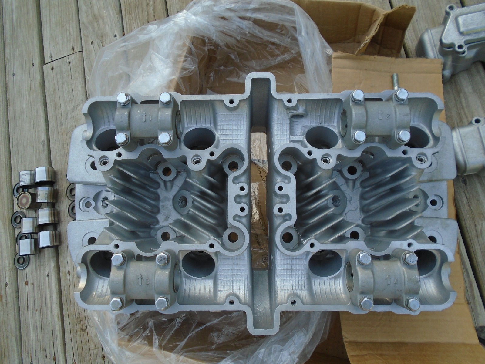

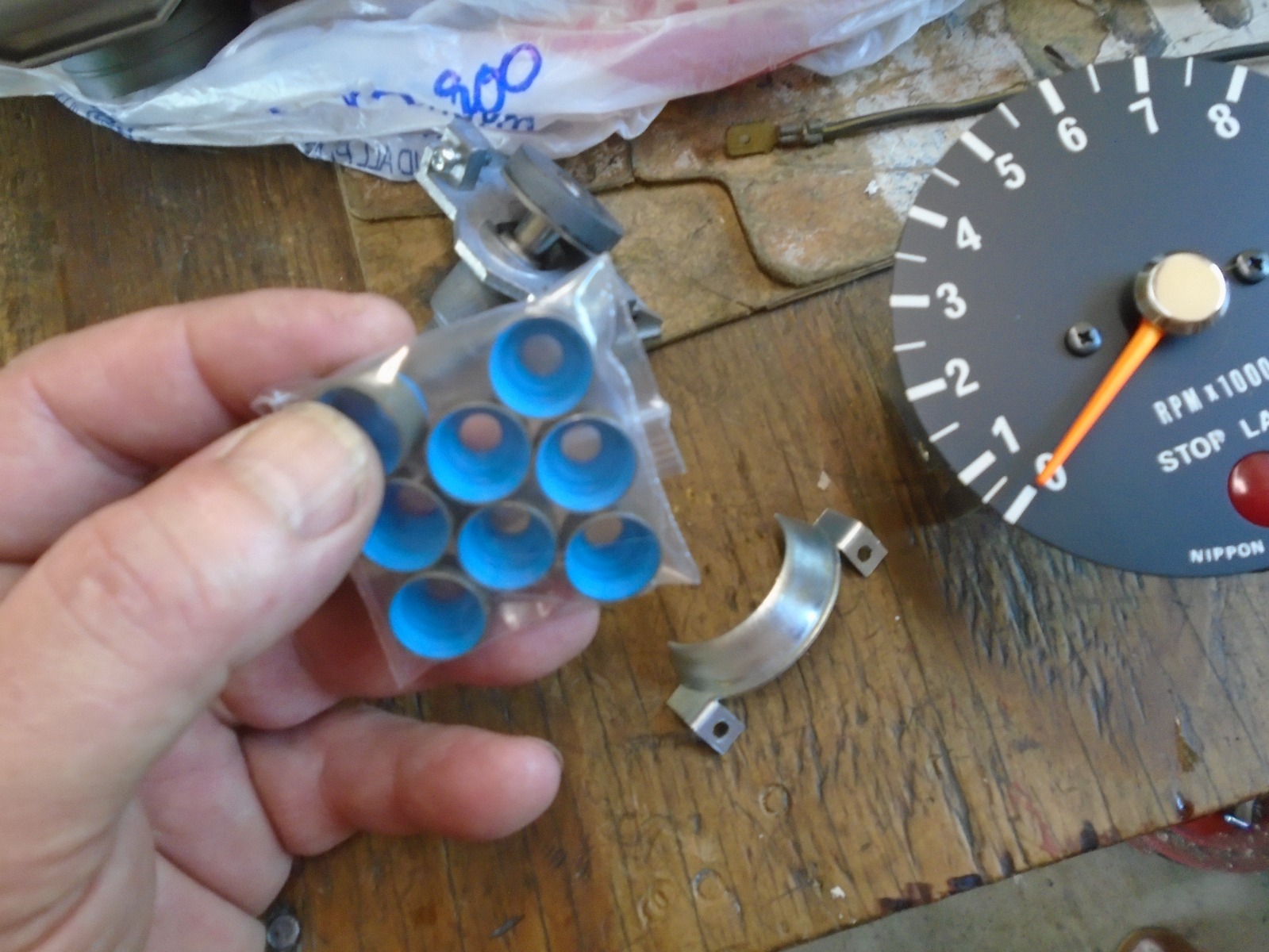

If a valve seal is the culprit, it will be either the intake or exhaust, so I'm mentally prepared to pull the cams and replace both seals in one swoop.
Just need to get them, and determine how to pull the old seals off the valve guides without damaging something in the bucket bore...while the head is on the motor, mounted in the frame.

Im sure it possible to change-out a guide seal while head is still in place? But might be tasking, pressurize the cylinder or feed rope down the sparkplug hole? The valve guide seals are the same 650-1100KZ's The disadvantage to that is you might be missing a key component of failure, that requires a bit more work, disassembly.

Besides, I have a new valve spring installation tool that needs testing on an assembled motor that is mounted in the frame.
