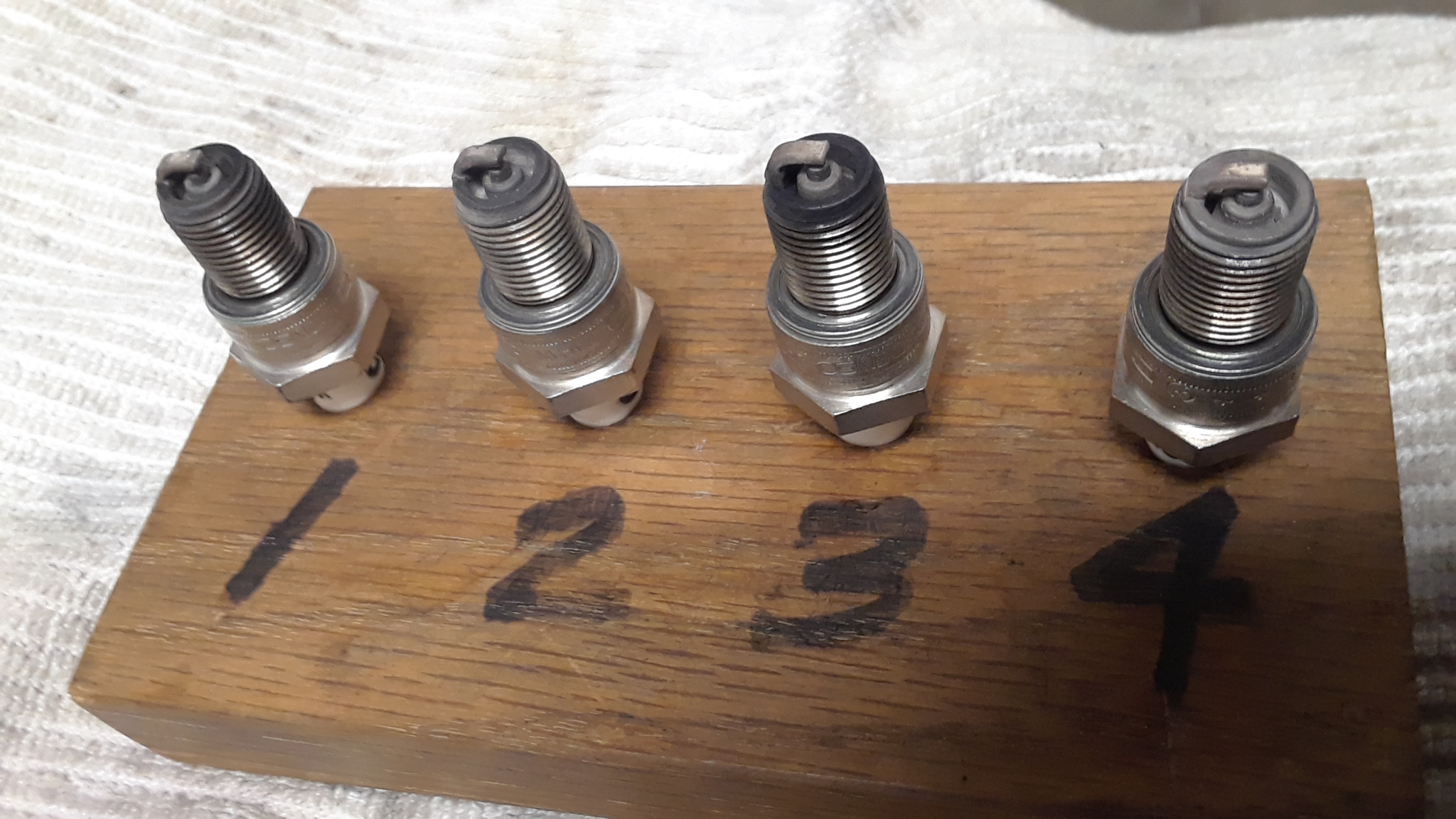

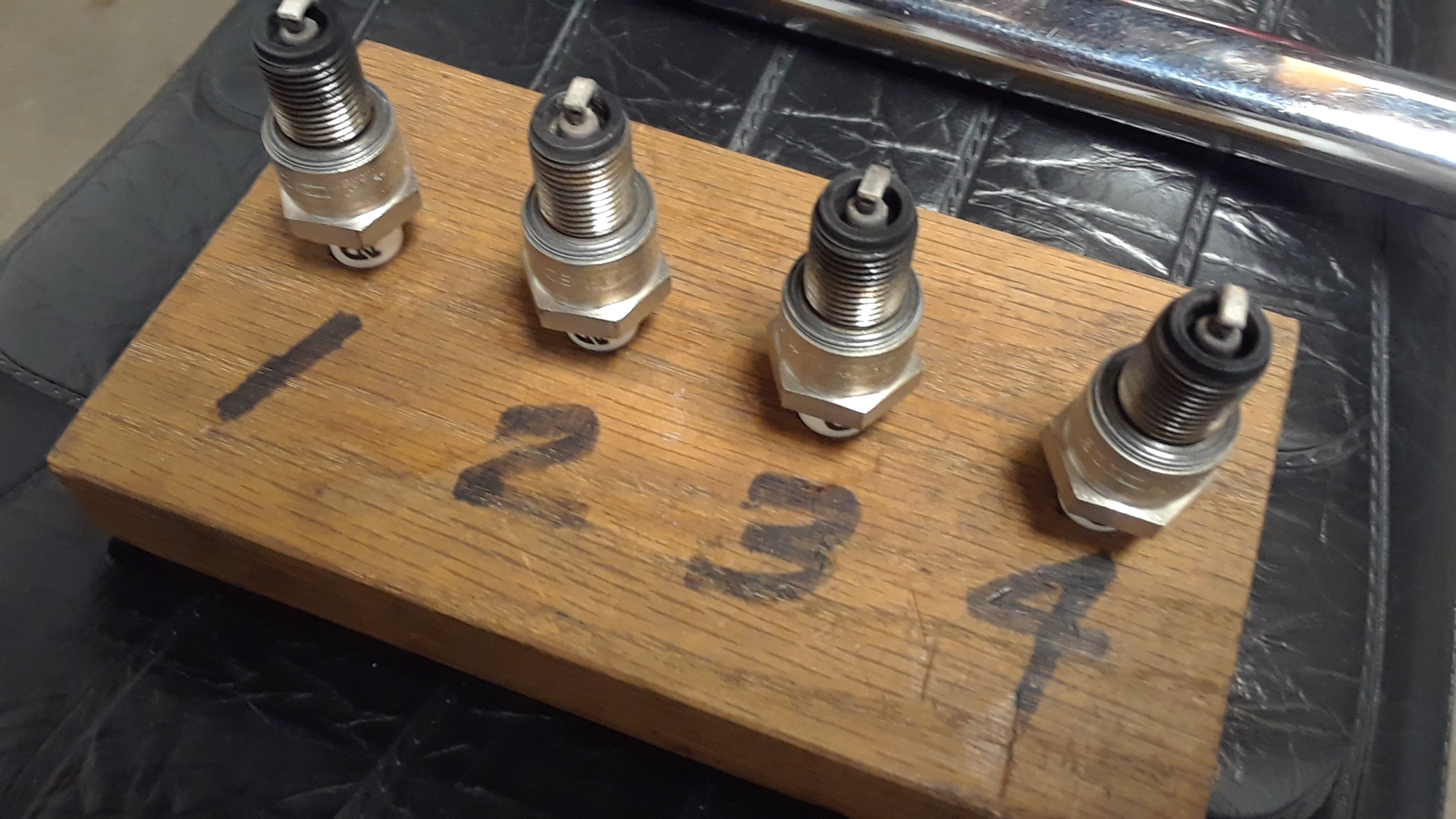

07 Aug 2025 08:39I would suspect the most likely culprit would either a damaged valve stem seal or an "oil scraper ring" issue on #3 piston (this wouldn't show from a compression test which I know is excellent on this motor) Before you dive in too deep it's worth checking that your crankcase breather is not restrictedTaken minutes apart, after the bike was parked a couple days.
I suspect a cylinder #3 issue is the oil consumption culprit, but what steps may be necessary to remedy the situation?
Will a top-end tear down ultimately be required to get at the problem?
Meanwhile, she's running great!!!

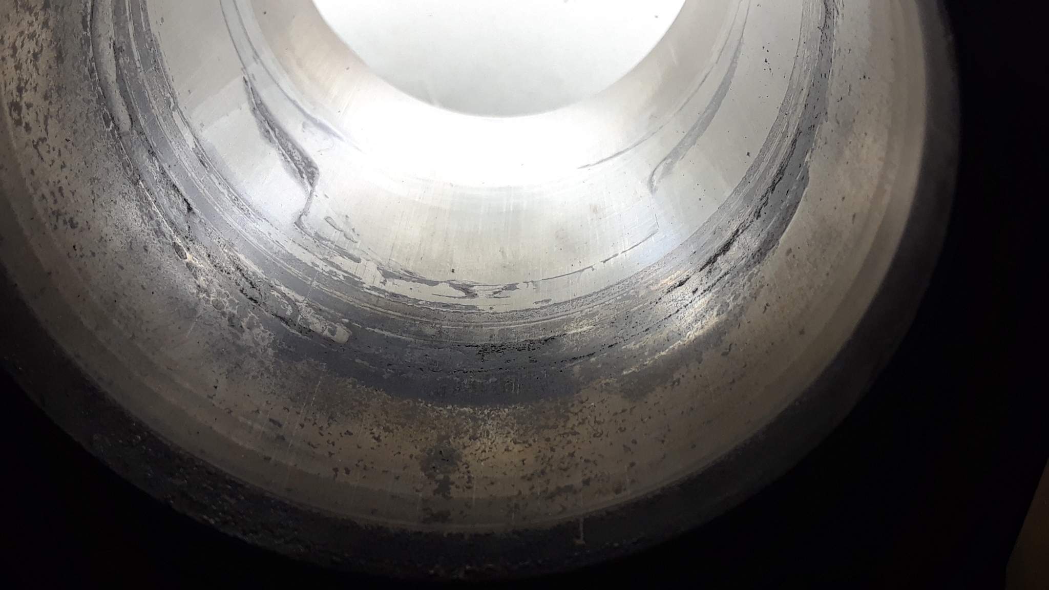

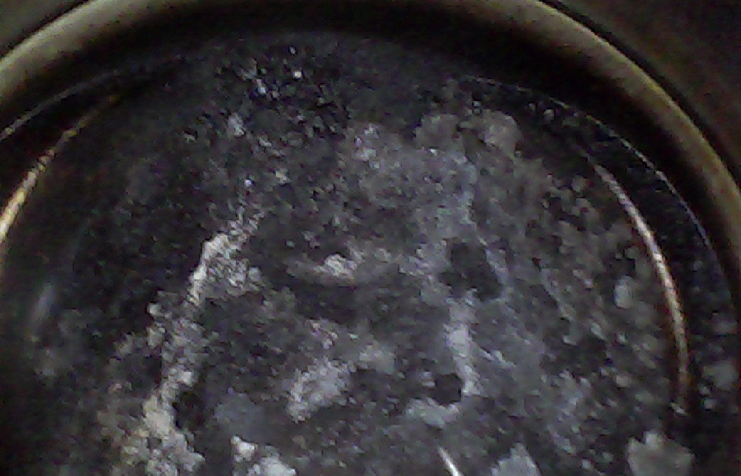

I wonder if that cylinder sleeve had an inherent weakness, after sitting in a warehouse on a pallet for thirty some-odd years. Image below:
That concern was brought up with the engine shop before the cylinders had pistons fitted...was NOT considered an issue, and the work was performed.

What was it like after re-bore and was the ugly part below the oil rings at BDC ?
The following user(s) said Thank You: asphalt900, daveo
- asphalt900
- Posts: 1953
- Thanks: 1313
Re: RS34 Tuning Assistance Please
07 Aug 2025 10:16
That's a pretty deep looking pitted ring there. Did they get all that out after 'BORING", you did bore them didn't you? That's the battle selecting "oversize" piston sets. While the others maybe didn't have as much damage? Trying to compensate for removal of that particular #3 i would of just sourced a better STD liner example.

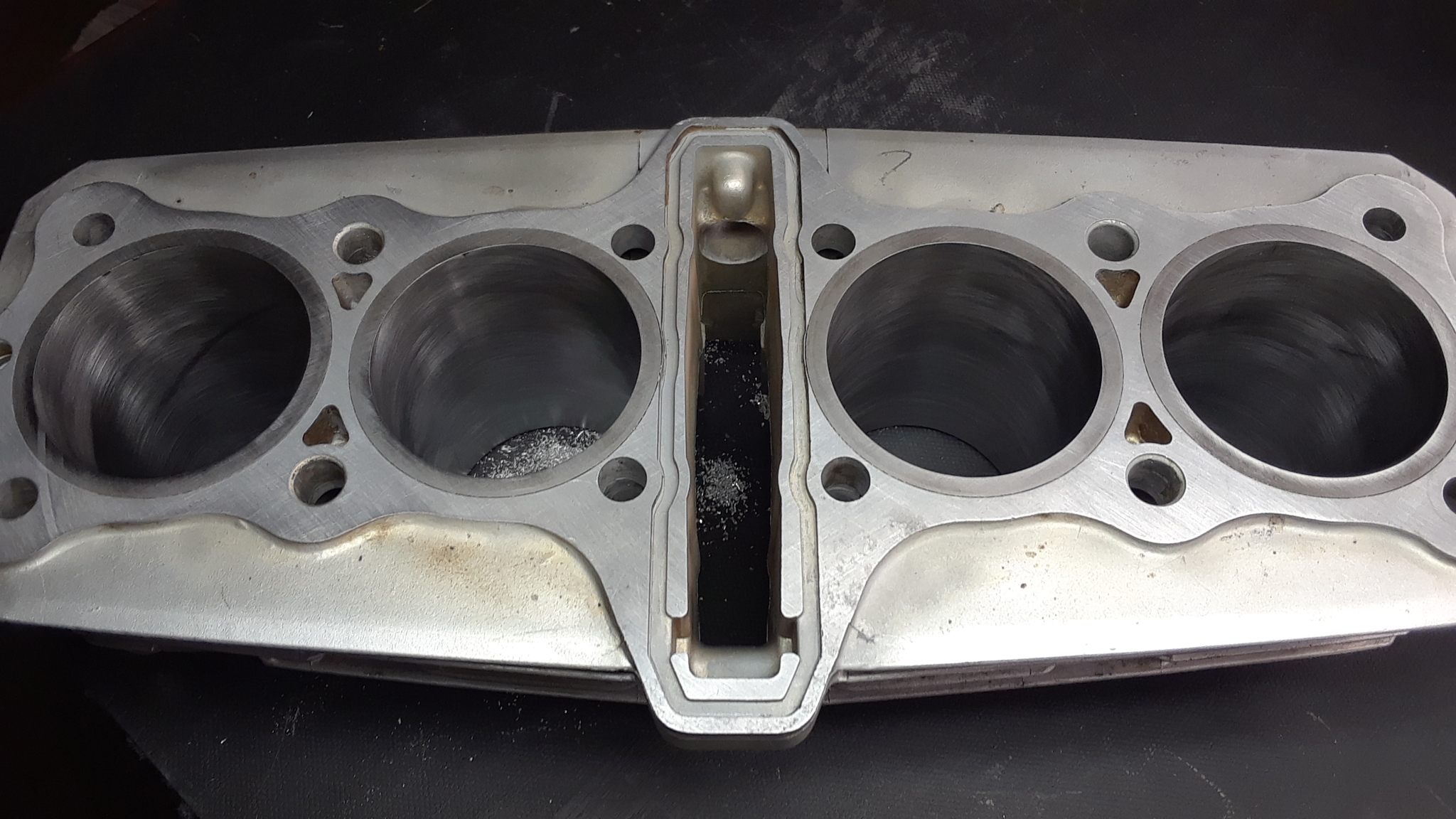

Wasn't a concern with Jay/MRE, who was hired to do the job and provide the Wiseco kit.
On receipt of the finished cylinder block I could not see any remnant corrosion, so I assembled without further thought.

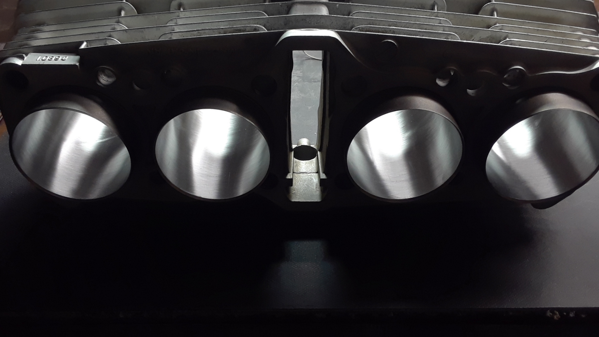

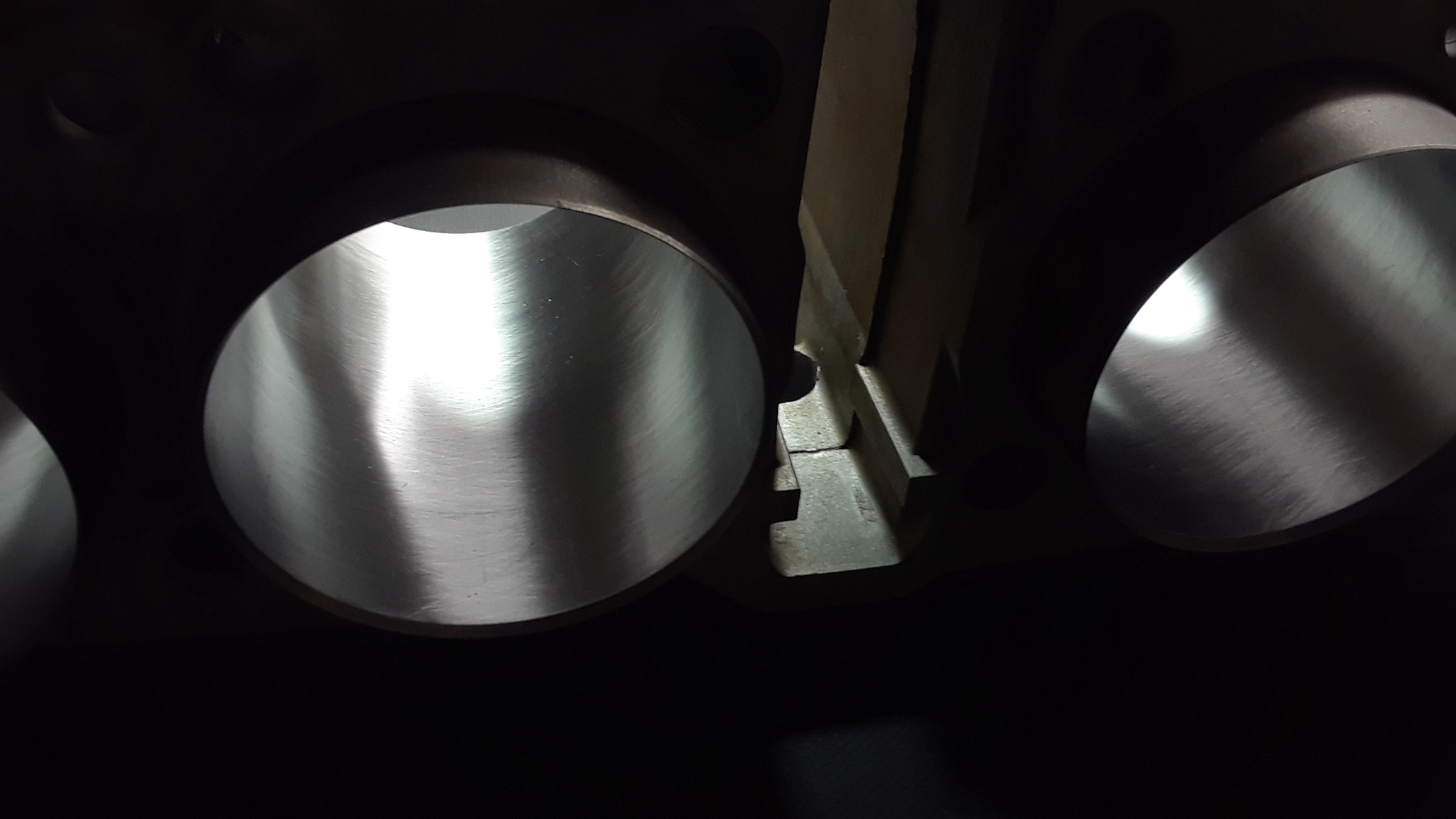

Others below...

- Posts: 6878
- Thanks: 4330
07 Aug 2025 12:51
They don’t look bad to be fair
- daveo
- Posts: 3174
- Thanks: 899
07 Aug 2025 13:49
Great assessment Guy. It pretty much rules out the cylinder wall as a potential cause...thank you!
07 Aug 2025 16:26
Those liners look awfully thin. Does it say 1.890 on them? What size are they now?
07 Aug 2025 16:45 - 07 Aug 2025 16:47
1.089 L. 72.5mm bored to 75mm
The Wiseco K1172 is the only piston kit specifically made for the ZX1100A model engine/crank with 18mm wrist pins...that doesn't require re-sleeving.

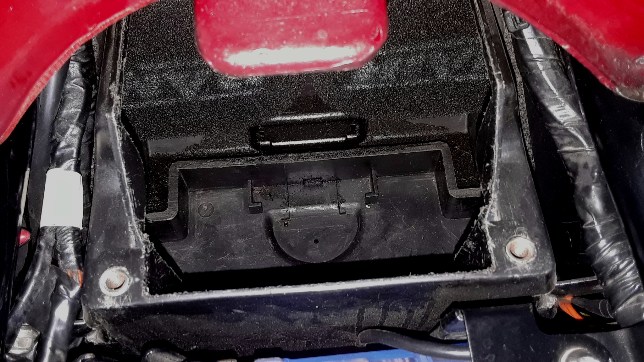

There is no breather obstruction, and the air box is clean.
The space beneath the breather cover is clean also, and has no filter element installed...
The original motor had a Ram filter media strip installed to minimize oil being blown into the air box.
To my surprise it actually worked!

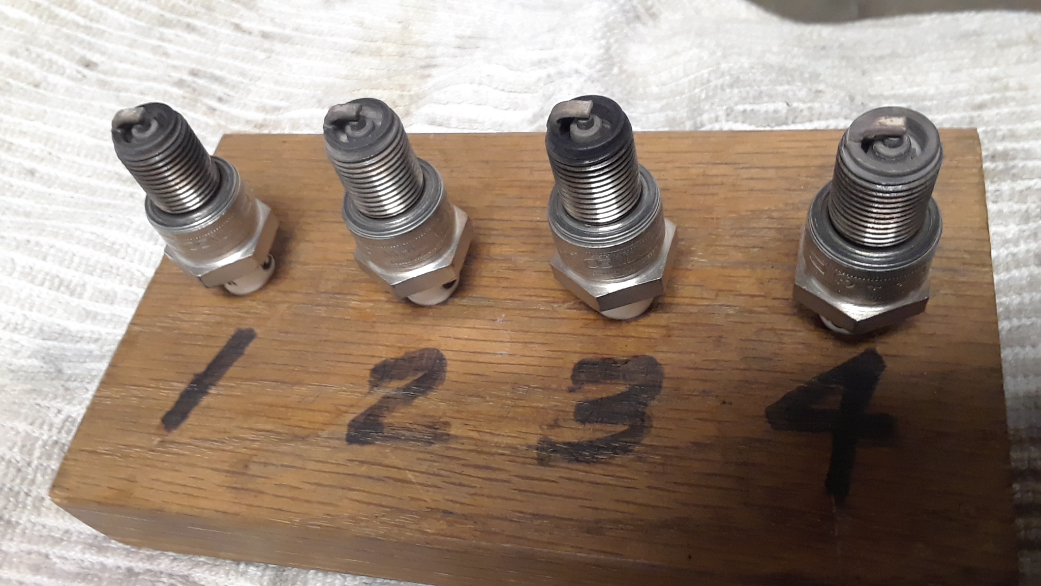

Cyl. #3 an hour after that:
Fuel screw was turned in slightly...dry piston, and plug looks better...for now, go figure.

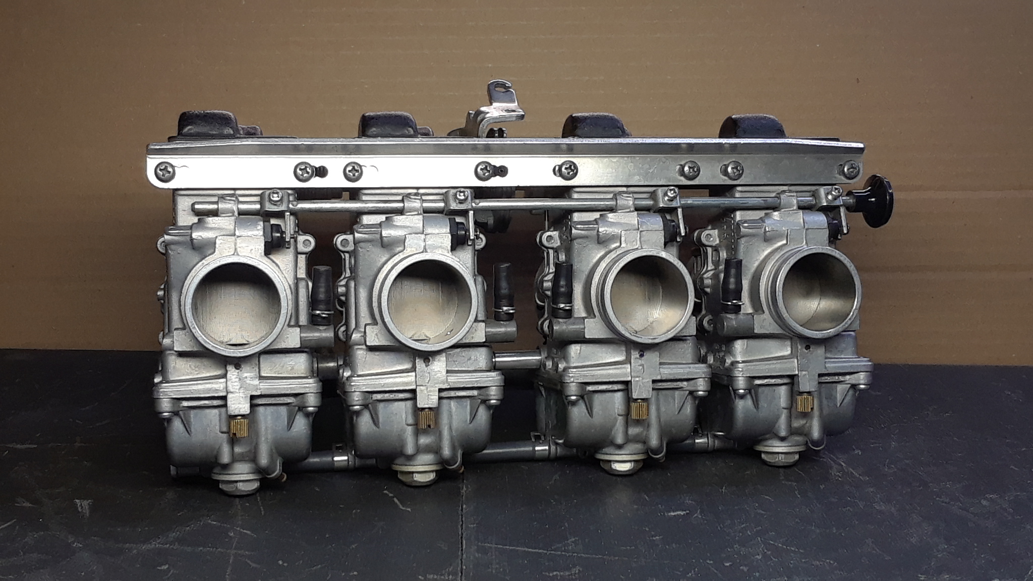

Runs great, but the #3 cylinder still has the oil-related operating issue, even with it's carb fuel screw seated.
If anyone in the lower 48 U.S. has an interest in my Mikuni RS34 carb rack, please send a PM.
