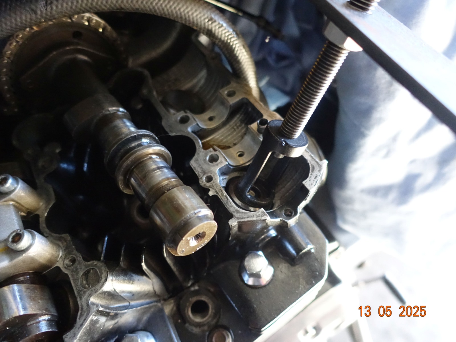

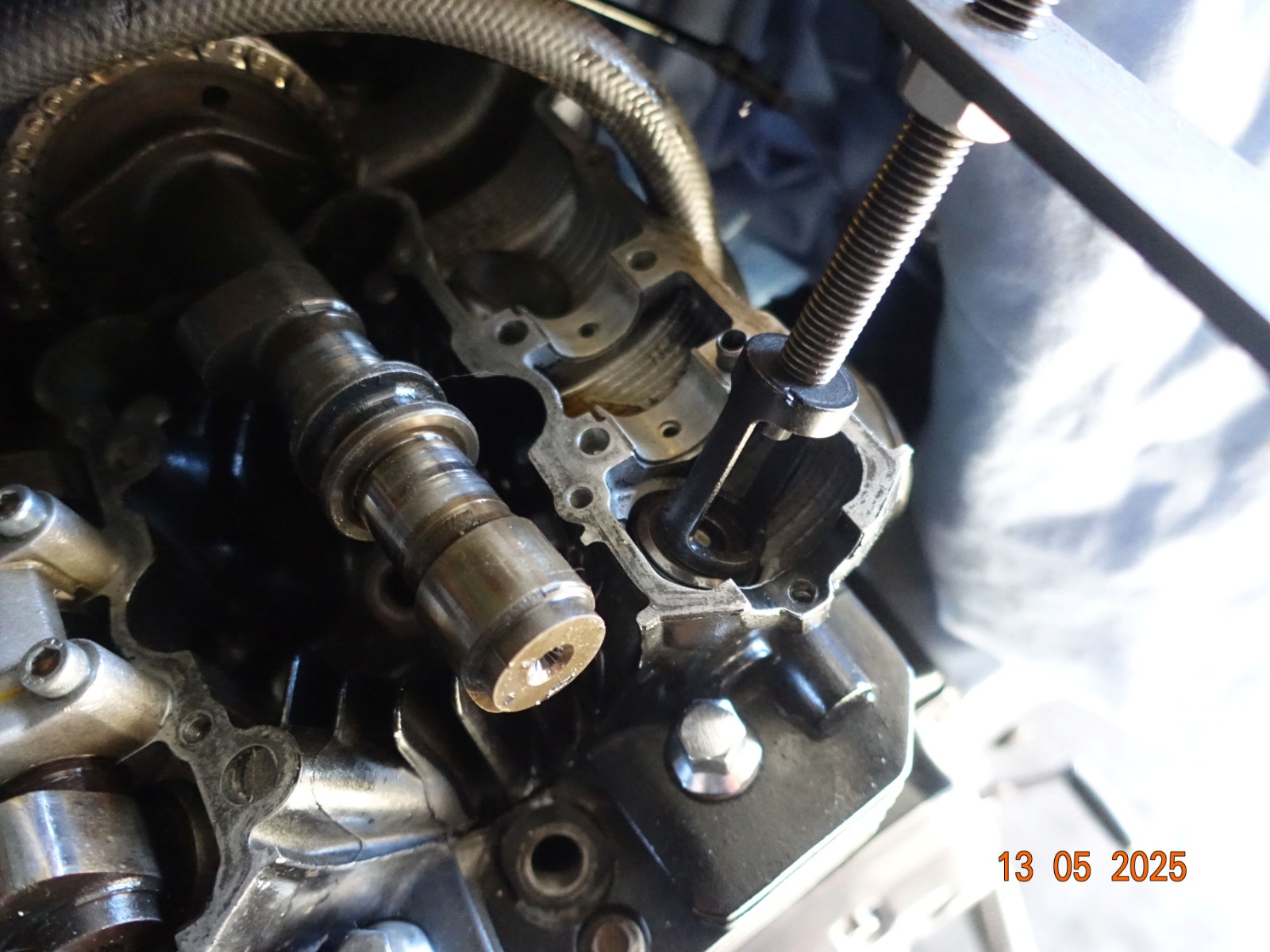

17 Sep 2025 07:00 - 17 Sep 2025 08:08Im sure it possible to change-out a guide seal while head is still in place?
I designed a "special" tool for the purpose.
A working prototype has been fabricated and tested...
1982 KZ1100-A2/1170 sleeper 😀

I had a similar issue with my GPZ1100A1 engine, I had new valves fitted, seals etc, after w while I noticed a slight puff of smoke on de-acceleration, obviously the valve guide seal was suspect. I found that the valve guide on the one cylinder was slightly up compared to the others so the under bucket actually touched the seal. I used the compressor method to hold the valve in place made a valve compressor tool, used a b rass bar and "gently" tapped the guide down, fitted a new seal, no more oil consumption.

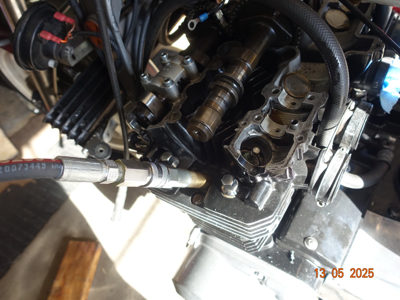

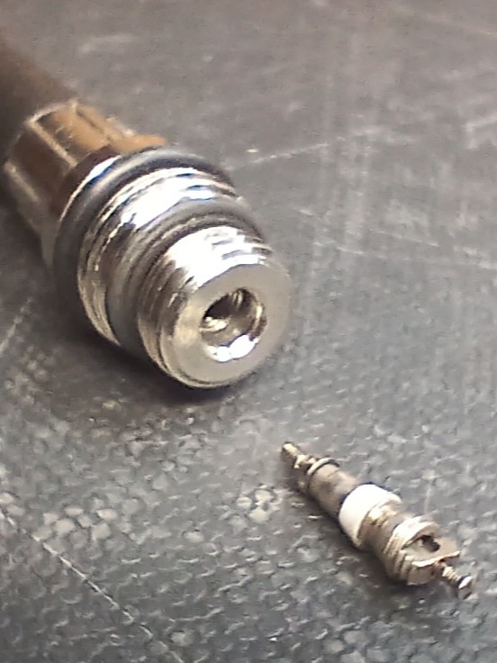

To hold the in/exh valve closed with air pressure, I was thinking of using my compression tester hose with it's Schrader valve removed.
Is that preferable to having it as a precautionary check valve?

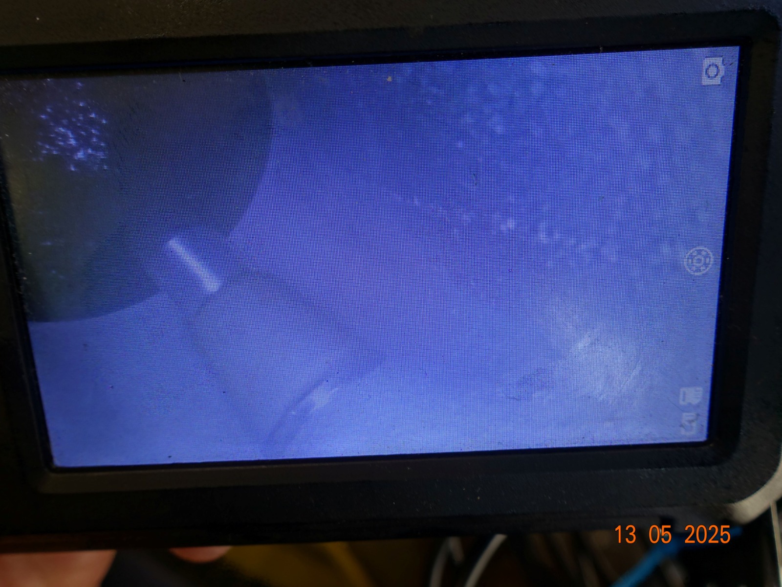

Assuming this might be the same problem as yours. The way to check is use a video scope to check if the intake/ exhaust valve is oiled up (see my previous scope photo).
I was lucky, I had a hose made for another job. make sure the piston is down as the air will push it down, unless the air drops completely there should no be any problem.
Remember my problem was obvious i.e smoke on de acceleration, it could still be another issue.

My personal preference (and it is just that) is to do this with the piston at the top (I tend to air on the side of caution and with the piston at the top, should your air line burst the valve can't fall in) The easiest way to do this single handed is to pressurise two cylinders together (one up and one down) using a "Y" piece on the air line. It's easy enough to make fittings for the head by welding air line fittings into the shells of old spark plugs with the ceramic removed

22 Sep 2025 07:34Assuming this might be the same problem as yours. The way to check is use a video scope to check if the intake/ exhaust valve is oiled up (see my previous scope photo).
I'm surprised that the hose typically provided with compression gauge kits has the proper end fittings needed for this purpose.
What was your #1 spark plug condition compared to the other three?
With the clutch engaged, will it work to lock the engine's forward rotation in-position (slightly beyond TDC) with a block of wood placed between a wheel spoke and the swingarm?

22 Sep 2025 07:38Yes but the cams will be removed at this stage and when the engine tries to rotate you will need to ensure it doesn't "snag" the cam chain on the crank !!Assuming this might be the same problem as yours. The way to check is use a video scope to check if the intake/ exhaust valve is oiled up (see my previous scope photo).

22 Sep 2025 08:01Yes but the cams will be removed at this stage and when the engine tries to rotate you will need to ensure it doesn't "snag" the cam chain on the crank !!Assuming this might be the same problem as yours. The way to check is use a video scope to check if the intake/ exhaust valve is oiled up (see my previous scope photo).
Sounds like a plan!
