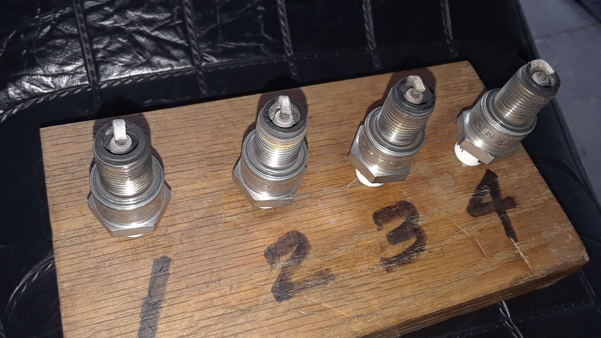

Groovy Daveo!! Has your oil consumption dropped? 400miles per quart is Waaay excessive, is it falling out? Baffle doesn't resemble an oil burner.

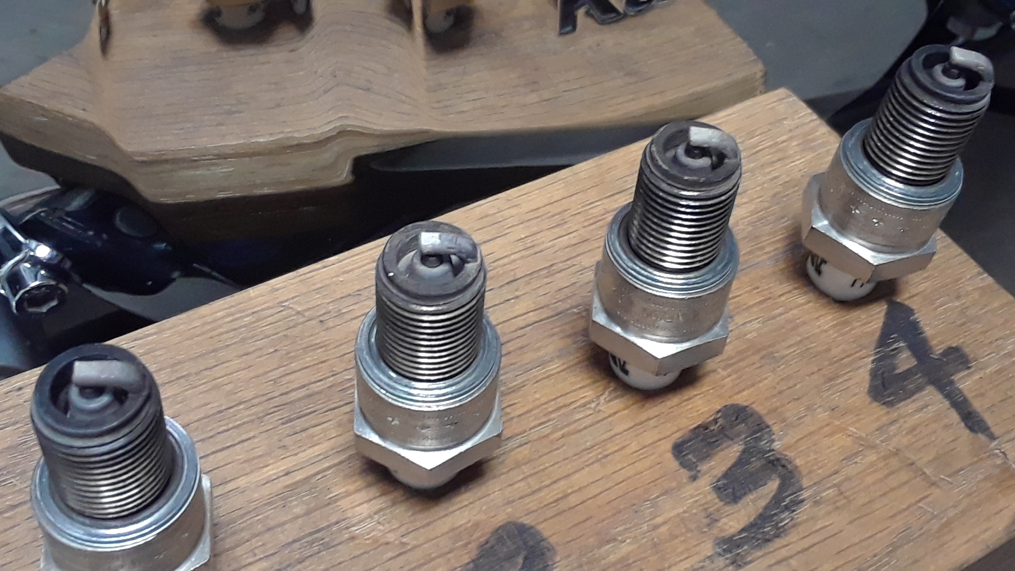

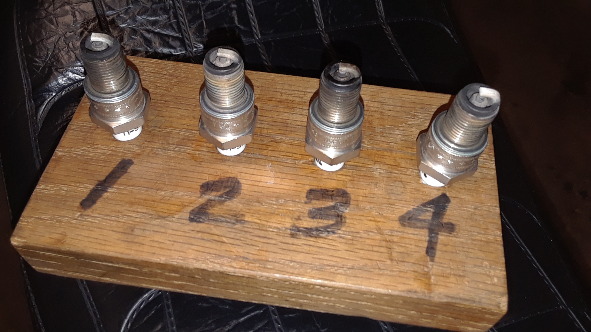

17.5 pilot jets and fuel screw adjustments have improved the spark plug color uniformity considerably:

04 Aug 2025 15:05Plugs look better 🌝
The motor is very happy with the T6 15W-40 Rotella.. Consumption is less, and leaks are minimal...limited to the cam cover gasket at a couple end plugs.
Switched to .9 air jets and dropped the needles (clips in 2nd slot)...and she likes this setup a lot!
1982 KZ1100-A2/1170 sleeper 😀
- Posts: 8205
- Thanks: 3577
Re: RS34 Tuning Assistance Please
04 Aug 2025 15:22
Those plugs look good.

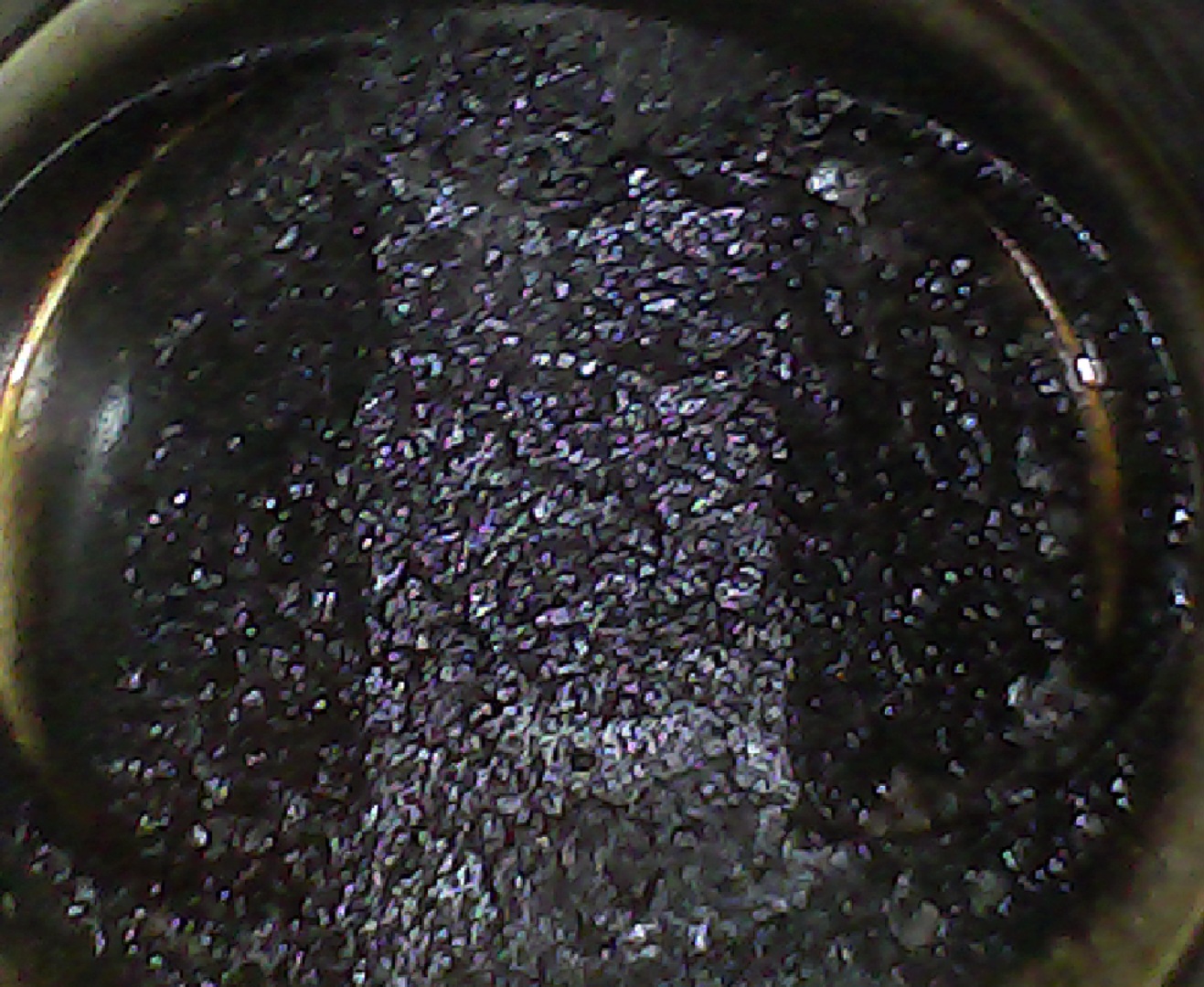

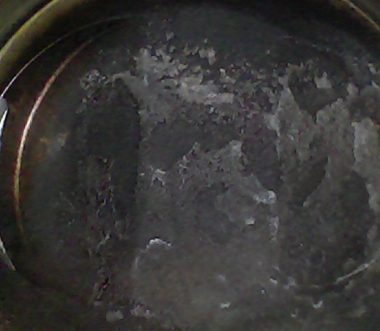

Still having issue with #3
A Klein bore scope (purchased off ebay) was used to capture the images below:
#3
#4 (#1 & #2 similar)
Does anyone know what's going on here?

#3 looks "wet" is it fuel or oil ?

That's screaming oil unless these photos were taken at different times.

07 Aug 2025 02:22I guess another pic half an hour later would confirm (fuel would have evaporated off)That's screaming oil unless these photos were taken at different times.

Taken minutes apart, after the bike was parked a couple days.
I suspect a cylinder #3 issue is the oil consumption culprit, but what steps may be necessary to remedy the situation?
Will a top-end tear down ultimately be required to get at the problem?
