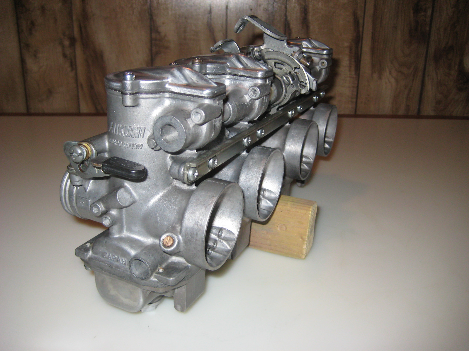

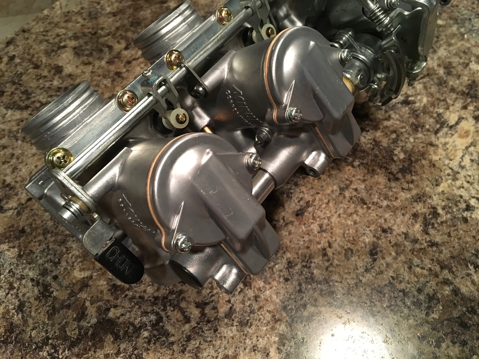

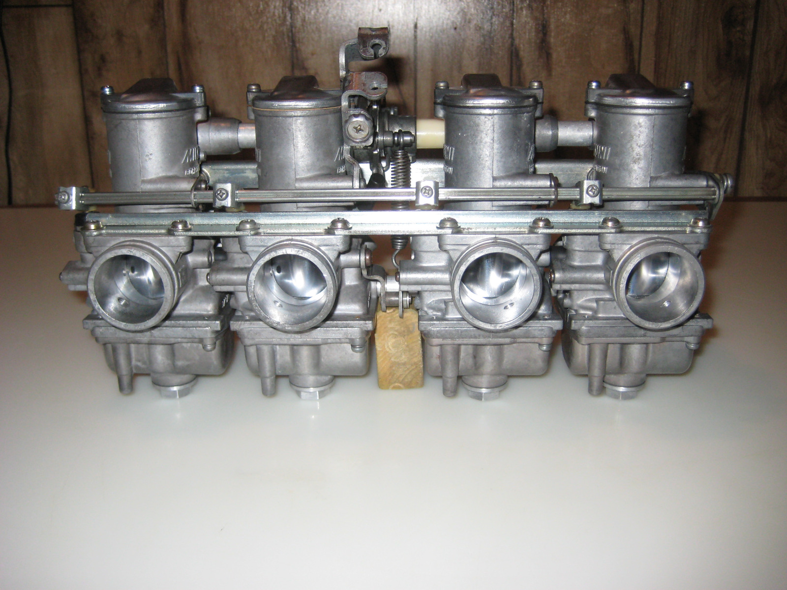

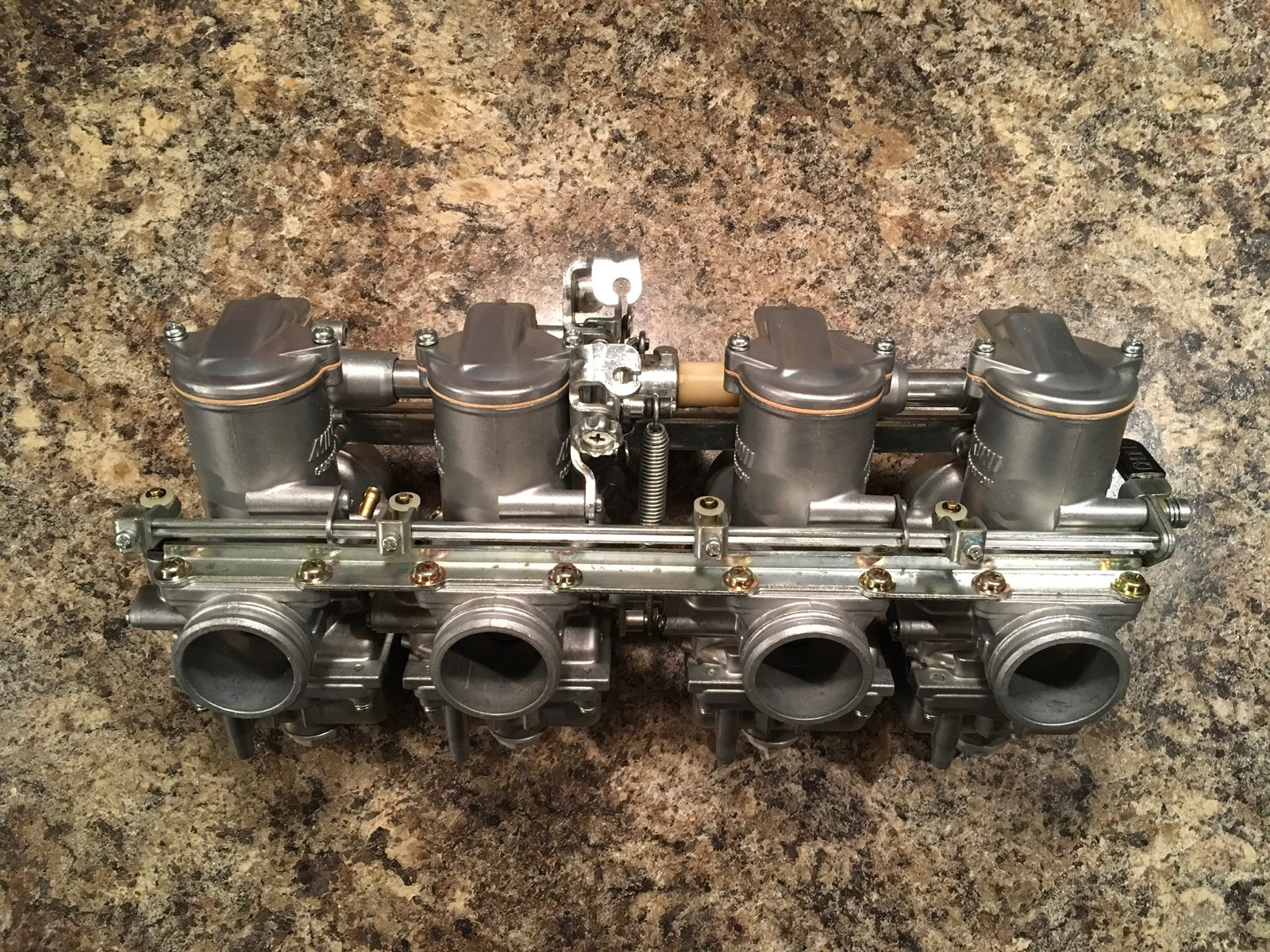

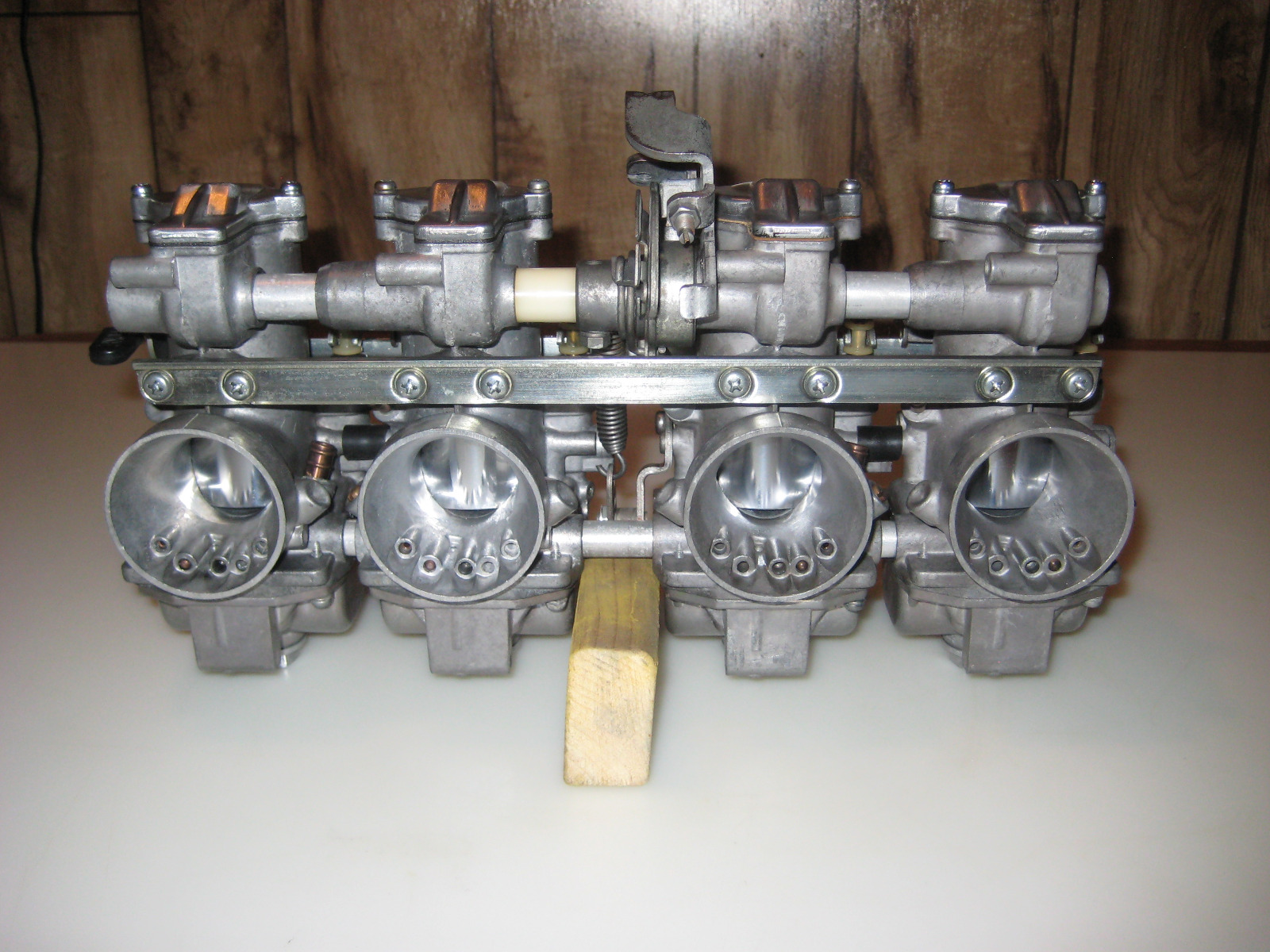

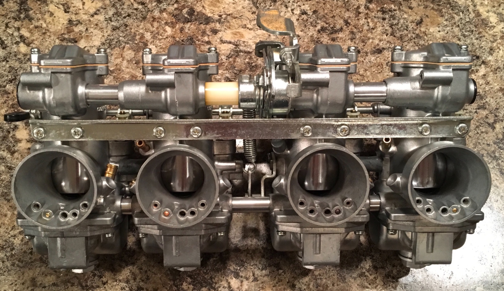

Bought my carbs like this :
After some clean up and parts replacement there are ready to bolt on :
Pre jetted for 1197cc 10.5:1 motor, big valve head, 420 lift Web Cams shim under, 90CFM port job, running a CV air box, stuffed in a stock looking KZ650 C3 build.

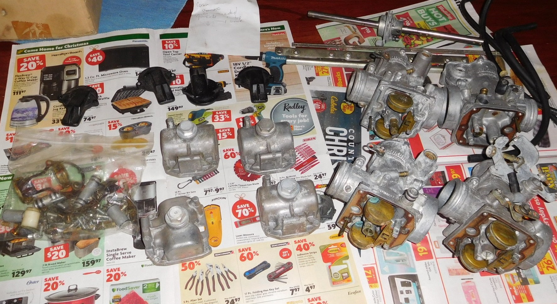

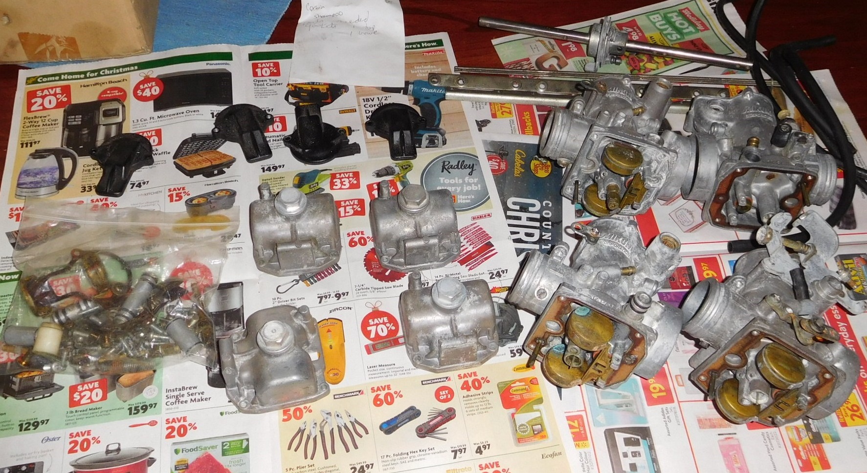

Mine were rebuilt cheap and nasty... Pine Sol soak and elbow grease
I did replace some rubber parts and fix one float (solder job)
Over all they were not that bad, some jets were seized but I got a torch out and they broke loose.
They just had some normal corrosion on them from years of use.
I did have to fix some PO installed sync ports that were drilled to the wrong size for adapters, redid them at M6 then installed button head Allen bolts with O rings.
I chose VM's over RS flat slides because Larry C had them on his 1200 and he liked them a lot, plus they look more stock than a set of flat slides. I am going for a mostly stock looking build except its a 650 with a 1000 motor in it.
