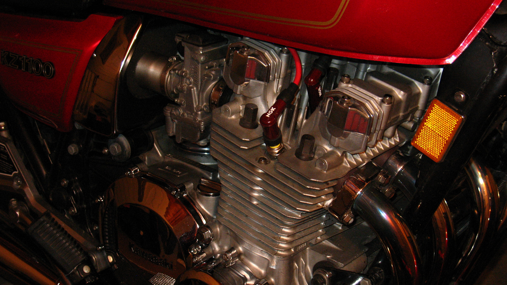

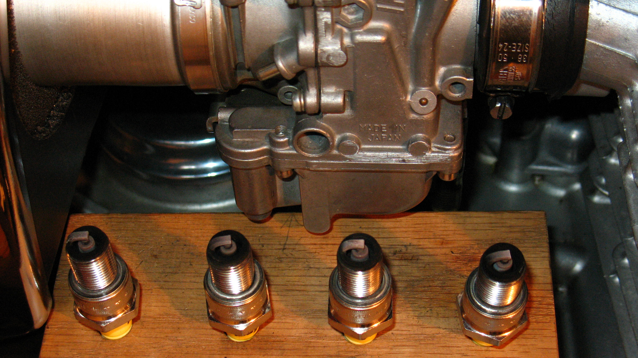

Pulled the plugs this evening and took a couple pics. Aside from the carbon on the outer ring, I think she's sitt'n pretty with the jetting.

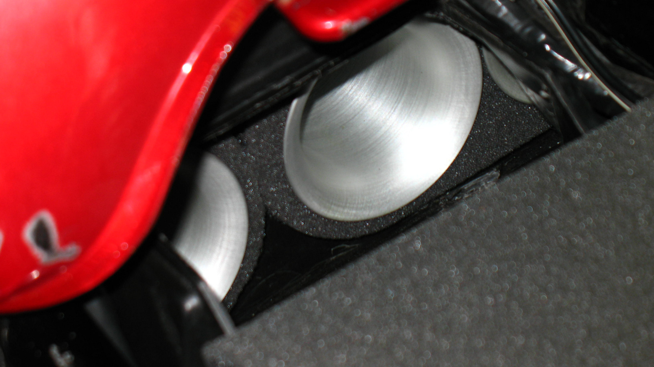

Figured I'd add another pic which partially shows the widened air box that is still going strong. I'm done with rubber air boots. The stacks open inside, just behind the RAM AIR filter media which seals them at the front, but permits air to flow into the box around the stacks as needed. Most of the air supply passes through the original intake opening beneath the seat, but the cover and snorkel are replaced with filter media over the hole. Way I figure, let the motor pull in whatever air it wants, through a well-filtered enclosure, which also serves to dispose of the engine fumes and oily vapors via the breather filtration system that was originally designed into it.
Maybe that is where my oil is disappearing to. :S
Air box interior as viewed from the back. No air filter media covers the stack openings inside the air box. but one 6" square piece is fit over the snorkel lid hole.
