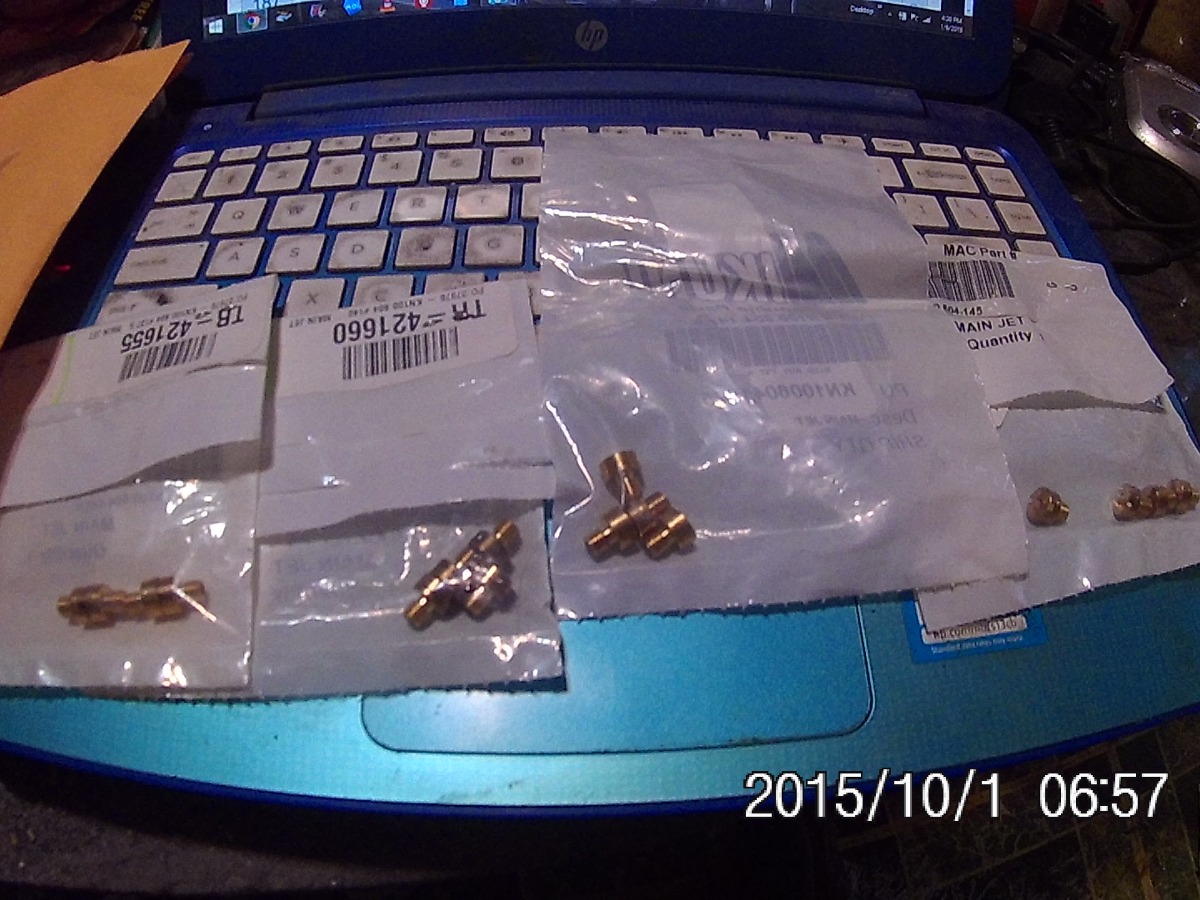

Need the 135's.

Got my jets. Gonna put them in tomorrow.

I'm going to pick up some 137.5's

One of our members sent me his extra main jets. 137.5-145. Thank you Dave. Our members are the best. Now I can play with the main jetting all I need to. I have to take my truck to the high desert for a few days, so Bossie will have to wait until I get back.

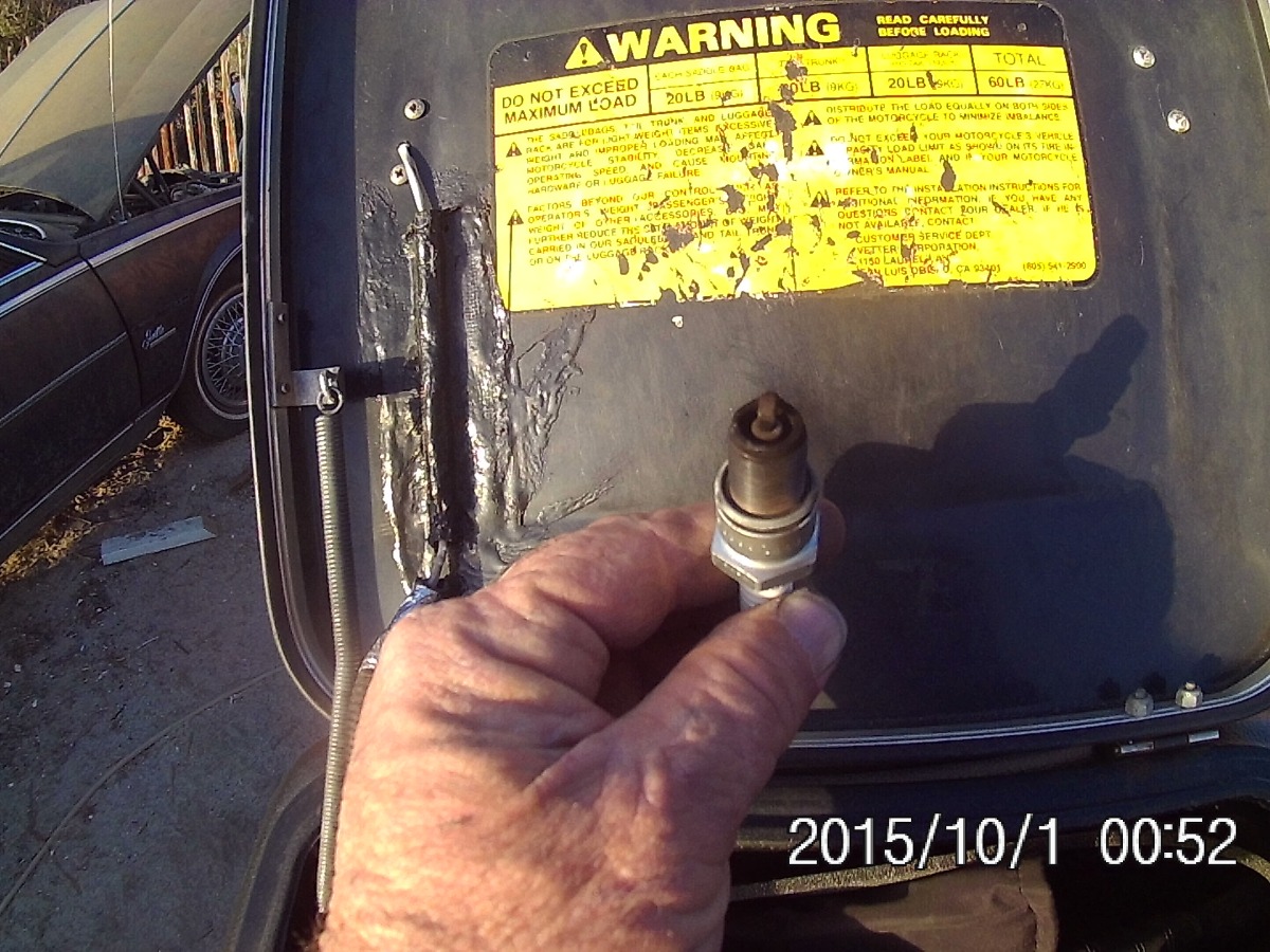

Exhaust sounds deeper at WOT and pulls a little stronger. Now it seems a little fat on the bottom. :dry:

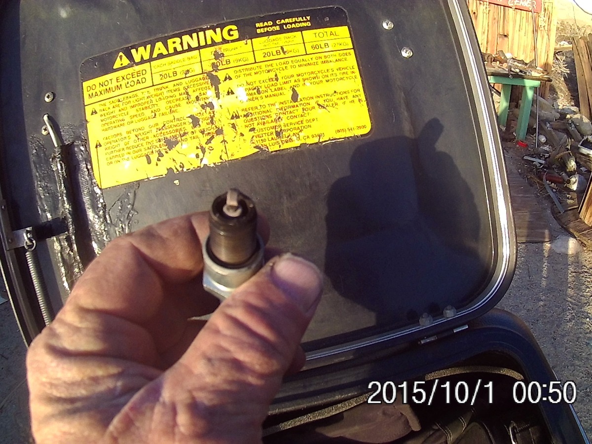

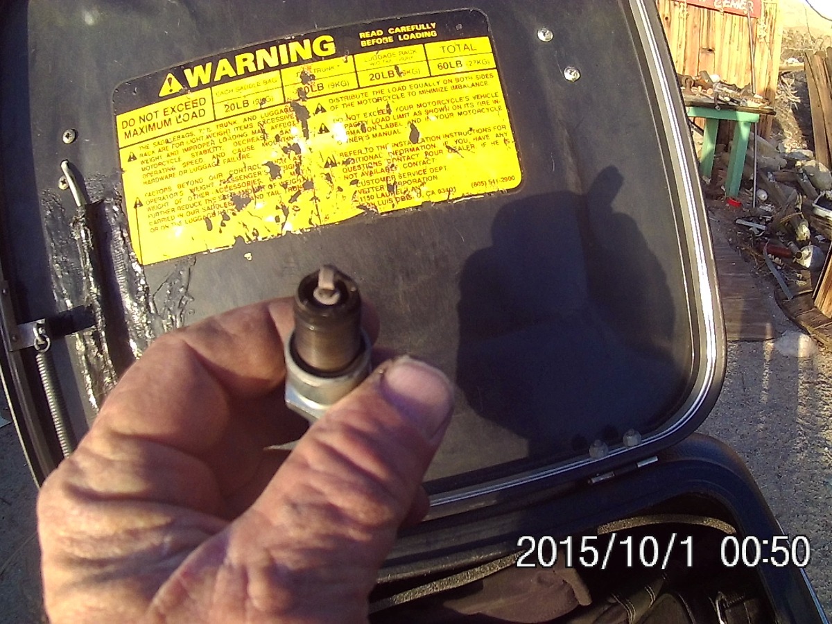

Went back to the 45 pilots. Revs crisper and pulls harder off the line. Now I have to dial the blub blubs out again. :dry:
