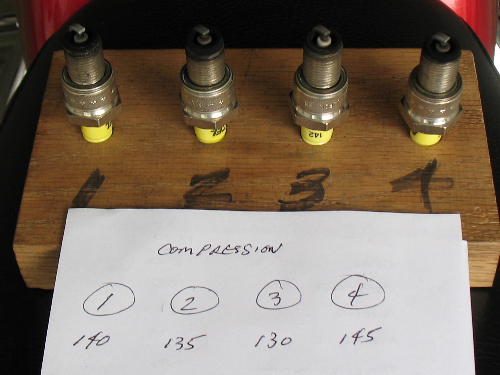

Had a thought after examining spark plugs and checking compression...
Would #3 be lean due to lower compression in that cylinder? If so, would having a richer air jet in just that carb serve to compensate?
Might be from air getting by that manifold at the head. Will be installing a new set this weekend.

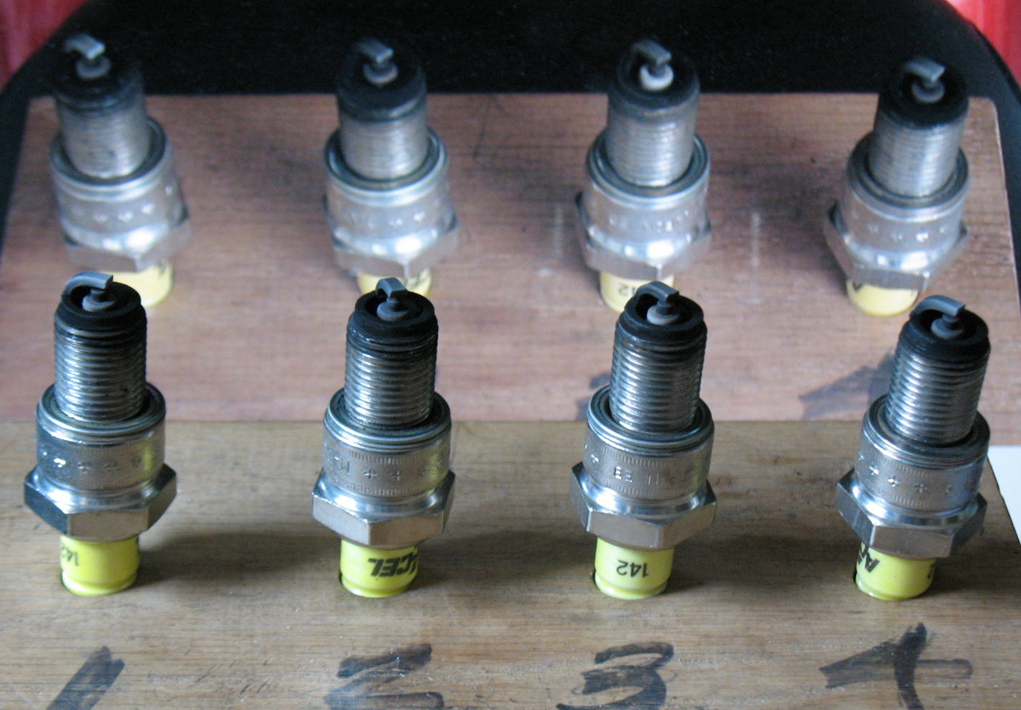

Rode 80 miles today after swapping out cylinder three air jet to .5, leaving the others .6's.
Immediate improvement; smoother idle and better throttle response through the entire operation rpm range, with only a slight adjustment to the fuel screw. Hardly any pops now when letting off throttle and between gear shifts.
Will post pic showing plug condition after riding some more miles.

Curious how far your rubber intake boots project inside your air box on 1 and 4, and if the air flow may be somewhat restricted compared with 2 and 3
*Approximately 150 miles later #3 spark plug color appears less-lean, and more as the others:
