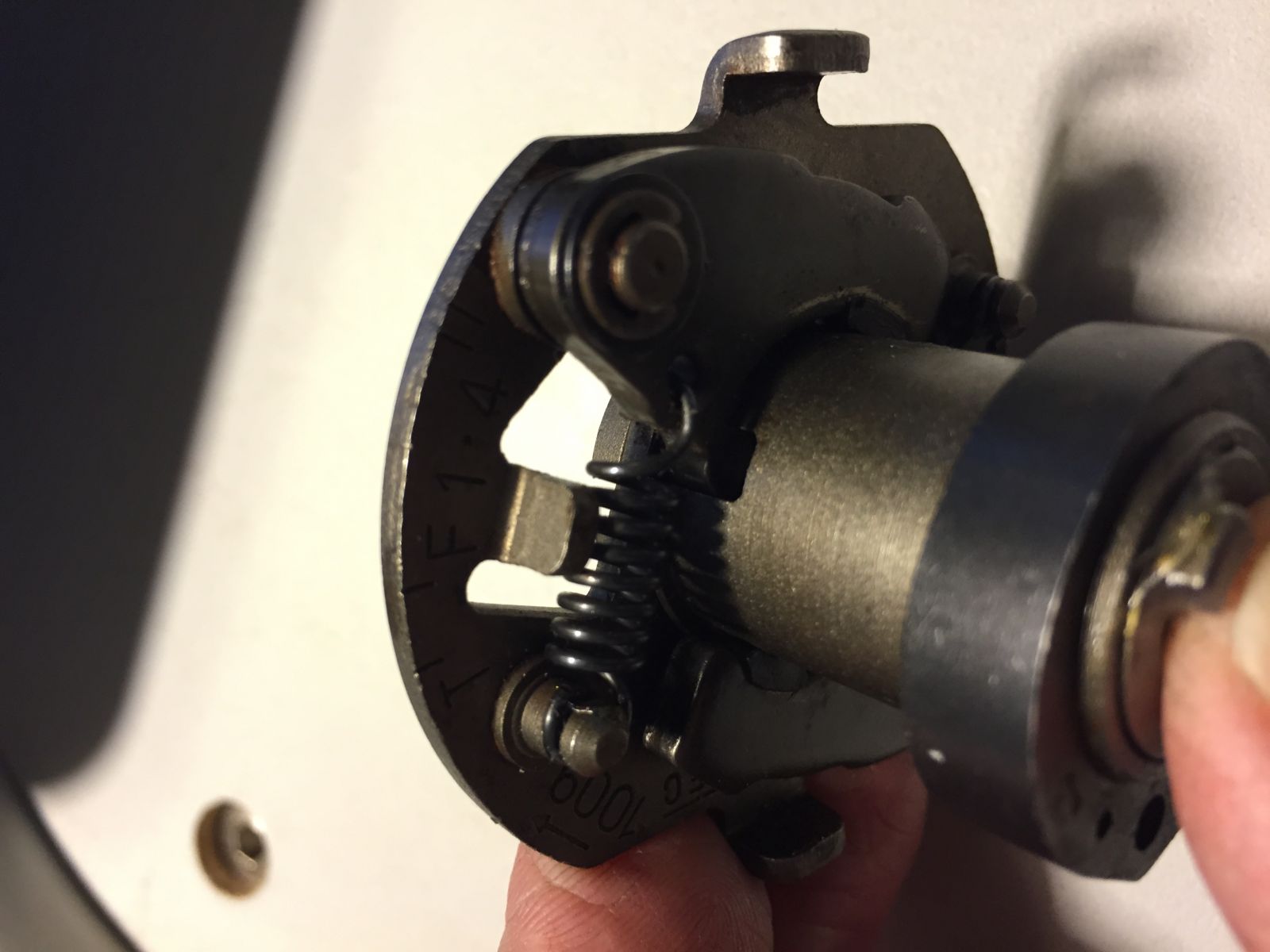

Well I'm not at home so it's not in front of me but I'm willing to say its prob an anomaly and it's the edge of the seal that's behind the advancer

I think it is a reflection of the machining of the actual notched shaft, pressed into the backing plate.... that connects to the crank.
