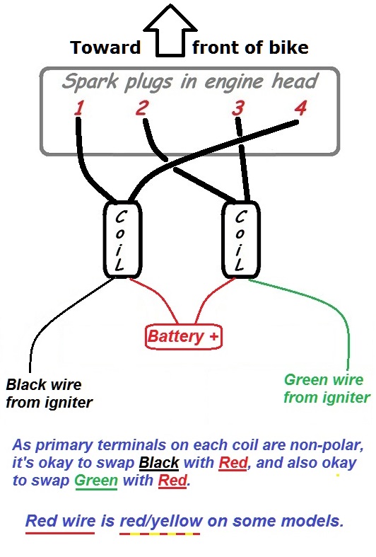

01 May 2015 04:56
#670236
bromz wrote: Red wires are on the common side of coils and black and green wires are on the positive side of coils.when you say signal wires reversed are you talking polarity?
Not polarity.
The dual-output ignition coils that I'm familiar with have a non-polar primary winding.
Am thinking that most KZ ignition coils are non-polar and do not have any polarity indication such as plus or minus.
However, there is I believe at one KZ650 model that has + and - marks on the primary terminals. And there may be others. But I don't know the purpose of having primary polarity.
In the case at hand, am thinking possibility of the signal wire that's supposed to be attached to the port-side coil being erroneously attached to the starboard-side, and the the signal wire that's supposed to be attached to the starboard-side coil being erroneously attached to the port-side coil.
In other words, possibility that the signal wires are attached to the wrong coils.
