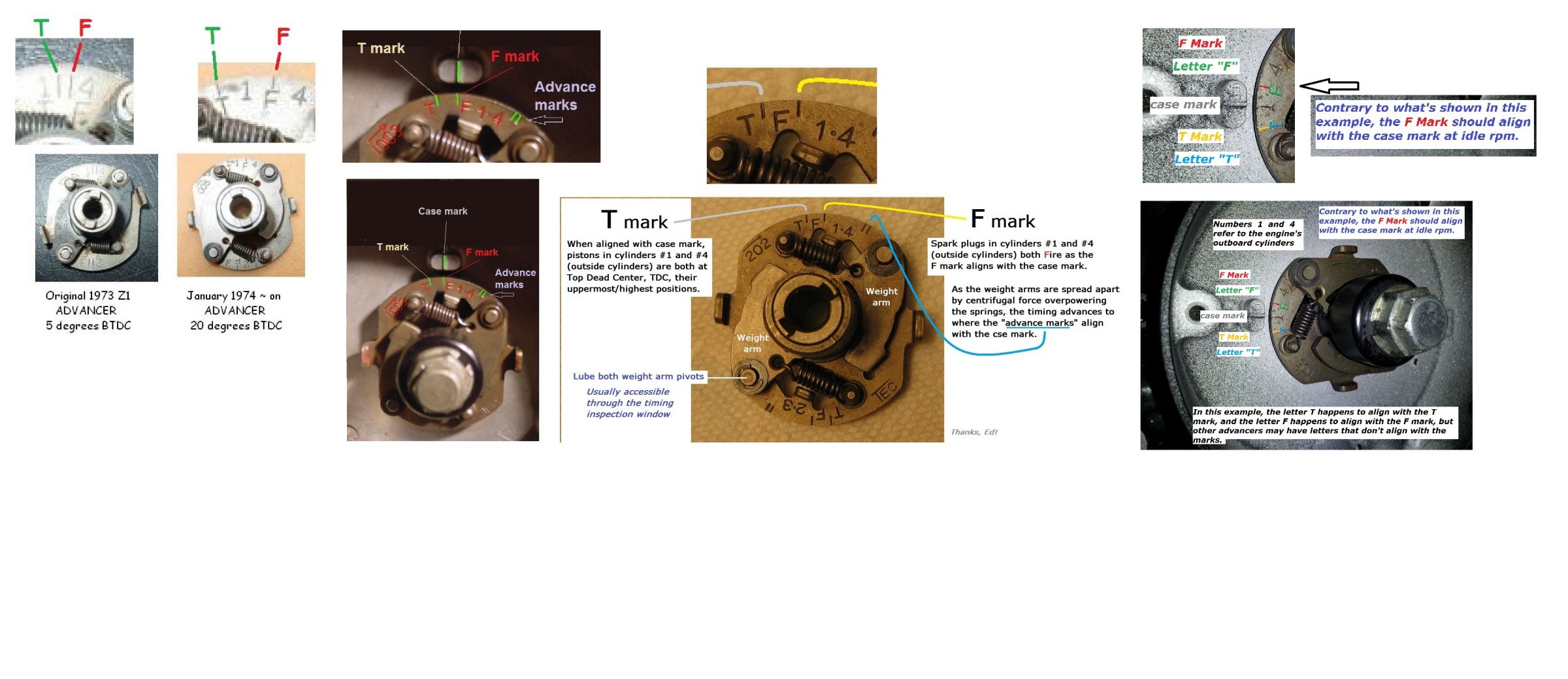

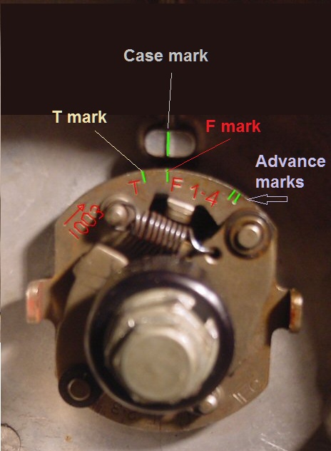

Do the timing marks on the advancer at hand look like any of the following examples?

I got the number 2 exhaust to .110 as far as the advancer and mark I will have to take some pics and yes stock ignition
