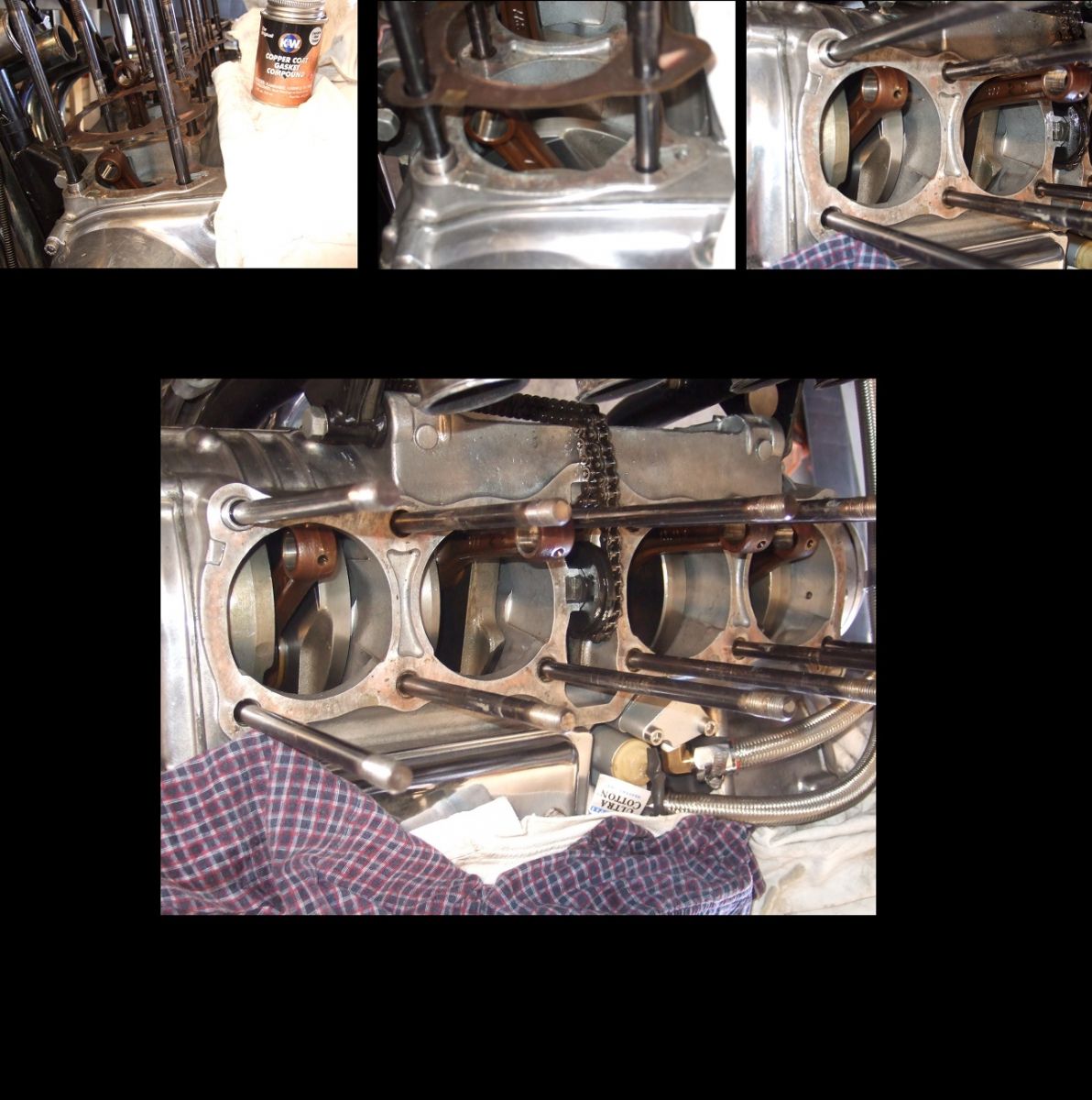

Simply put....
Soak + toothbrush, don't use metal/wire wheel brush (use soft Nylon if required) for will scratch the dome surface....
Simple Green...
Can of Copper Coat...
While head off, new seals....
New rings a must...
New Piston clip rings...
Hone the cylinder bores...
New gasket kit (base & head)...

2. The honing of the cylinder- Is there a thread that goes into this process with a little more detail? Seams like a very important step, and I don't want to screw it up. OMR suggested a "flex-hone" tool, but there were also 3 drill attachment brushes (soft, medium, coarse)- are these used to hone the cylinders as well as the flex tool? or are they used to give everything a real good cleaning?
3. How essential are the "new piston clip rings"? Can they not be re-used?
4. What is "copper coat", and what is it used for?

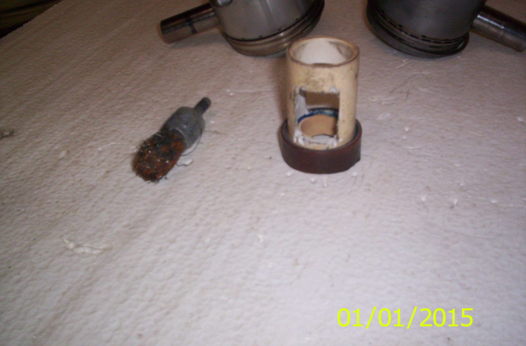

It depends on the condition of the bores. Is there a ridge at the top? I like the three block hones. A good mechanic can pull out a slight ridge with one but for most people it's best to have it done. That hone job is a little too much for my liking. It's easy to take away too much metal and have a sloppy bore. A good 45 Deg. cross hatch is ideal. You use the course stones for this. I use a wire brush attachment to clean the head. Leave the valves in while doing this. Fine clean after the valves are removed. I use a C clamp and a piece of 3/4 PVC to extract the valve keepers. First use a deep socket to loosen the valve retainers then use the PVC cutout to remove the keepers with a magnet. Tweezers to put them back in. I was going to donate a deep spark plug socket to do it but I don't do enough of these to justify ruining a good socket.
