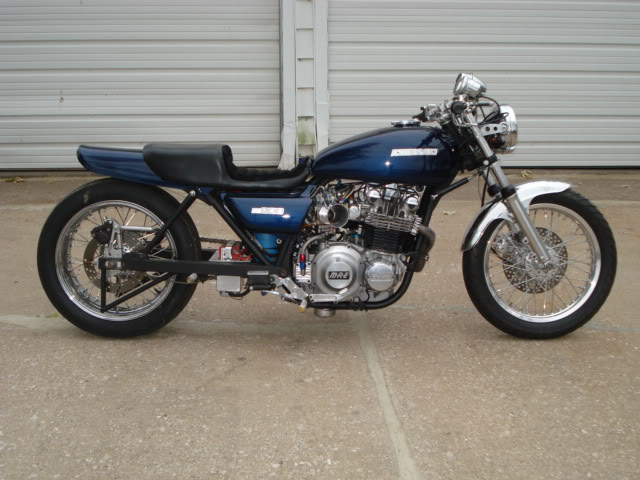

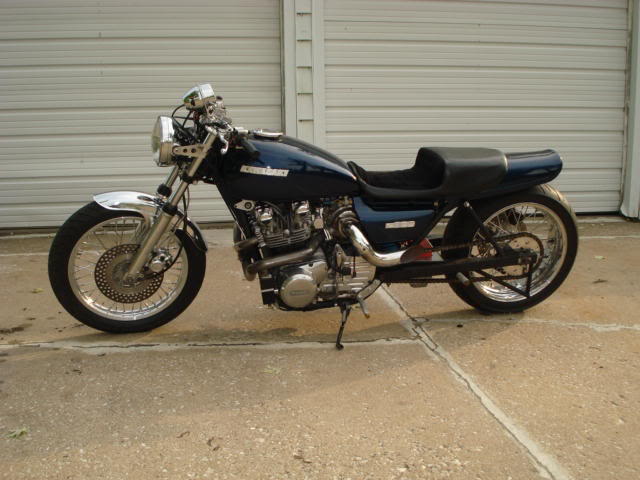

- Jeff.Saunders
- Posts: 1238
- Thanks: 149
Re: turbo time....
24 Oct 2012 20:12 - 24 Oct 2012 20:13They do - it's just in different places on different setups. On my bike it's very obvious - the rectangular box under the pipe - just where it wraps around the engine.
