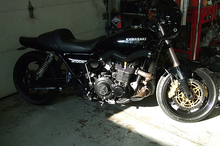

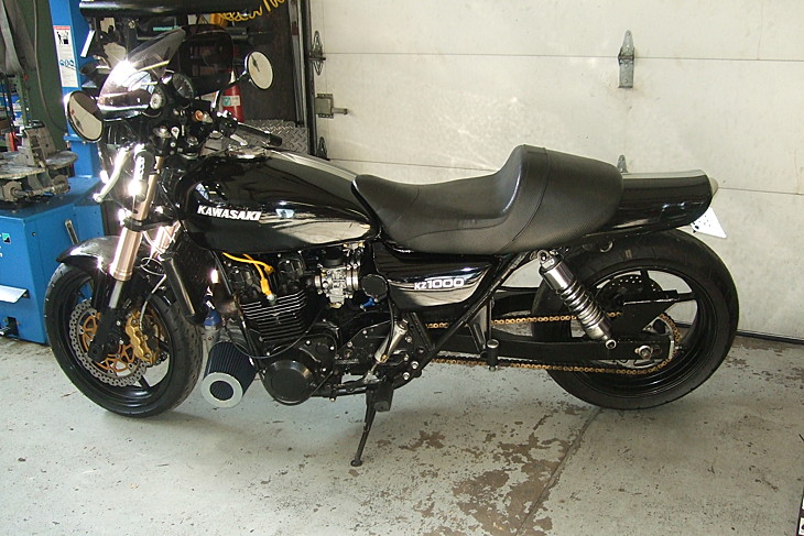

Here is 2 pics of a street turbo setup I really like.
Note short exhaust to front mounted Turbo and long hivolume tubing to intake ports.

any more info on that cause i love it. i wanted to do a front mount but im not raked at all and i dont have a jig to do it correctly. i guess i could still do it. i wonder if it takes longer to spool with that large diameter charge pipe. my reasoning behind the front mount turbo is less lag and cooler air. plus you have room to run a small intercooler.

only thing i dont care for is the blow thru on the cv carbs.

I run the 42 carb on my bike like Jeff has, It has alot more potential to make power than you will ever possibly use.
As a Turbo Layman.. Turbos like short exhaust headers feeding them for quick response. They also like short exhaust from the turbo for no restriction .
I am of the opinion that the long hi volume intake tubing is a positive and wouldnt worry about lag. Remember the whole intake will be pressurized and the hi volume should insure good cylinder filling. ( Read it somewhere )..
A proper hi flow , low restriction intercooler is a big plus for a turbo system that I can only dream of based on my Mr Turbo designed system.
Go fuel injection at the ports if your able to.
Hope this helps
