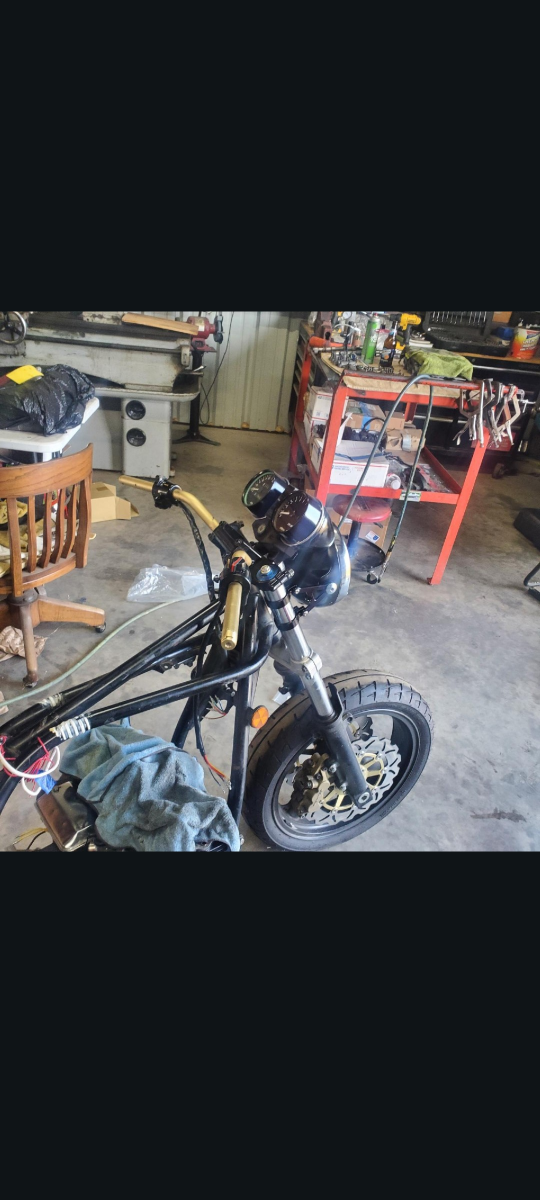

Re: 78 KZ 1000 build
09 Sep 2025 19:49
#916966

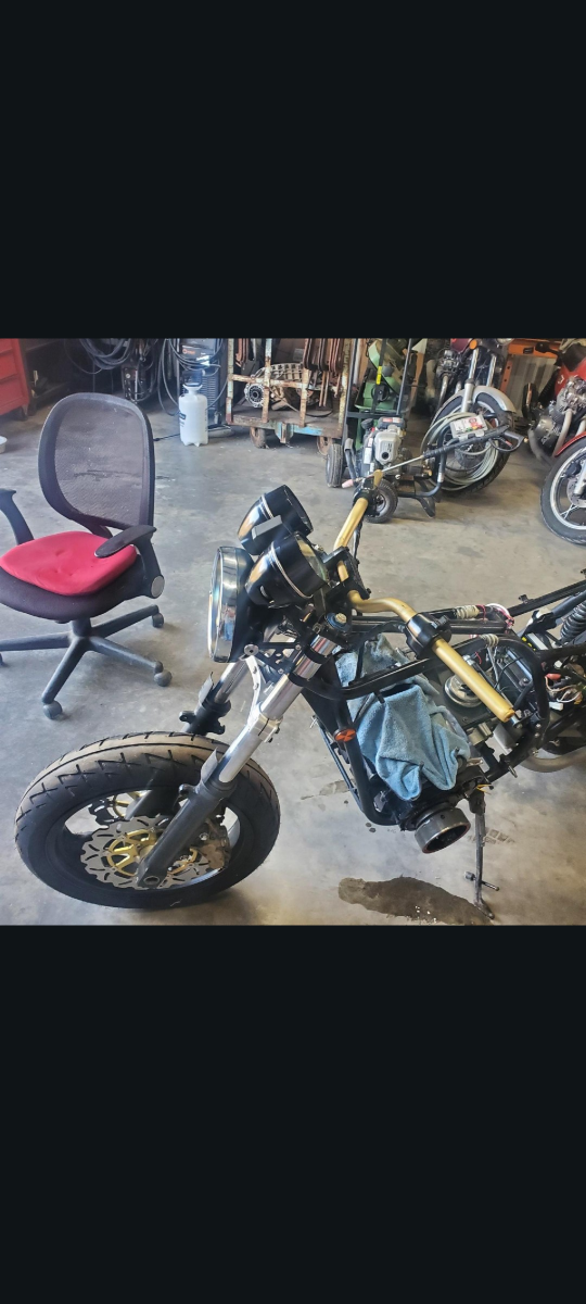

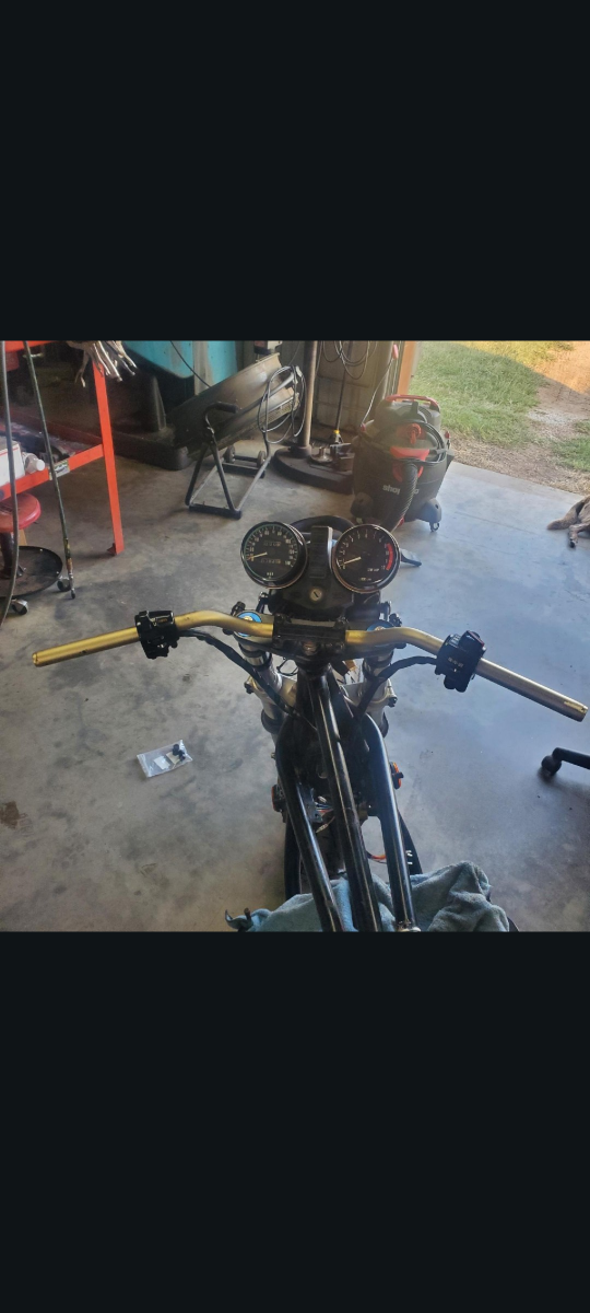

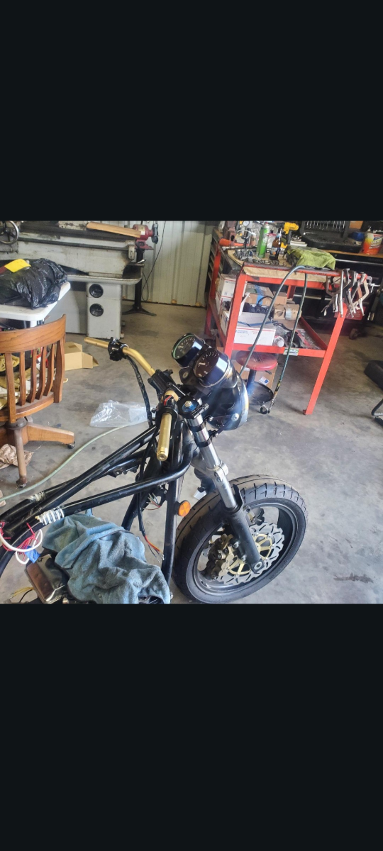

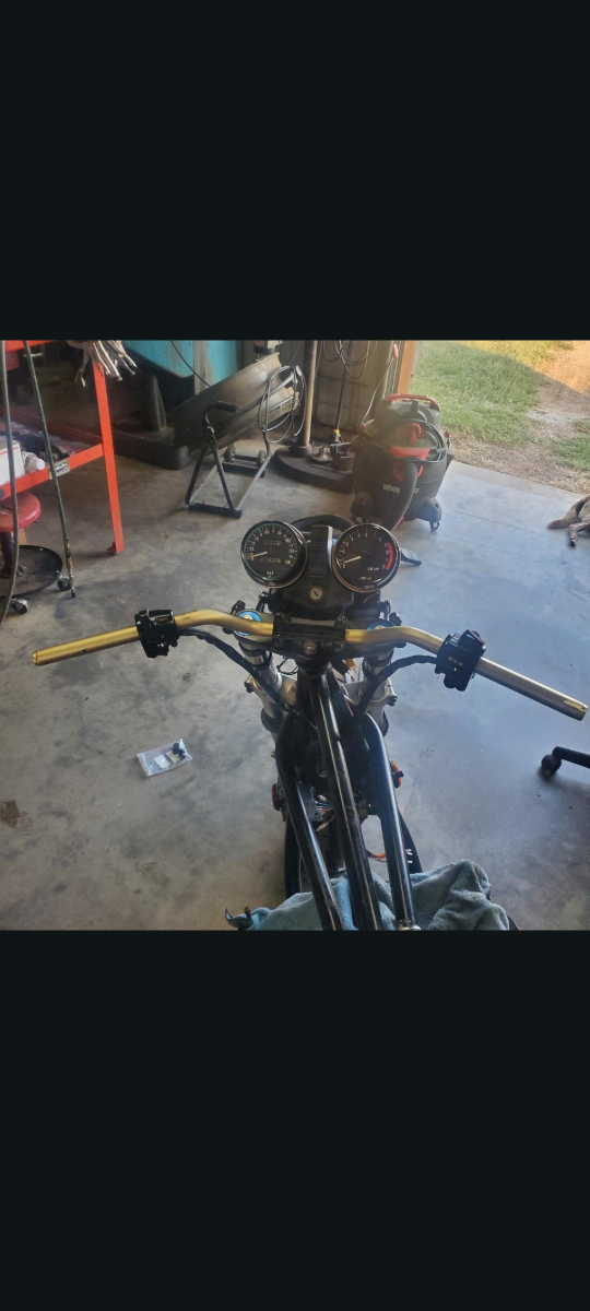

Cutting and welding to mount the 78 clocks to the ZRX head...

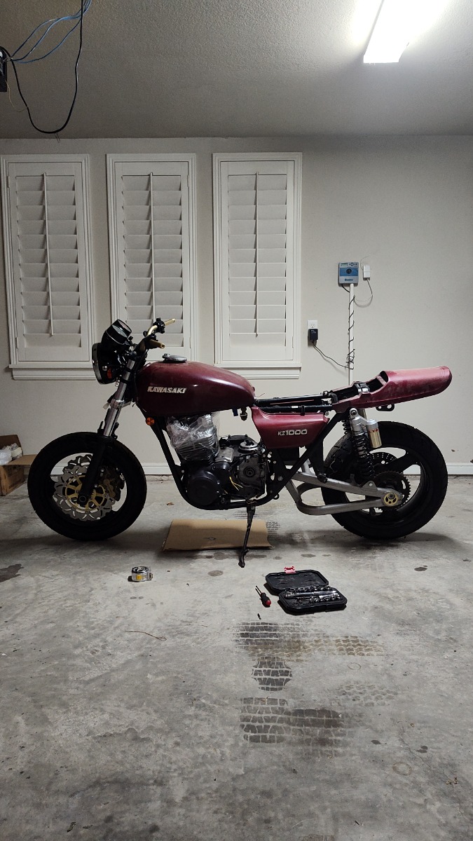

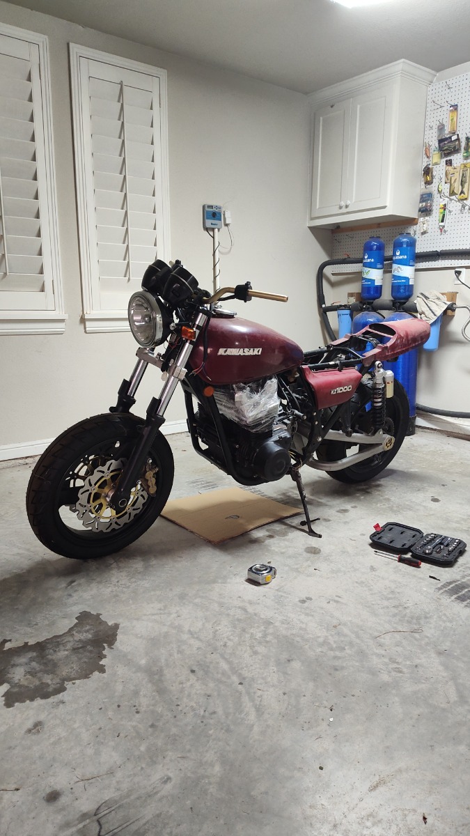

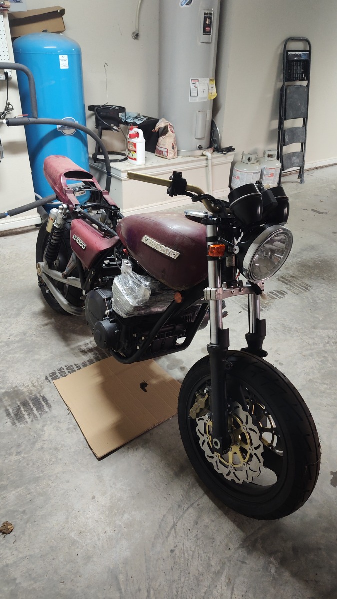

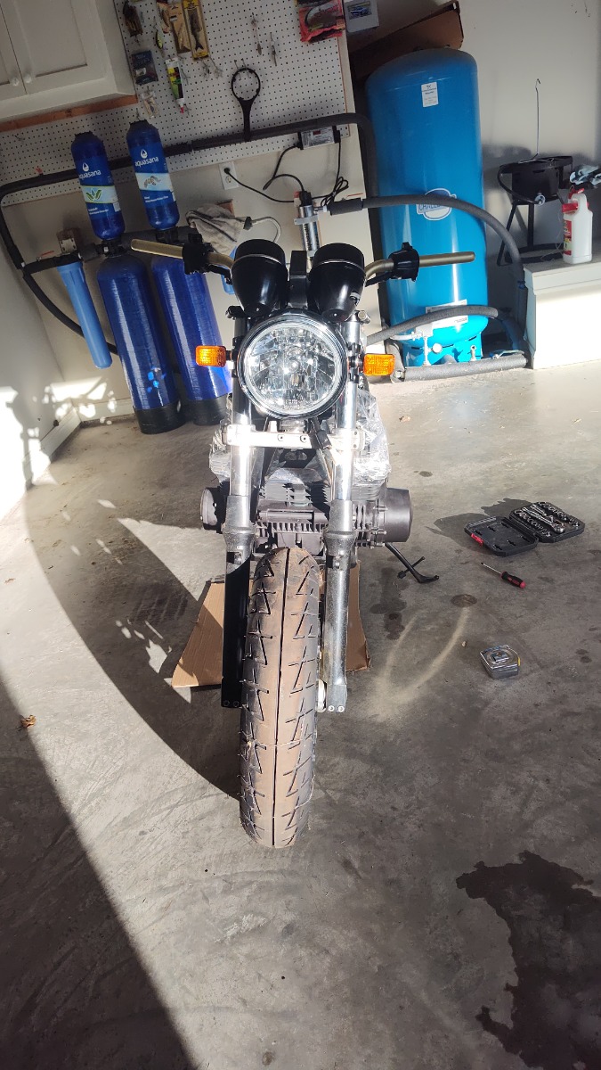

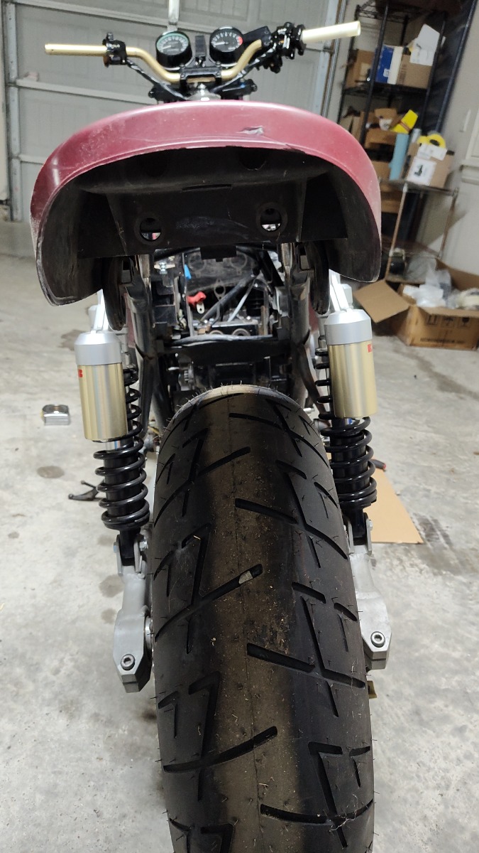

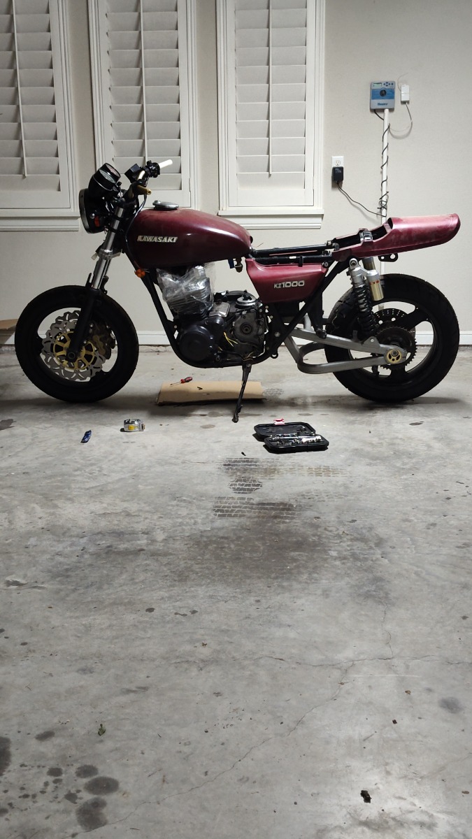

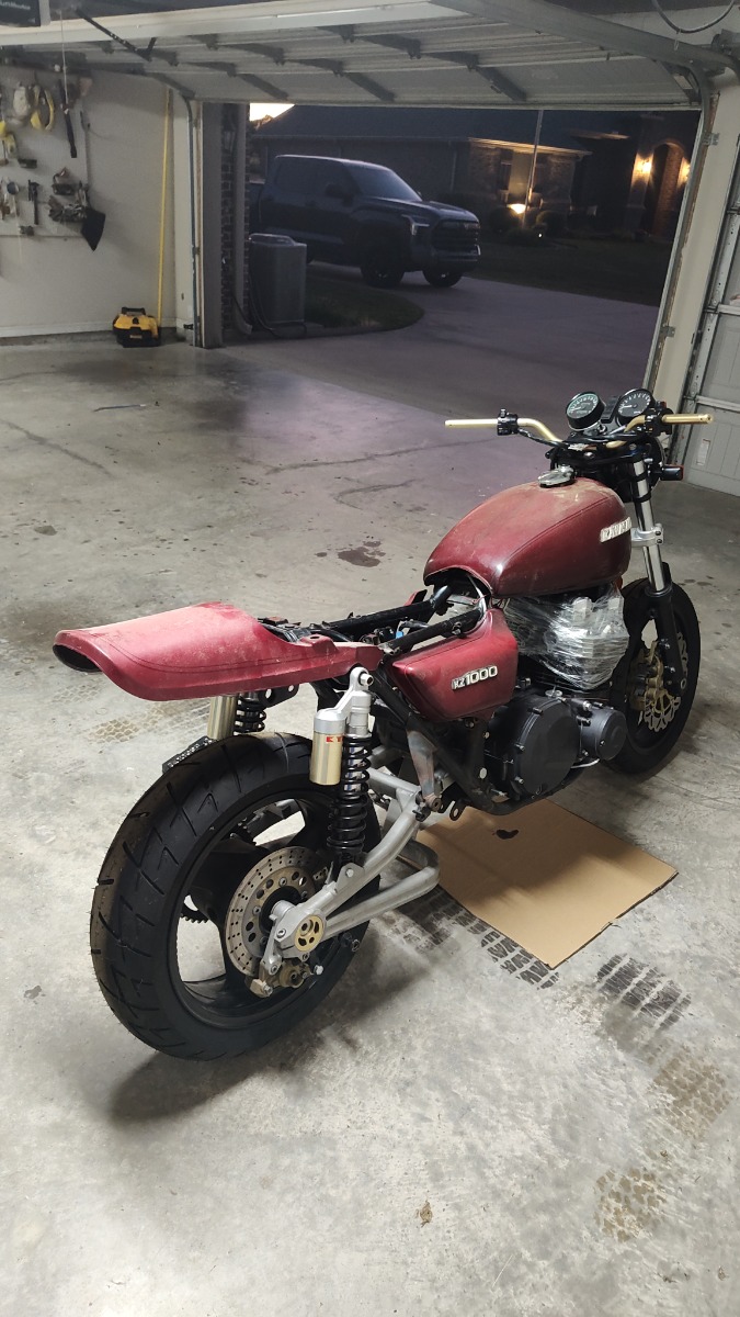

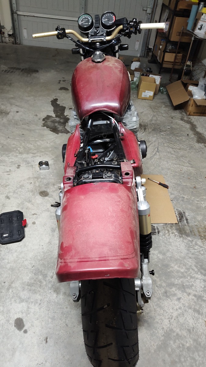

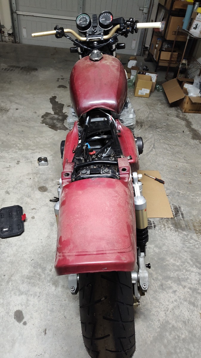

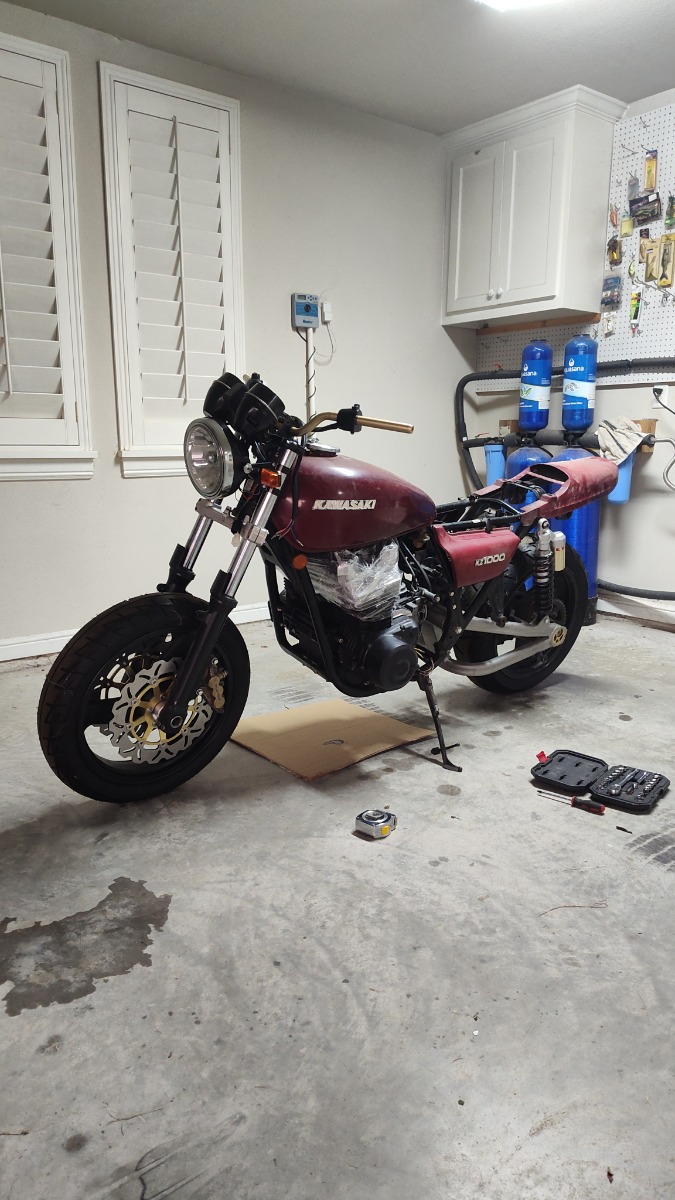

Sent the stock cams to APE for a K410 regrind with about a six week turnaround so I'm starting to fit things to what works and what doesn't. A little more progress.
Last edit: 07 Nov 2025 12:56 by Street Fighter LTD.

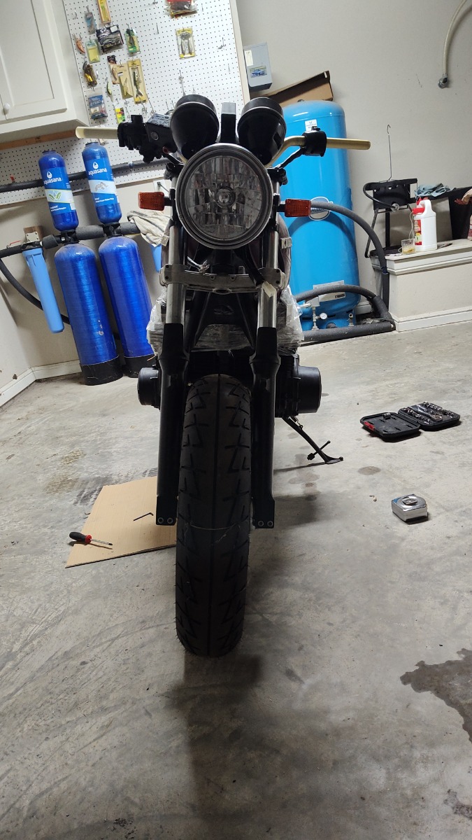

  • Formula264
  • Formula264's Avatar Topic Author
  • Posts: 153
  • Thanks: 83
22 Oct 2025 07:52 - 07 Nov 2025 12:56
#918261

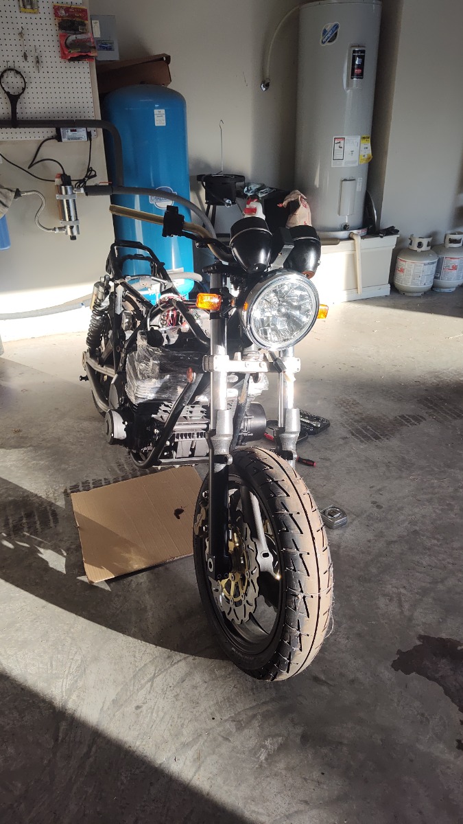

  • Formula264
  • Posts: 153
  • Thanks: 83
22 Oct 2025 07:54 - 07 Nov 2025 12:57
#918262
Last edit: 07 Nov 2025 12:57 by Street Fighter LTD.
  • sf4t7
  • sf4t7's Avatar
  • Posts: 1038
  • Thanks: 890
22 Oct 2025 17:40
#918286
Yes, we do love pics. Thank you!

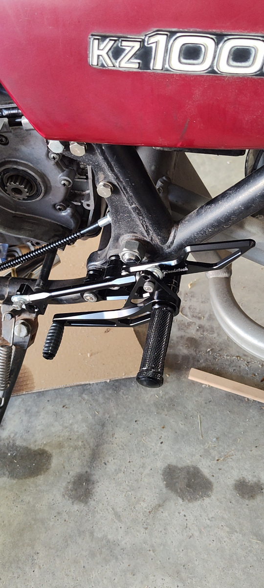

07 Nov 2025 11:23 - 07 Nov 2025 12:58
#918831

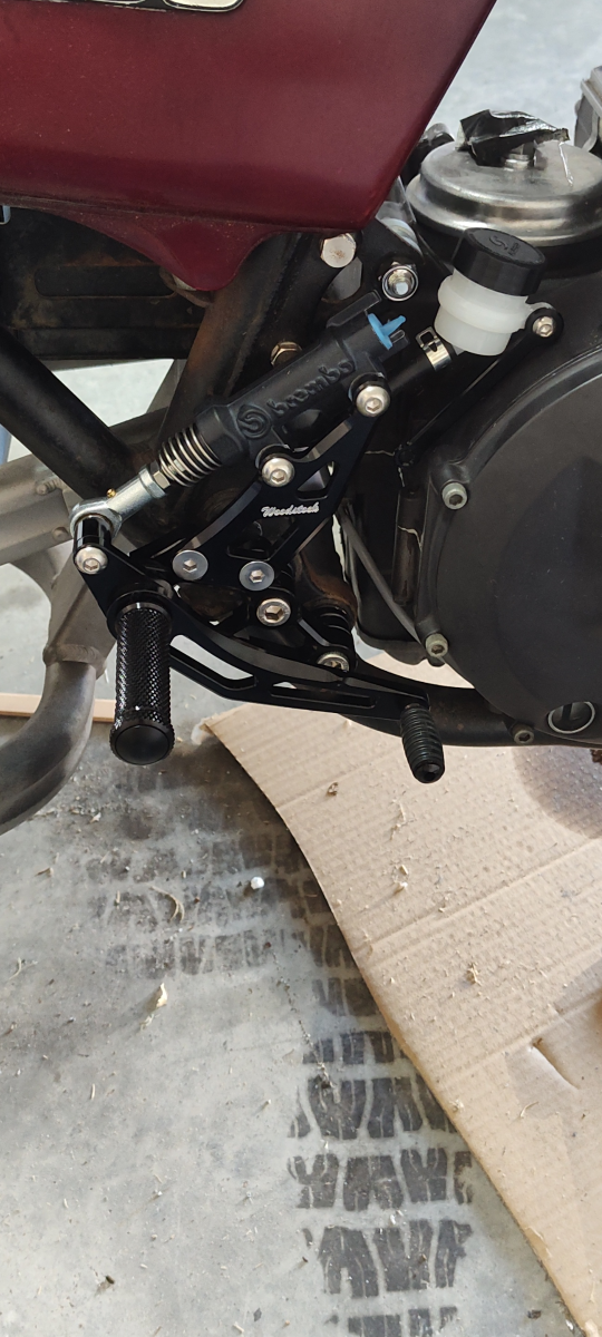

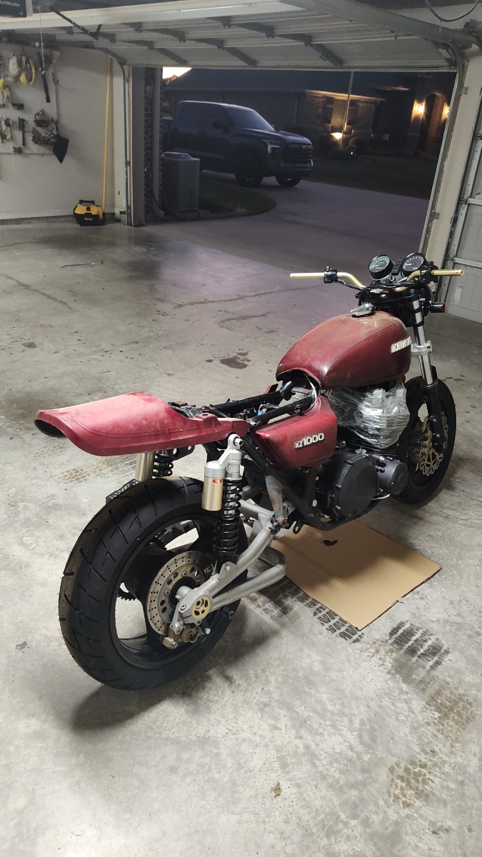

Got the rear sets installed, just have to dial in the shifter(GP style)and hook up the master cylinder..
Last edit: 07 Nov 2025 12:58 by Street Fighter LTD.
