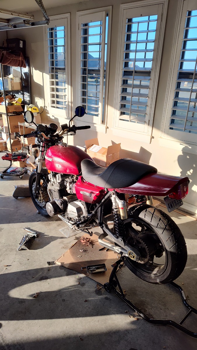

501821.jpg[/attachment]

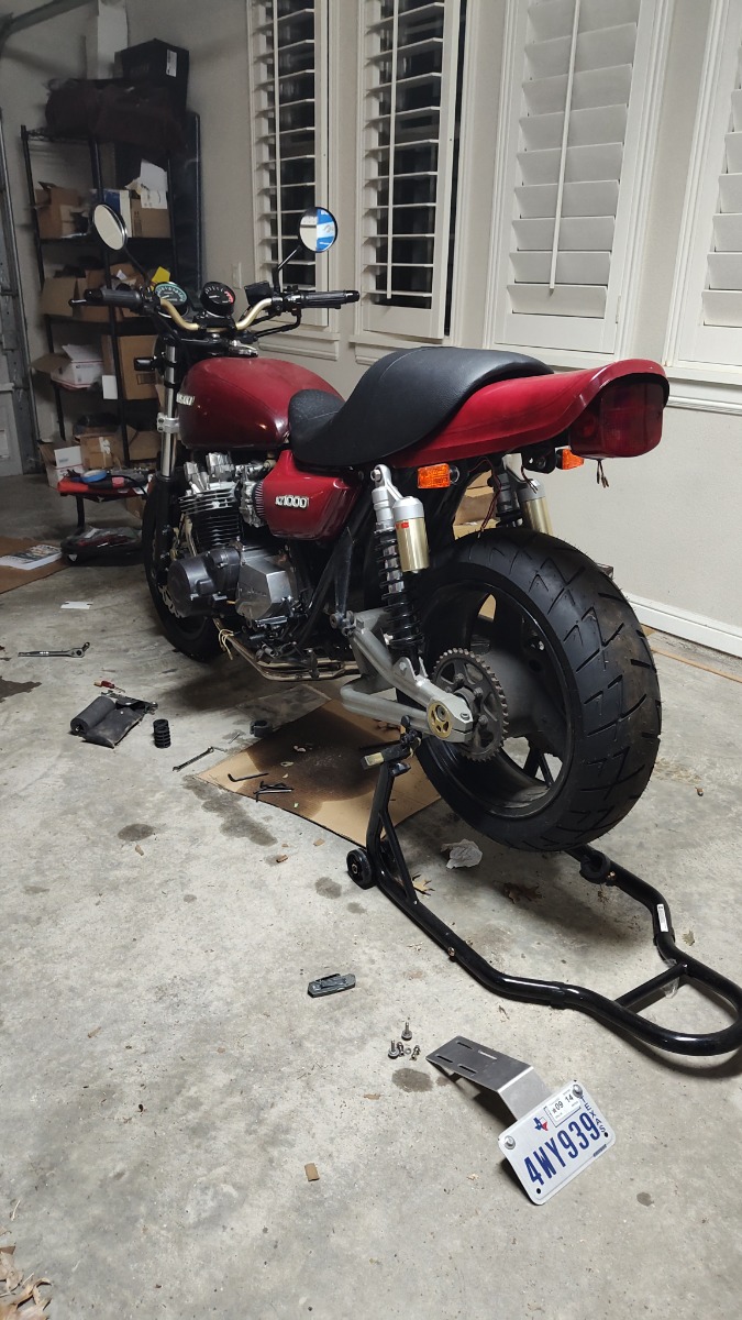

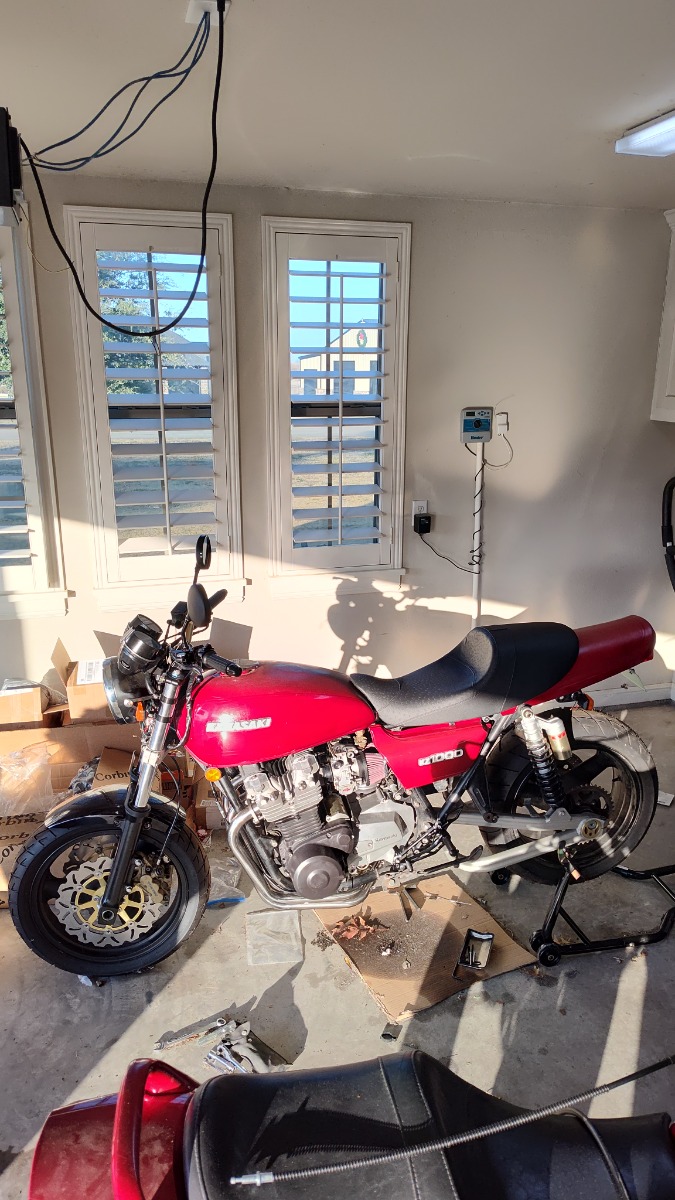

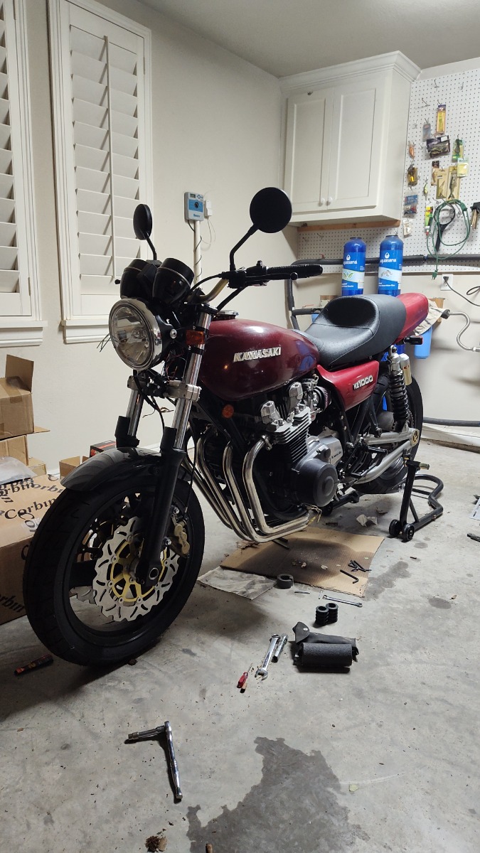

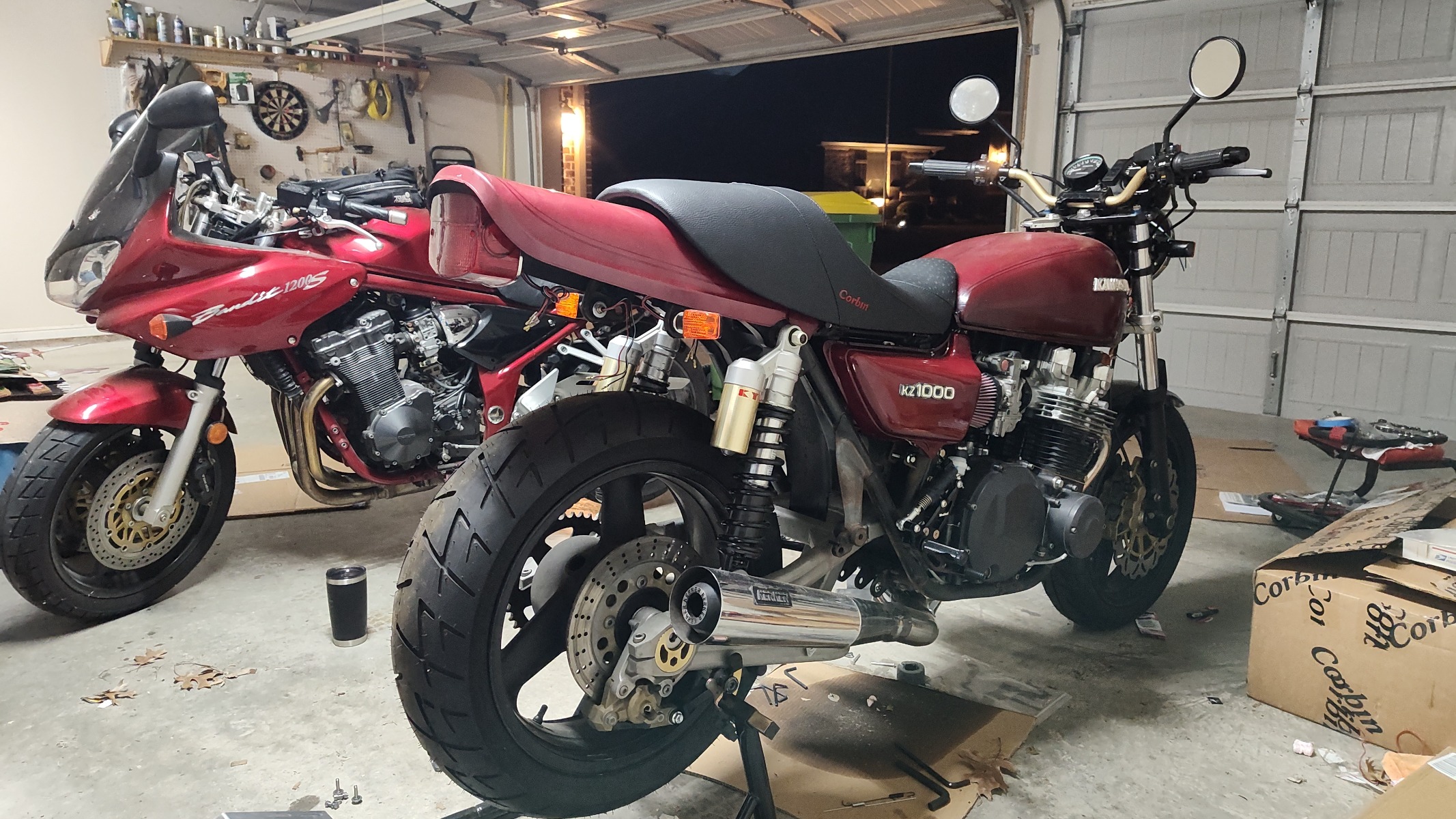

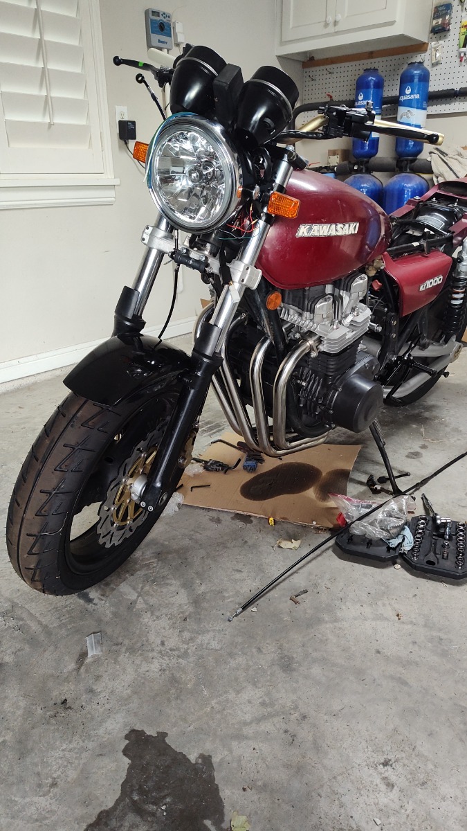

Well, a little more progress. Got a set of superbike throttle cables that worked out great for the ZRX bars to the 34mm smooth bores. I have to modify the clutch cable from a 1981 KZ(just an inch or so too long) and received the Corbin seat today. Also my reground cams came in from APE so the engine will be done and fired up in a couple weeks. I have wired in for the electronic tach(81' engine was electric) and I think it's coming together. Still have to configure the rear master cylinder to the rear brakes/rearsets and make a brake line as I think a stock ZRX line won't work. I had the original KZ body parts ceramic coated just to see how it would look and I have to say, I'm liking the patina. Custom paint might be in the future but all in all it's looking pretty good. A few pics of the seat...

Thanks Wookie! It's been a pleasure/journey and appreciate all the help and input, great group of people here! So far everything on this bike sans the rearsets have come from a Kawasaki . A mix of old and new, can't wait to test ride.

I was having a problem getting the Corbin Seat to fit but figured out that the fender eliminator kit was interfering with the rubber bumpers, so got that worked out. I had to cut and resolder the clutch cable to get the right length so now I have a clutch! The speedo cable from a 78' KZ works with the ZRX speed gear to the 78' speedometer so that is working out. Last big things are finishing the motor and getting the chain/ sprockets to align. And of course finish the wiring. I'm stoked!

01 Feb 2026 17:51
Yes, it's so close I can smell it! Still a few things to work out as I'm not sure if or how off the chain alignment is. Have my rear brake line coming from Spiegler. I need to figure out the transition from header collector to baffle but shouldn't be a big problem. 90% done I'm thinking?
