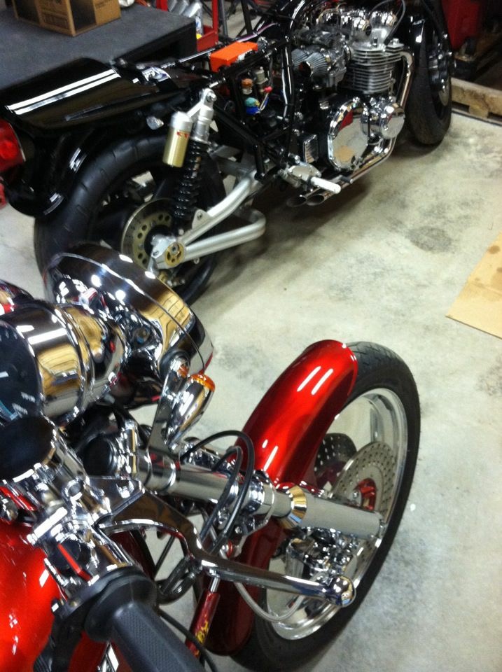

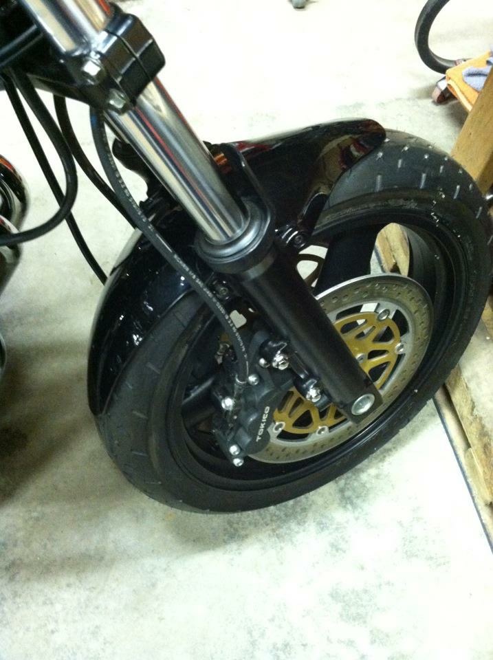

Yes I would like to see the fender pics, thanks

These are a couple that I had on my phone.
  • Formula264
  • Formula264's Avatar Topic Author
  • Posts: 156
  • Thanks: 83
Re: 78 KZ 1000 build
20 Jun 2024 16:43
#901049
Very nice, I hope mine turns out anywhere close to that. Was the fender a direct fit or did you have to modify and what was it off of if you don't mind my asking?

It was probably ten years ago when I built that. Can not remember who I purchased that fender from. Possibly Airtech as I used to purchase body parts from them.
  • rivman15
  • rivman15's Avatar
  • Posts: 112
  • Thanks: 34
21 Jun 2024 08:01
#901070
I do remember painting it separately as I already had the rest of the bodywork done.

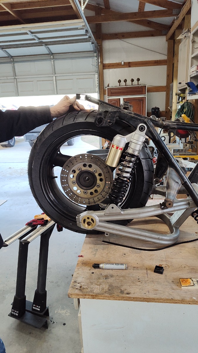

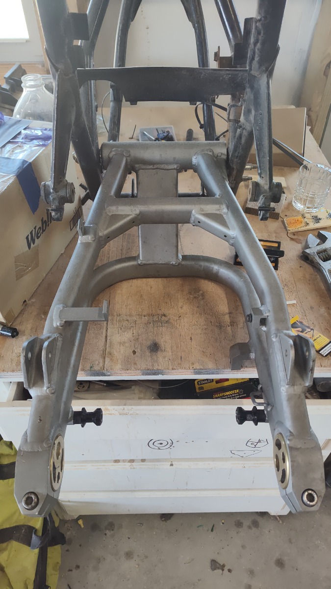

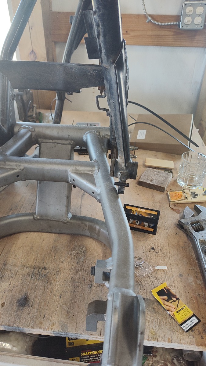

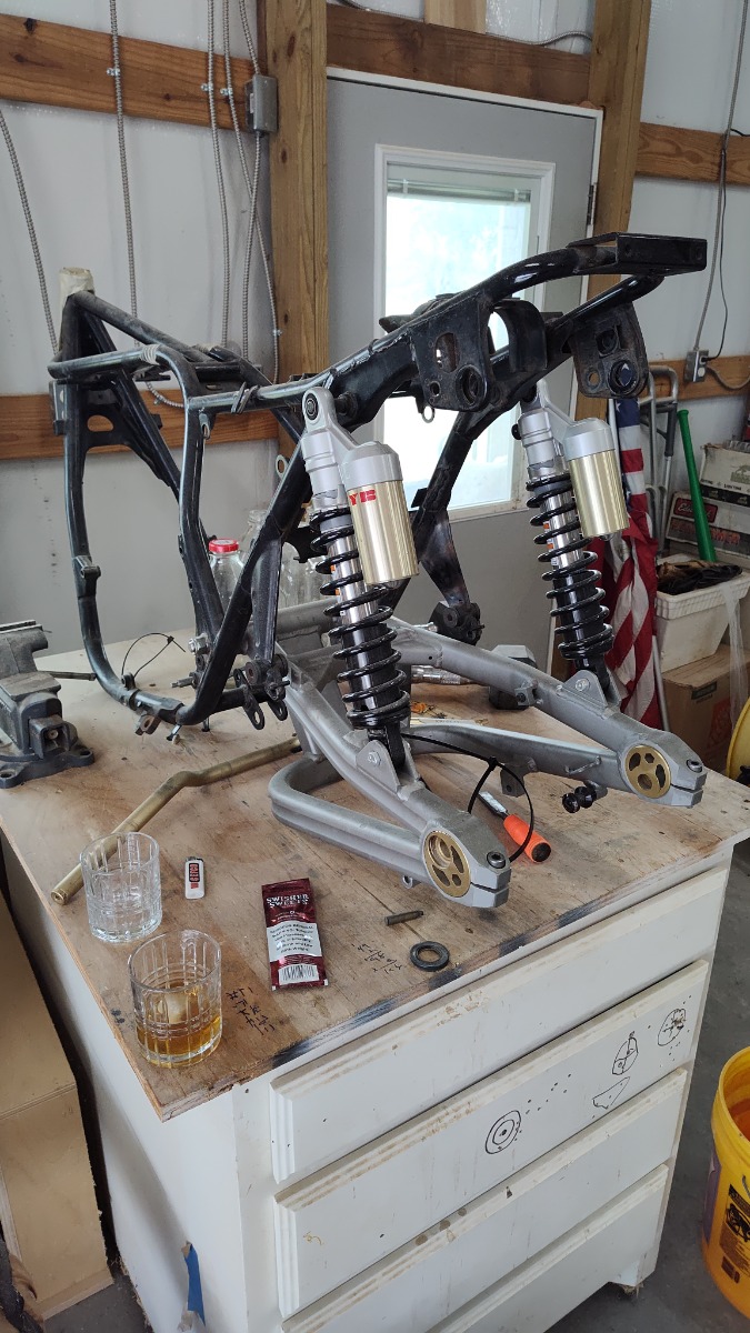

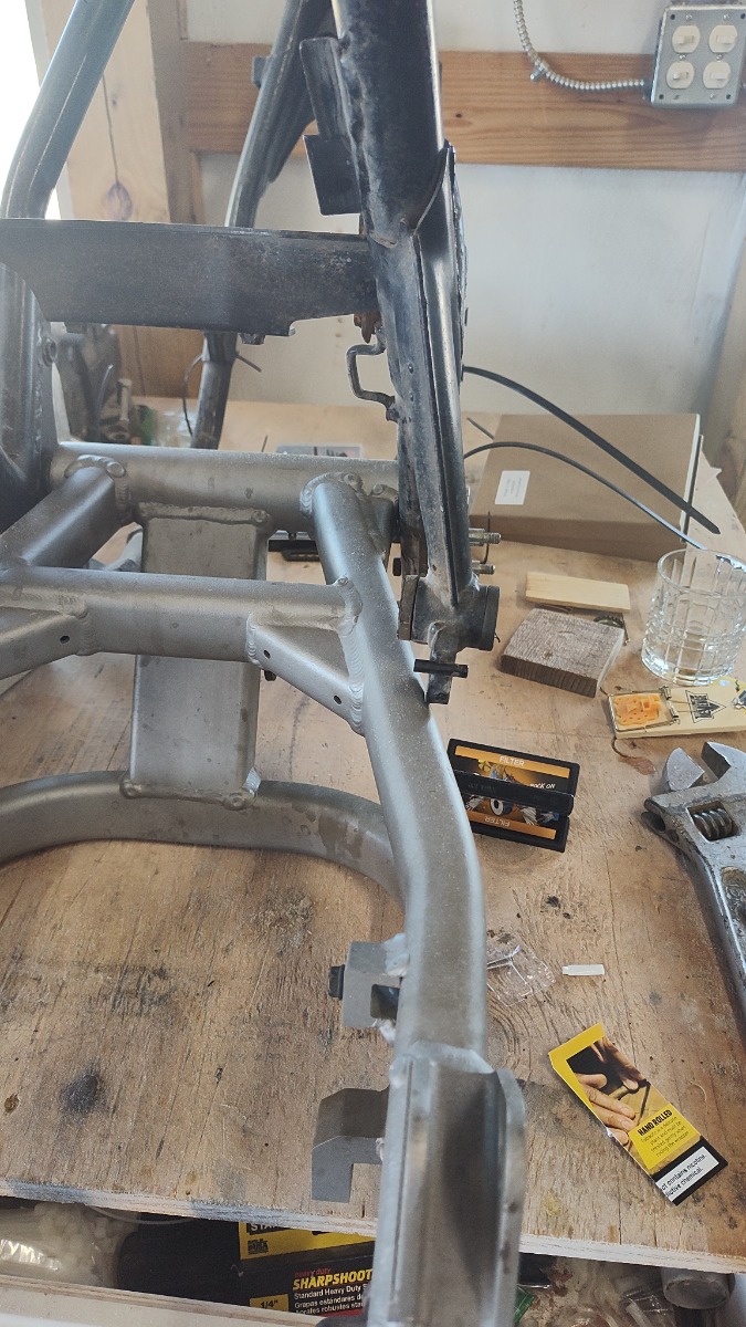

Well, I'm back on my project, haven't done anything since June. We finally have the ZRX swinger to fit and installed. Here is a small issue with the right side rear foot peg mount is hitting it. It looks to me like it is bent inwards and all I have to do is bend back out?
  • Wookie58
  • Wookie58's Avatar
  • Moderator
  • Moderator
  • Posts: 6918
  • Thanks: 4341
27 Dec 2024 12:34
#907207
Hard to tell from the pics, I would suggest using heat before you bend it back
The following user(s) said Thank You: SWest, Formula264

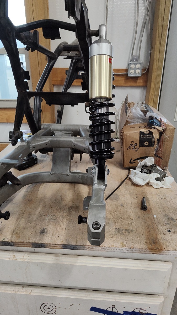

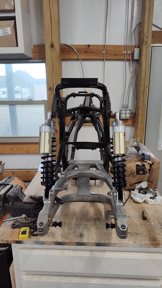

[attachment=174898]IMG_20250113_163550185_HDR.jpg[/attachment
Progressing]
  • NakedFun
  • NakedFun's Avatar
  • Posts: 1129
  • Thanks: 121
15 Jan 2025 18:14
#907938
Would suggest you have the chassis setup with wheels on it and at intended ride height before locating the upper mounts.  Weight would be nice if you have the ability to have powertrain in place.  I found my upper mounts needed to be located more forward than where you have them, but it might work for you.
Nice work so far.
Cory
2008 Kawasaki Concours 14
1999 Kawasaki ZRX1100
1976 Kawasaki KZ900
  • Formula264
  • Posts: 156
  • Thanks: 83
17 Jan 2025 16:21
#907997
For now I'm going with the stock location. If it needs to be moved after I get it rolling and the engine in place then will tackle then. Thanks for the info!
