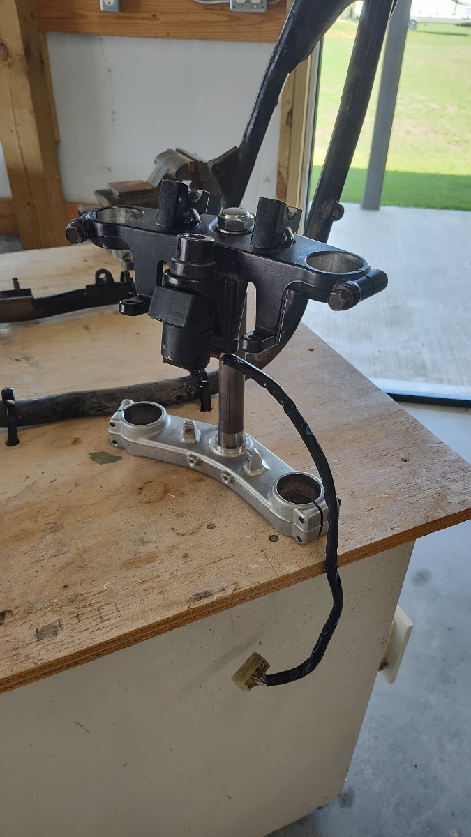

As a novice at this I thought I'd start a build thread and show my progress, or lack there of. It's just kicking off so here's where I'm going with it. I have acquired the swingarm and forks from a 2004 ZRX1200 so I will be using the brakes/wheels from same model. Perhaps I should have chosen an easier route with GS swinger but nevertheless I think I can do this(with all of you helping of course). I have a nice set of instruments from a 77 KZ but might go with the ZRX pods. I also have purchased a J model 1000 that will get headwork and a 1075 kit. That's about it so far and I will ask questions/post pictures as I go. I have read through some of the ZRX swingarm installs and have gained a little confidence.

Both the ZRX1200 and 1100 swingarms need to be narrowed to fit the frame. The good news is that the swingarm bearings sit quite a long way inside the pivot area, which means the bearing location/seats can remain unchanged. The ZRX pivot bolt is thicker (20mm I think) compared to the 16mm of the Z1000/Z650. I use top hat spacers to make up the difference.

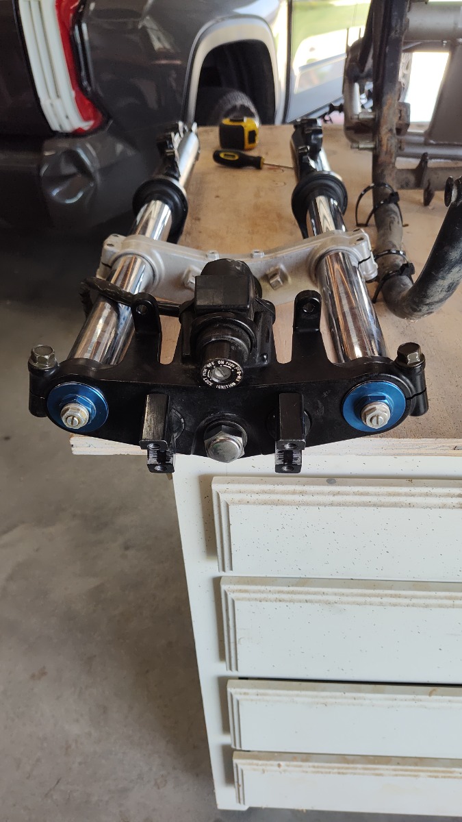

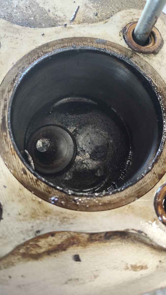

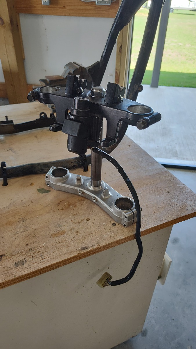

Well I figured that I need to cut 3/16" off the ZRX swinger. I will have my brother do that and make the bushings for the KZ through bolt. Ordered my bearing kit from Allballs for the ZRX front end so making a little progress . I then took the head off the 81 J model engine and discovered it had a broken exhaust valve but doesn't look like it did too much damage. I will be sending that out for headwork.

I fixed your pics, next time click "insert all" before submitting your post. Looking forward o following your build
