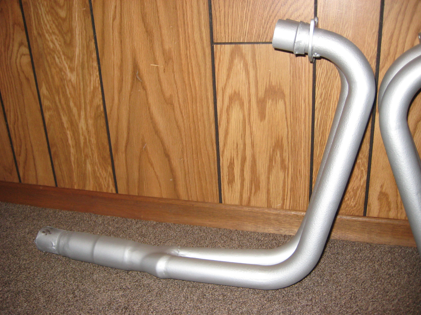

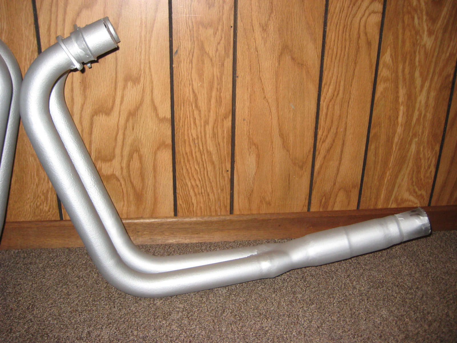

I was looking at my exhaust head pipes today, they are OK for something I cobbled together on the cheap. This is what I ended up with after bead blasting and two coats of VHT high heat paint.
Left side #1 and #2 :
Right side #3 and #4 :
I pulled them out to measure up and see how much it would be to duplicate in 304SS tube. I could not find a commercially made 2 into 1 collector at the size I require so I will probably have to make them.
They are OK to get me on the road so I can tune the jetting, but in the long run a stainless set would look much nicer. Also looking at ceramic coating but would require addition fill welding and grinding, maybe the cheapest option.

I checked into replacing the head pipes with a 304SS set and its a non starter compared to Ceramic coating. I will start up and ride this year with the painted pipes, and see about it at the end of the season.

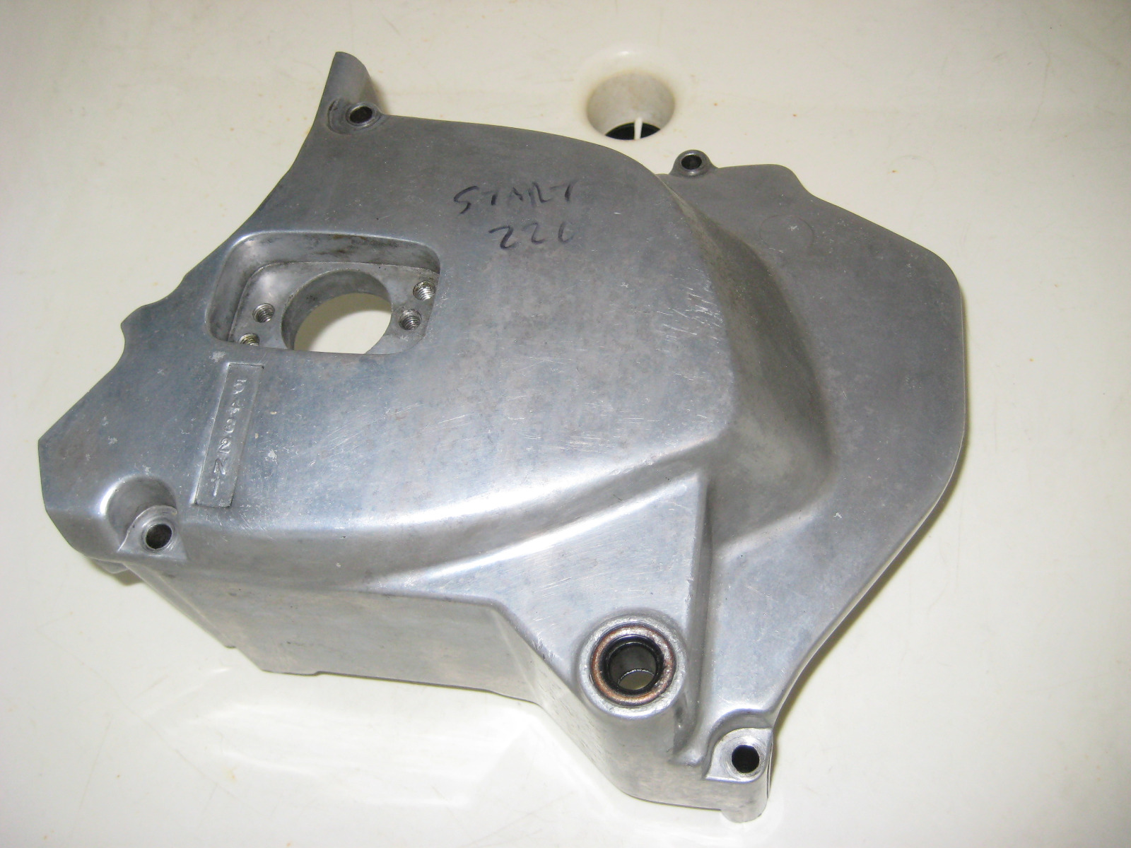

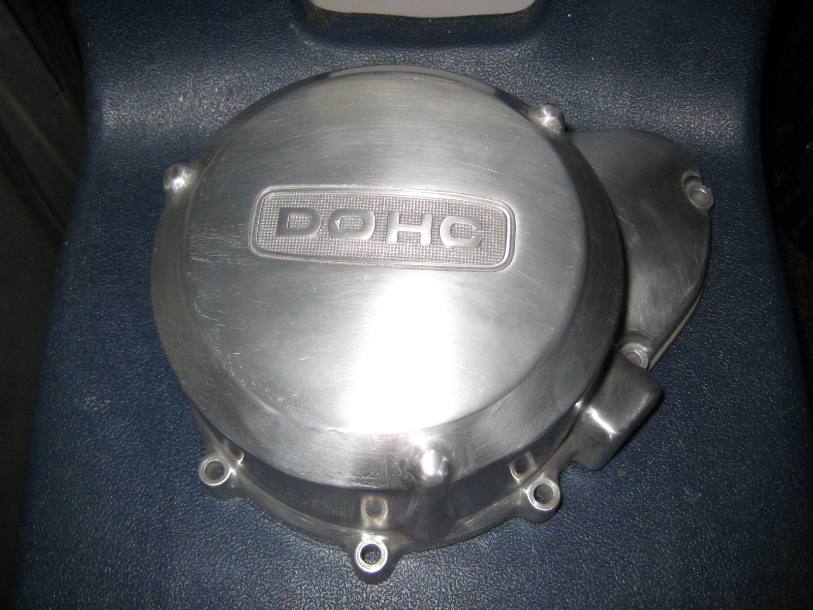

Did get a chance the other night to spend some time sanding the generator cover. Got it to 600 grit, still need to hit it with polish compound but will do that when the sprocket cover is finish sanded.
This one was rough so started with a file then progressed to 80 grit paper and above. I don't like a mirror finish, so not too fussy about the odd ding or scratch... if its OK from 10 feet I am happy as long as it looks "clean".
The sprocket cover is not that bashed up so will start with 220 paper, any heavy scratches that I find will be smoothed out with 80 paper. Hoping to get this one sanded tonight, then polish both.
Its not much progress lately but these small jobs are better done now when there is a foot of snow on the ground.

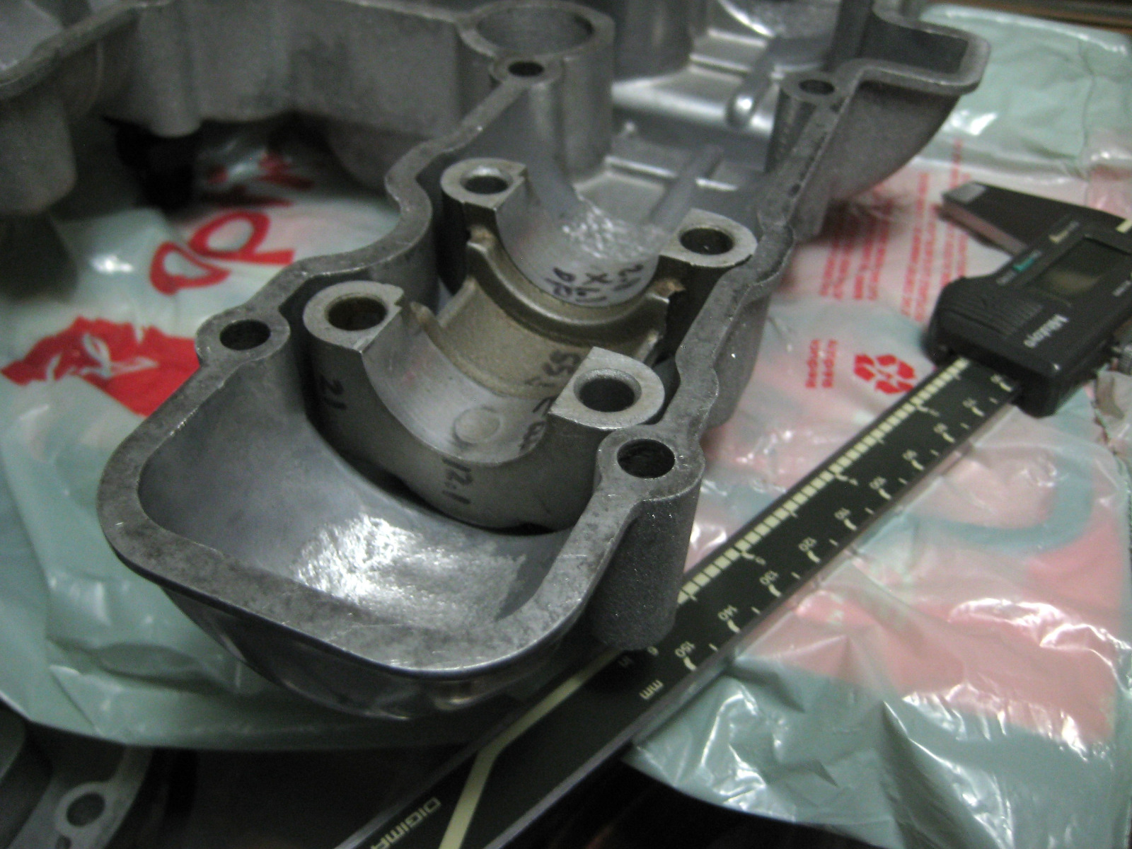

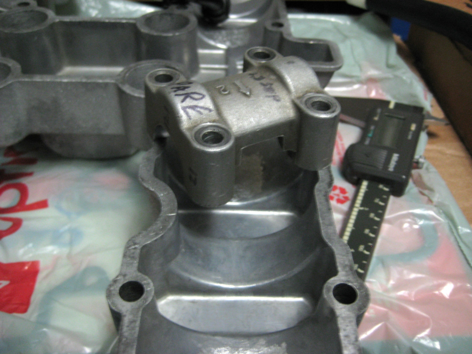

The other day I looked into replacing the cam cap bolts with studs. On the early Z1 head and cover this ended up to be a non starter.
I had a spare cam cap to lay into the valve cover.
Cam cap shoulder where bolt goes thru is 22.5mm high.
It ends up that the cam cover cavity where the cam cap sits is 29mm deep (Kawi OEM gasket is 1.70mm thick) This leaves only 8.2mm clearance for a stud sticking thru before it hits the cam cover (only room for a flange nut) So there is no extra stud length to "pull" down on the cam cap when permanently installed as planned.
I can't speak to what the situation is on the newer heads and cam covers (J/MK2)
Wookies temporary stud method seems to be a good option or the "C" clamp method for "pulling" down higher lift cams. I don't think it will be a issue with my .425" cams, and probably up to .435" cams (max for street)
So I am shelving the idea on this build and sticking with regular OEM bolts.
I have been a 650/750 guy for most of my motorcycling life, so shim under cam swaps must be over a hundred times or more. Have I stripped out a few holes, yes (mostly on my 650 drag bike) Just insert and move on, usually do them with the head on the bike, eventually they all get done. Come to think of it I don't think I have seen too many pics of heads with permanent studs installed, maybe once or twice.
I am not saying its not a good idea to put studs in permanently, I just don't think its warranted. The number of times I am going to take the cams in/out I could not say, its a crap shoot.
The most proactive thing would be to insert all the cam cap threads with steel inserts, but that takes time and setup. I don't know if I would bother with a street bike as it seems over kill. With the steel inserts you can positively pull the cams down by using OEM bolts in the cam caps.
I had no issues pulling down .480" cams on my drag bike with C clamp or even just pushing on them with my hand. I think it may get trickier with +.500" cams and higher spring rates (never been there)

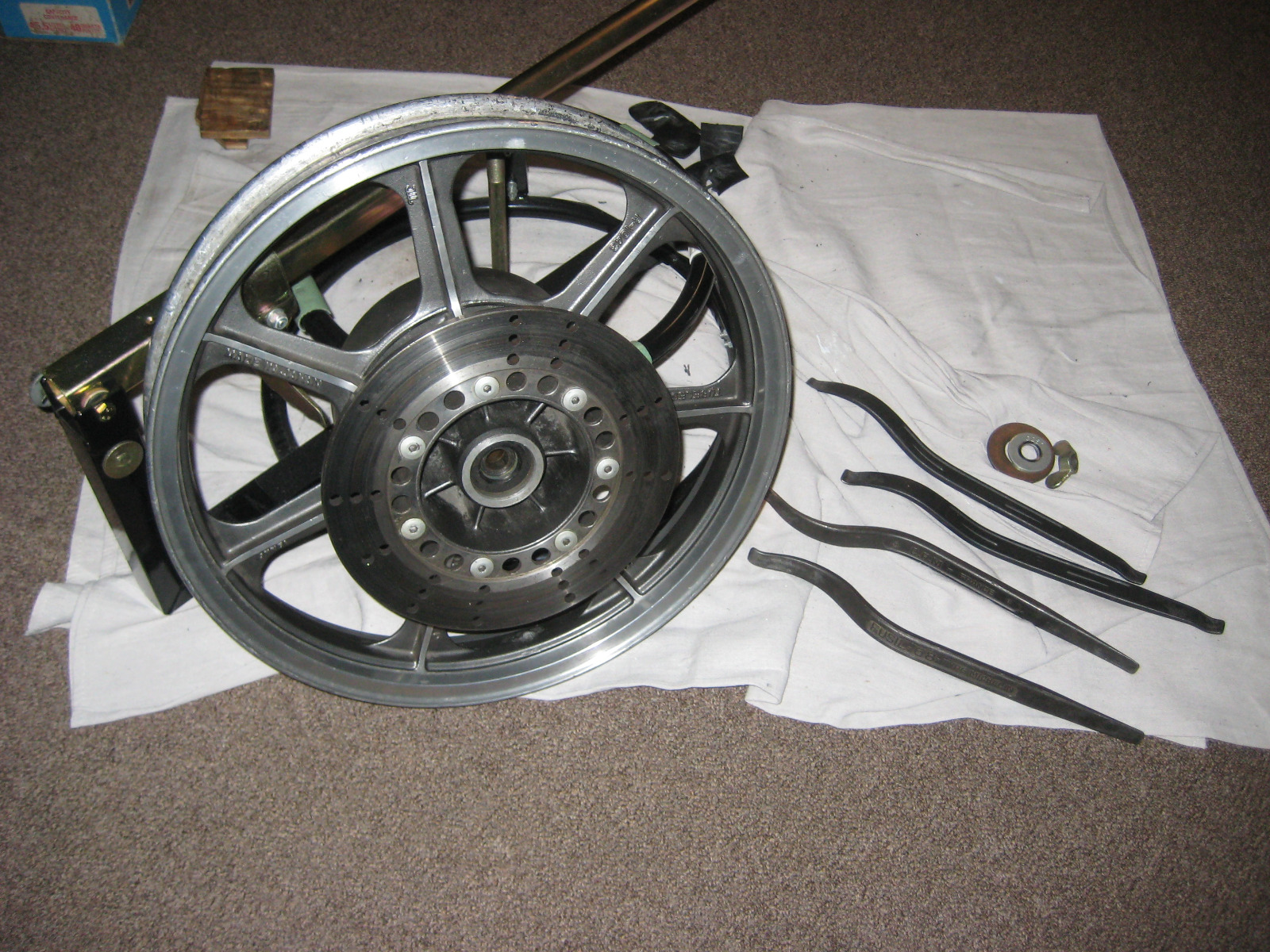

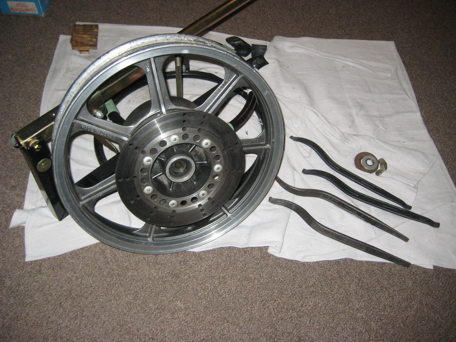

I just got back to working on this project today. I was able to remove the rear tire from the rim and will have a new one mounted soon.
Once I get the back wheel on I still need to get a couple of engine covers mounted before I can proceed with the top end assembly. I want to be able to fire it up ASAP.

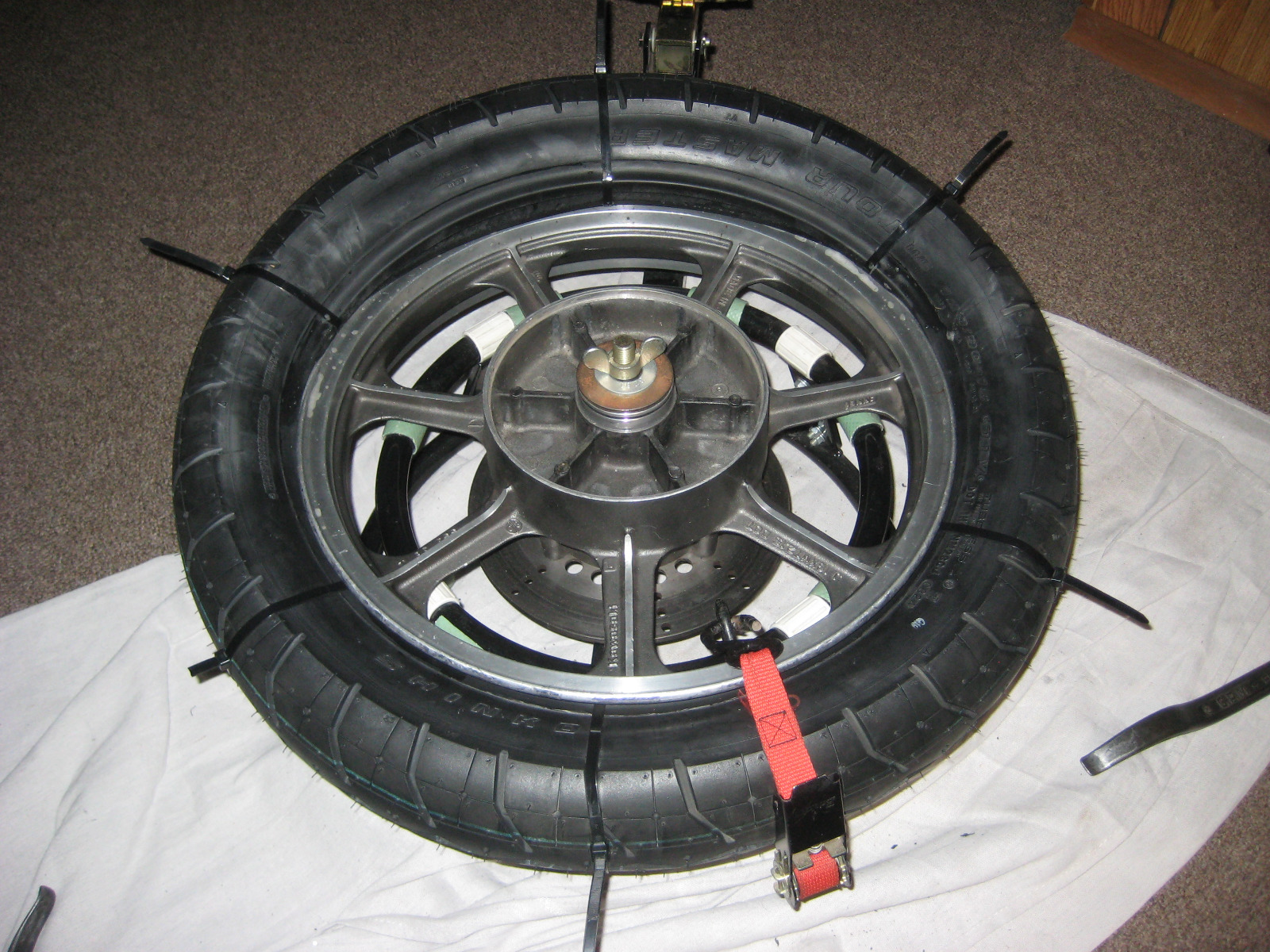

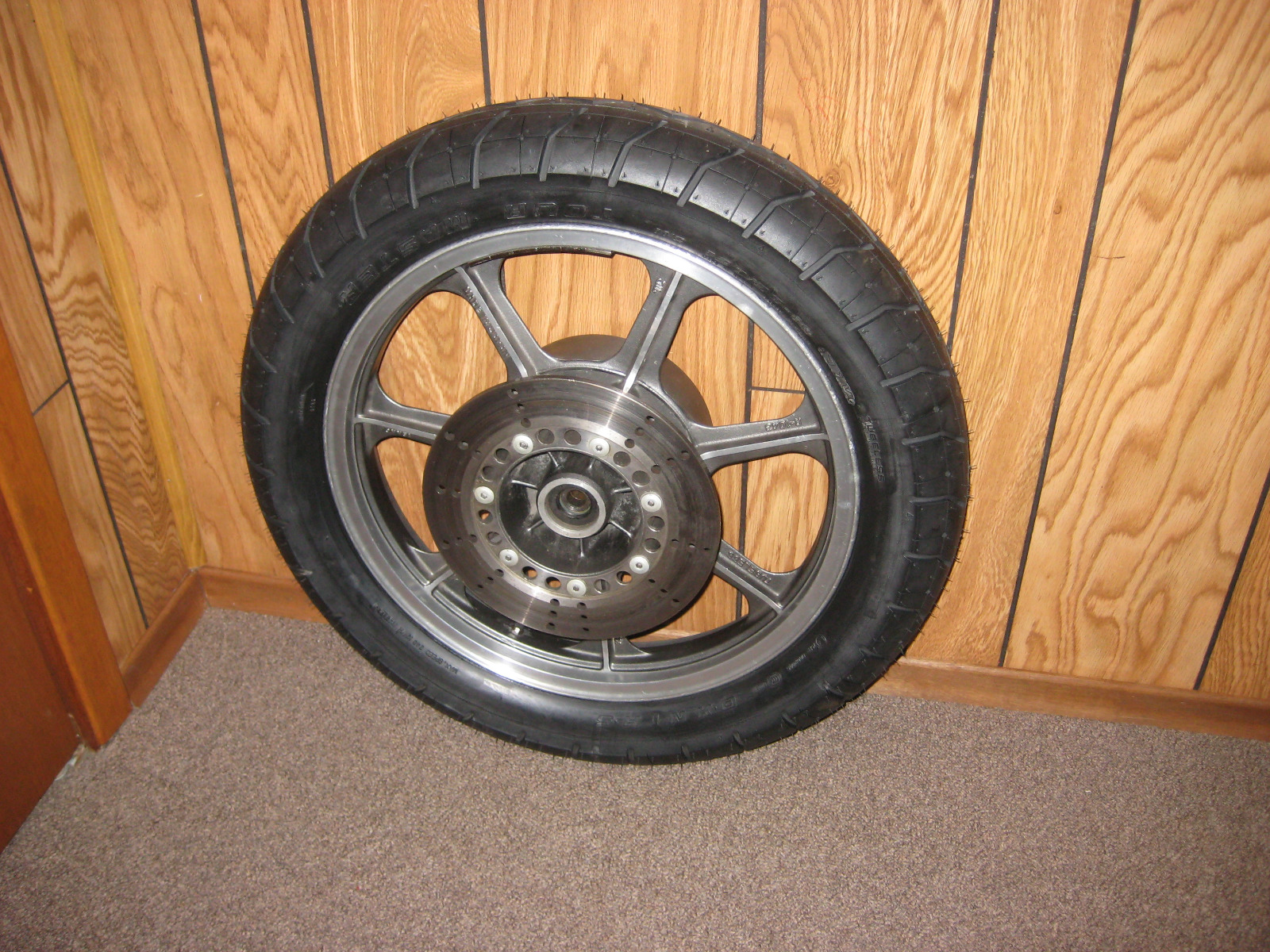

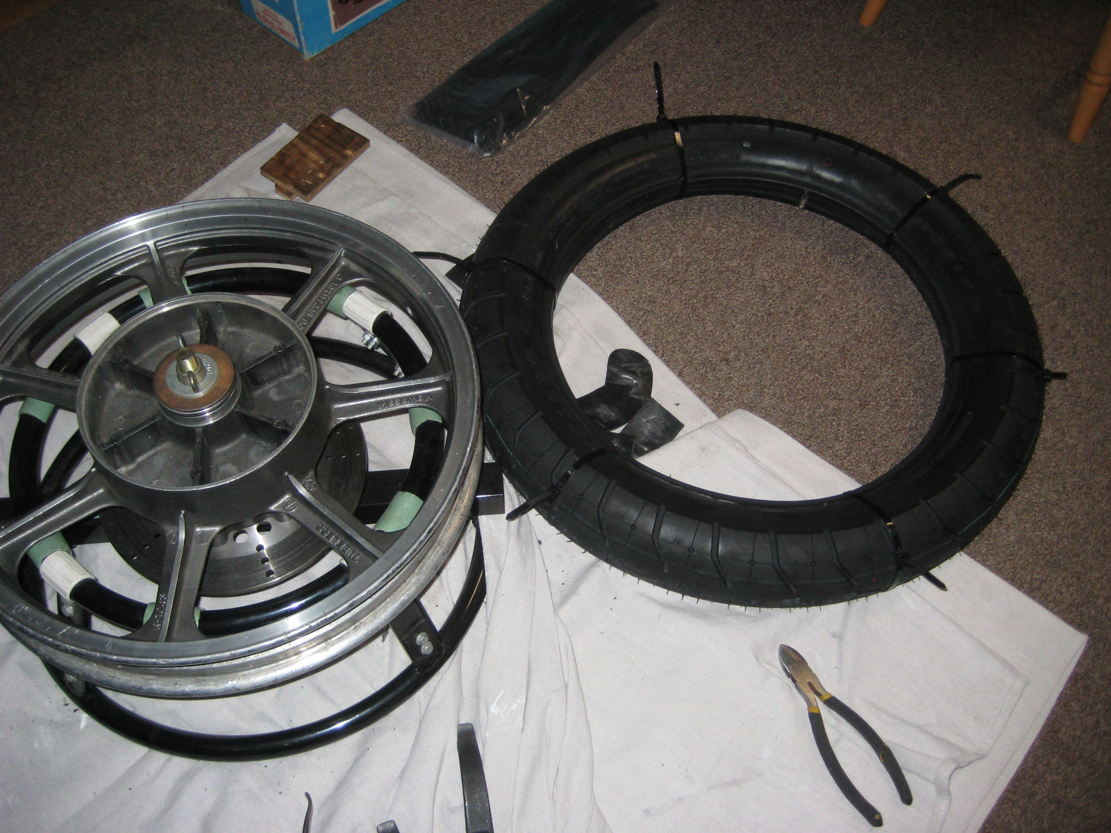

Finally got this wheel sorted and will try to get it mounted on the bike tomorrow.
I did the zip tie method with the tube inside, had to use 3 ratchet straps to get it sucked into the "drop" enough to lever the beads in place. I used soapy water solution rather than silicone spray, and it was not as easy as those YouTube videos make it out to be. Maybe this brand of tire is tighter than others?
Once the tire is on I can mount the front sprocket and new 530 chain. I held off on doing that as I might need to make a thin sprocket spacer to adjust the chain line. The chain line was only "eyeballed" in mock up before the motor mount tabs were welded and not rechecked afterwards.

I used the zip tie method on my front 100/90-19 tire (1.85 wide wheel) without much difficulty, but on the rear 120/90-18 tire (2.15 wide wheel) had nothing but trouble and ended up doing it the old way. Had the same issue trying to get the beads opposite into the center drop. Good thing I decided not to use the rim locks!
