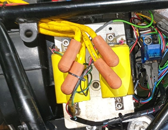

04 May 2025 10:06Here is a closer look of my Accel coil mouning plate with the WG coil relay mod.I would be using the same mounting holes, bolts, and spacers. They will bolt to a bracket I'll make attached to the frame. Similar to Scirocco's first picture (behind the side cover). Or I may decide to leave well enough alone!

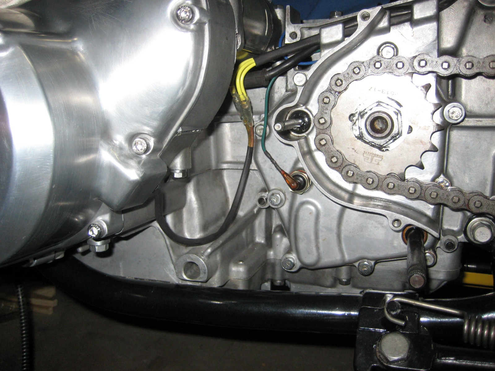

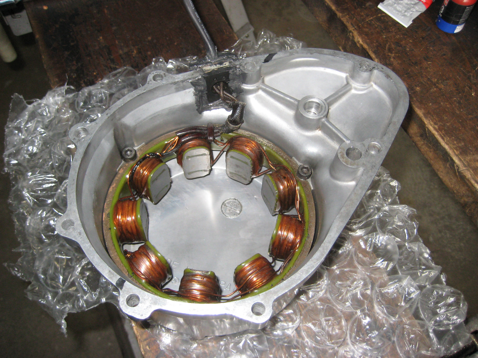

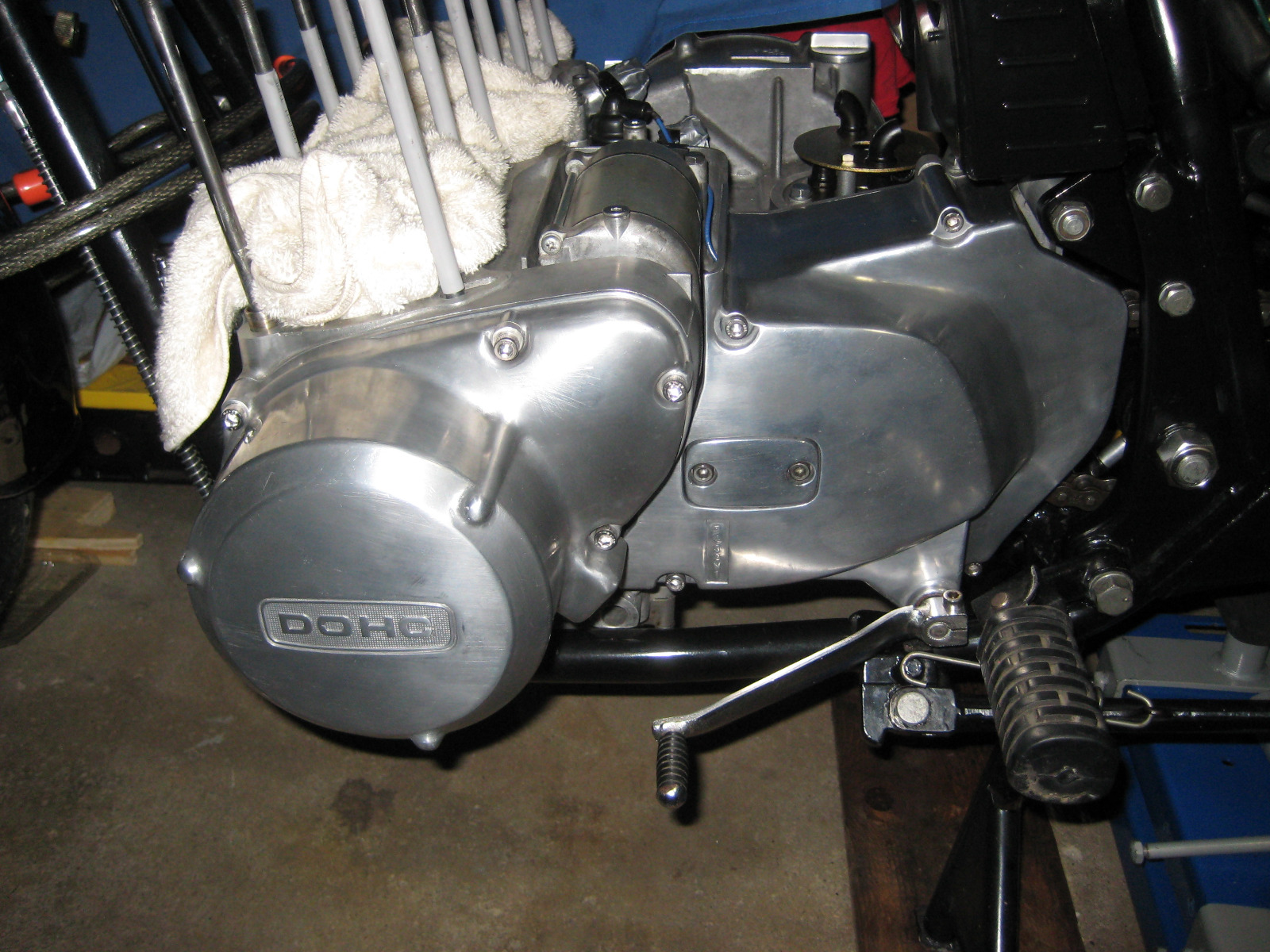

I got a little bit accomplished on this build today.
Was able to get the stator cover and sprocket cover installed. My first time bonding that damn rubber wedge into the cover where the wires come out, what a pain in the arse. Working on mostly 650/750 there is never a need to do this chore.
Got it done with some advice from a guy who has done hundreds, hopefully it won't leak!
I waited quite a while for the RTV to set up before tightening the cover bolts.

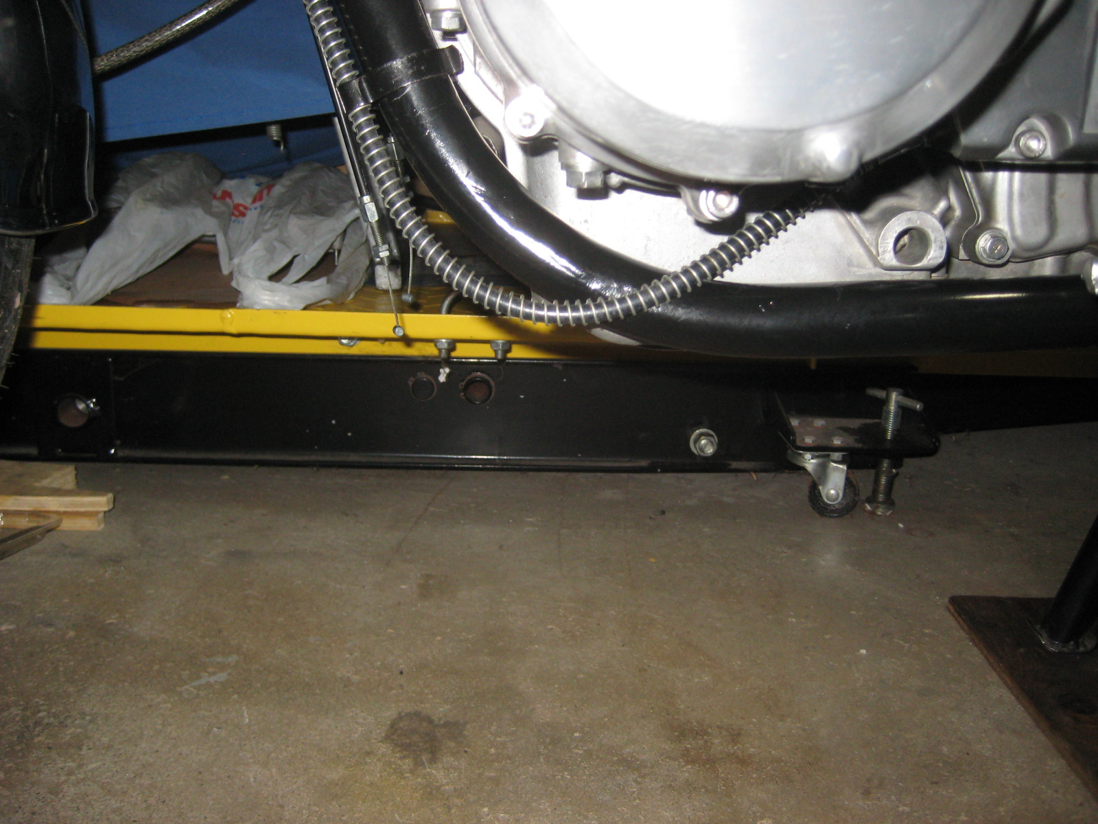

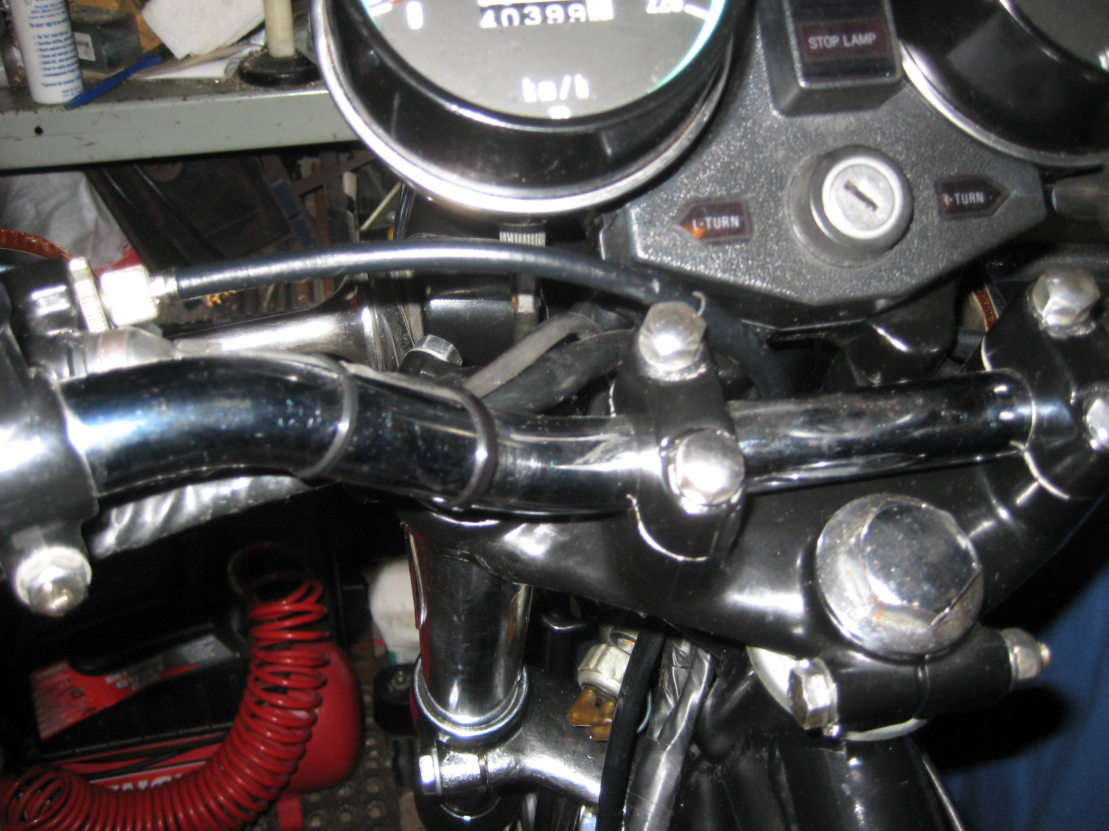

Found out that there is some sort of dimensional difference from the 1000 to the 650 on where the clutch rod sits, as the 650 clutch cable is now too long.
Had to run the cable inside the center of the triple tree to take up some length, and could not route the cable inside the frame like it would normally run. I will need to take some time to measure where the difference lie, I guess this is why a standard length chain was slightly short.
Normally on a 650 the upper portion of the clutch cable would go behind the speedo and the lower portion inside the lower frame rail next to the engine case. On this build there was no space between the frame rail and the case for the cable. I fished the upper portion of the cable where it would take up the most length to avoid a big arch on the lower portion. I will need to cover the spring with a section of rubber hose to protect the frame and use the stock clip cable minders where they make the most sense.
