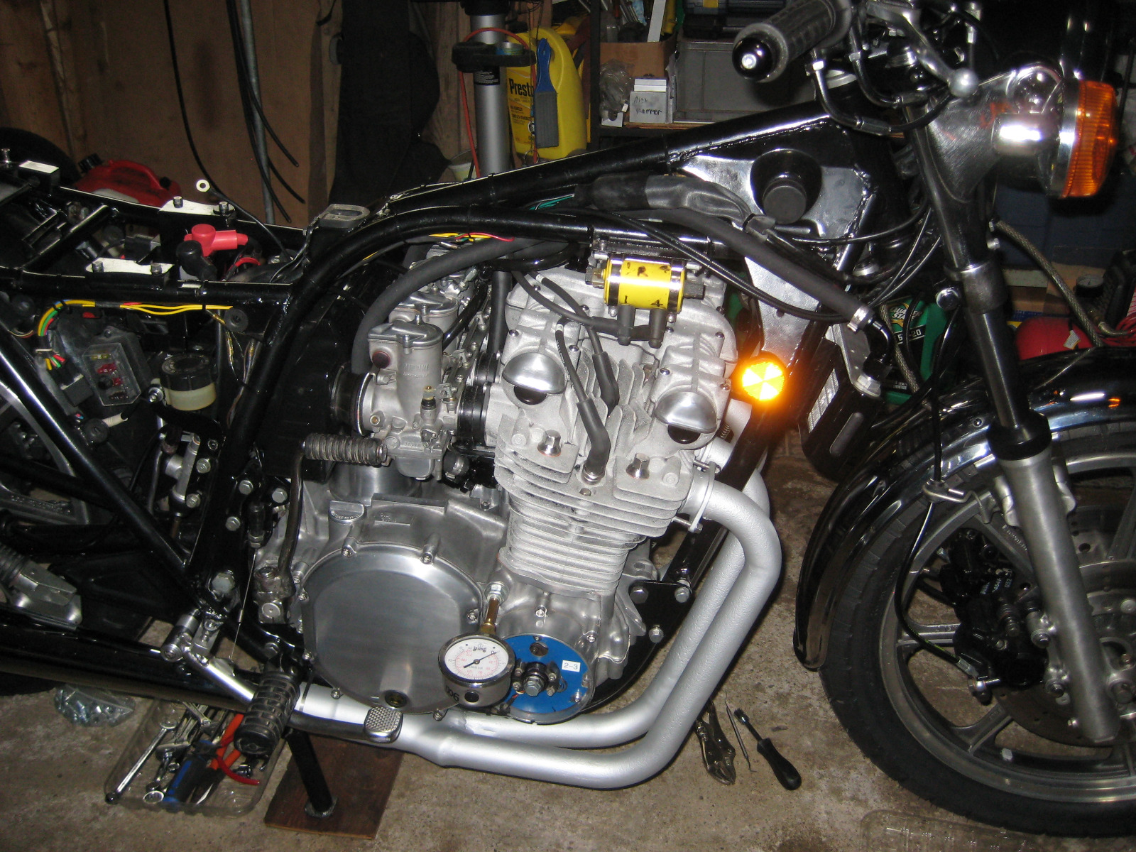

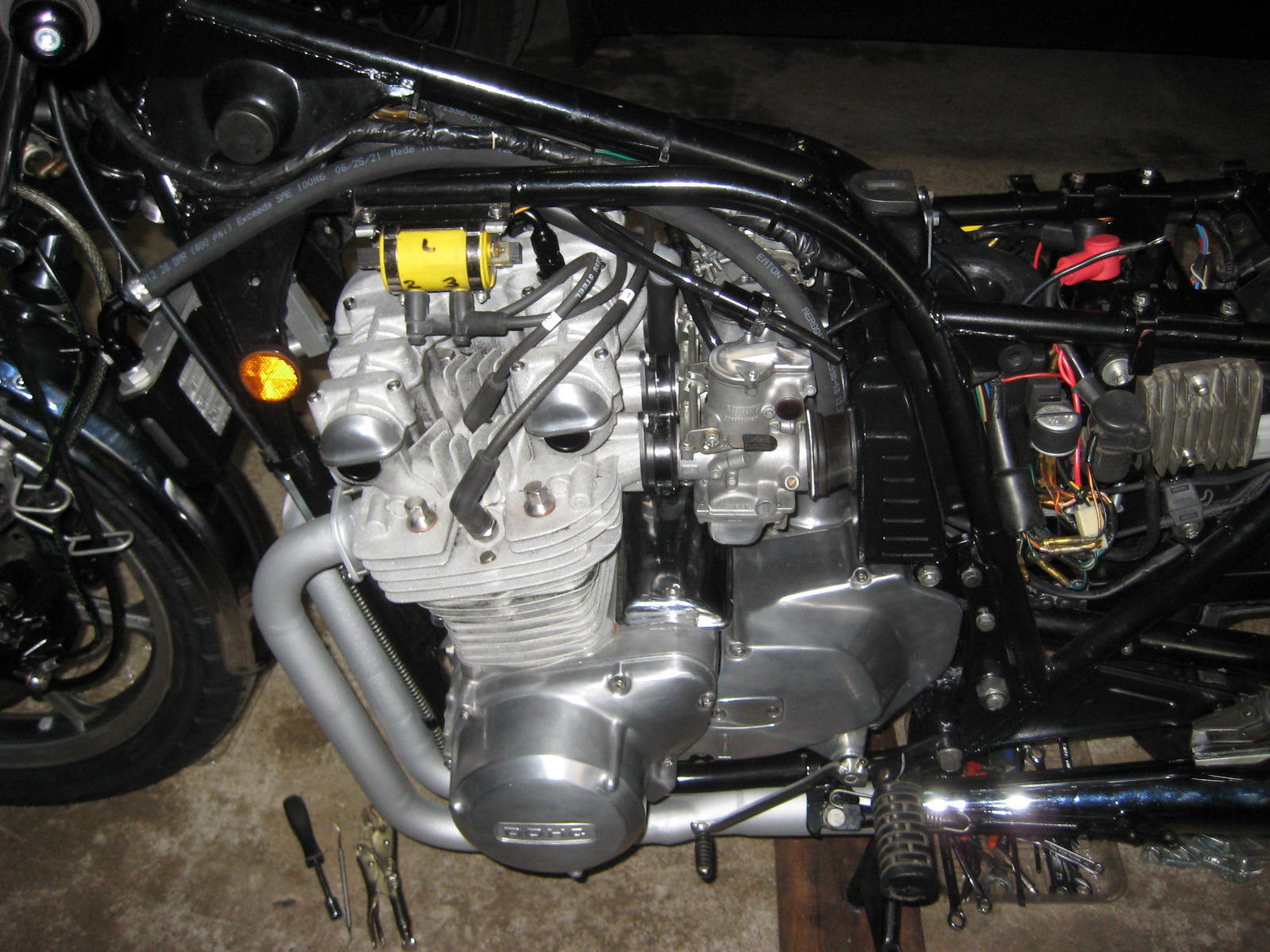

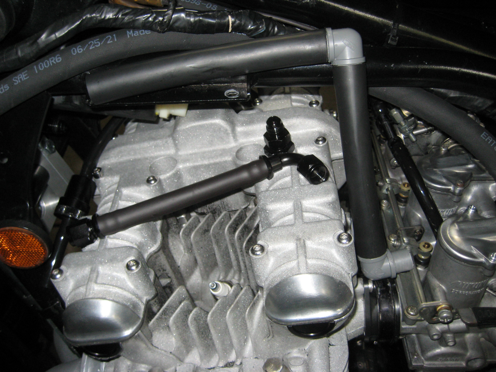

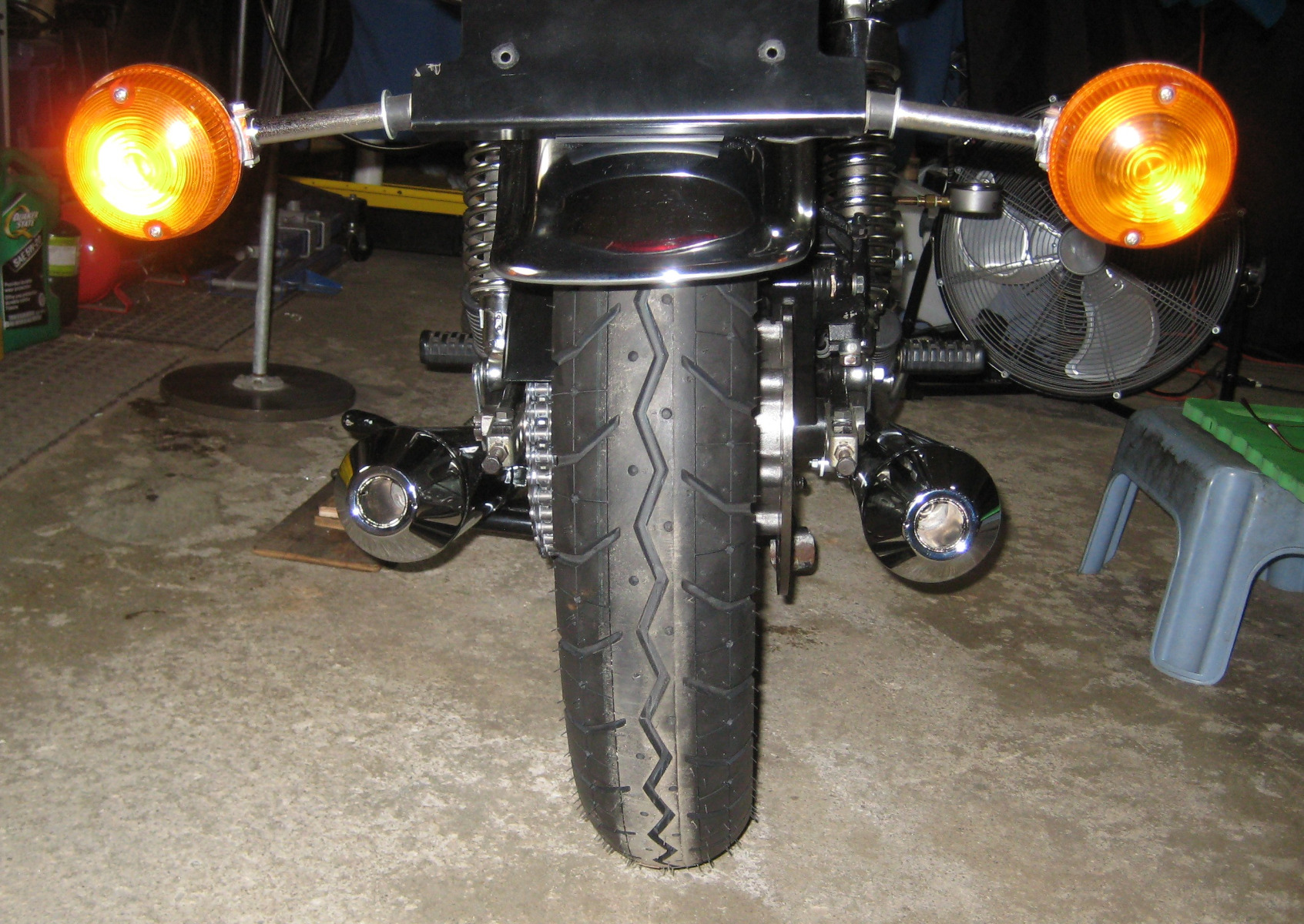

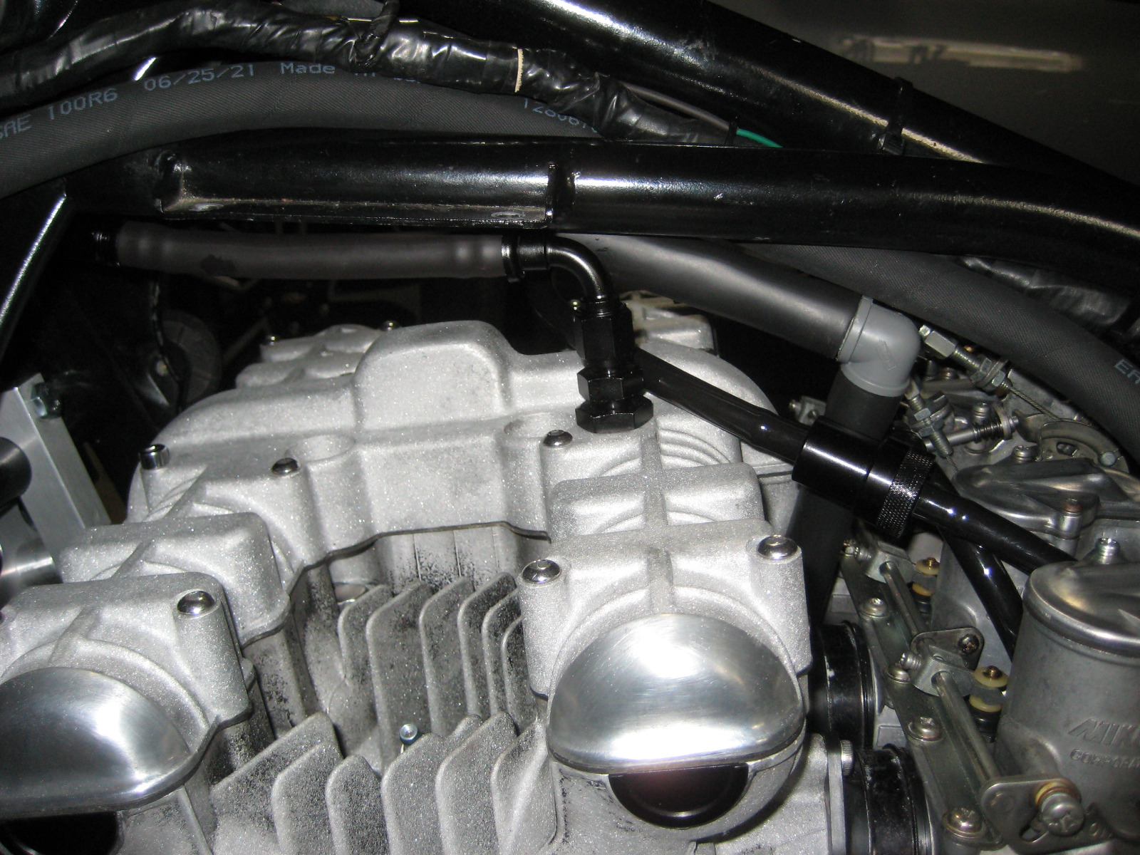

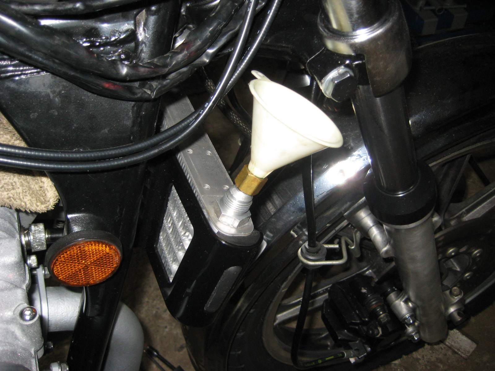

I was able to work on this bike today with only one interruption for a few hours to cut the grass. I was able to prep it for a first start tomorrow and may even get a ride in if its early enough and only if no issues crop up.

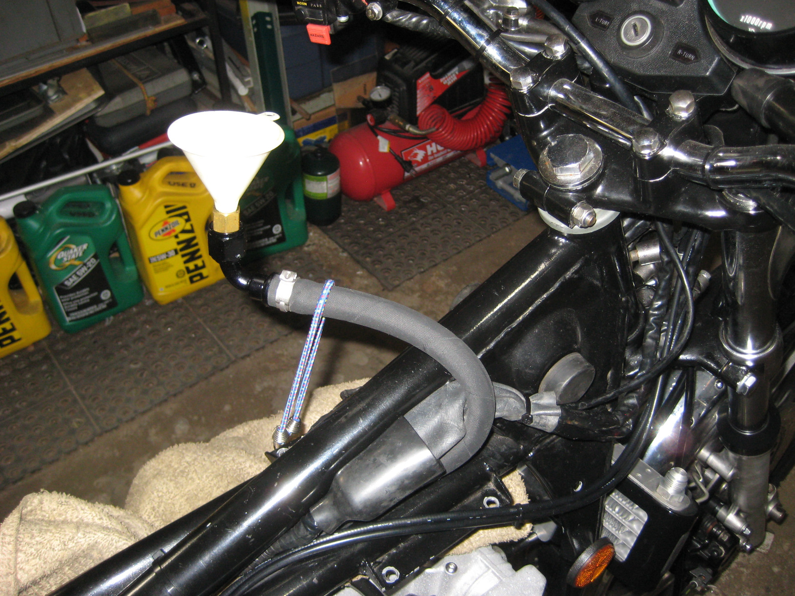

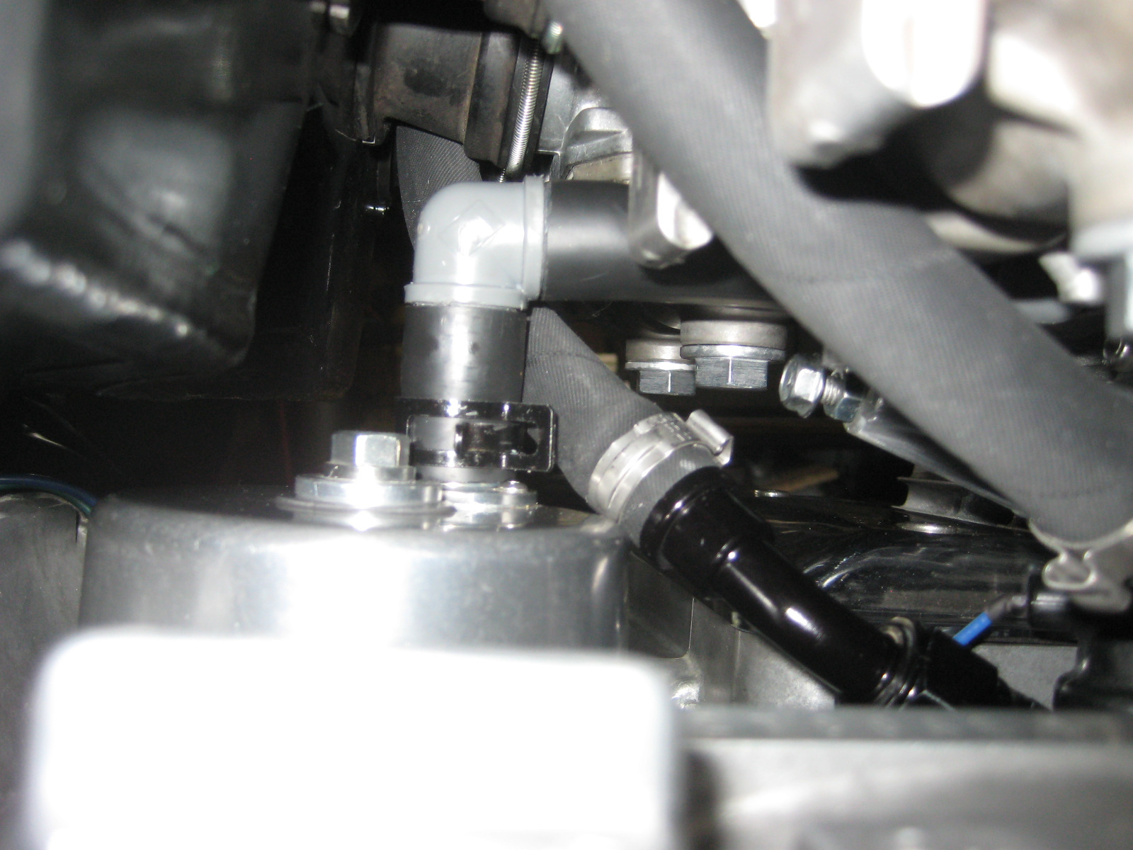

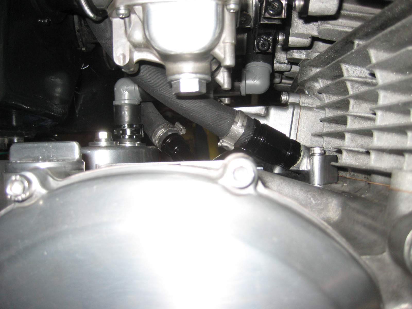

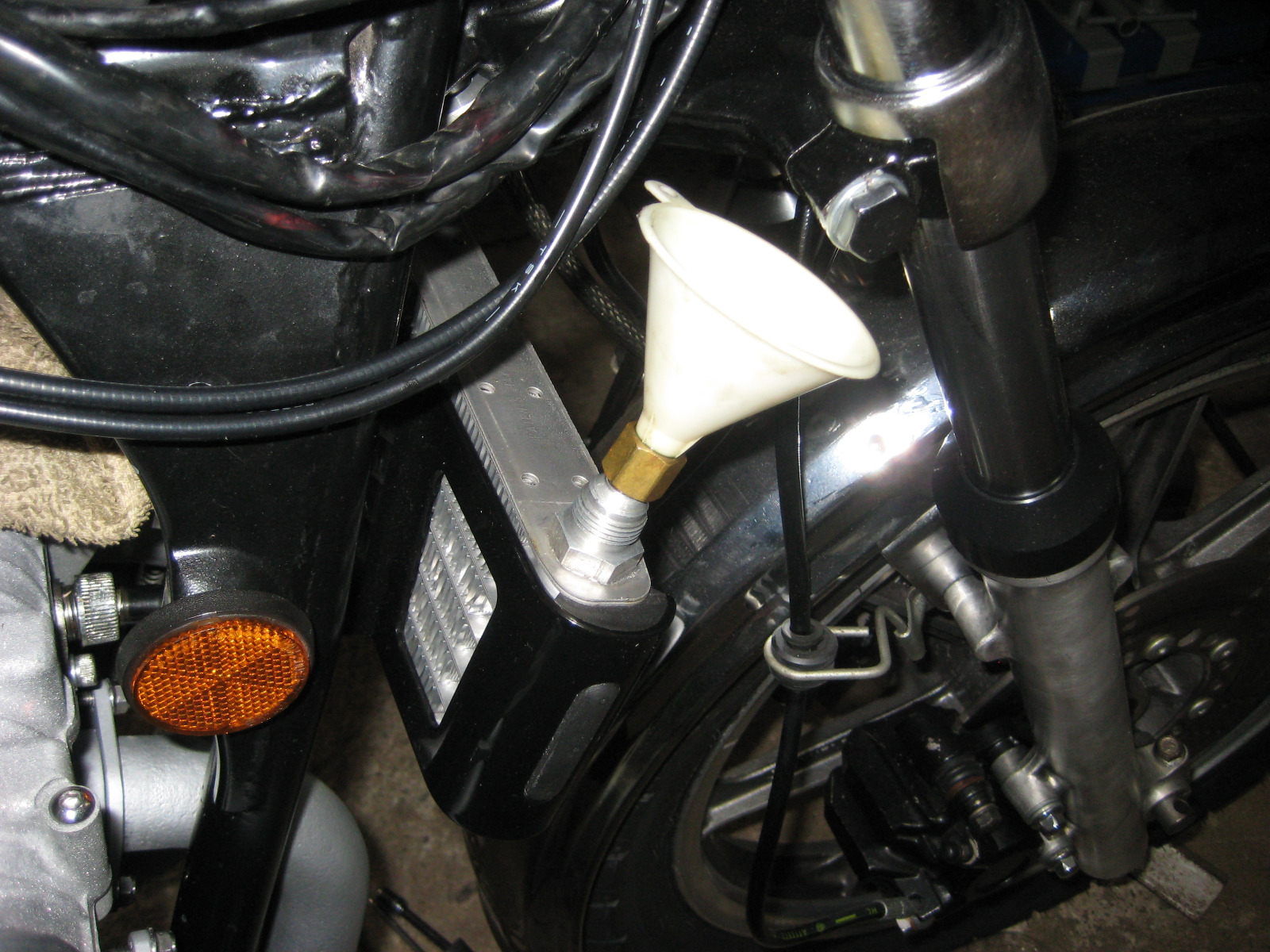

I filled the crank case with oil and prefilled the inlet line to the cylinder head along with filling the oil cooler. I fit a pressure gauge to the main gallery to monitor pressure on startup.

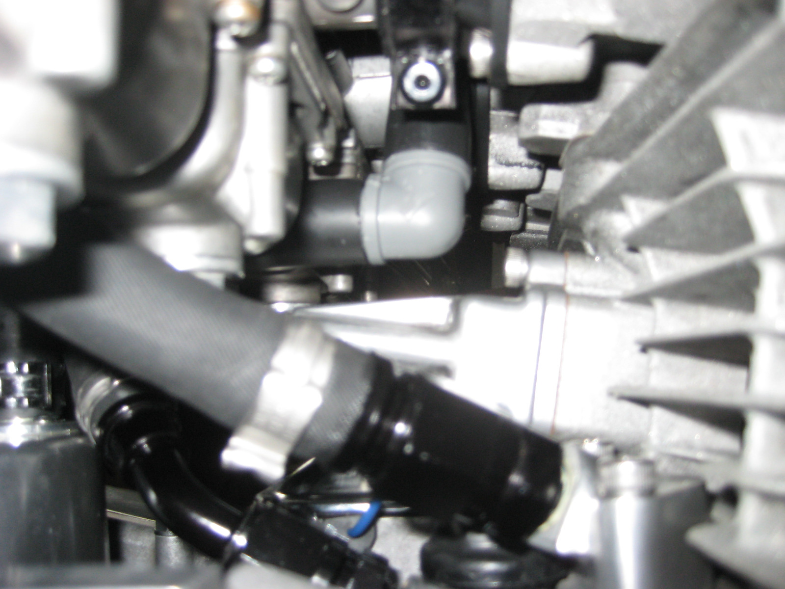

I had to make 3 vent elbows and I got the time for each one down to 30 minutes, the first one I did took me 45. The vent tube fitting was time consuming but it looks like it will work. Again, everything is tight toward the top of the frame on this swap.
When I put the coils on I really noticed its tighter than a stock 650 install, but it works.
The only thing stopping me from starting it is the left hand exhaust is currently loose at the head and the muffler mount. I have it loosened to make a small adapter shim bracket to drop the muffler mount and move it inboard. I think it may take me about a hour tomorrow morning. After its assembled I can tighten everything up.
Hopefully there are no surprises.

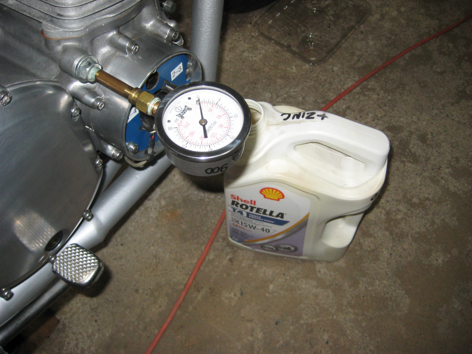

Hey Injected, what do you use to add the zinc to your oil? I noticed you container is marked, +zinc

07 Jun 2025 16:10 - 07 Jun 2025 16:27Lucas Zinc Plus.Hey Injected, what do you use to add the zinc to your oil? I noticed you container is marked, +zinc

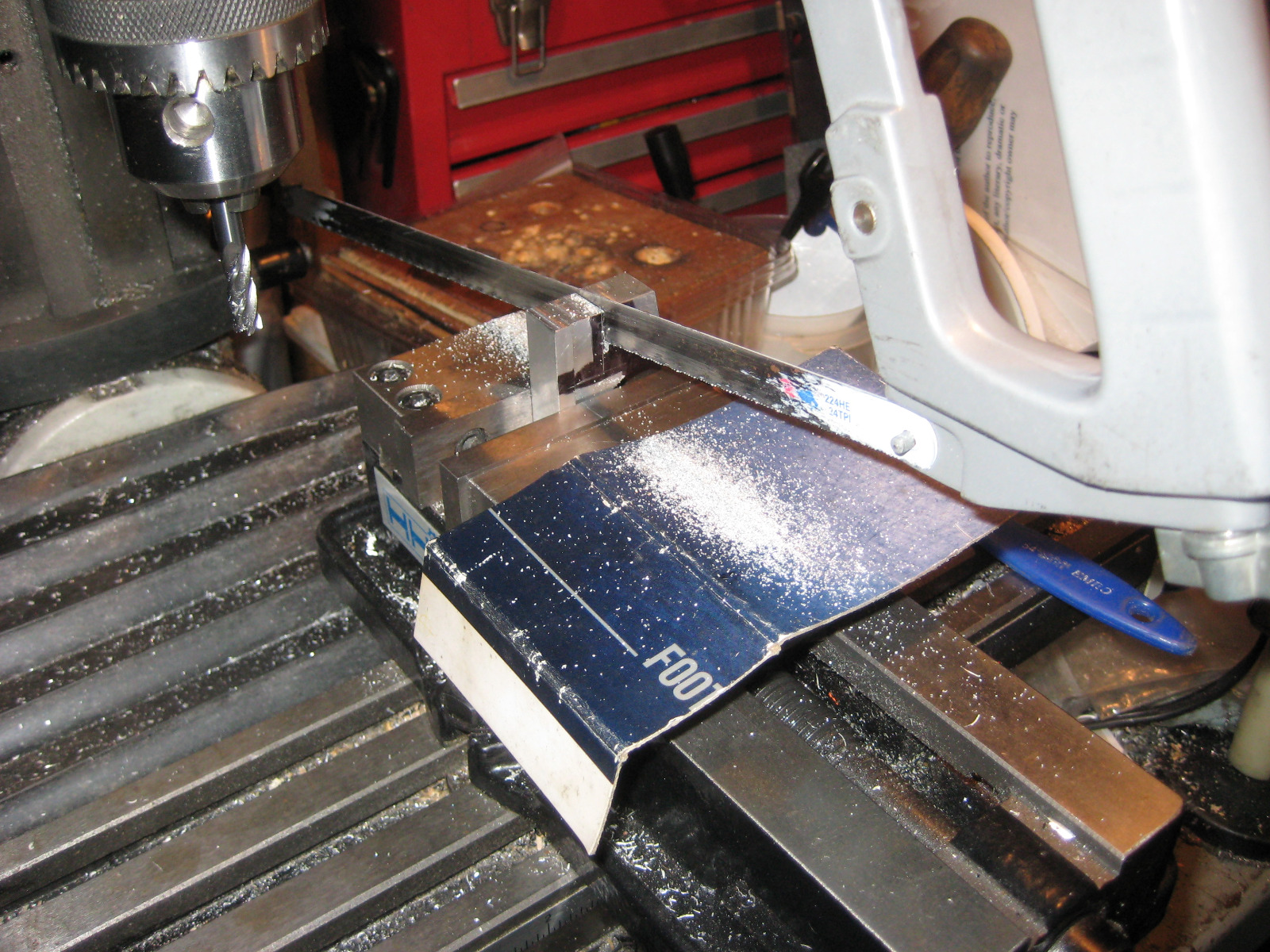

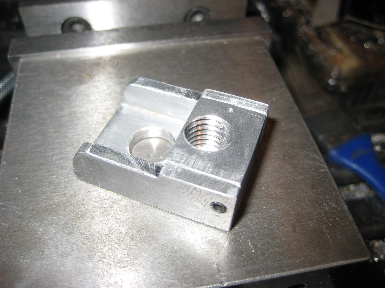

Today was a mixed bag, it took me twice as long as I figured to fabricate that shim to drop and suck in the LH muffler. I did get the bike started and everything was good, but when I went to set the timing it started running on 2 cylinders only minutes after getting the barrel warm.

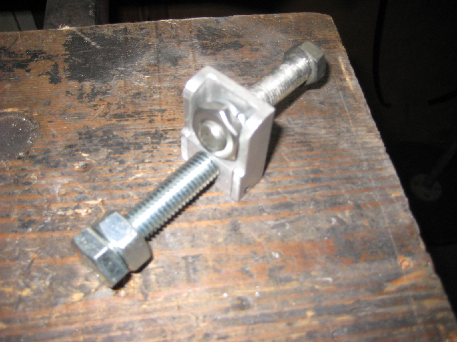

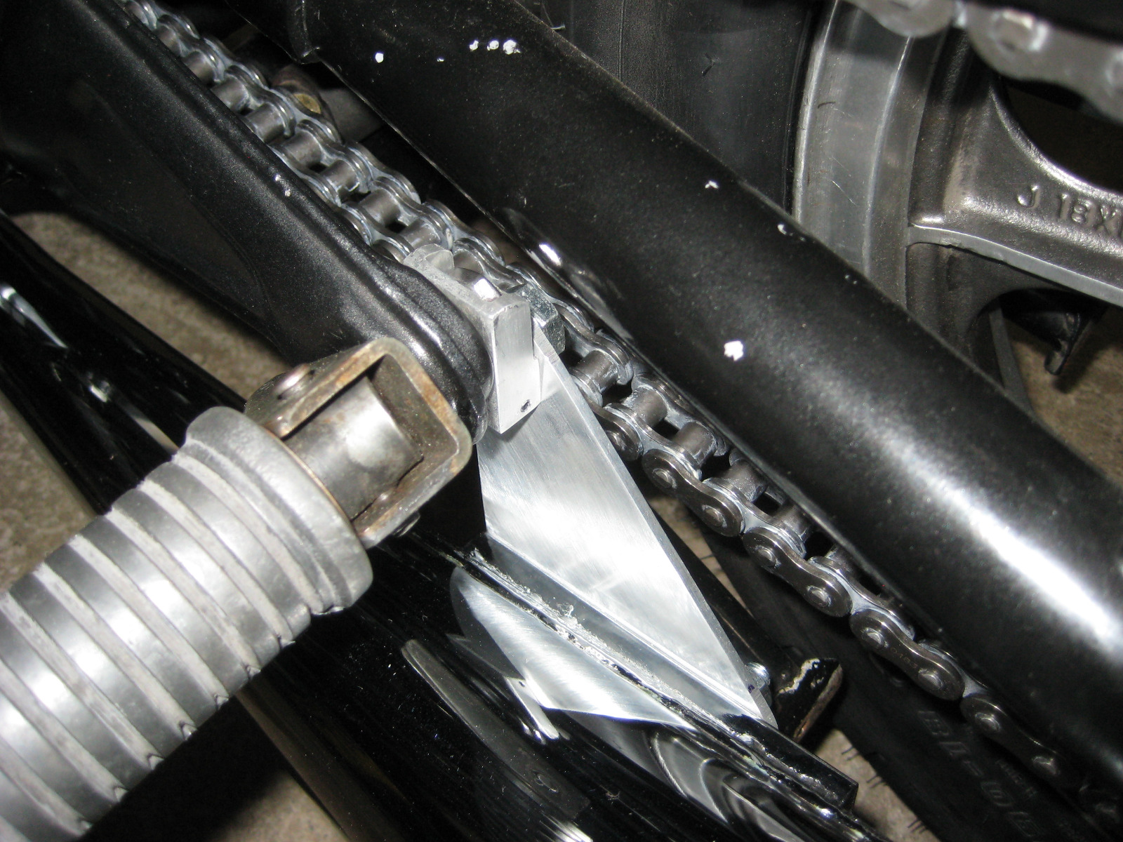

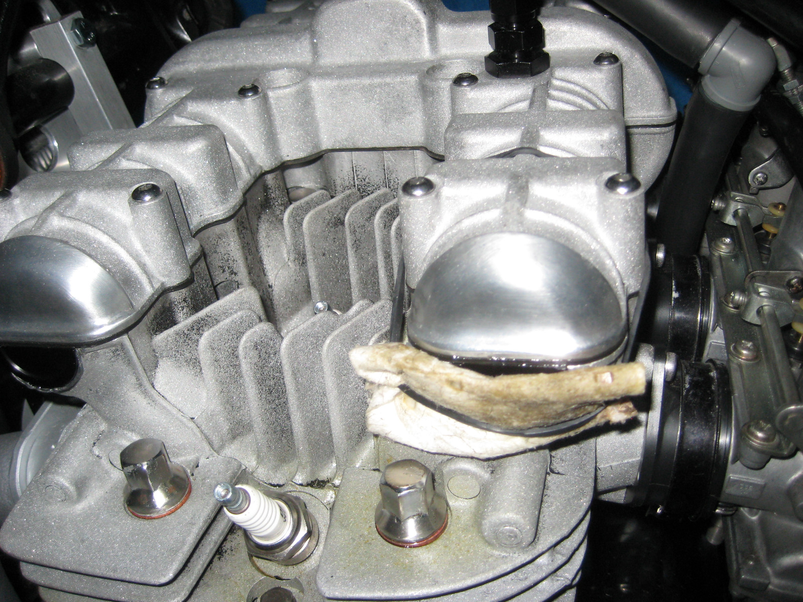

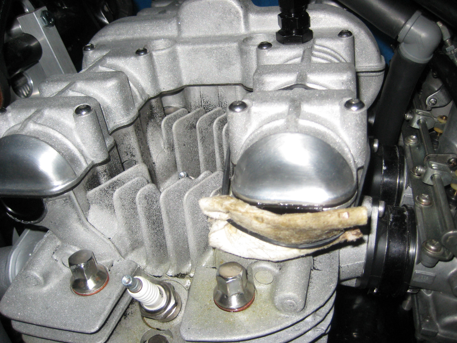

I also had a small oil leak on both rear cam end plugs, one side worse than the other, that damn RTV! I cinched down the bolts so hoping the leaks subside, if not I will need to redo those two.
Here is what I had to do without running out to buy material, scrap bin to the rescue!
I did not have a solid piece so used what I could scrounge, it works for now and got the mufflers "closer".
Its just a bit off, so one day I will make another to come closer but order the material to machine it out of a solid piece.
The idea works and it gets the job done.

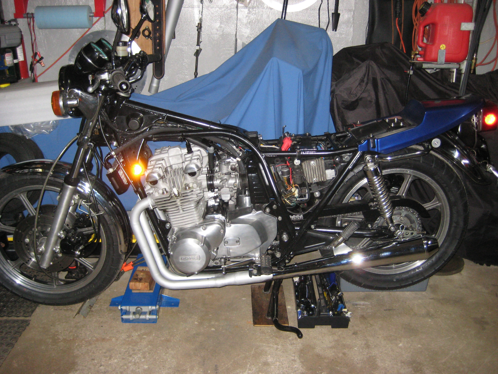

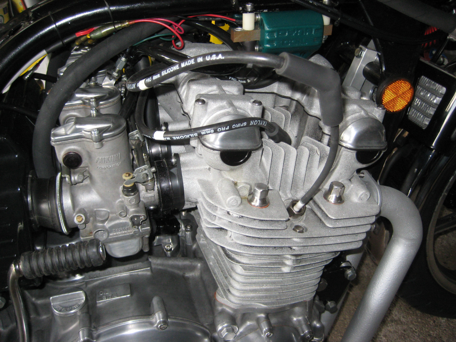

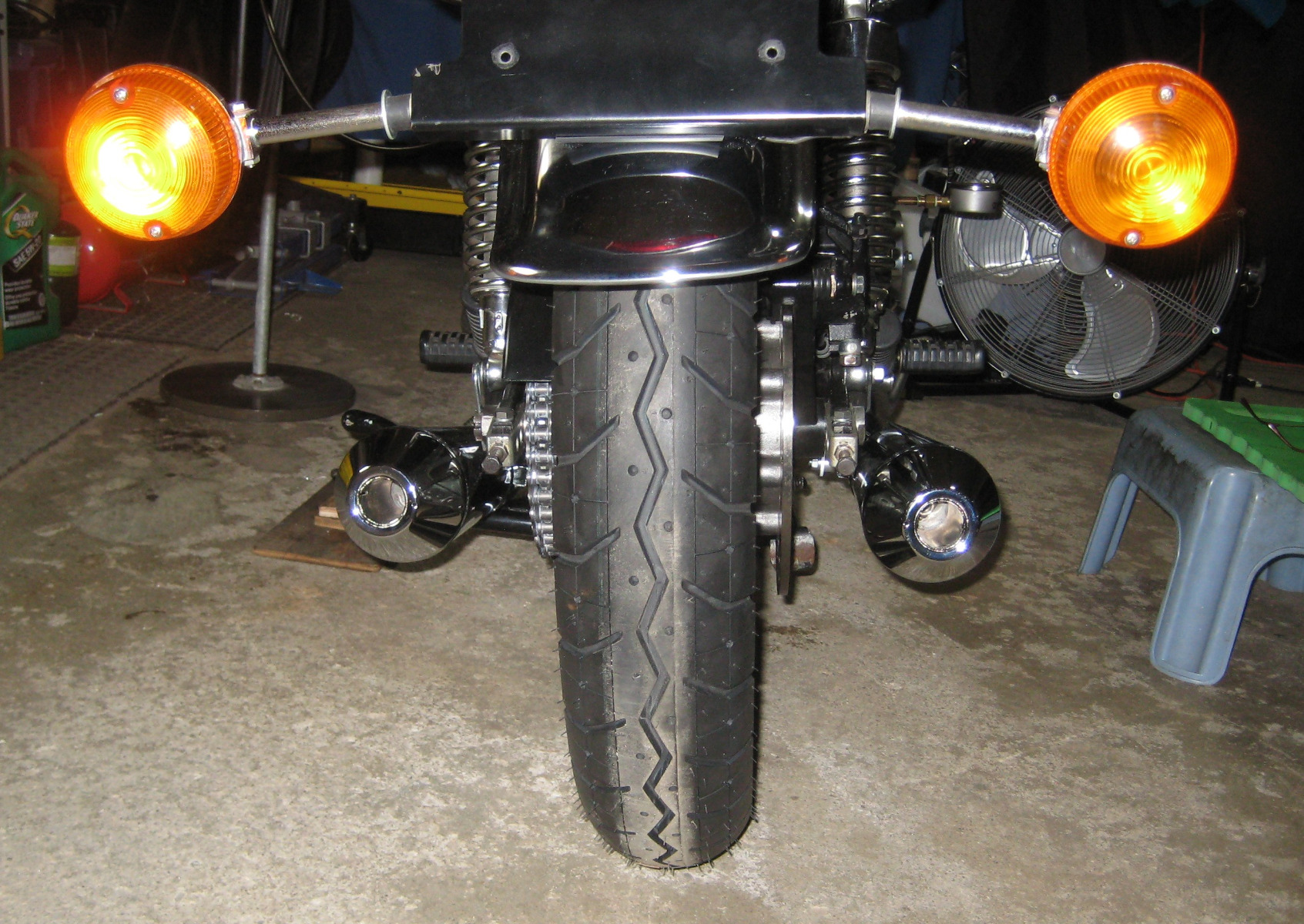

I did get back working on this today, got it started and I am working on tuning it. Re-torqued the head, it needed it just after that first start before the coils got installed.
It cold started with no issues full choke on the starter motor, ran OK once I got it warmed and set the idle but it started cutting out and died. Its a fricken BEAST, revved it up about 4K and kids on the street ran for cover
After that it was a bear to start, ran my battery down (older AGM) so tried kicking it and just about broke my leg! Put the battery back on trickle charger and did some other stuff, but I think I will try again tomorrow. Hamstring is now tweaked
I had the pilot air screws mostly closed at 1/8 turn (it started that way) but put them at 1/4 turn to see if that helps any.
Cam cover is still weeping, will need to lift it and redo the RTV... pain in the arse!
