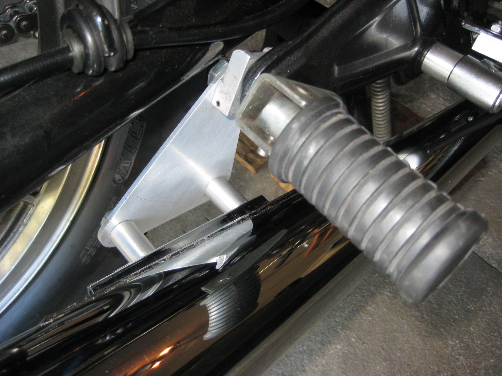

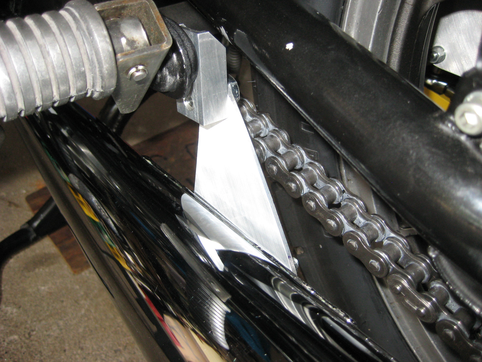

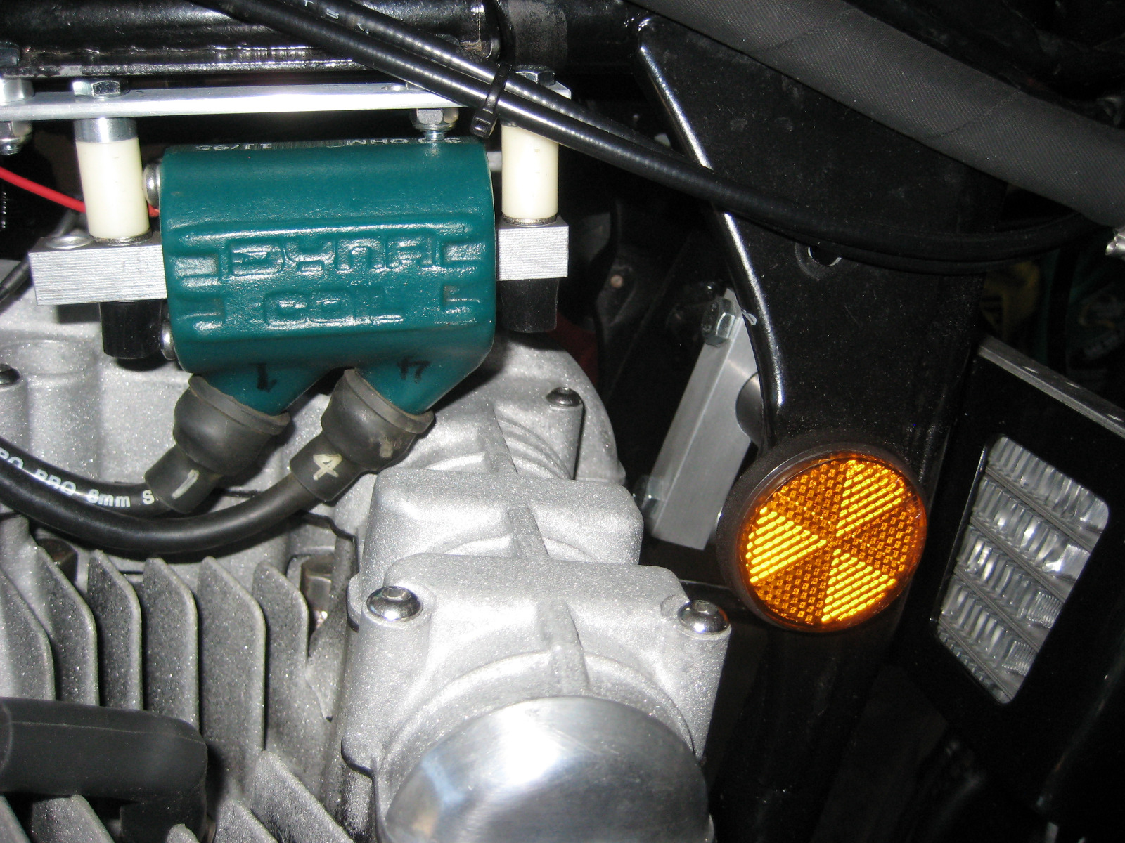

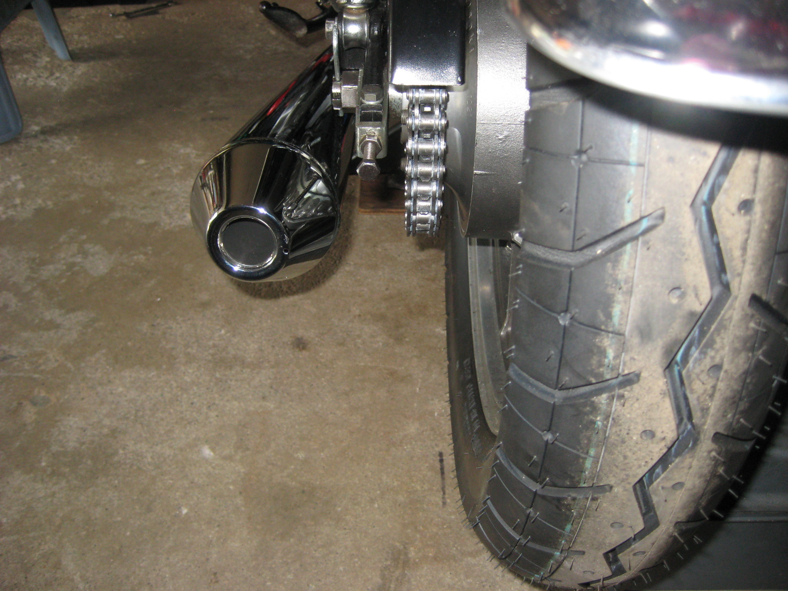

I installed the new one piece drop shim for the LH muffler I made on my mill.
It moved the muffler closer to the tire and it dropped the center down another 1/2", its now within 1/32" of the RH muffler from the floor. The RH muffler is going to be kicked out a bit further with some shims, but I could not adjust it up or down too much because of rear brake lever interference.
I also sealed the joint between the muffler and the head pipe with grey high heat RTV as there was already a sooty exhaust leak there upon first start.

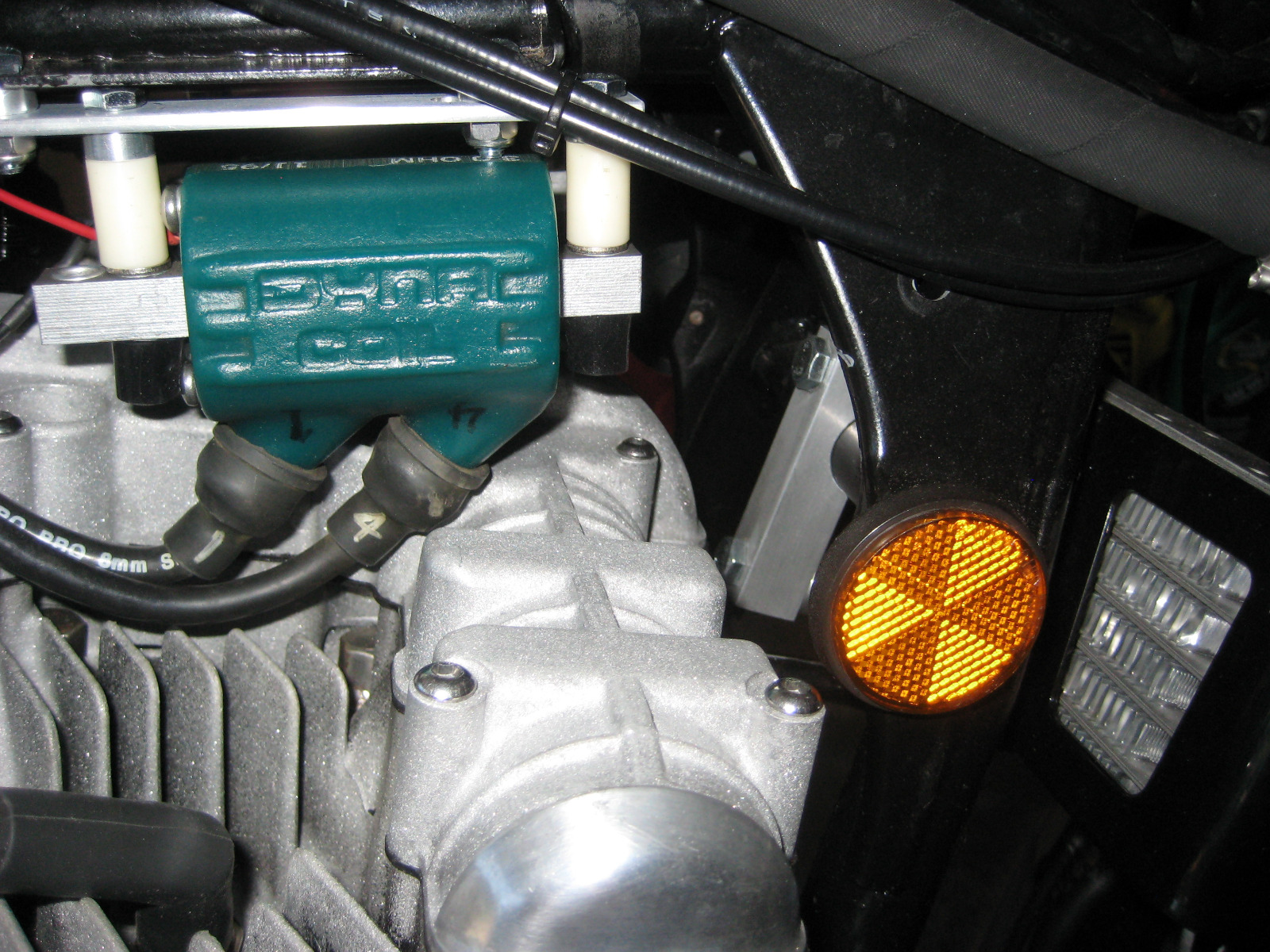

The rail I made to push the coils more forward is a little too much forward so I will drill some holes to pull them back a bit. It did elevate the tight spark plug wire condition. I also need to add about 8" of extra length on the #2 spark plug wire as I need to route the wire around the back of the cam cover.
Its a bit too tight on the trailing edge of the cam cover between the top of the cover and the bottom of the gas tank. I am not too keen on having the plug wires sandwiched on top of the cam cover. I need all the air flow I can get between the tank and the head.
I did buy some reflective self adhesive heat shield foil to attach to the bottom of the tank to try to keep the heat under control. I won't apply it to the tank until I can commit to fixing the petcock orientation and shortening the lever handle to miss the air box.

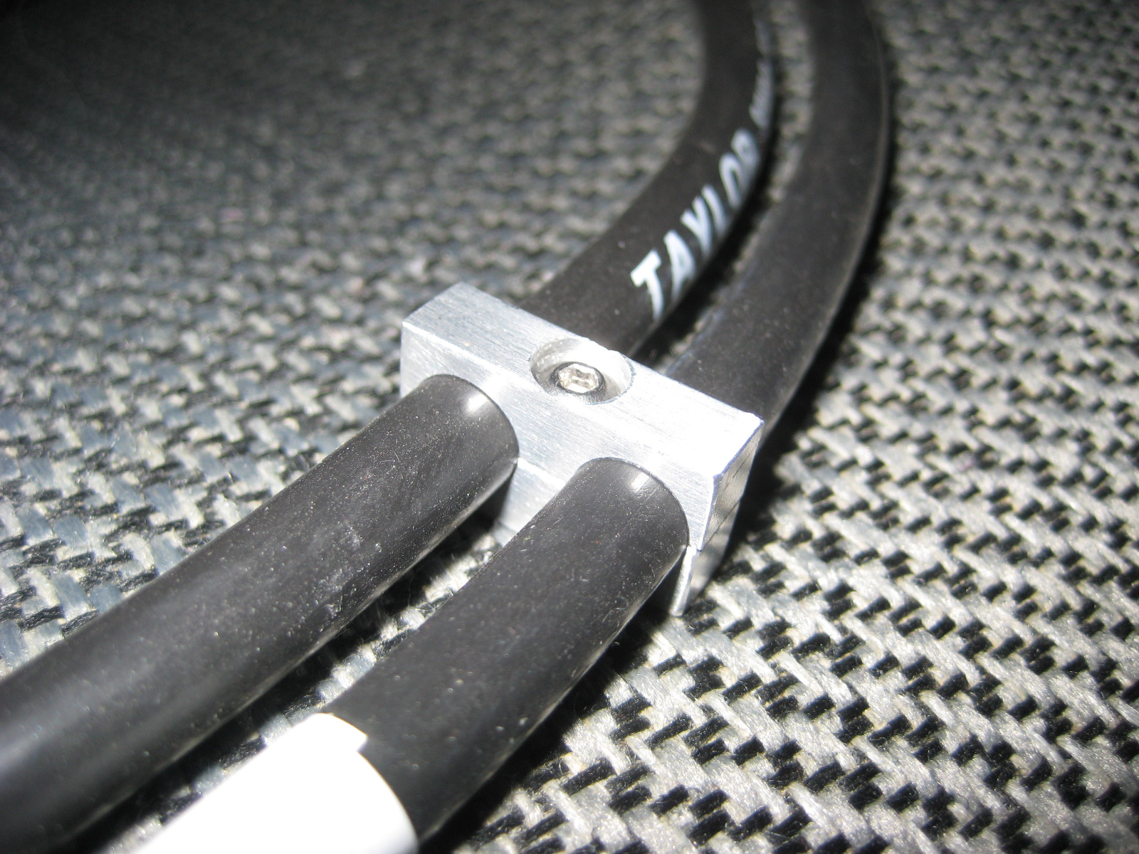

I am also fabricating some billet aluminum spark plug wire separators. I only need one on each side so buying a set seemed to be a waste of money, I had the aluminum so its just going to cost me some time.

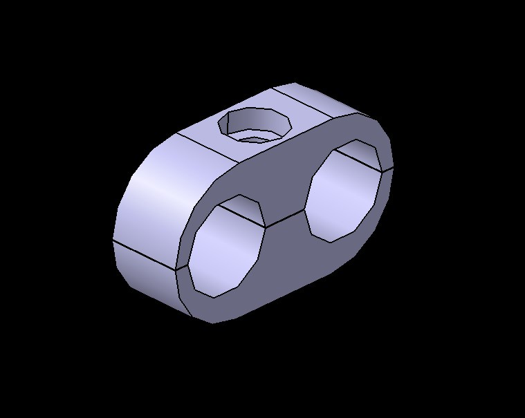

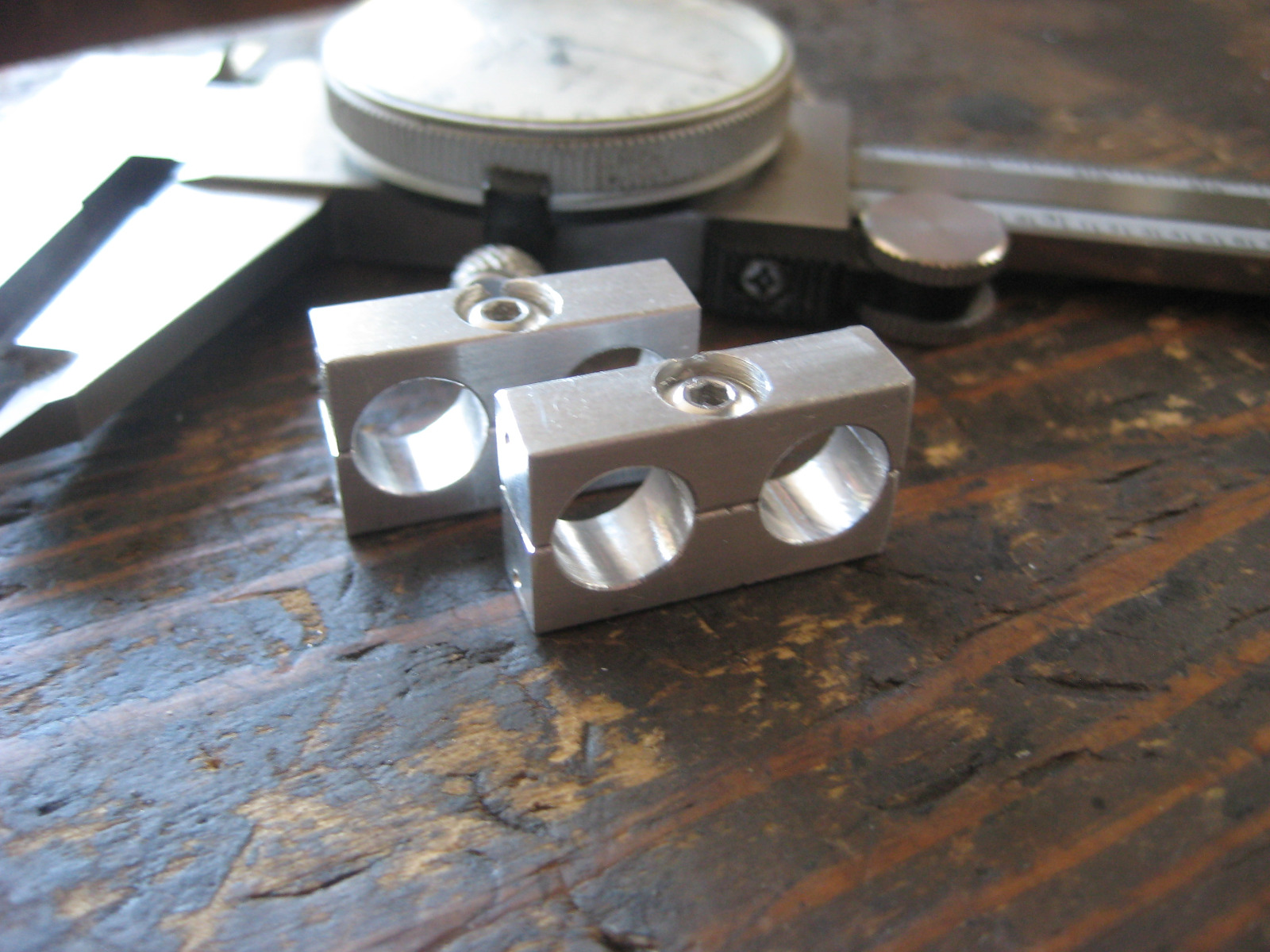

Billet alloy spark plug wire separator for 8mm wires.
Bolt is a tiny M3, and its only 1/4" x 1/2" x 7/8" made from two pieces of 1/4" square bar 6061.

Finished the spark plug wire separators and decided I did not want to risk putting the corner radii on the ends because they are so damn small with hardly any material left on them. I think they turned out OK, I admit I am not the greatest machinist, just passable.
I only had some M3 flat head bolts and they were not long enough so I used button head bolt and cut them to fit.
They will get the job done, will probably have to reapply the number decals on the wires as they might show too much.

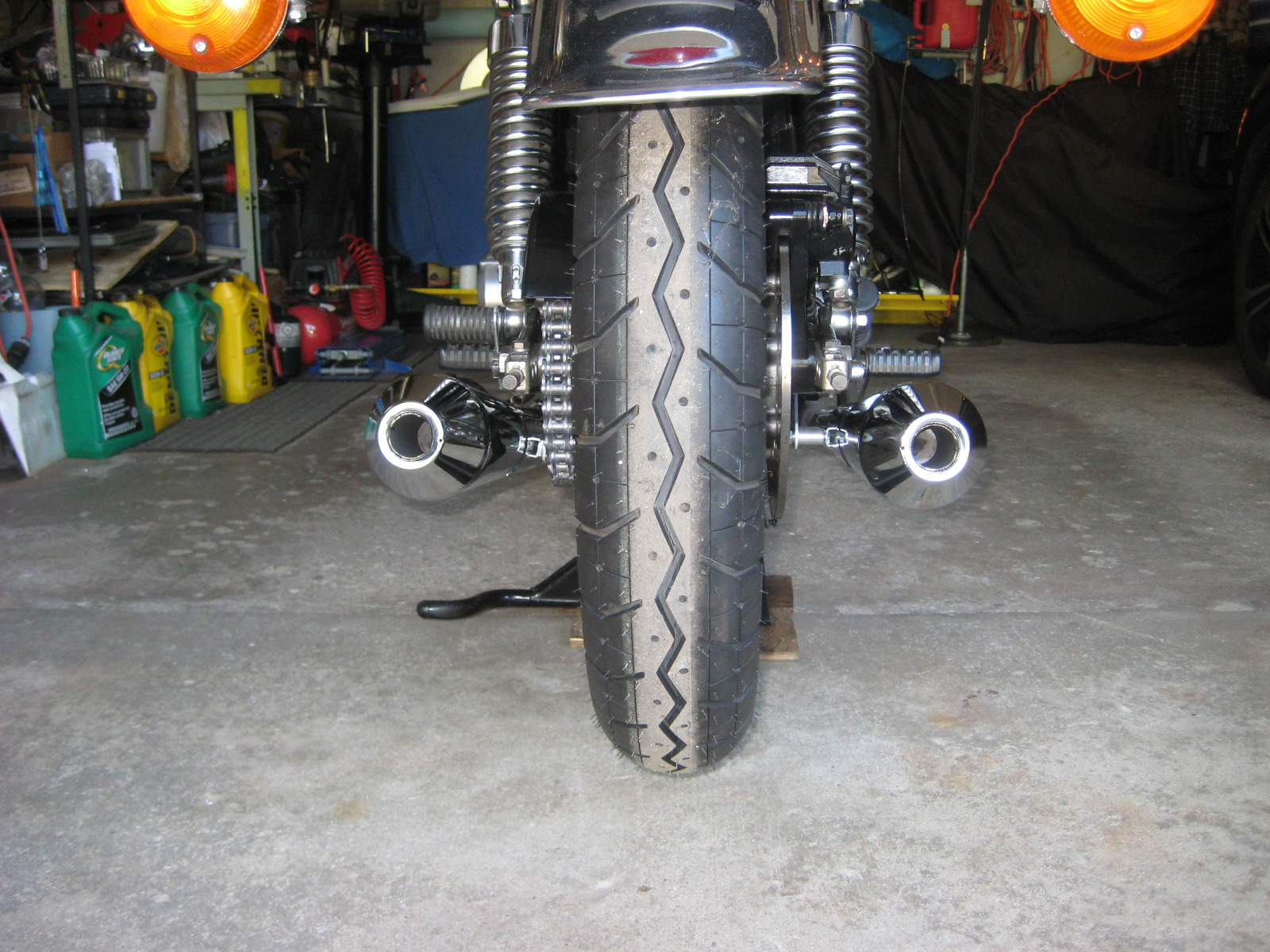

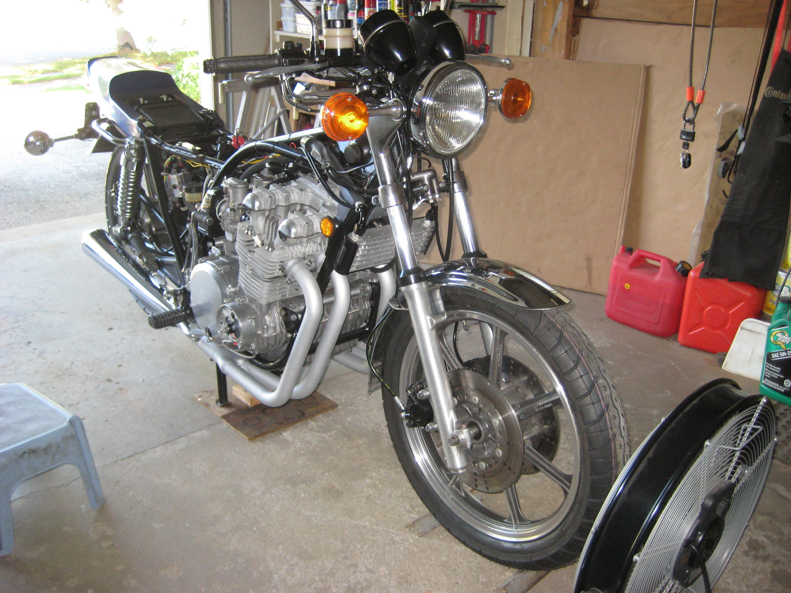

I got the RH muffler almost at the same height and distance from the frame center line as the LH muffler (to within 1/16") Its sort of difficult to measure precisely, but it looks OK to me.
I used the old drop bracket on my first attempt from the LH muffler and it seemed to be very close to what I needed. I also used some new 1" long standoff's I machined on the lathe.
Now I need to fabricate that drop bracket in a billet version as its basically scrap, but it served a purpose.

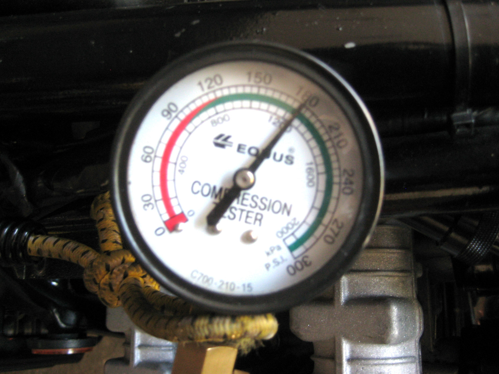

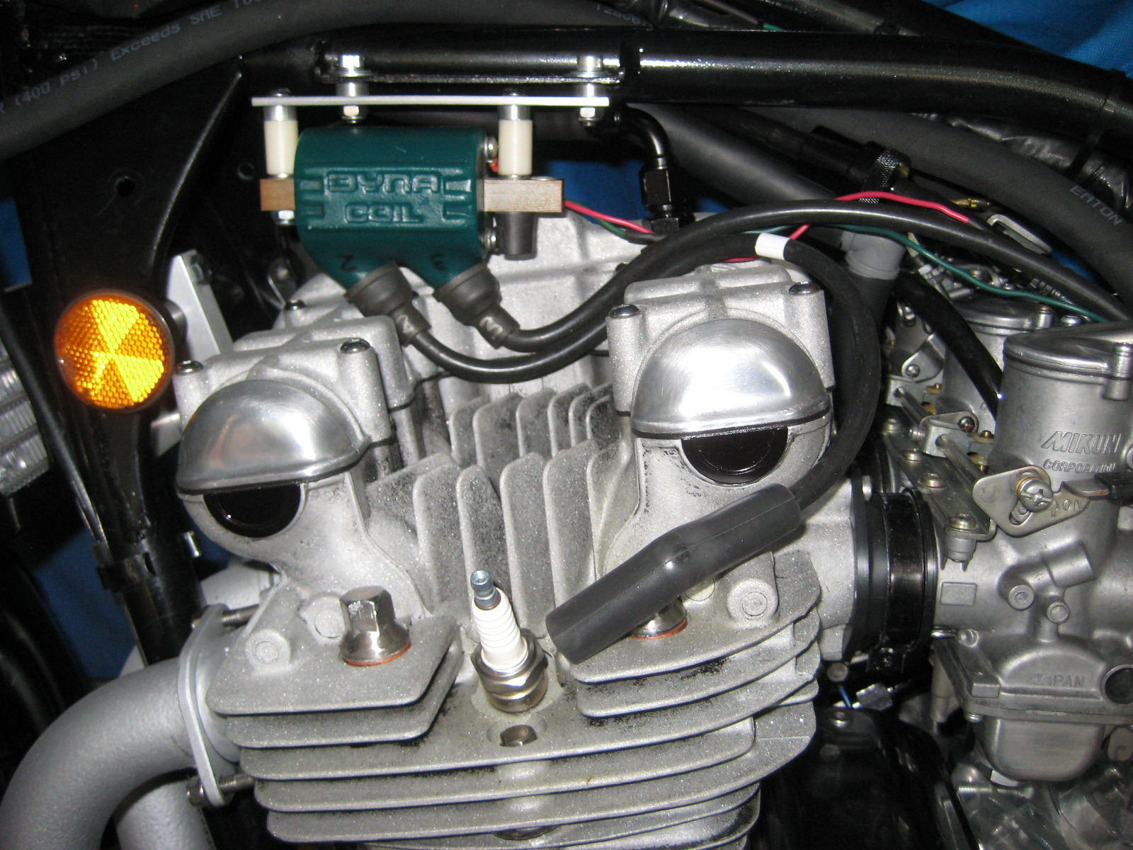

Today I did a compression test to verify if there were any tight shims. I got 180/160/155/175 PSI across the bank from #1 to 4.
Since I did not have #1 spark plug running it was probably down to a plug boot not seating correctly, as I did have the plug wires disconnected to do a spark test prior to that.
At least there are no shims to change yet.
Compression is typical for a engine with only a few minutes idling and zero road miles after a complete rebuild.

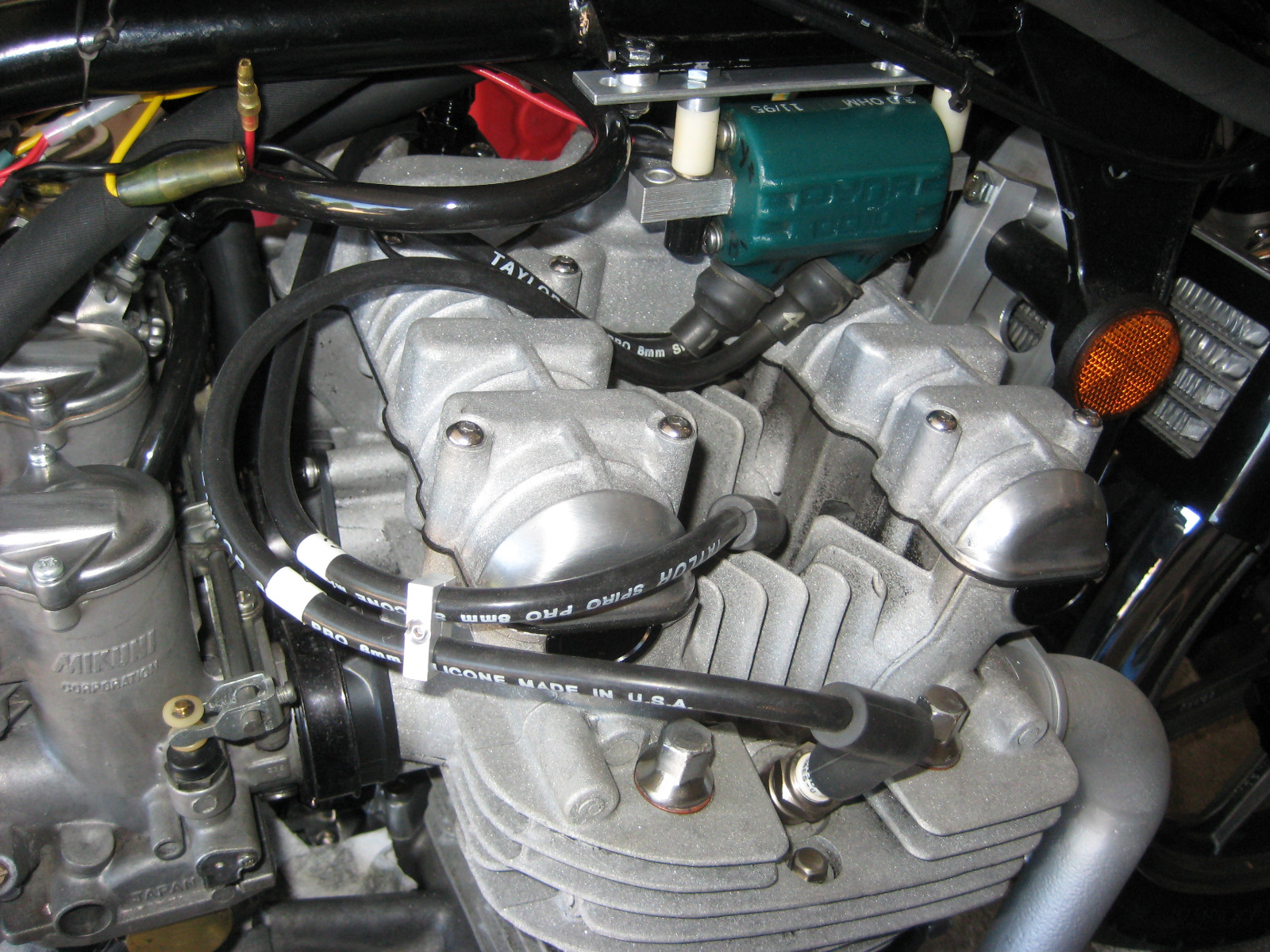

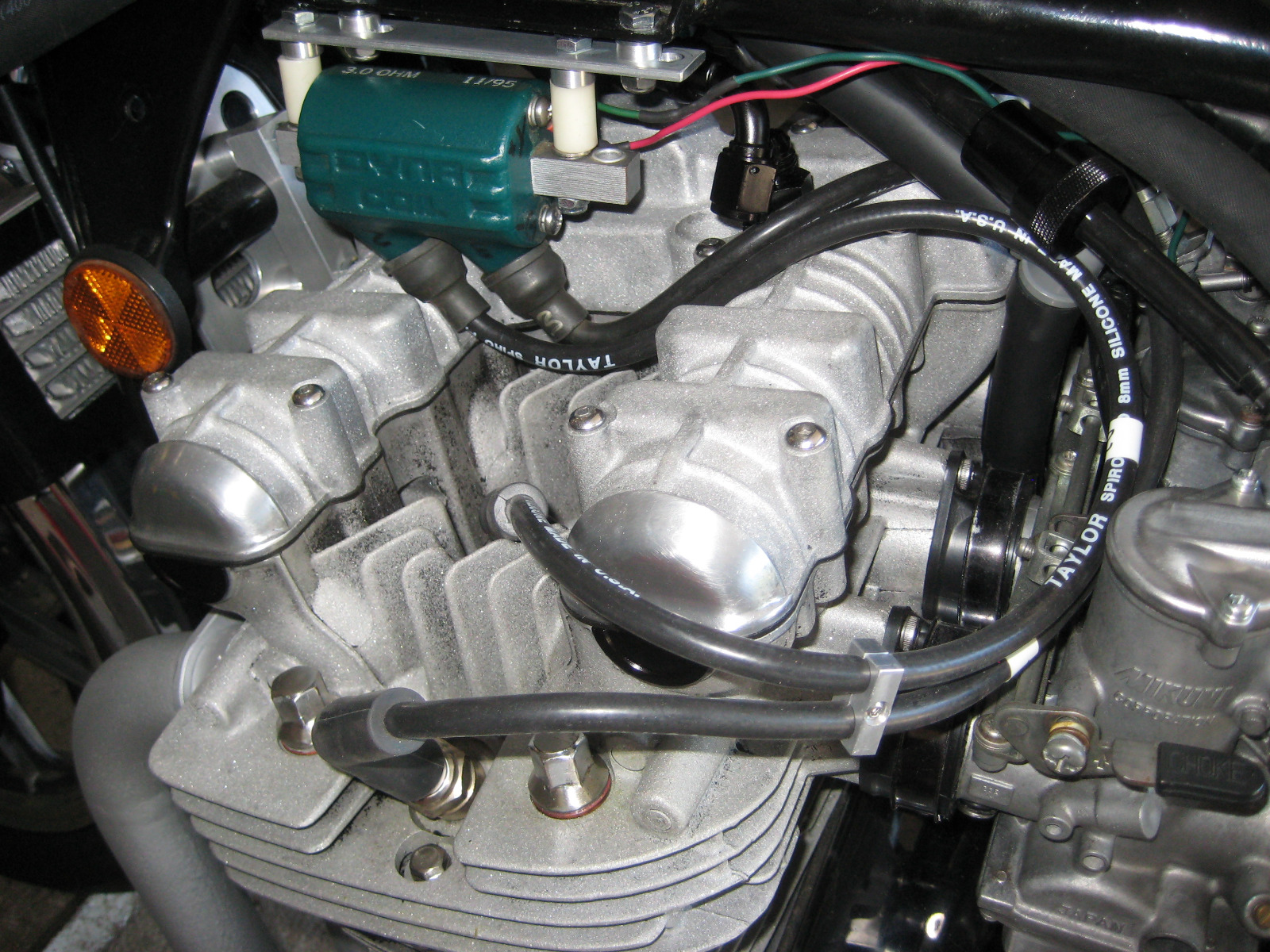

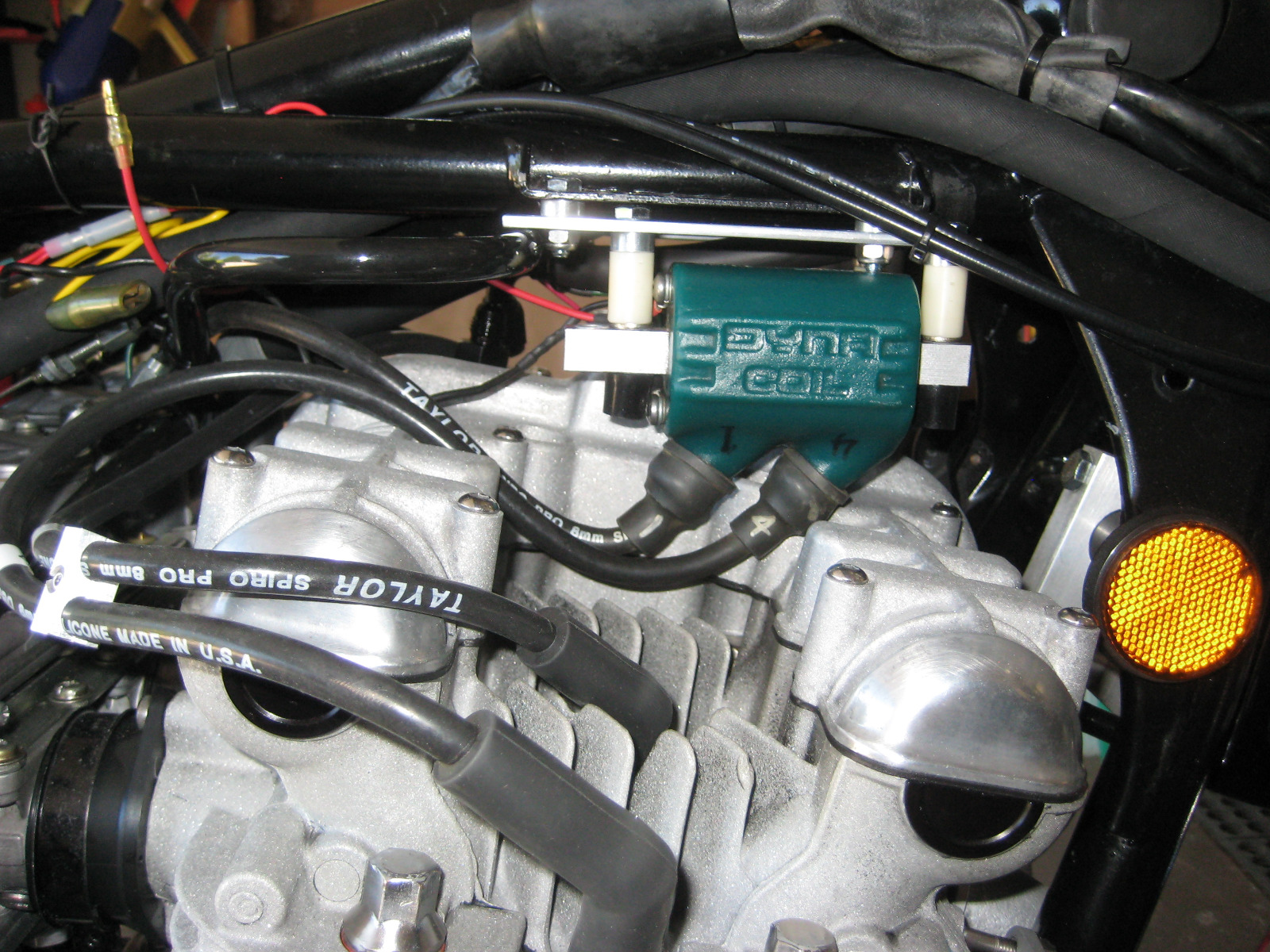

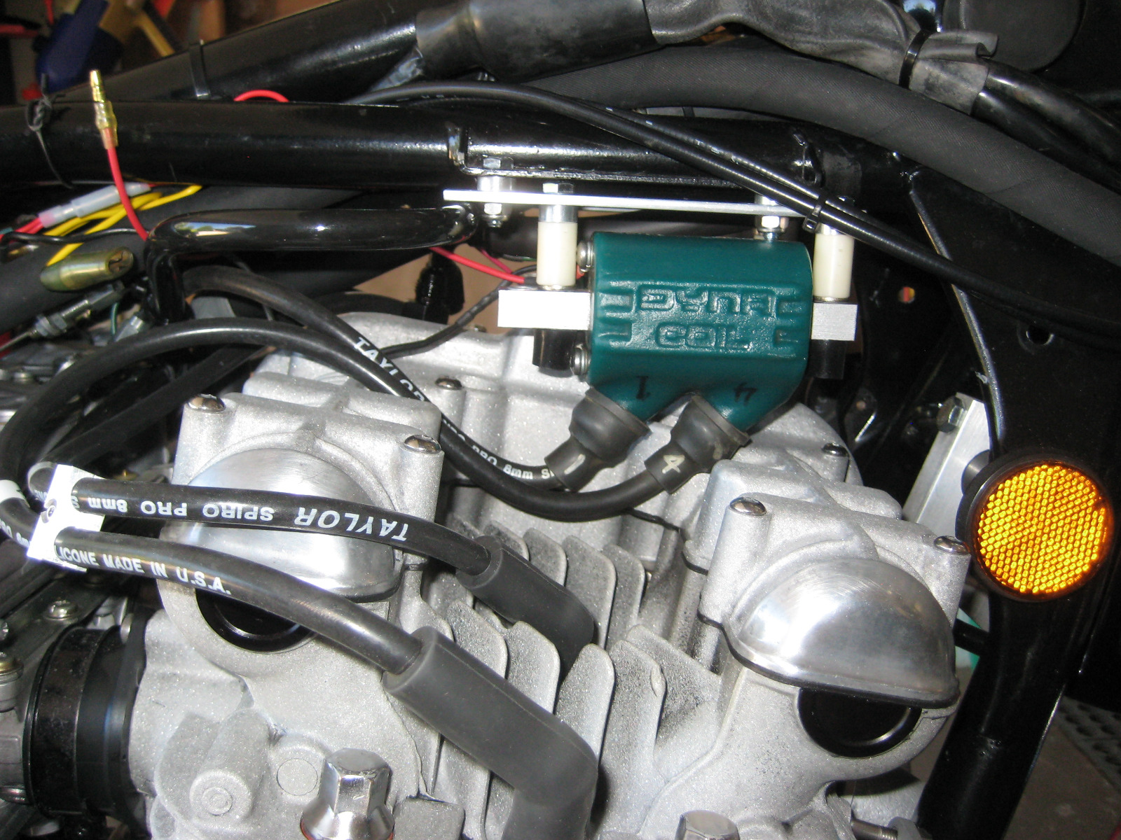

I fitted the coils to check the new setback and route the wires to see how the new wire separators look. The will do the intended job of securing the wires since they are out from under the gas tank and out in the open.
Wire separators.

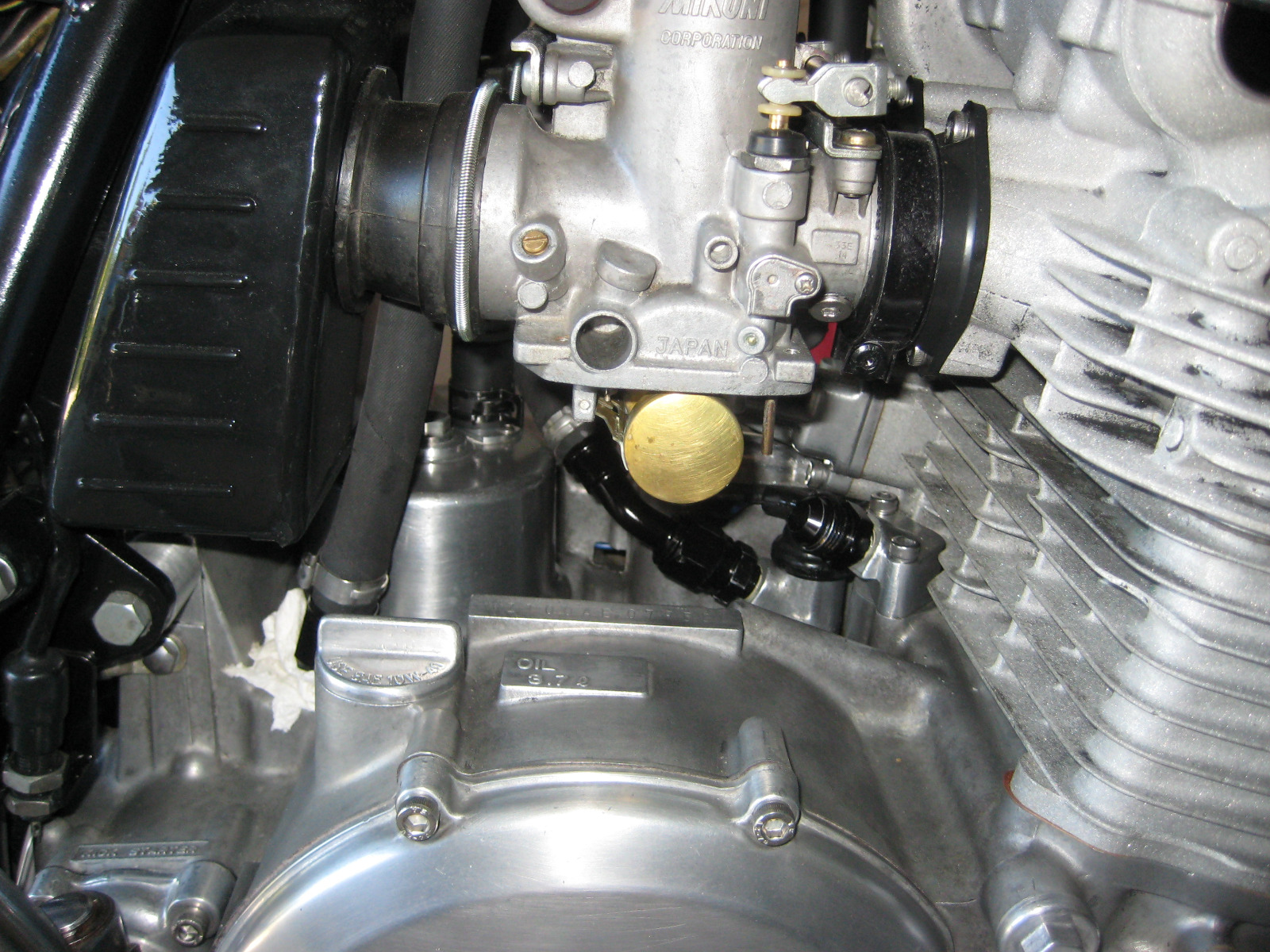

Swapping the pilot jet on #3 carb body was a chore, had to disconnect the oil line and push it to the back. No issues but took longer than expected but now I know what it takes to get it done.
No chance of rotating the cam cover to the front of the engine, the oil cooler bracket it in the way.
Will see how much room I can make tomorrow when I jack up the cam cover to fix the leaking cam end plugs.
Wire separators.
