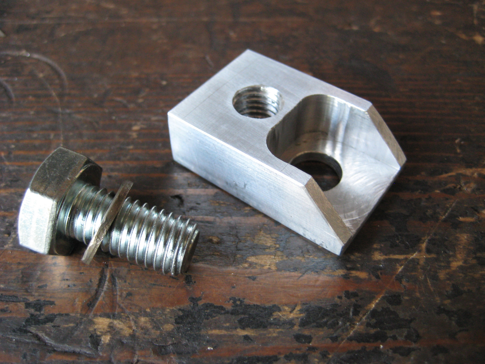

I finished machining this drop shim for the RH muffler, got it installed and sealed the muffler to collector pipe joint with 3Bond sealant.

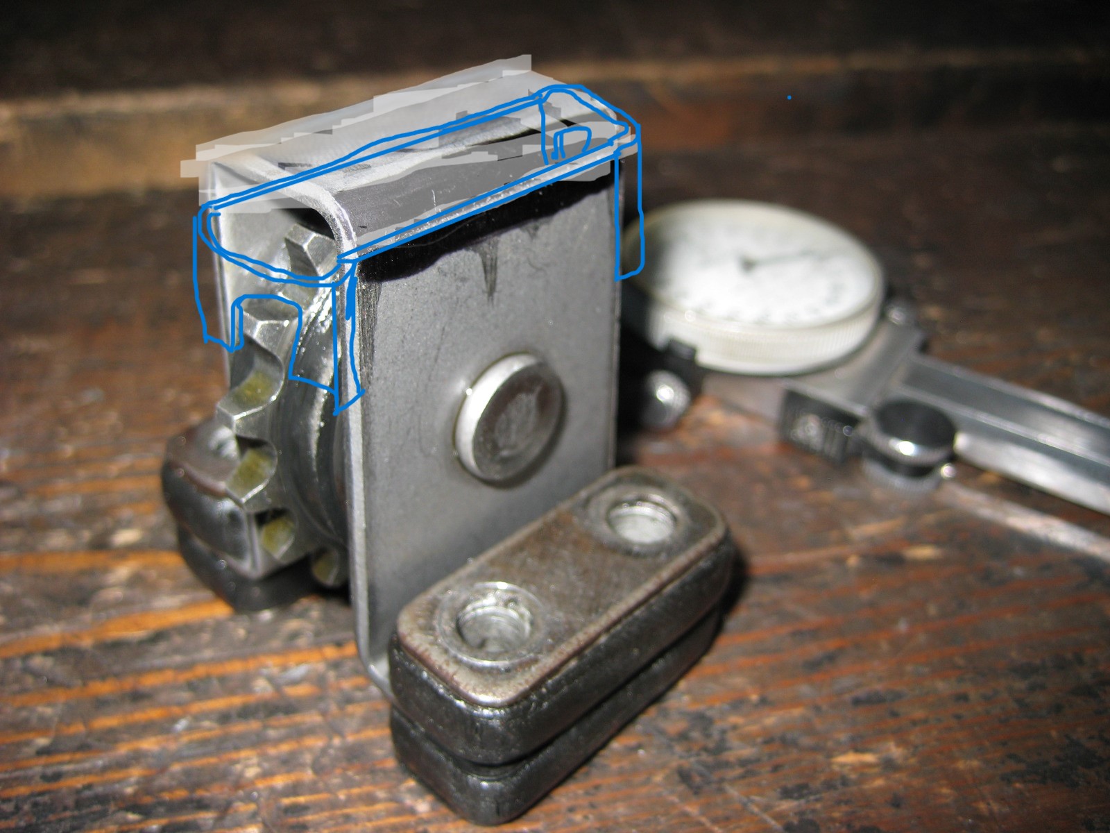

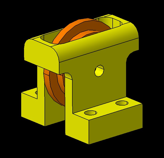

Just spit-balling here but wouldn't it be relatively simple to brace the sides of the idler then remove the required amount from the top (space permitting)

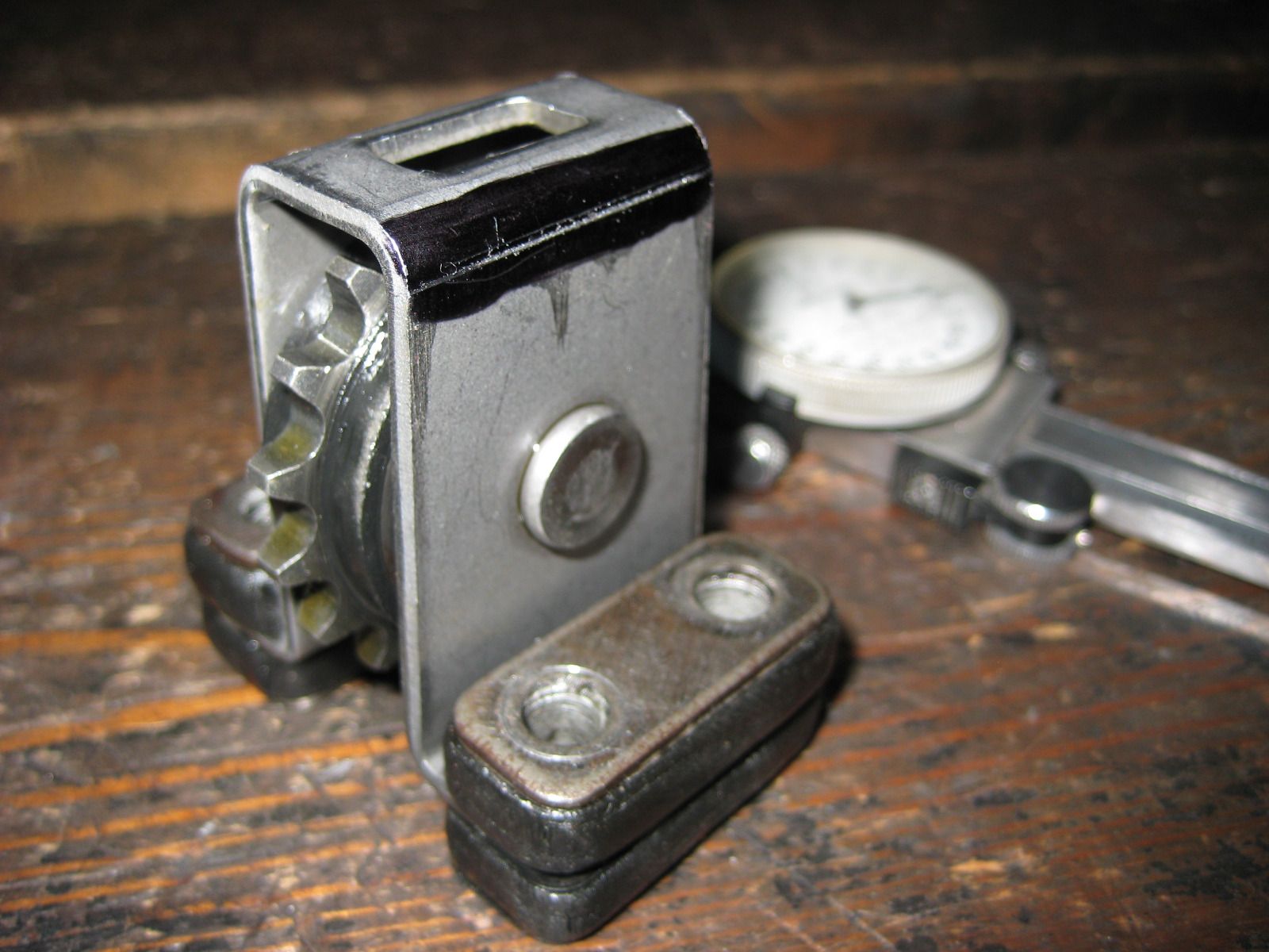

I bolted the idler to piece of aluminum then cut the top off and lowered it to the same height as the sprocket then welded it together. Doing it like this doesn't change cam timing or amount of chain adjustment.

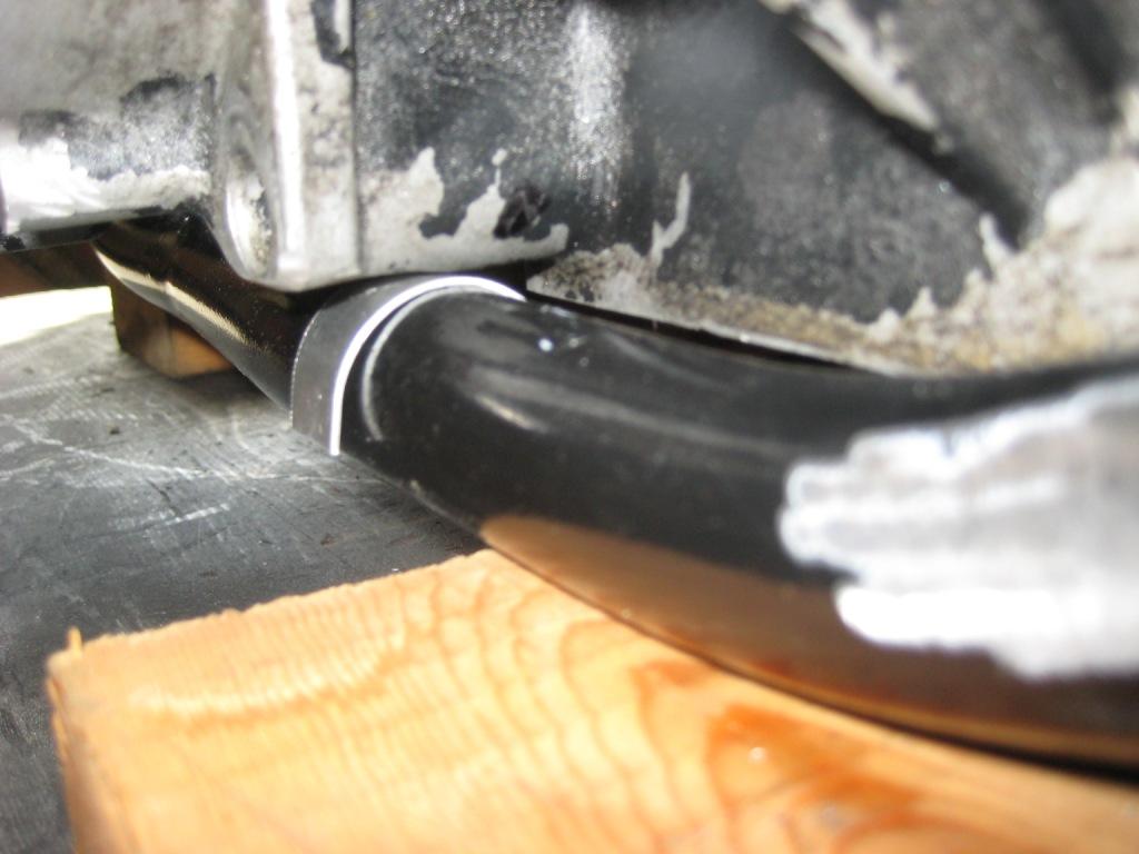

I was thinking lowering the engine by removing the long bolts and using a small floor jack 1/2" might be the easiest way to remove the cover. Lots of room in there when they are out.

30 Jul 2025 08:01Indeed, this was just an alternative way to achieve the same outcome but may give more clearance given the frame/engine combo here.I bolted the idler to piece of aluminum then cut the top off and lowered it to the same height as the sprocket then welded it together. Doing it like this doesn't change cam timing or amount of chain adjustment. I posted a photo of the mod here but don't see it now.

30 Jul 2025 11:22 - 30 Jul 2025 13:01I came up with the same conclusion the other night...
Just need to check the cam cover internal dimensions to make sure it clears. This design keeps everything the way it is except clears for the interference at the top, plus no dowels or loose pieces to worry about.
No dropping the engine to take the cam cover off, there is only 1/16" of clearance from the engine case to the bottom frame rails on this conversion.
