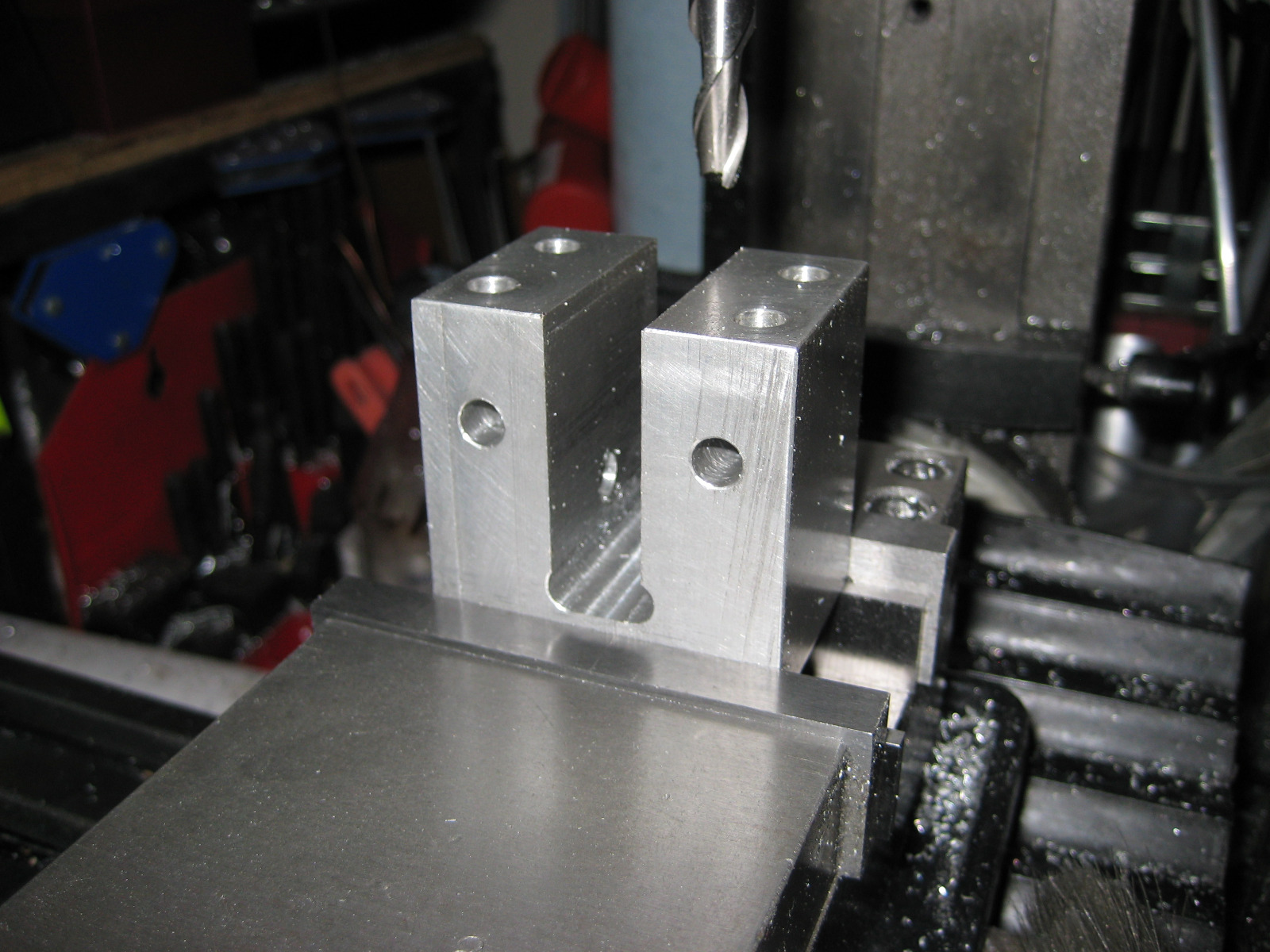

I got out in the garage today and got all the holes drilled, then I started milling the main slot for the sprocket.
Its slow going on the mini mill

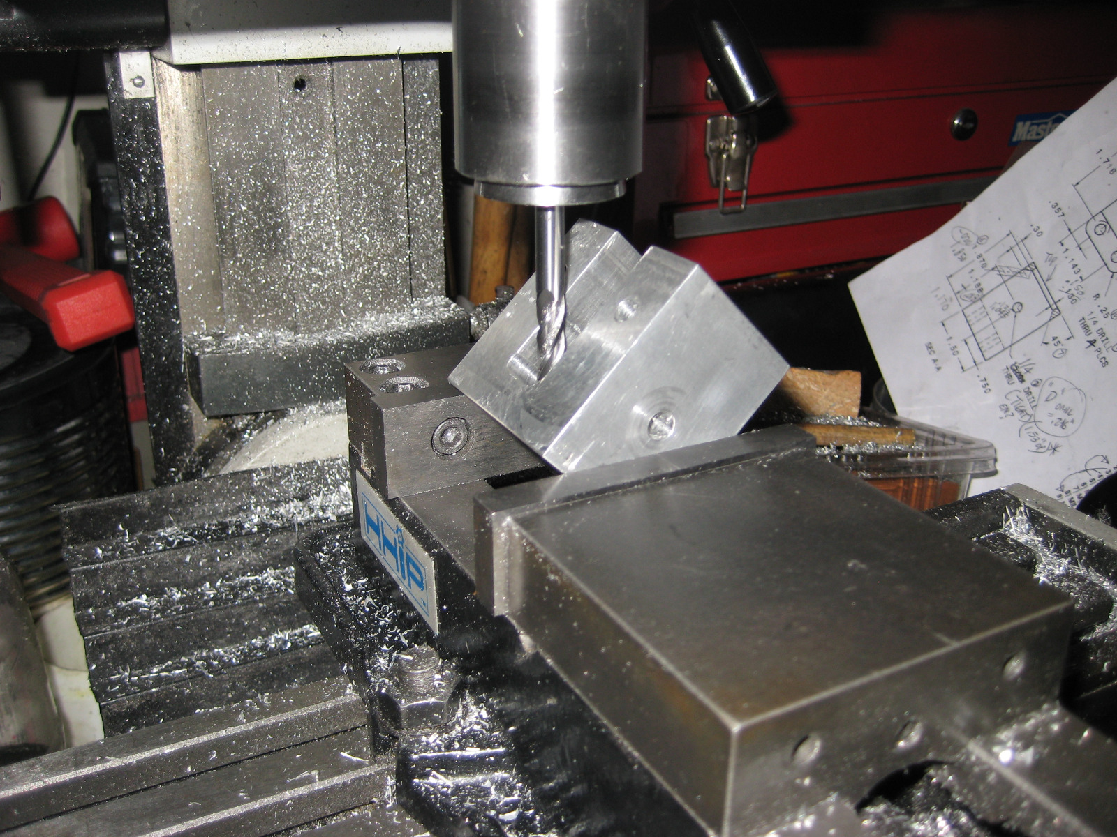

Re: KZ650 Sleeper Build (KZ1000 engine transplant)
26 Nov 2025 16:10
Yes, its just frustrating taking 1/32" passes when I need to cut away +1-1/2" but it will get done. It was 12C in there so not too horrible, better than a visit to the dentist
This is where I stopped for the day.
1978 KZ650B2 modified project
The following user(s) said Thank You: Nessism, MFP-Joe, Wookie58, kimchella
- Injected
- Posts: 1831
- Thanks: 1279
27 Nov 2025 13:04 - 27 Nov 2025 13:04

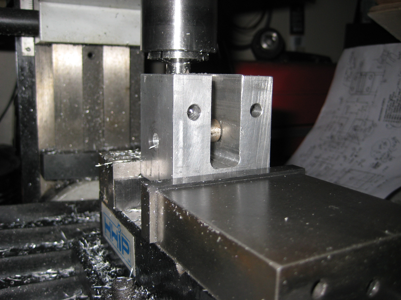

It got cold and windy overnight with trace snow so the garage is now 7C. Its OK in there as I can't see my breath, once I see my breath and my nose gets cold its time to re-evaluate if I need to be out there or not.
Today I did put some time in and milled that slot down to the two holes at the clamp edge. I now need to change the cutter so I can go right down to the bottom of the holes. Then I need to go back to that 1/2" cutter to widen the slot to the finish size of .590" (center dowel length)
It all takes longer on a manual machine with no DRO but its coming along as anticipated.

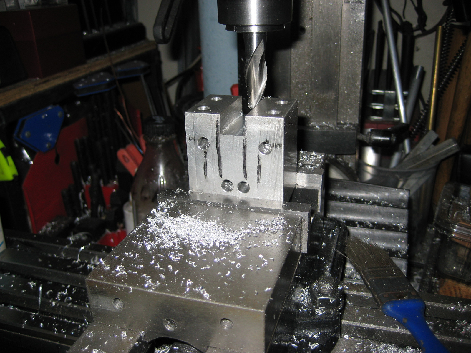

28 Nov 2025 13:14 - 28 Nov 2025 13:15
Got out there today for a short while to continue cutting that slot.
Used the 1/2" end mill to go as low as possible on center then switched to a 5/16" to go to the bottom of the radii holes.
Switched back to a 1/2" end mill to clean out to the finished width of .590" and slid the center pin in which is .589" long. This mill is small but its pretty accurate, and good enough to make these kinds of parts.
There is a little witness line across the length where I had to put the cutter down in two steps but it clears the pin OD. The 1/2" end mill I have was not long enough to machine it in one pass.
I will see if I can get some more work done before we get a dumping of snow.
Last edit: 28 Nov 2025 13:15 by Injected. Reason: sp

- Injected
- Posts: 1831
- Thanks: 1279
29 Nov 2025 13:16 - 29 Nov 2025 13:22

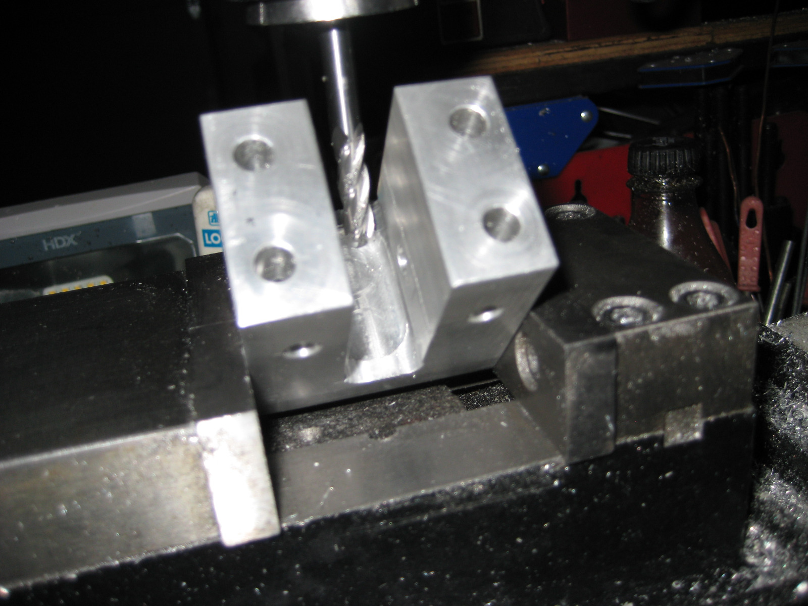

Every time I go out to work its colder, 6C today inside and expecting snow tonight, possibly 6 inches or more.
It took quite a while to mill out the inside pocket, and my 1/2" end mill was just long enough.
Next setup is at a 45 degree tip and have a 1/4" end mill mounted to cut away some of that material left on both ends of the slot to clear for the idler sprocket. Very light cuts expected so the setup should suffice but realistically I could do the same thing with a 1/4" carbide in my Dremel tool.
Last edit: 29 Nov 2025 13:22 by Injected. Reason: info

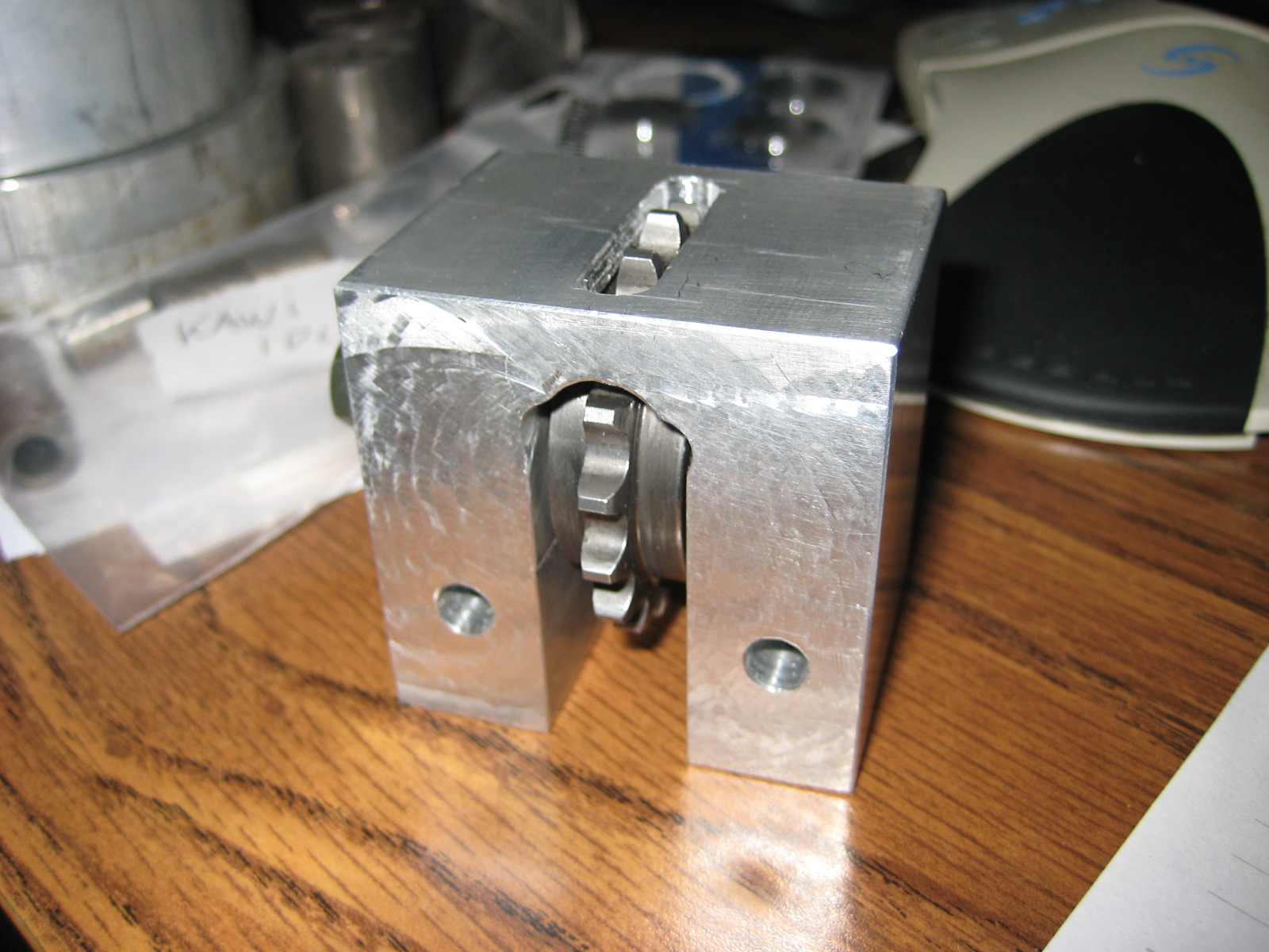

I was able to get out in the garage today for a short time so I did the angle cuts for the sprocket clearance then cut the top slot where the sprocket teeth stuck thru.
Had it assembled in there from one side and it spins just fine with no binding. A few mistakes along the way but its functional.

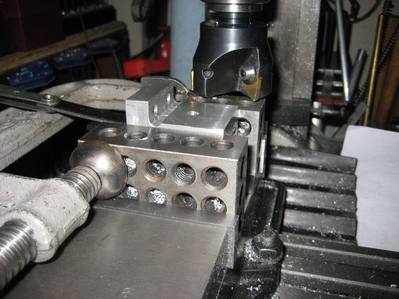

Got out in the garage to get some work done, it was 2C in there but forged on.
A bit of a funky setup after trying to cut it with a end mill, which was too slow.
The 2" face mill gave better results, but had to bridge the slot gap to stop it yapping and run a C clamp to make it rigid.
Stopped short of where I need to be as there is another job that needs my attention. In no rush to get it done so I will get back on it when time permits.

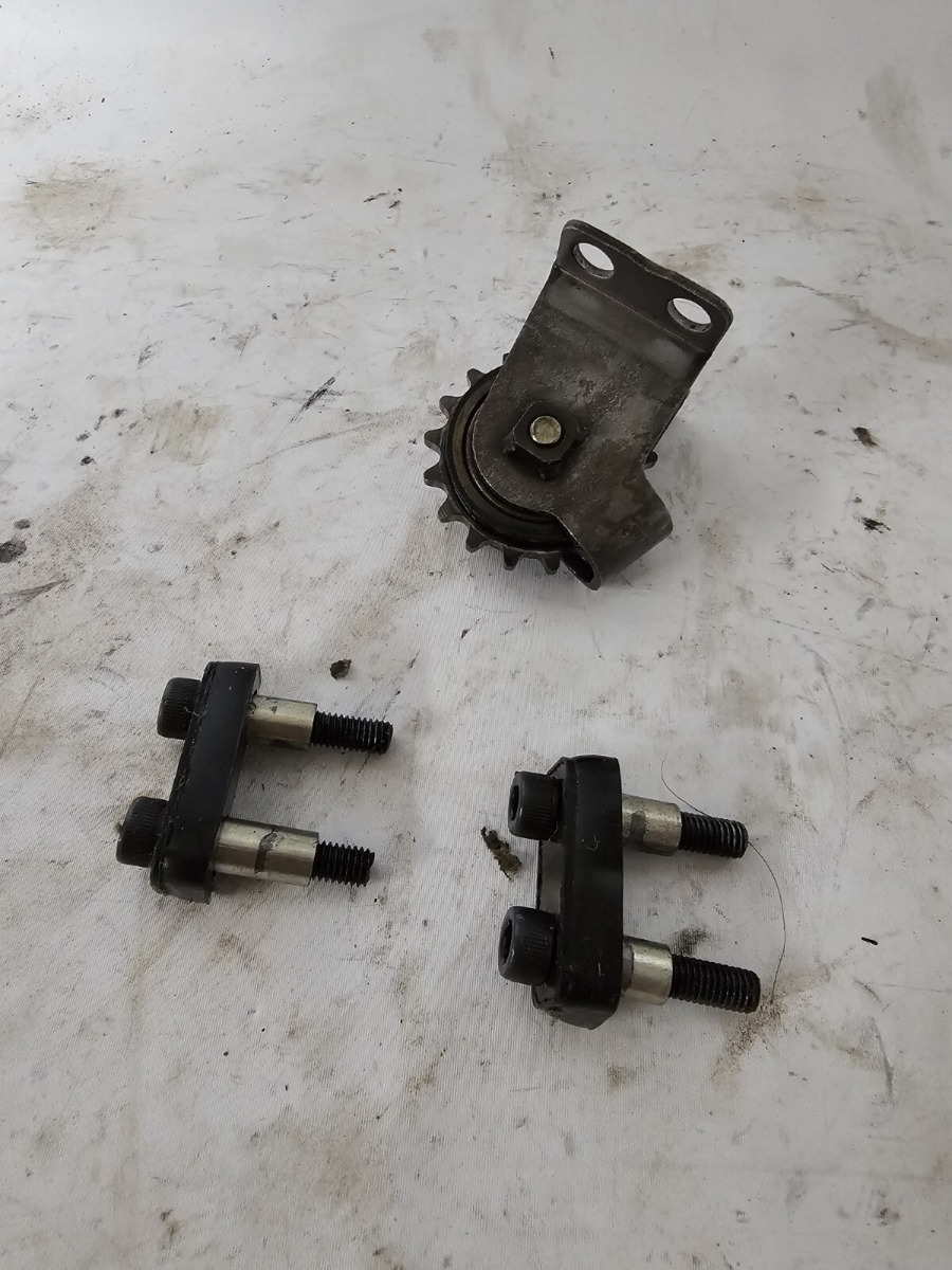

After a couple of days of snow (about 8") it was mild and sunny today so I did a bit more milling but quit just a bit short of being able to take it out of the vice. My feet got cold so it was time for a whiskey
I did buy this extra 650 idler off Ebay as it was listed for $3, but with shipping and exchange it came to about $33 Canadian, still a bargain and will be "rebuilt" with billet center.
Nothing going on tomorrow so I may be able to finish up on this bracket.
