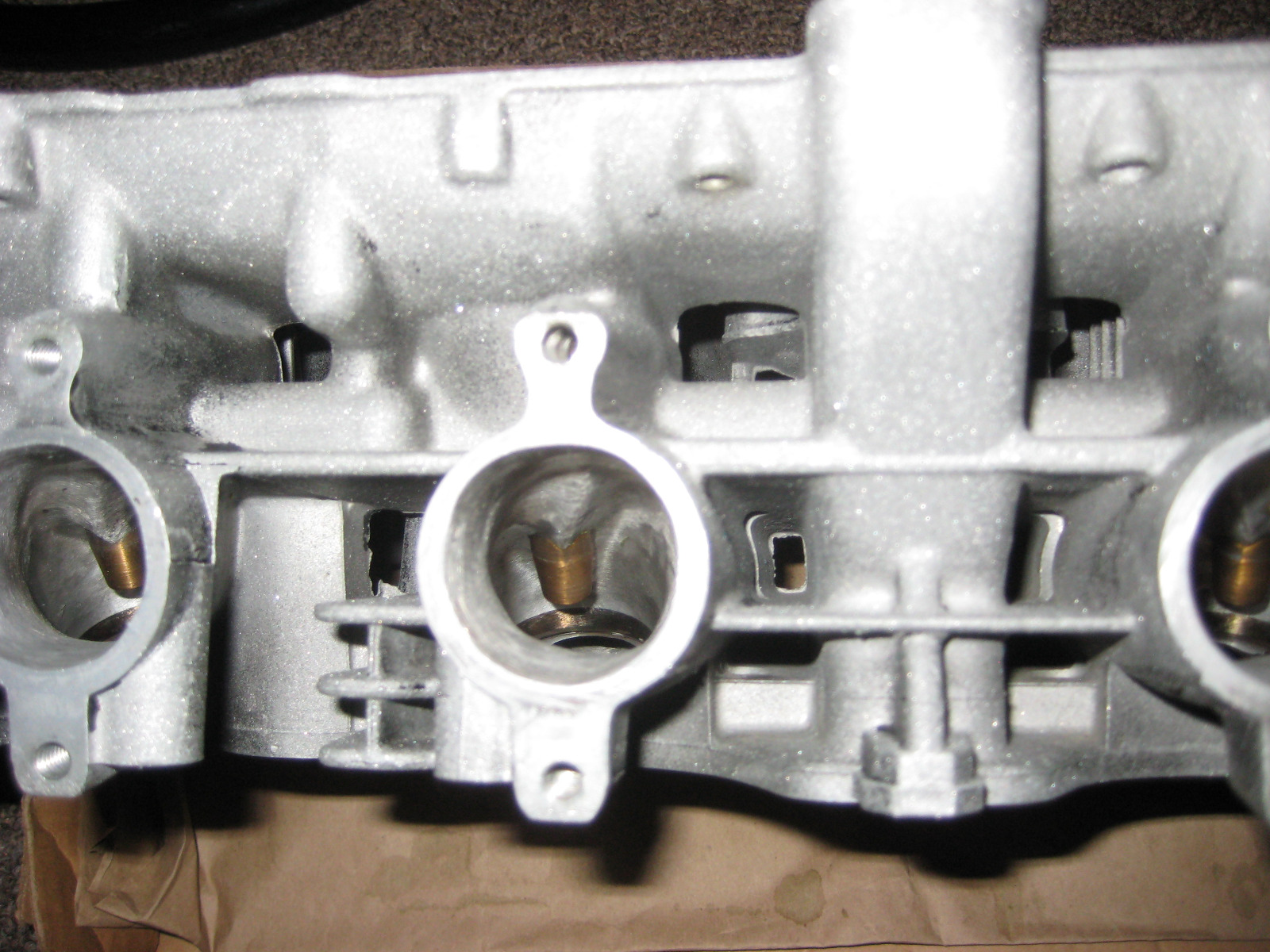

Nice work on the porting and manifolds, doesn't look like there is much left for the manifolds to seal against (pictures may be deceptive) will you need "sealant" ?

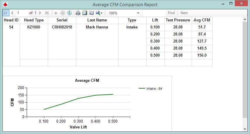

Looks like he opened the ports pretty good. Wonder how they'll flow?

The port job was not too aggressive and there was plenty of face left to seal on. The rubbers were sealed with grey gasket maker similar to 3Bond.
The head was give a street style port job probably one notch down from a drag race setup. It was flow checked on a Superflow 110 flow bench.
It flowed 96CFM intake and 74CFM exhaust @ 10" of water which I was told is similar to what he does for a road race engine. The valves are oversize 37/31 mm and the cams are .420" lift Russ Collins. It flows more than a stock GPZ1100 head that has bigger valves.

That chart works out to 89CFM @ 10" at .400" lift, so fairly typical for a high performance street engine. Stock GPZ1100 head comes in at 84CFM @. 500" lift.

The KZ head on my 1327 drag engine is ported to 110CFM even though it the smaller 37/31 valves. Its still not opened up on the intake like some I have seen that use epoxy or end plates, it still has some meat to seal the rubbers :)
Here is the intake side before the rubbers got put on.
You don't really have to have GPZ head to make some decent flow numbers, but you do have to take pounds of aluminum out of a KZ head to get similar results.

From that angle you can see there is a decent sealing surface

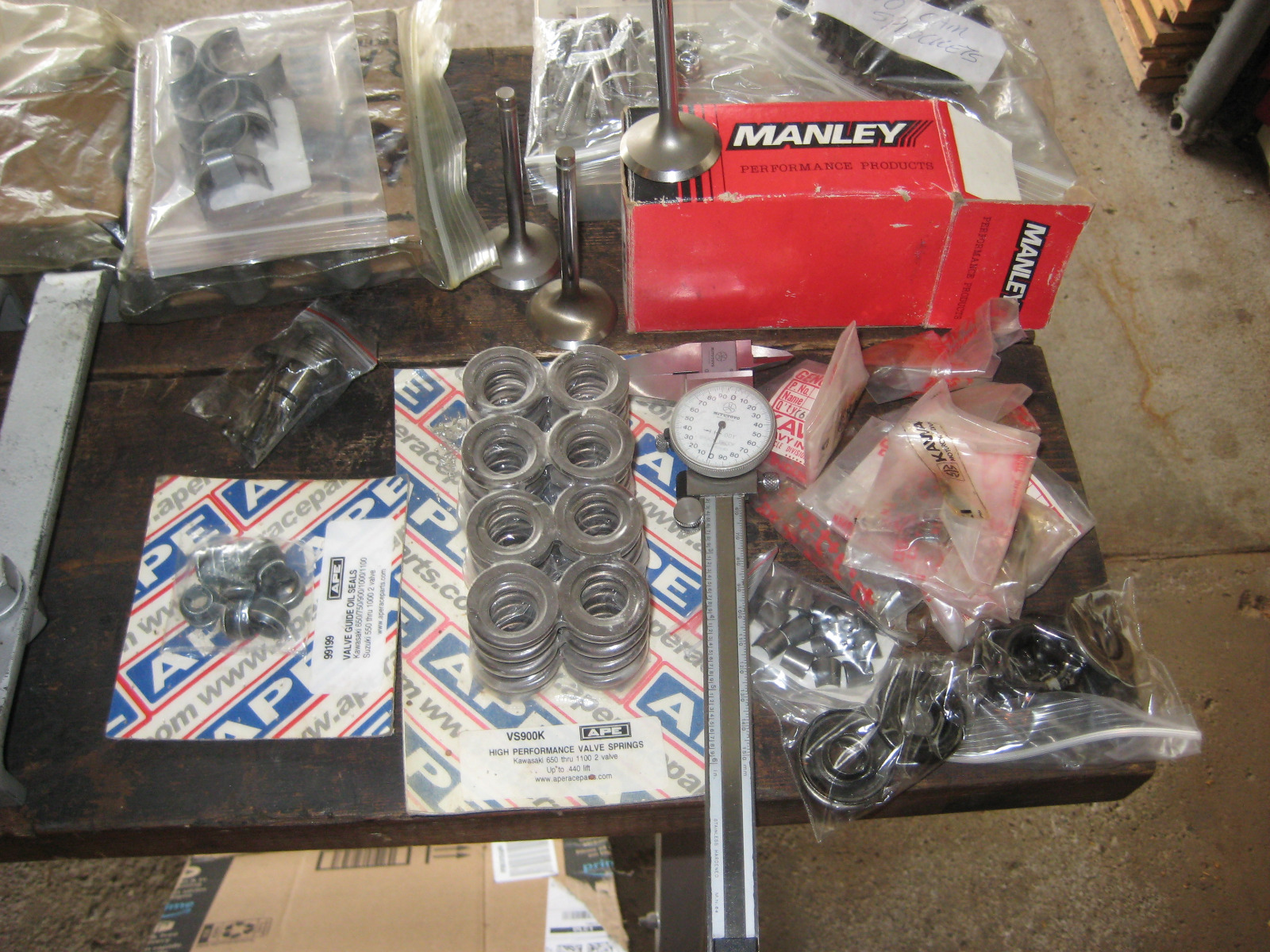

I did not get very far on this cylinder head assembly today.
I realized when I put the light checker springs together that the intake valves need the keeper grooves re-positioned below there current position as the tip is .020" below the keeper tops. The intake and exhaust valves just happen to be the exact same length and tips are in the same position relative to the cam CL (valve faces sunk symmetrical on both sides) I can't move forward without addressing this situation, and I don't know why I did not see this before! Just a small hiccup.
I did install the exhaust studs and fixed up some bolts for the cam caps. Installed the cam gears on the cams and tach gear on the head, small stuff like that was addressed. I also pulled together all the parts to assemble the head properly.

I just went out and double checked the intake measurements, then setup the exhaust side to check if those valves need tipped. Found out the exhaust side valves are OK as is, and they can be assembled with shims around the 270 range.
On the intake side if I was to skim enough off the collet tops to get .010" below the tip of the valve, the valve tip would be .010" below the recess in the retainer and the shim would be sitting on the retainer and not touching the valve tip.
I think I ether need some collets where the radius is closer to the top instead of the middle (stock units) or I need to grind another groove on the valve stems lower than the current groove (done this before) I will get in touch with the guy who did my valve job and sold me the intake valves in question, we will work out some kind of solution to get me back on track.

The guy who did my cylinder head has been on vacation, he has a cottage up North and usually spends a few weeks up there then brings his boat back to home. This seems to be open ended, so no idea when he will be back but I did leave a message about my valve groove issue.
I could cut new grooves myself but I figure this is his oversight so he should solve it.
While I am waiting I figure I need to check piston to valve clearance as it may be a issue with the cams I have. At .420" lift I am not sure if the valve pockets in the pistons are deep enough, the other issue is the head has been surfaced by a unknown amount. I do have slotted cam sprockets but that is not always enough to get you out of a bad situation.

My guy called me back today, I am going to his shop in the next few days.
He suggested a couple of things to correct the intake valve issue. He says using titanium retainer where the recess is deeper will give extra clearance. He happens to have 4 sitting there from a full set with matching shortened keepers that I can use. He is pretty sure this will solve the issue.
He also mentioned boring the stock 650 retainer recess but that would be only as a last resort.
1978 KZ650B2 modified project

Went to my engine guys shop this morning and resolved the intake valve issue.
He had a bunch of miss matched titanium retainers that we sorted thru. They are about .130" shorter in height that stock 650 retainers but the recess where the shim sits is about the same as stock 650.
Since they are shorter, the angle where the keeper sits makes them give a different stack height. He tuned them all to use a 220 shim and there is still room to peel more off the keeper tops if necessary to make adjustments.
