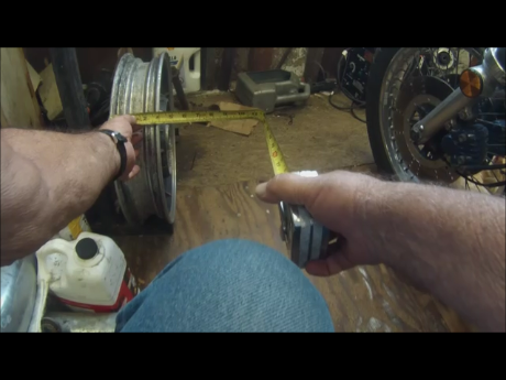

The bead breaker worked fine, got the old rear tire removed but it was on there pretty good. I needed to use dish soap solution and a combination of the breaker bar and tire spoons. I have not put the new tire on yet.
The rims/wheels on the project are 81 GPZ550 (forks,swing arm,rims,brakes) I believe the PO had it set up for road racing because most of the bolt heads were drilled for safety wire.
The 550/650 rims are smooth on the inside.
Are you referring to those rubber tube locks on the rear tire? Both have them but I don't run them, I closed up the rim holes with plastic plugs.

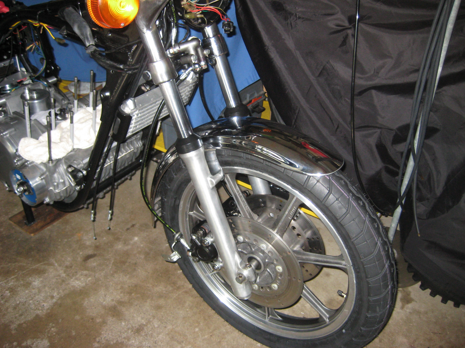

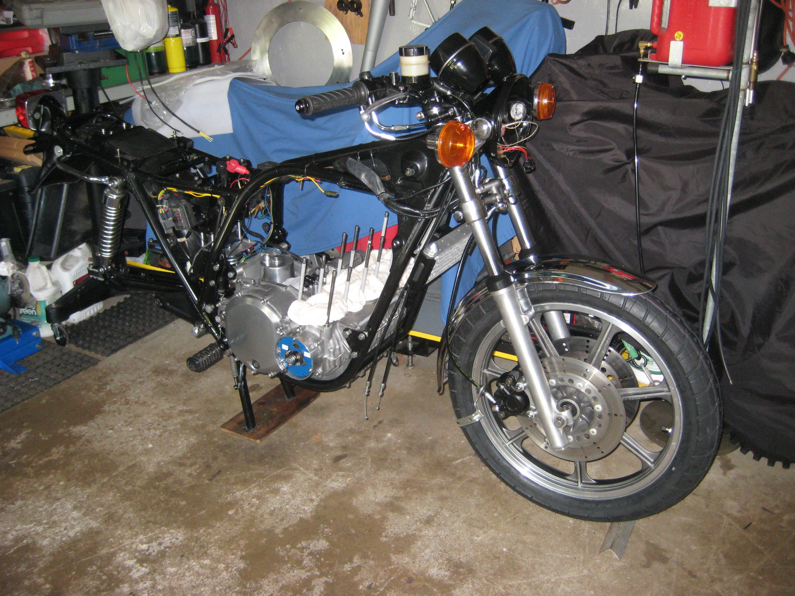

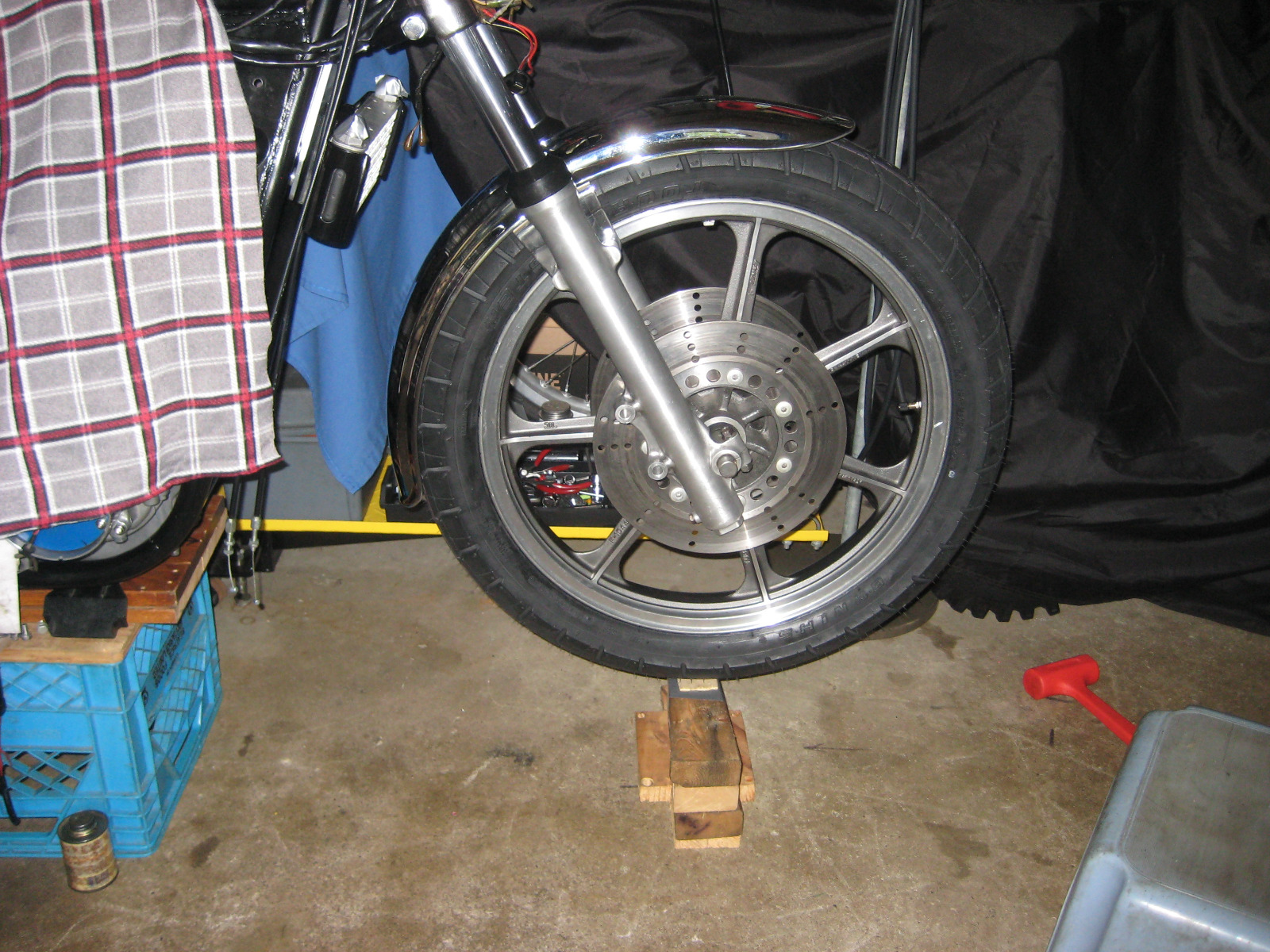

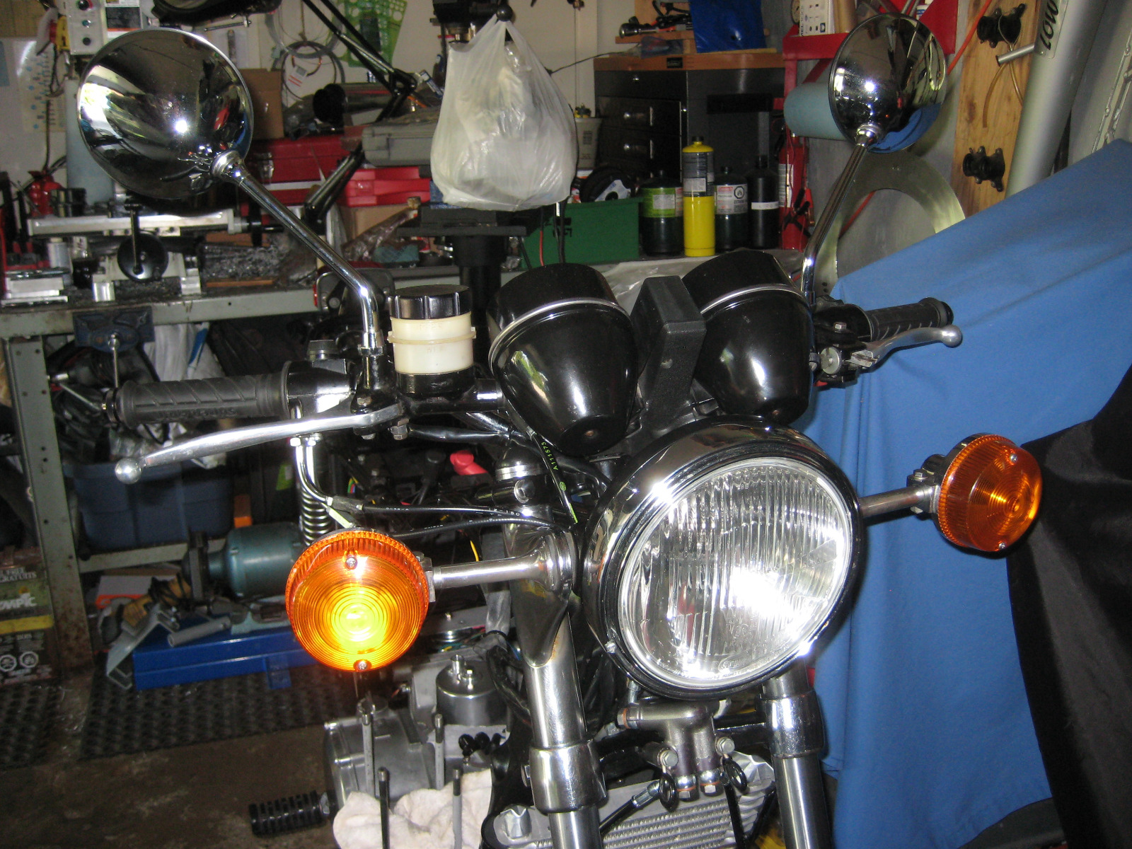

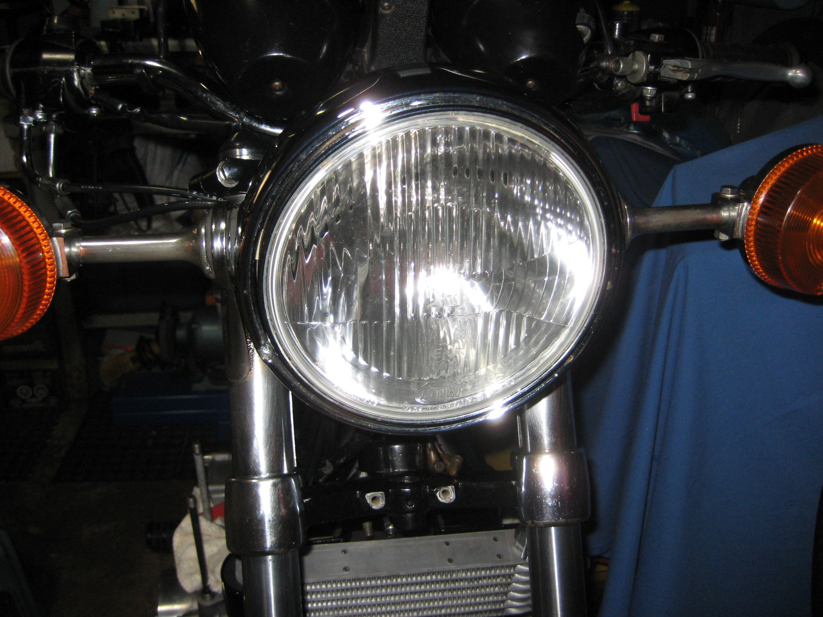

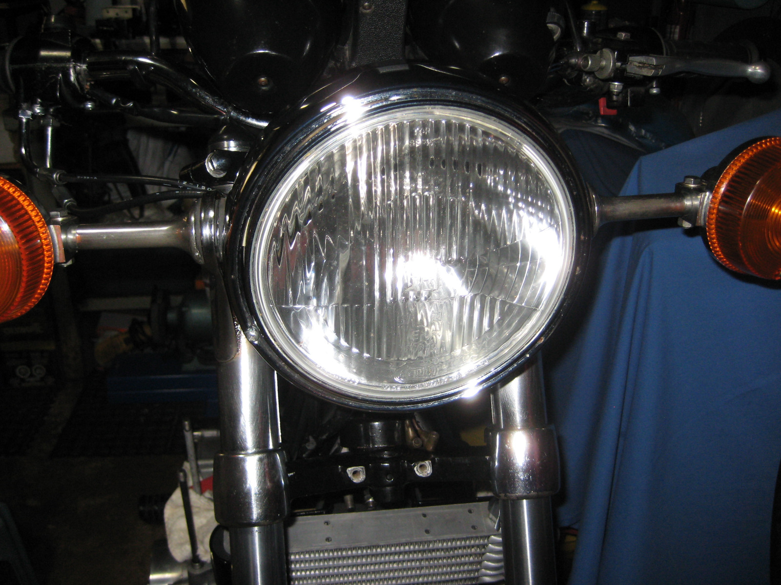

Shitty rainy day here so I decided to get some stuff done. Mounted the front wheel, a bit higher that I thought so blocked it up.

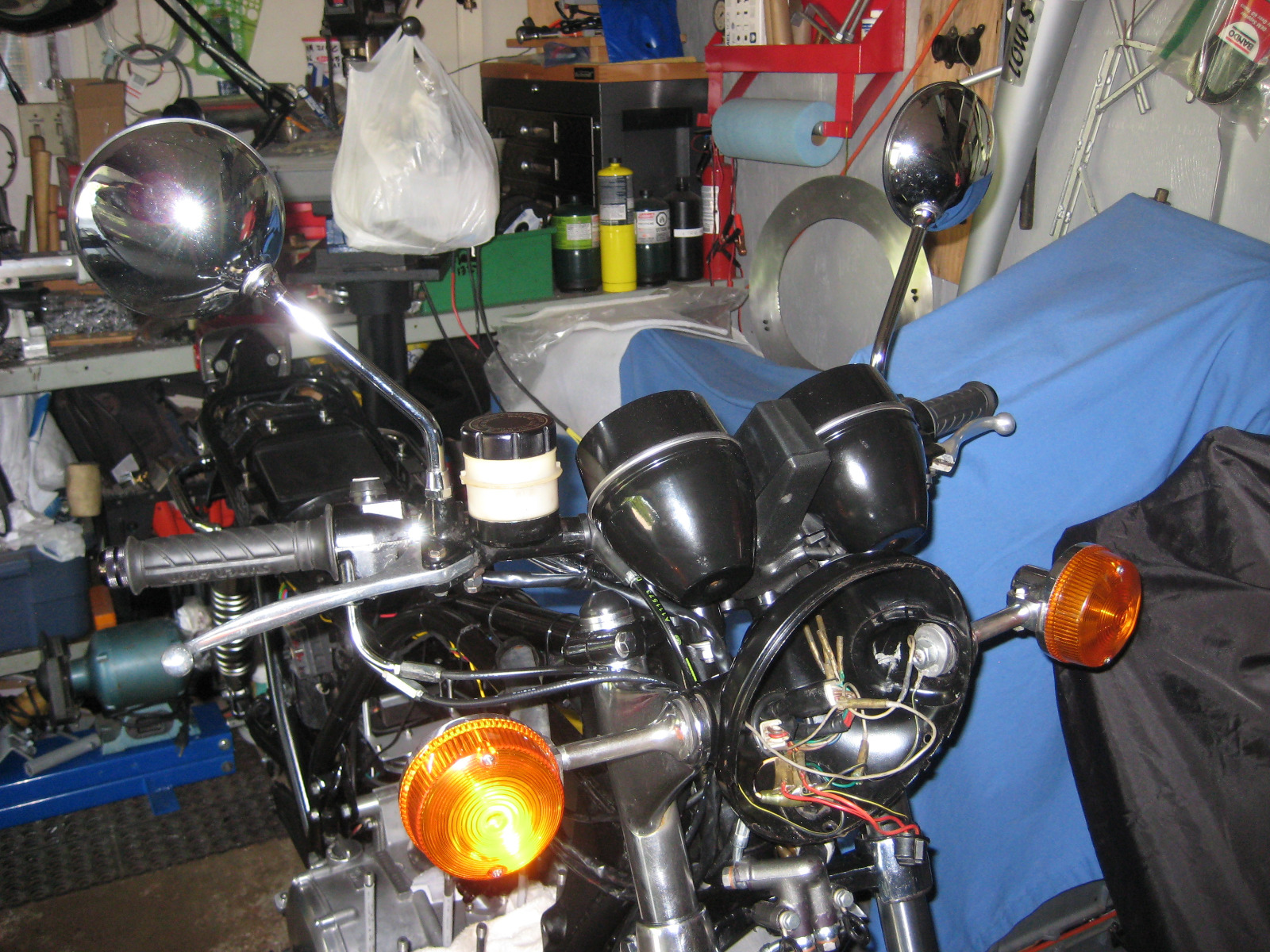

Also mounted the headlamp after hooking up a battery and seeing that everything was plugged in correctly (using Z1 indicators) Wiring does not match 650 harness in there.
Hella H4 Euro style lamp.
Checked the horn and the relay just clicks, wired something in the wrong direction I think. I will have to get it sorted out.

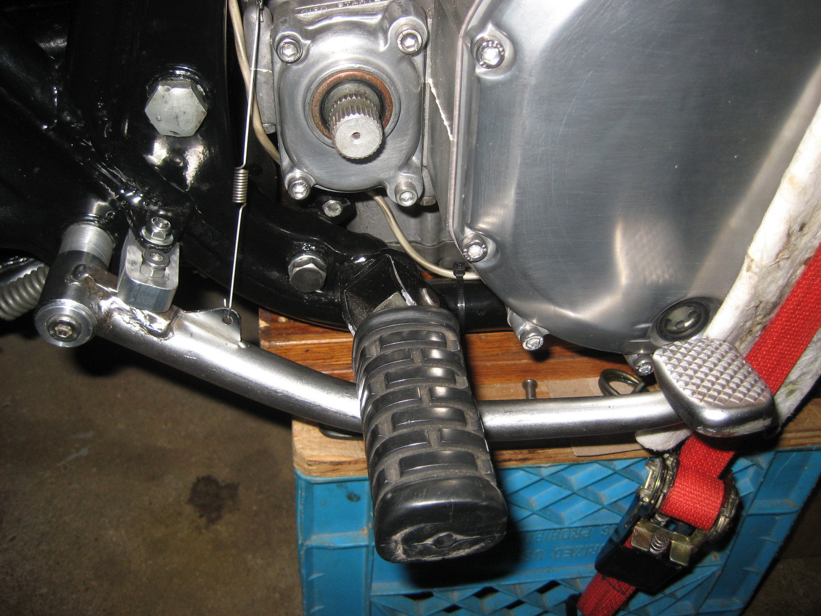

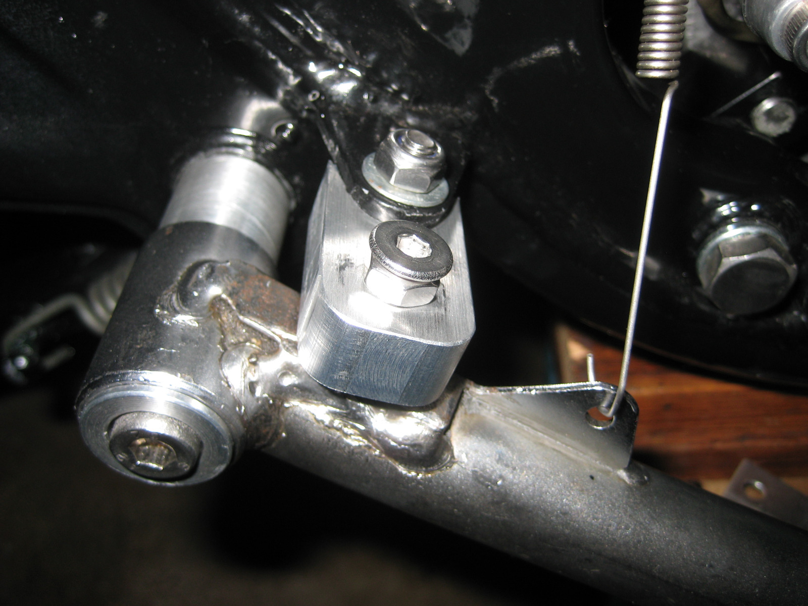

I decided to put a screw adjuster on the brake pedal stop, did not make any sense not having one.
Need to fix that horn before I move on to anything else.

The rear rim I have came off a KZ750 G. It's strange they used a ridged rim on the 750 twin for such a underpowered bike. They are a bitch to get over. I was hoping the bead braker would handle them.
We'll see soon.

It ended up I had the horn wired thru the relay wrong, was using switched power and engine ground instead of directly off the battery terminals. I only had to make up one new wire to attach to the battery negative lead to the horn.
I am using aftermarket battery cables and fuse box from Creative Wiring Solutions. The cables have extra wires to plug into and the fuse box has a extra place to run a accessory item. I put a 7.5A fuse in there to run the horn to battery positive.
Now it works and its pretty loud!
