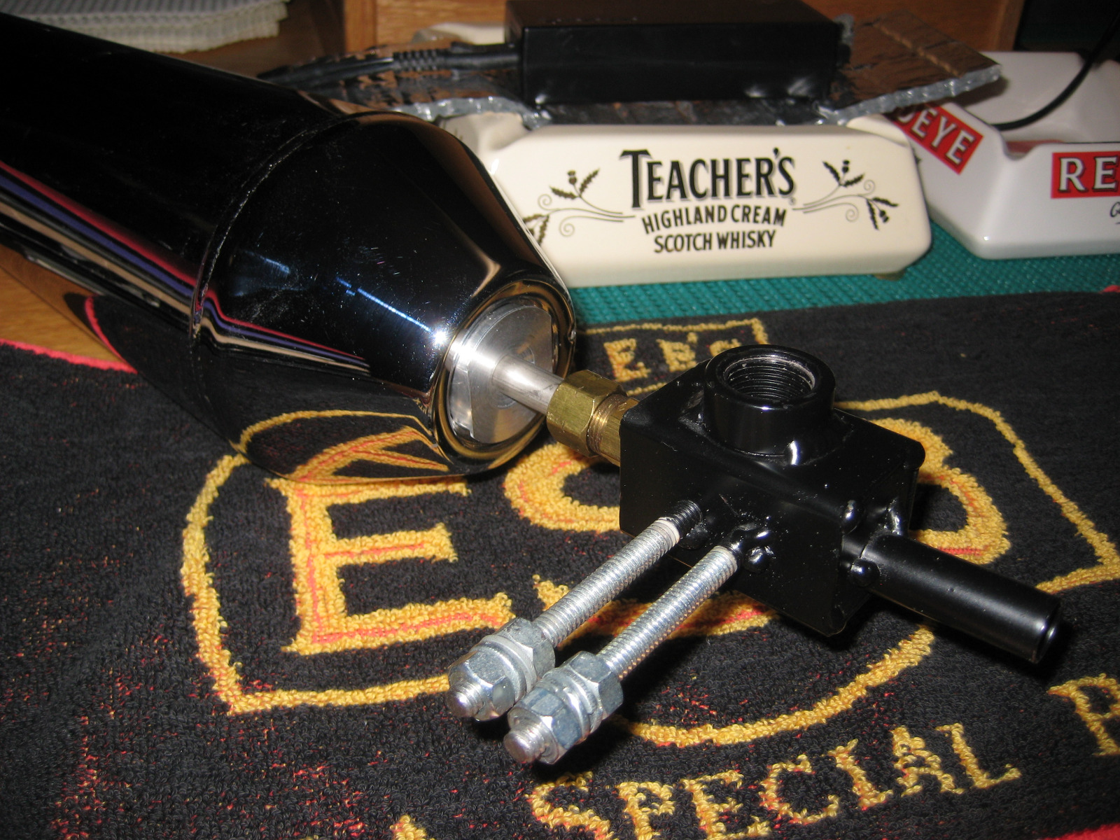

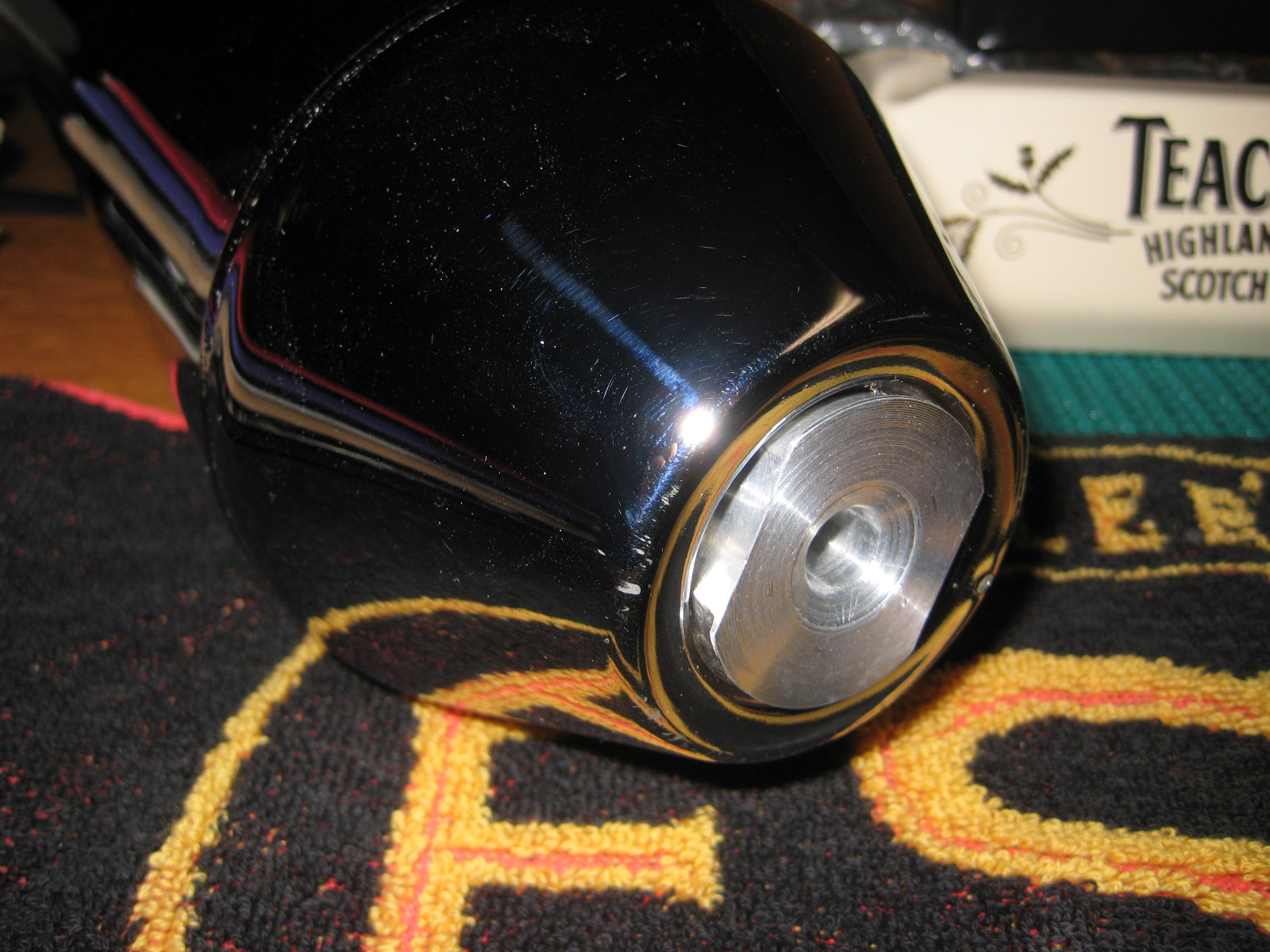

I made this centering plug for the AFR probe to attach to the RH muffler I will be using on this build.
I just need to drill some more holes in it to let the exhaust gasses pass, those flats got milled on OD to be able to clamp it in a vice for drilling.
I also made up a mount rail to attach it to the muffler bracket.

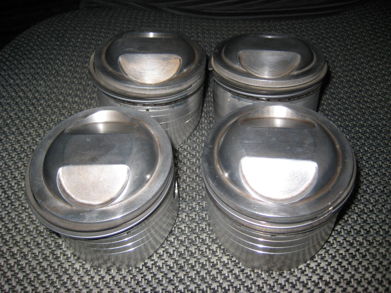

Got my used MTC pistons cleaned up and installed new NPR rings on them.
They have been around the block but they are good quality pieces so glad to have them.
The rings I found thru the Hastings catalogue by cross referencing thickness VS bore size. They were listed for a 1.6L Nissan Pulsar car engine, quite a bit cheaper than MTC/Wiseco equivalent.
I also trial fit my base gasket and found I needed to trim a few spots, but now it fits perfect.
Not sure when I will be installing the top end. I think I want to build the bike on the ground first as its easy to get down off the cart right now without the addition weight of the head and barrel.

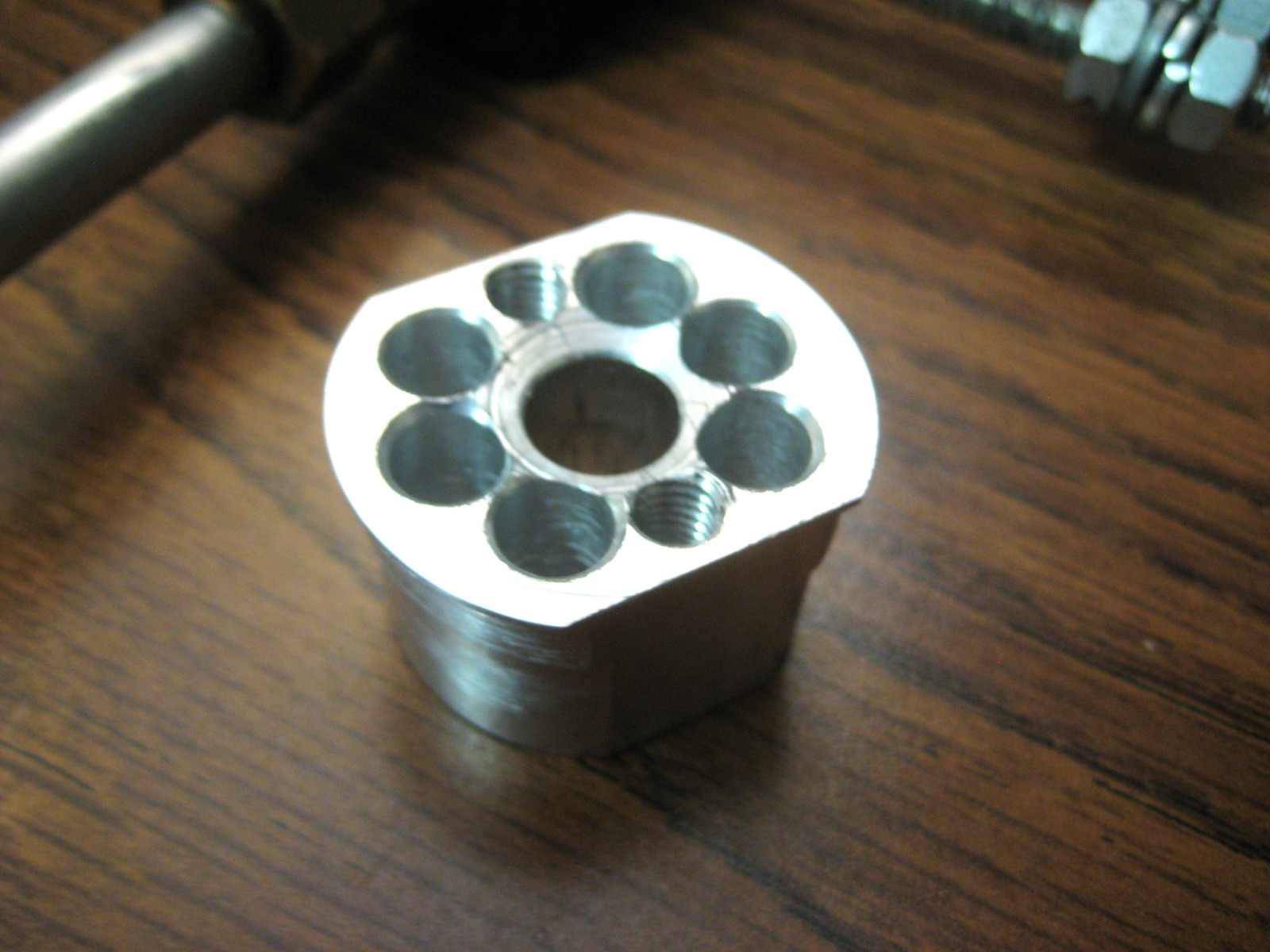

I finished drilling the holes in this centering plug for the O2 sensor fixture. I added some M6 threads to pull on it in case it gets stuck in the muffler opening.
Just one more thing put to bed so I am not caught scrambling when its actually needed.

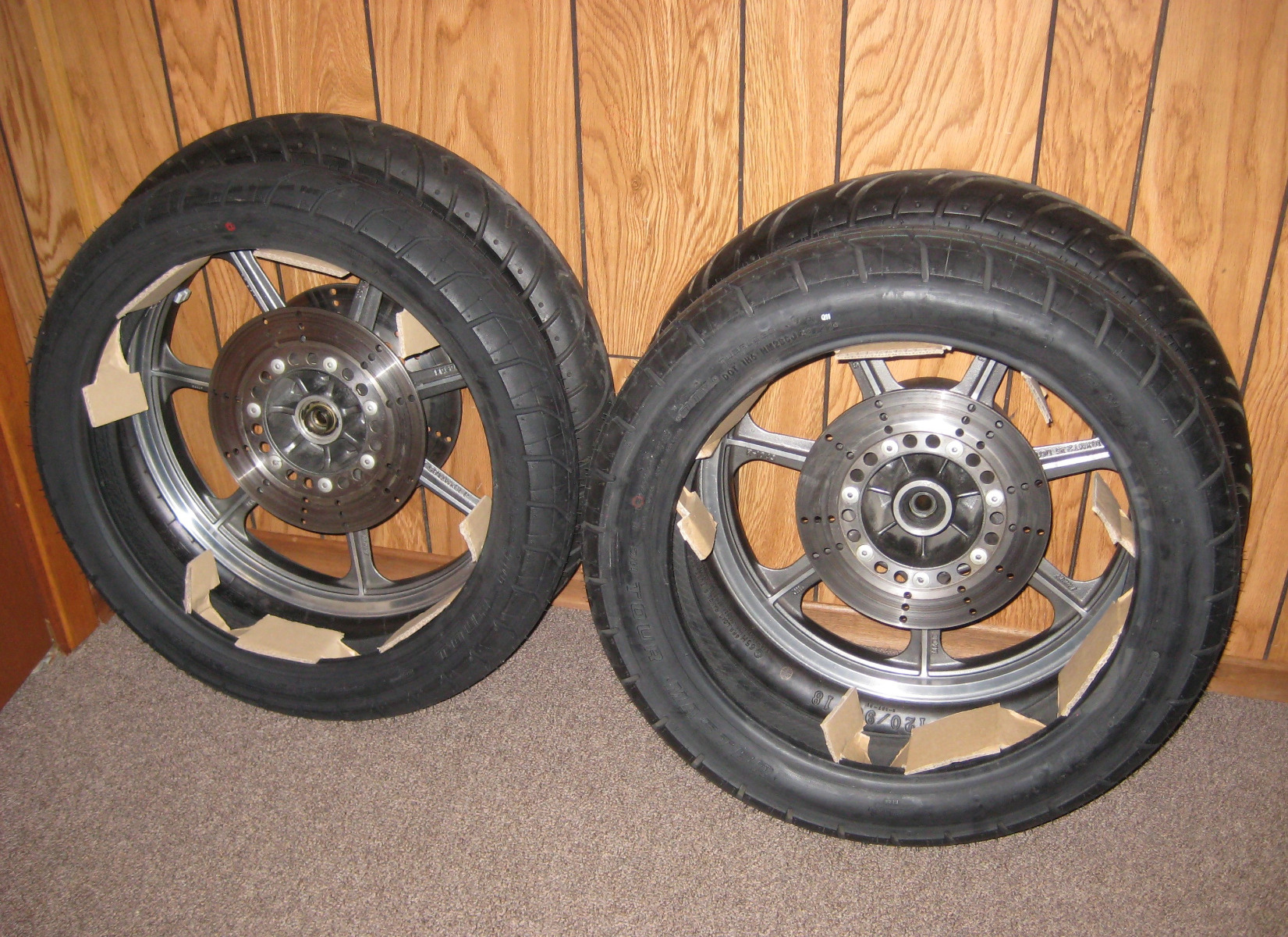

Looking at installing the new Shinko 230 tires I bought. Decided to start building the frame up on the garage floor instead of yanking my drag bike off the bike lift.
The old Kendas are from 2012 but they don't have that many miles on them. They did pass a safety check a couple of years ago.

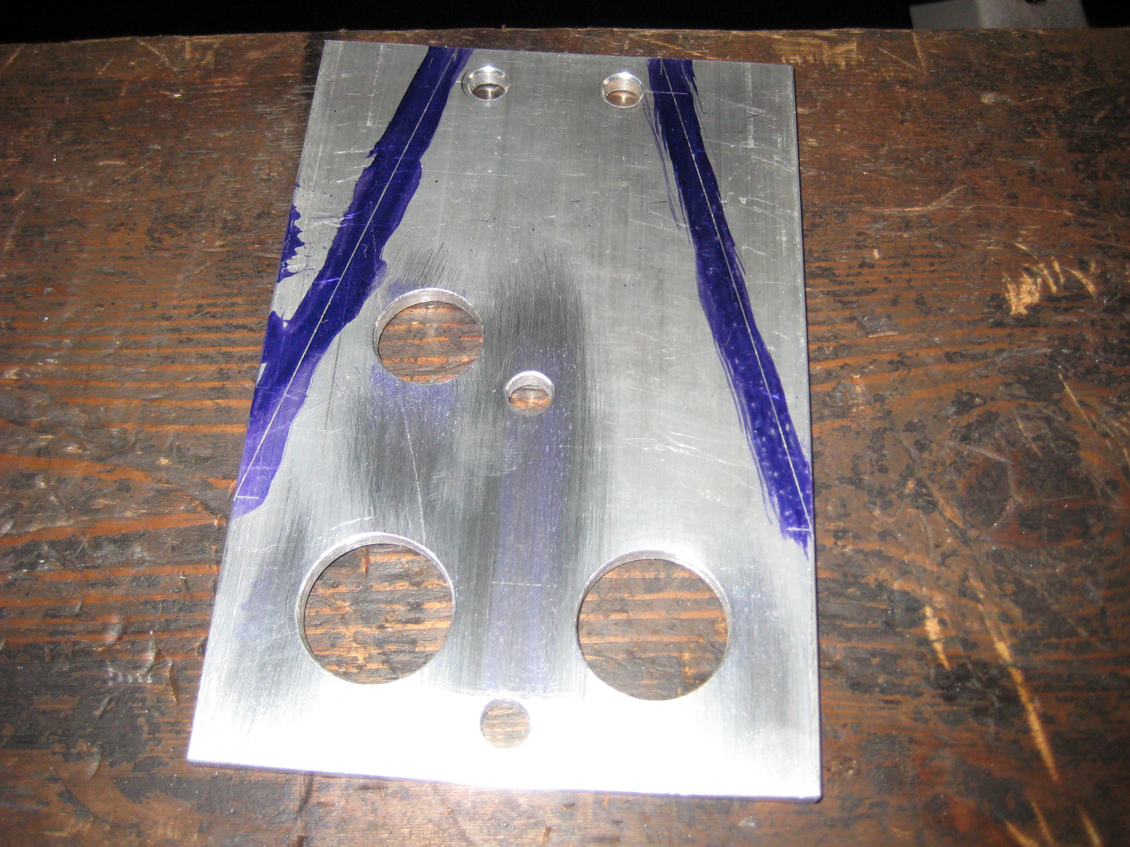

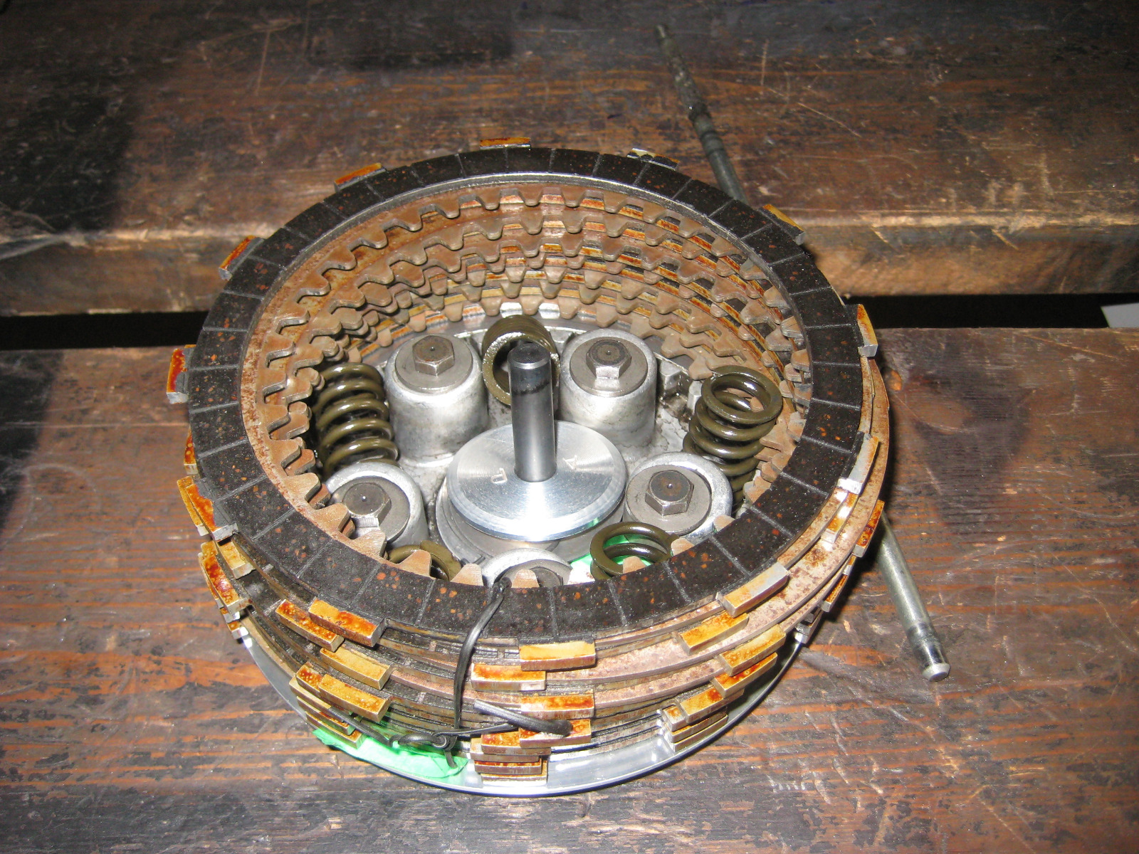

I decided to put the clutch pack on the engine, but I need to soak the fiber plates in fresh oil as they have not had oil on them for a lot of years.
I also put the holes in the oil cooler bracket, only thing left to do on it is saw cut and mill some flat edges to match the profile at the top of the frame.
This is the last fabricated part required that is going on this build.

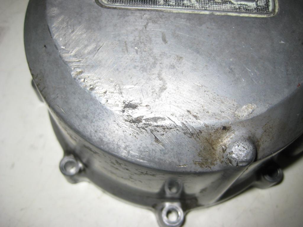

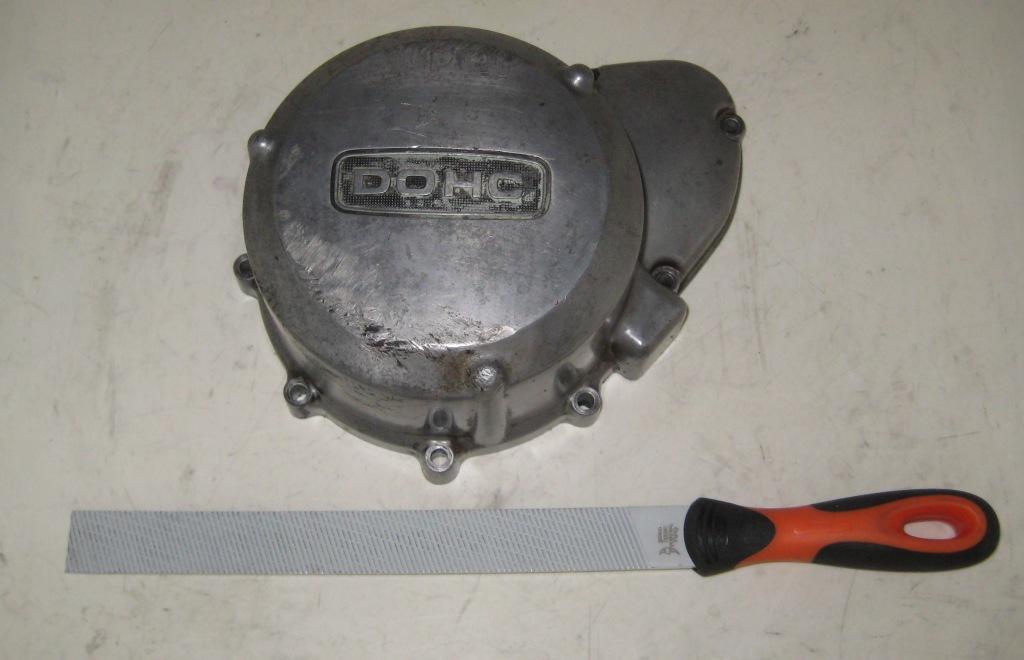

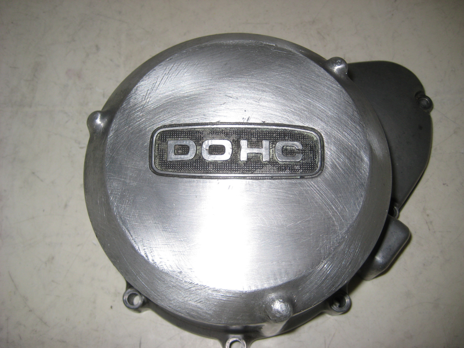

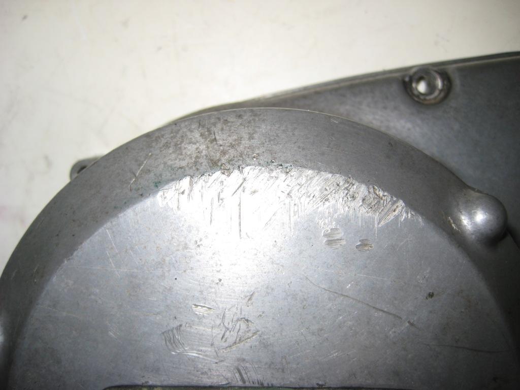

It was cold and snowy here today so had a bit of time to work on this cover.
Went from this
to this
in about 10 minutes with a aluminum file and some 80 grit paper. I was able to get all the big gouges out pretty quickly.
Just need to spend more time hand sanding it now working from 80 to 400 grit, see how it goes.
