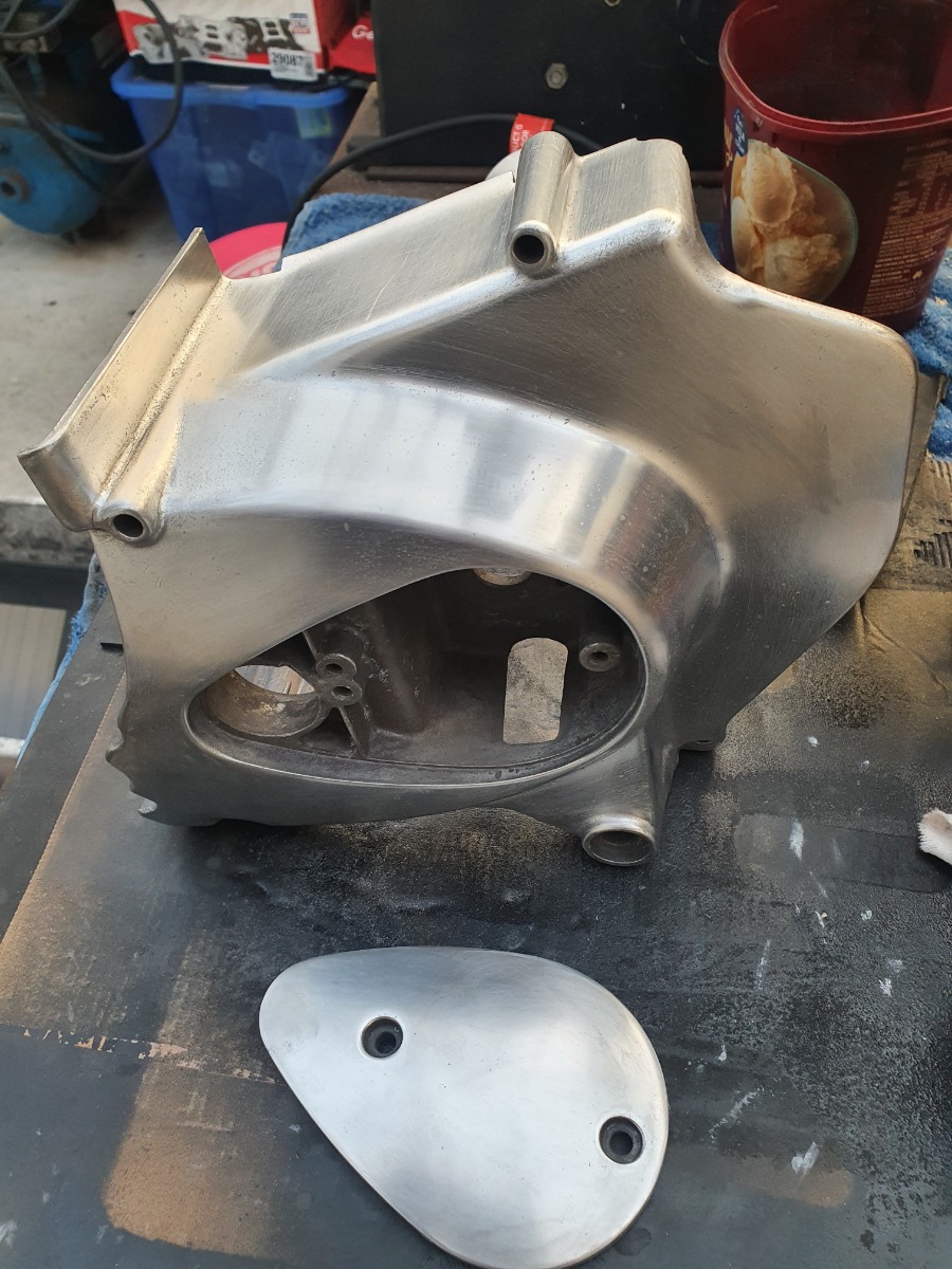

23 Jul 2022 06:53Haha, the drilled one is the outgoing, the other one will be the replacement.Don't like the clutch cover mod. It will allow grease to escape and may attract wasps!!
Maybe I can turn it into a wasp nest ?

Trypophobia. fear when you see patterns with lots of holes.

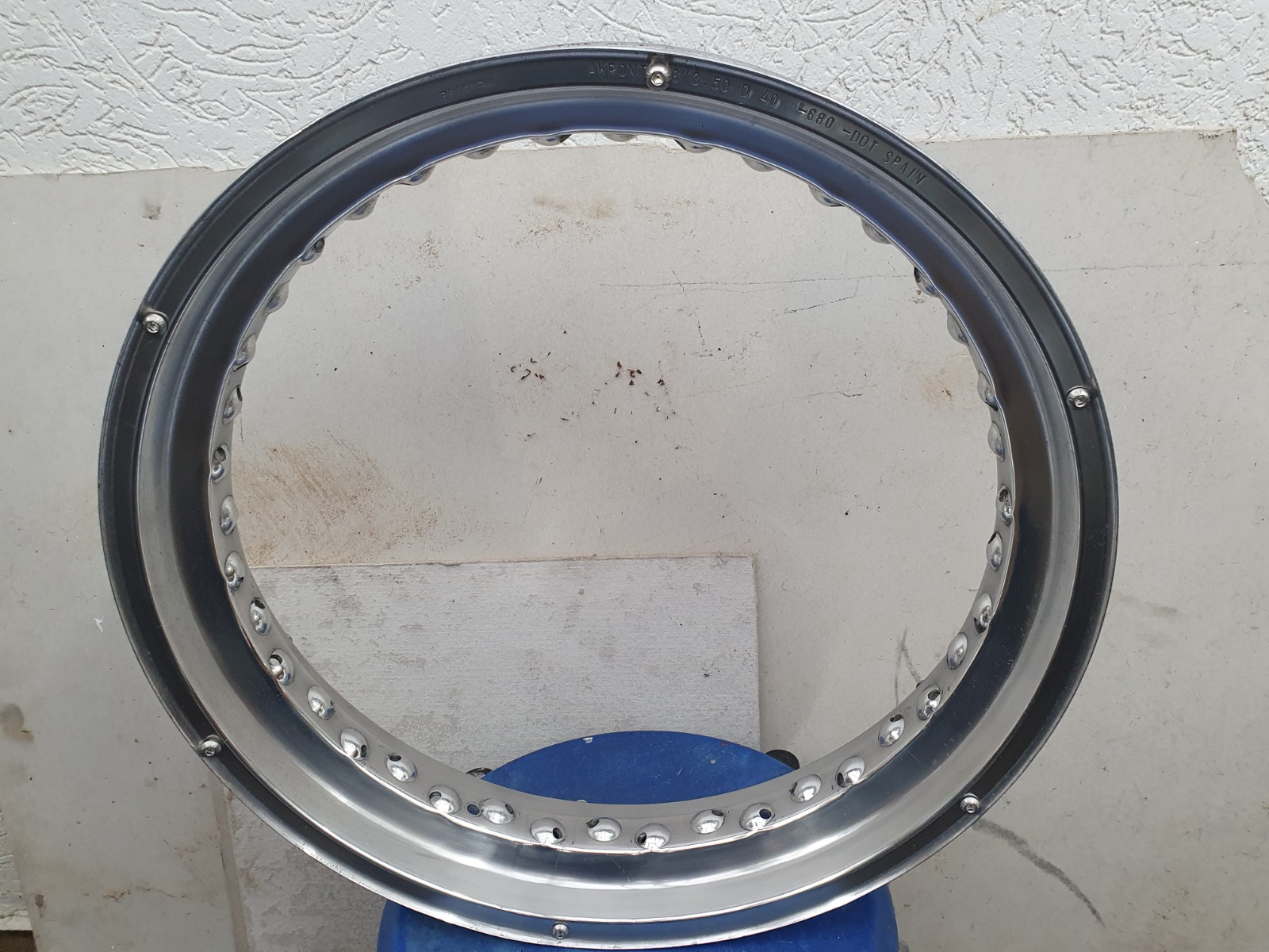

23 Jul 2022 23:27I have put stainless 6mm mushroom head bolts in - looks better than the bare holes.Are you going to do anything about the screw holes in the edge of the rims? I ask because I have an old 3.5x18 DID rim that has the same holes, It's off an old CB750 drag bike I bought years ago...

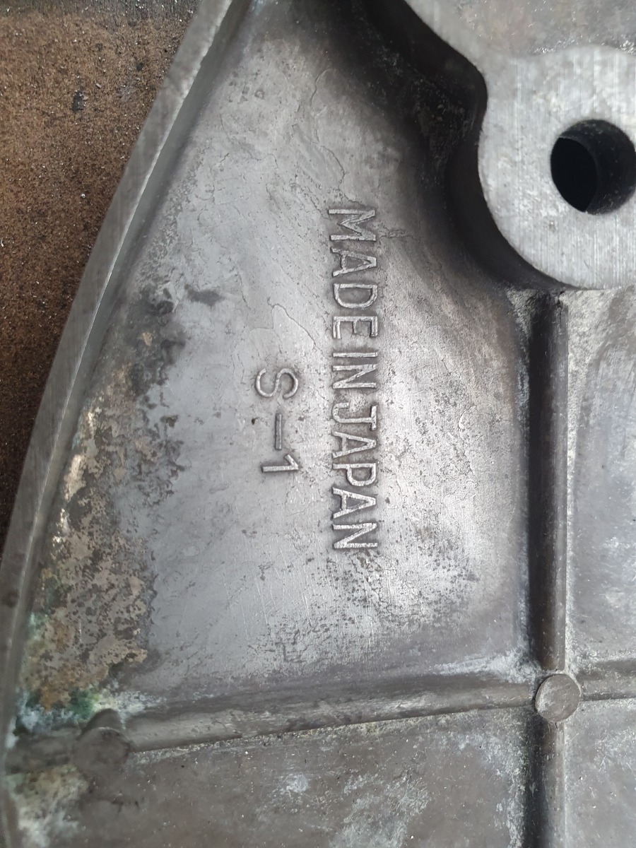

For info I found out about the S-1 embossing on the alloy covers. It would appear that a lot of parts on the bikes have a month and year stamping and the alloy engine covers used a S-1 embossing to designate '72 or '73 part. Later bikes used 2 and 3 in the embossing.

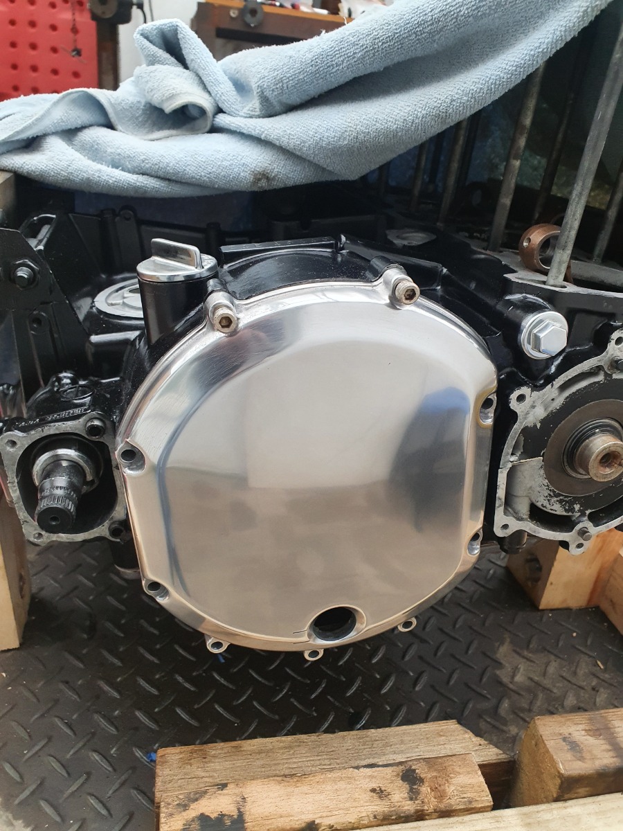

I have been busy polishing the de chromed alloy, focusing on the engine covers.
It's been a bit of a grind (quite literally) as the de chroming process of the corroded covers has left pock marks in the alloy, making it necessary to start with 80 grade wet and dry and work up to 1200 to get the covers flat and ready for a hand polish.

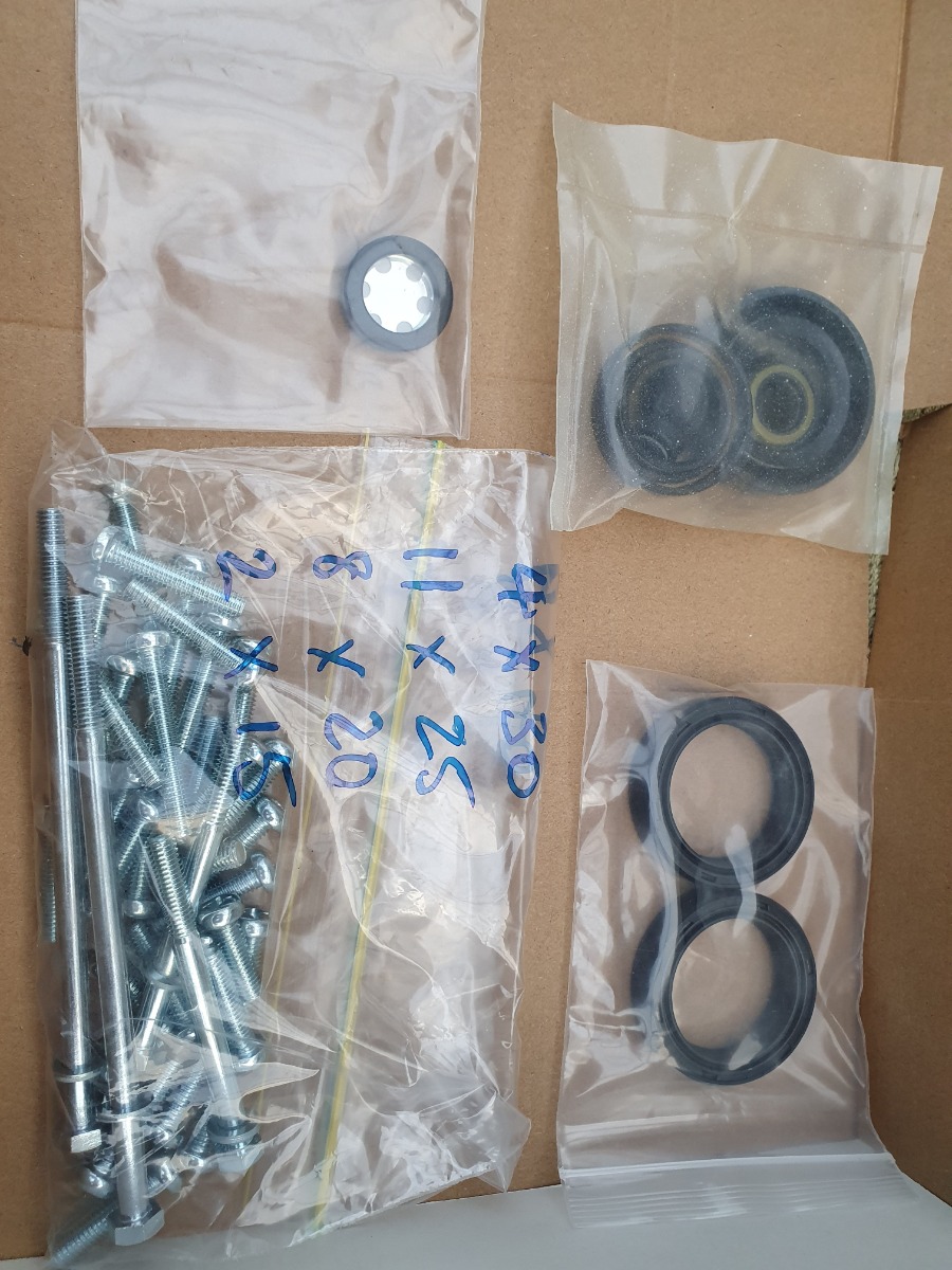

Also got some more parts, a set of cover screws in original philip head style, a packet of various engine/cover seals, a pair of fork seals and a clutch cover sight glass.

I have always found using 1200 W&D together with "Autosol" polish as a next step takes the finer scratches out before final polishing

26 Jul 2022 03:16Well I havent heard of using 1200 paper with Autosol - I still have a bit more to go on the top of the sprocket cover to clean it up so I will give it a go and see what happens !I have always found using 1200 W&D together with "Autosol" polish as a next step takes the finer scratches out before final polishing

I do it as you mentioned blackozvet, but I usually go to 3000. I don't bother with wet...just dry. I use Mother's polish, but I don't polish too much. The original look is what I am after.
You can learn all about Kawasaki parts codes in general and Z1's in particular in a book by John Brookes.

the sprocket cover needed some extra work, but I did give it a 1200 with Autosol and it didnt seem to hurt.
only 3 more to go.
I'm trying to get a clean shine on the covers, but not so shiny I can do my makeup in it !
