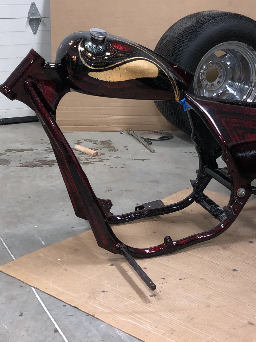

I have seen black frames with one coat of color scheme matching KANDY on top.
You don't see the color, it just glows a little more like an high definition Black with a deep undercoat.
But so you know I'm a bastard on color (not a stock paint job at my house,on anything except the wifes daily) as my z chop frame shows.

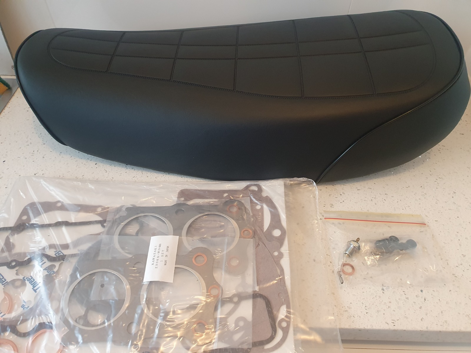

Time for an update - I have been busy online finding stuff. The wait continues on the de-chroming (they were still waiting on chemicals)
I have got the complete gasket set, valve guide seals and the later model brass neutral switch (which fits the trans cover perfectly)

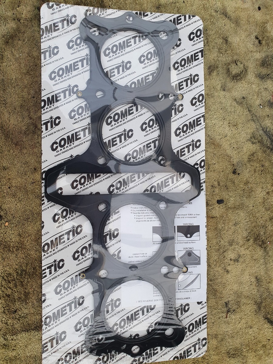

I have ordered a separate Cometic MLS head gasket for the larger sleeves/pistons.
The Mrs got me a new seat for my birthday !
Still in the process of moving stuff around in the workshop, need to get the bike stand in a position where the bike can get up and down the ramp when its rolling.

Make sure that head and block are baby bum smooth if using the MLS gaskets...

Beautiful seat!

06 Jul 2022 19:29I usually scrub them with brake cleaner till you can see the machining grooves.Make sure that head and block are baby bum smooth if using the MLS gaskets...

06 Jul 2022 19:32its the PMC made one.Beautiful seat!

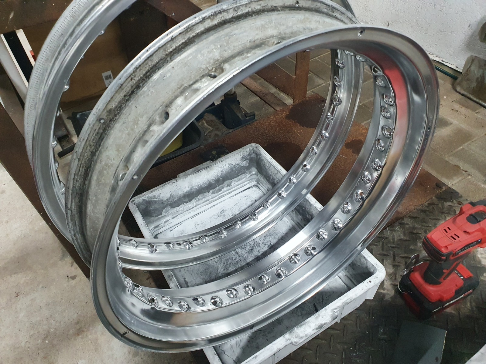

I spent a few hours wet sanding the Akront rims to get rid of corrosion marks and grime, finishing with 1200 and then polish.
They are looking a bit fresher than they did before !
Also got the Cometic MLS head gasket that will suit the 72.5 mm pistons.
